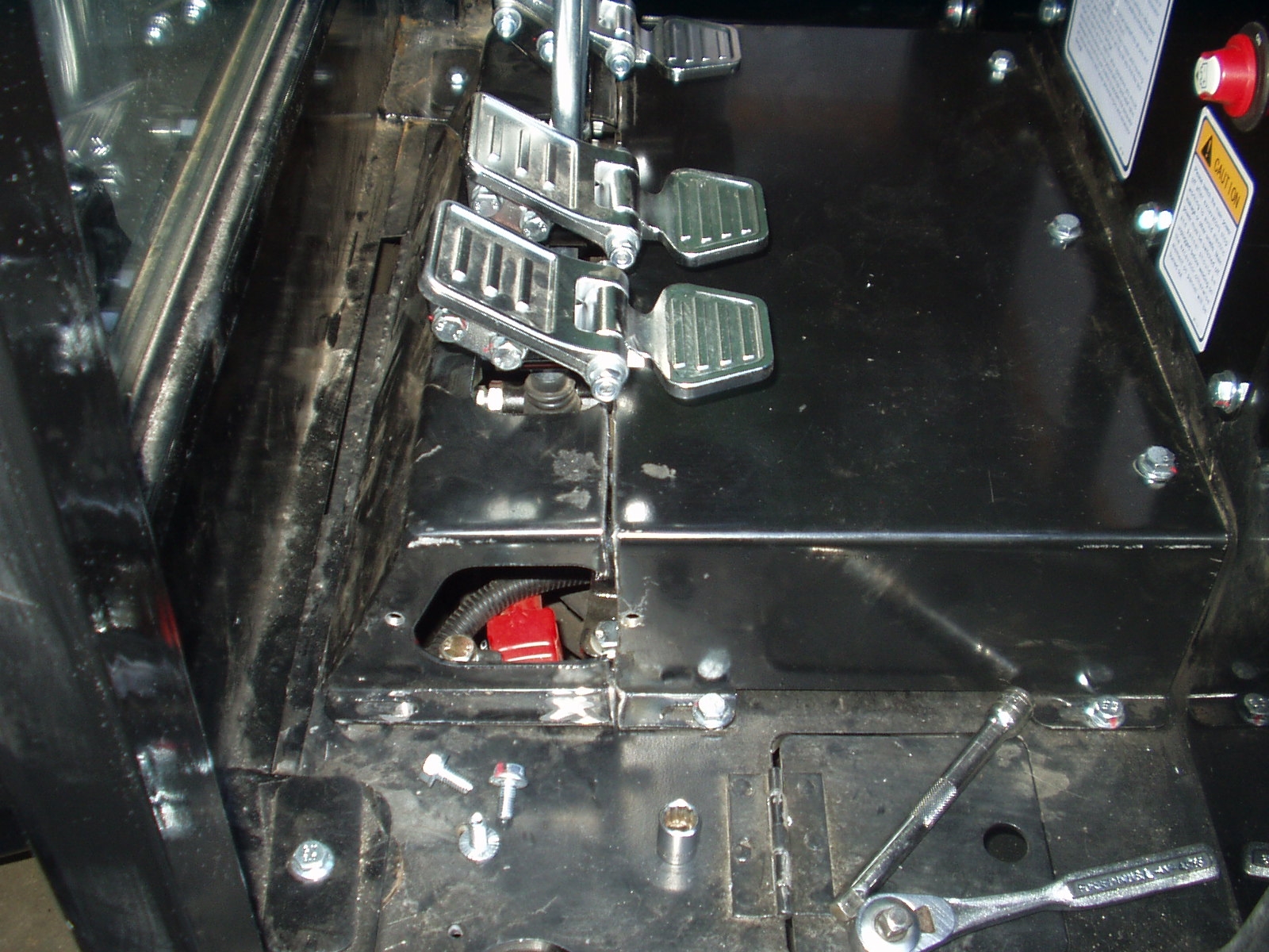

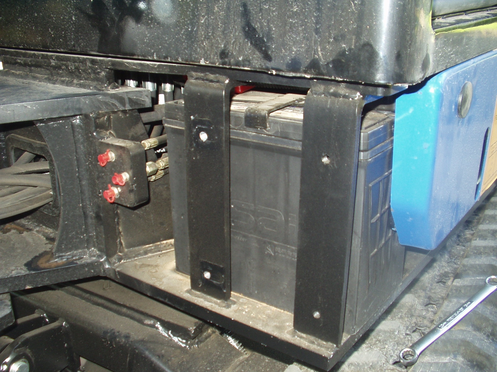

Incidentally finding the battery and how to access it took me a fair amount of effort. I first thought it might behind the vertical metal plate ( 6-13mm bolts to remove) below the seat where the battery cutoff switch is. It's not. Though the battery switch might be a quick place to jump or put a wire for a maintainer. The battery itself sits under the floor boards on the front left side and the access appears to be a metal plate on the front of the excavator where the turntable grease fittings are at.
Did not take it off yet but it seems you have to pop out two rubber hole covers and use an Allen wrench to remove bolts to loosen cover.
Edit 6/29: Well it is worse than I thought. 3 6mm Allen screws and some prying and the plate comes off but the battery is behind welded bars. It seems the left side panel (blue) would also need to come off and to do that it looks like the cab has to be pulled off first. At some point in the future I expect to modify the left side panel so that access to battery would be possible without lifting cab off first. Likely cut off the metal portion next to the fuel sight gauge and maybe hinge it for opening.

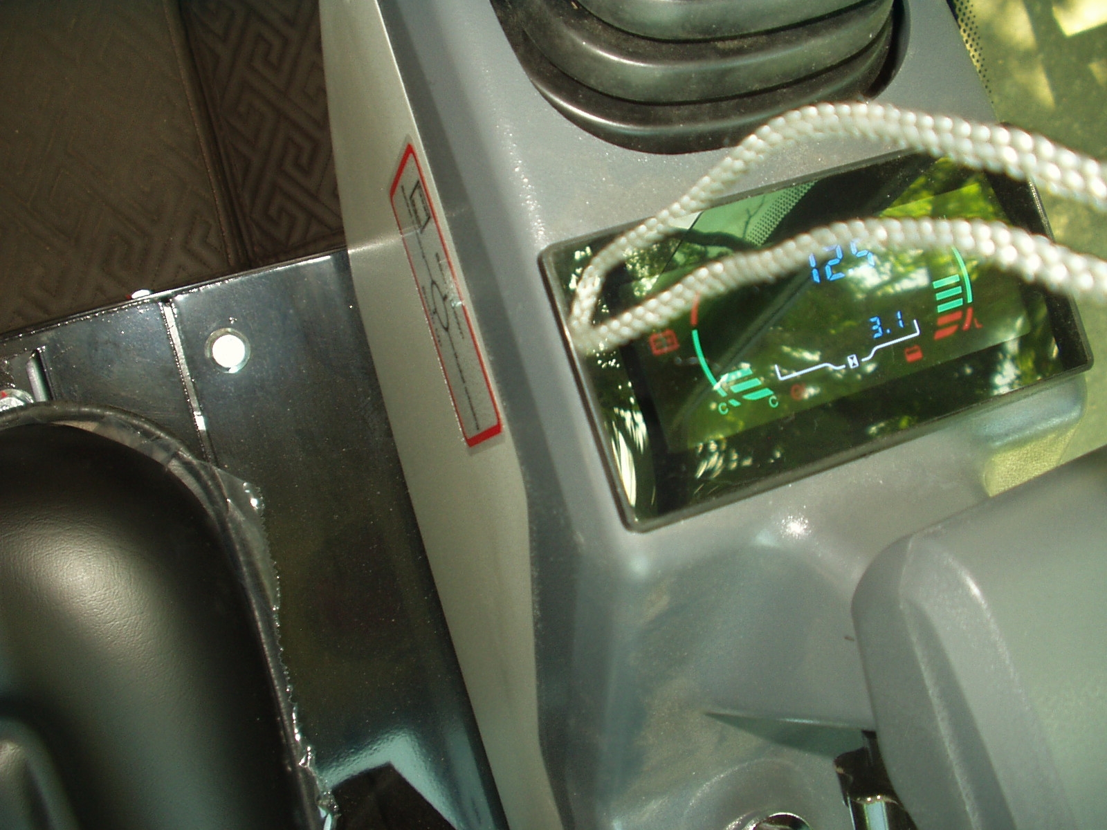

A question for anyone that has a cab with 12vDC Aircon/heater. The temperature settings do not make any sense to me. It is not in degrees C or F but it is numerical starting at 3P as lowest and going up by 1P (4P, 5P and I gave up once it reached above 10P) with each up arrow press and back down to the lowest of 3P with each down arrow press. Since it seems to operate all the time with it being 92F outdoors it baffles me how to set a temperature corresponding to a degree for cycling the unit.
One thing I notice is it seems to draw plenty of current from the charging system. To avoid exceeding the 40A rated alternator and drain the battery it will take some testing. The excavators display on the right hand joystick armrest gives battery voltage both as a number and a bar graph of SOC. BTW the LCD display only gives readout for engine temperature, battery voltage, hours and SOC. There is no other indications.

I was wondering if the compressor for the air conditioner is mechanically driven by a belt off the engine or is driven by an electric inverter motor?
   / Typhon Terror XVII with cab.
#28
It is 12vDC. There are many of these units being sold to RV'ers, truckers, farmers for enclosed cab tractors and such. They are the same concept as a mini split home Aircon with a unit outside that has the compressor and radiator than an indoor mounted head attached with hoses. you see a ton of them for sale on Ebay, Amazon and the like for people willing to connect up and add the refrigerant to them.
Problem with it being 12vDC is the amount of amperage it draws. people buying the excavators that have the gas engines without alternaters lack the amp capacity to run one of these without draining the battery. if you look around the 'net there are some interesting mods some folks are doing to add a belt driven alternator to the gas mini ex's.

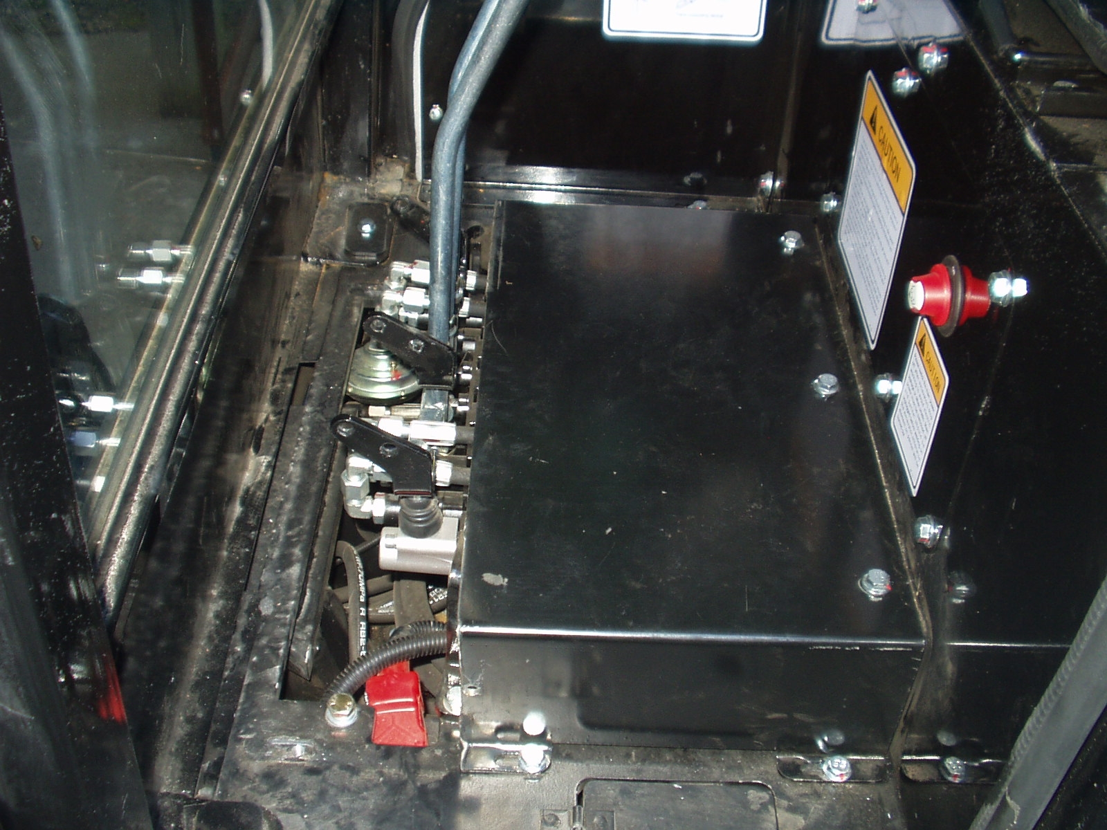

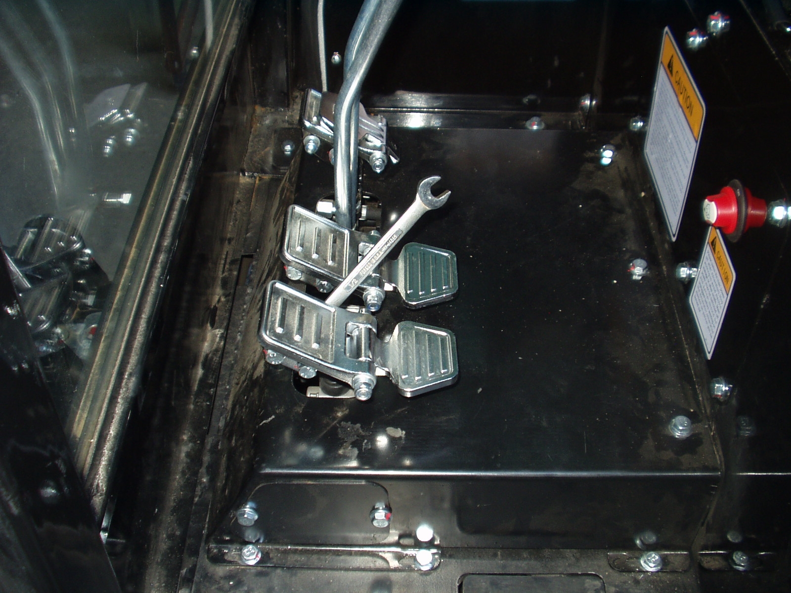

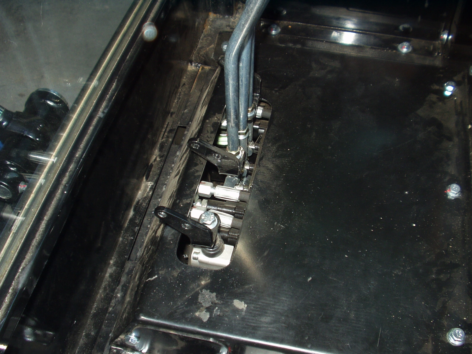

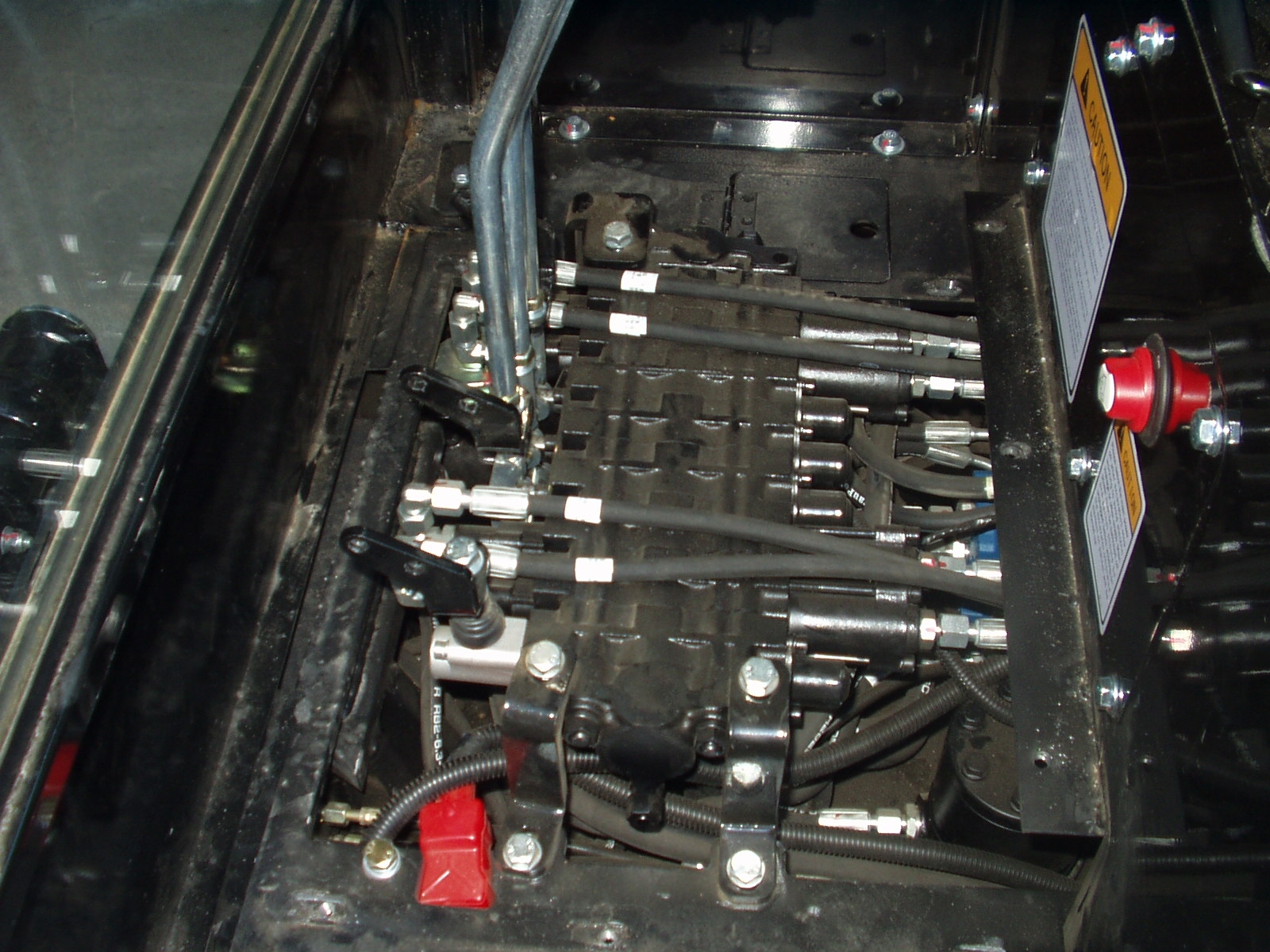

Couple of modifications this morning. The floor plate above the valve body is a pain to remove due to having to pull off all the floor pedals. Some work with a plasma cutter and the plate is now in two pieces and more accessible. One floor bolt per side and the little cover plate on the left side also acts as a brace.
Not sure if there is anything that can be done to get at the battery short of abandoning it when it goes bad and installing a new one in the engine compartment. One thing I found out is the battery switch interrupts the negative. That means the positive going to the starter from the battery allows me to wire at the starter a 10awg connection to SAE plug and to the switch side of the battery cutout. This will be used as easily accessible charging point.
I ended up removing the seats head rest as it was a concern about it busting the back window. Especially after I found out that the seats recliner adjustment did not hold if I pushed back to hard while seated. The ergonomics of this cab unit would make it great if I was 5'-6" tall and weighed 135lbs. Not so good at 6'-3' and 210lbs.
I plan to go with a different smaller battery, too, but my 7yo original is still going strong. I plan to use a smaller U1 riding mower battery, and I will have to change terminals, too.
   / Typhon Terror XVII with cab. #31
It's a bit shocking they'd put the battery in such an inaccessible location.

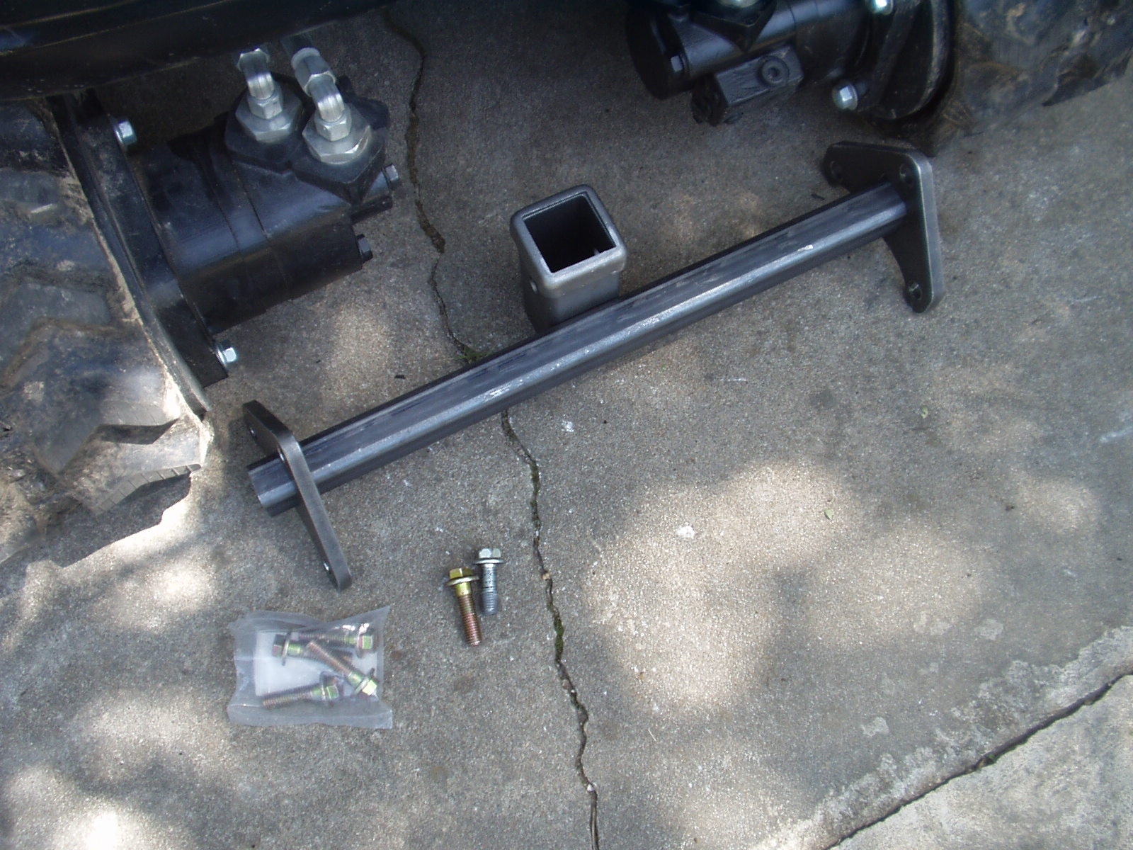

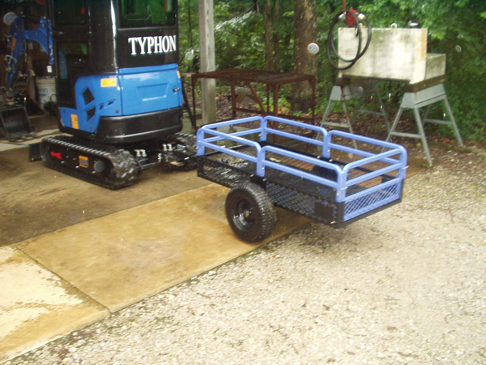

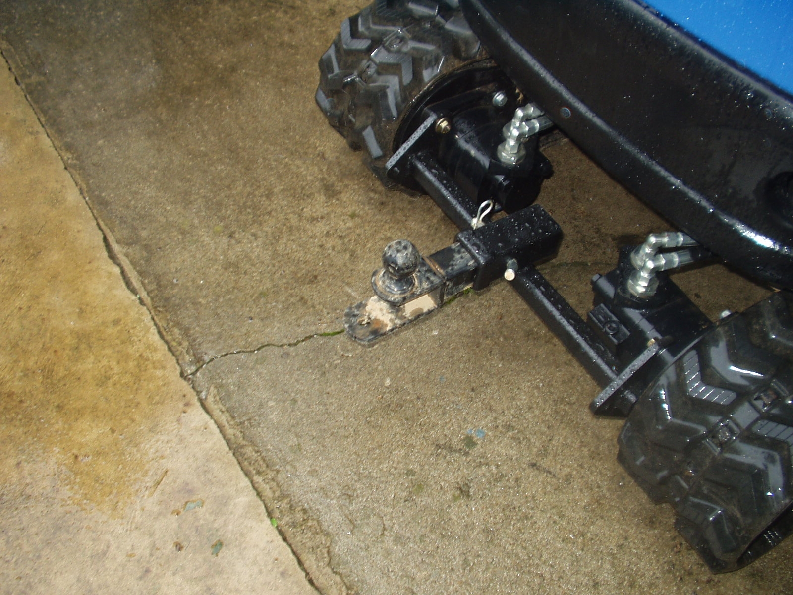

Went ahead and built the drive motor brace. It mostly came out good once I got all the parts I needed to build it. One error I made though, when welding on the trailer receiver hitch, was I allowed myself to get hurried by an approaching rain storm. I had spot welded in place the tube but one side was not good enough and as I welded around from the other side the spot weld broke and the tube lifted a small bit. This meant the tube is not perfectly level to the cross bar. You can not really notice it but it bugs me.

Looks good from here - and you have a cart to load rocks and stuff! I got the same plate and found a bolt on hitch plate from off TEMU 45$ for two so used on on the mini.
Have a HF receiver hitch platform 24x48 to carry spare buckets etc, if needed too.
