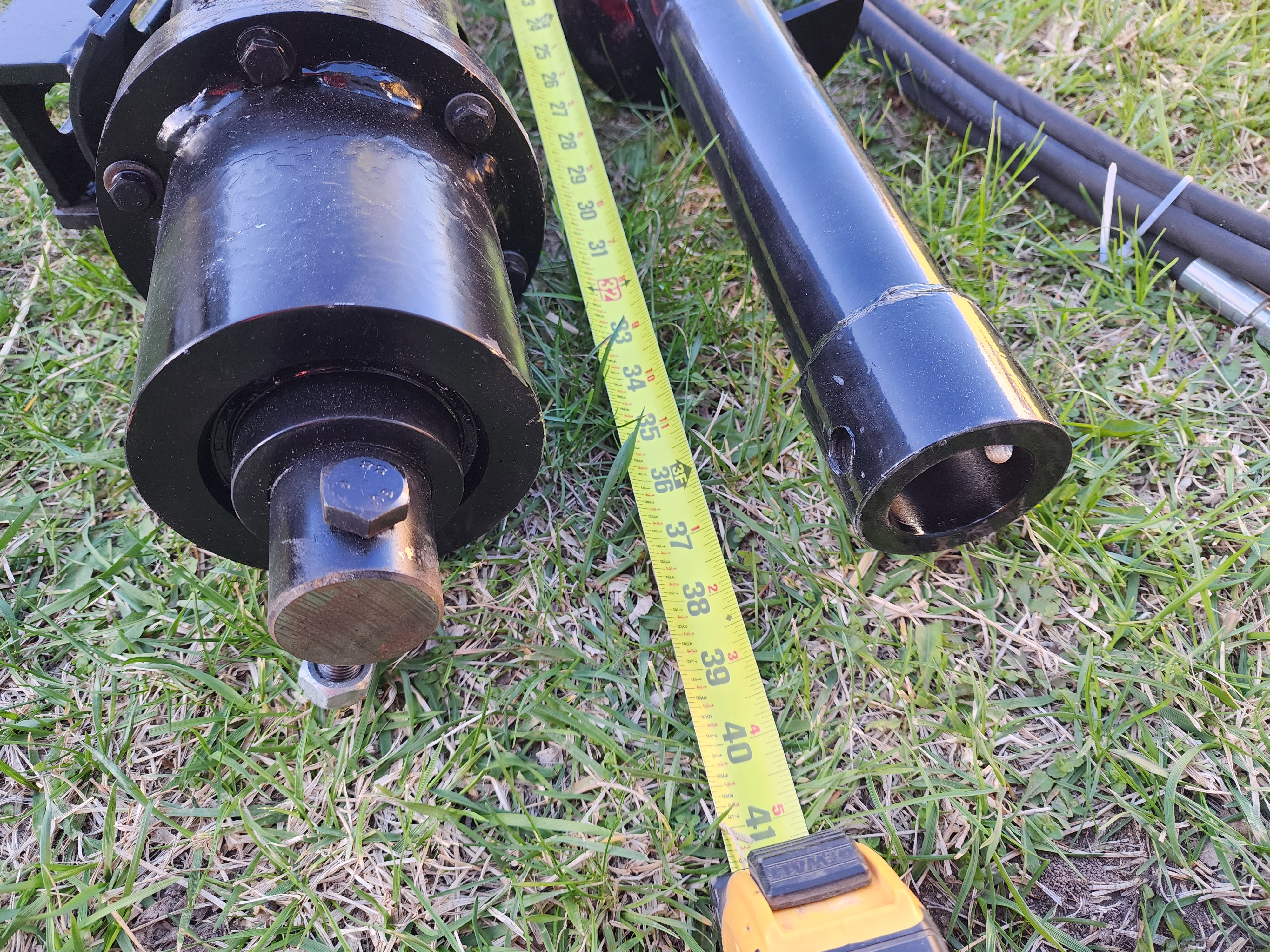

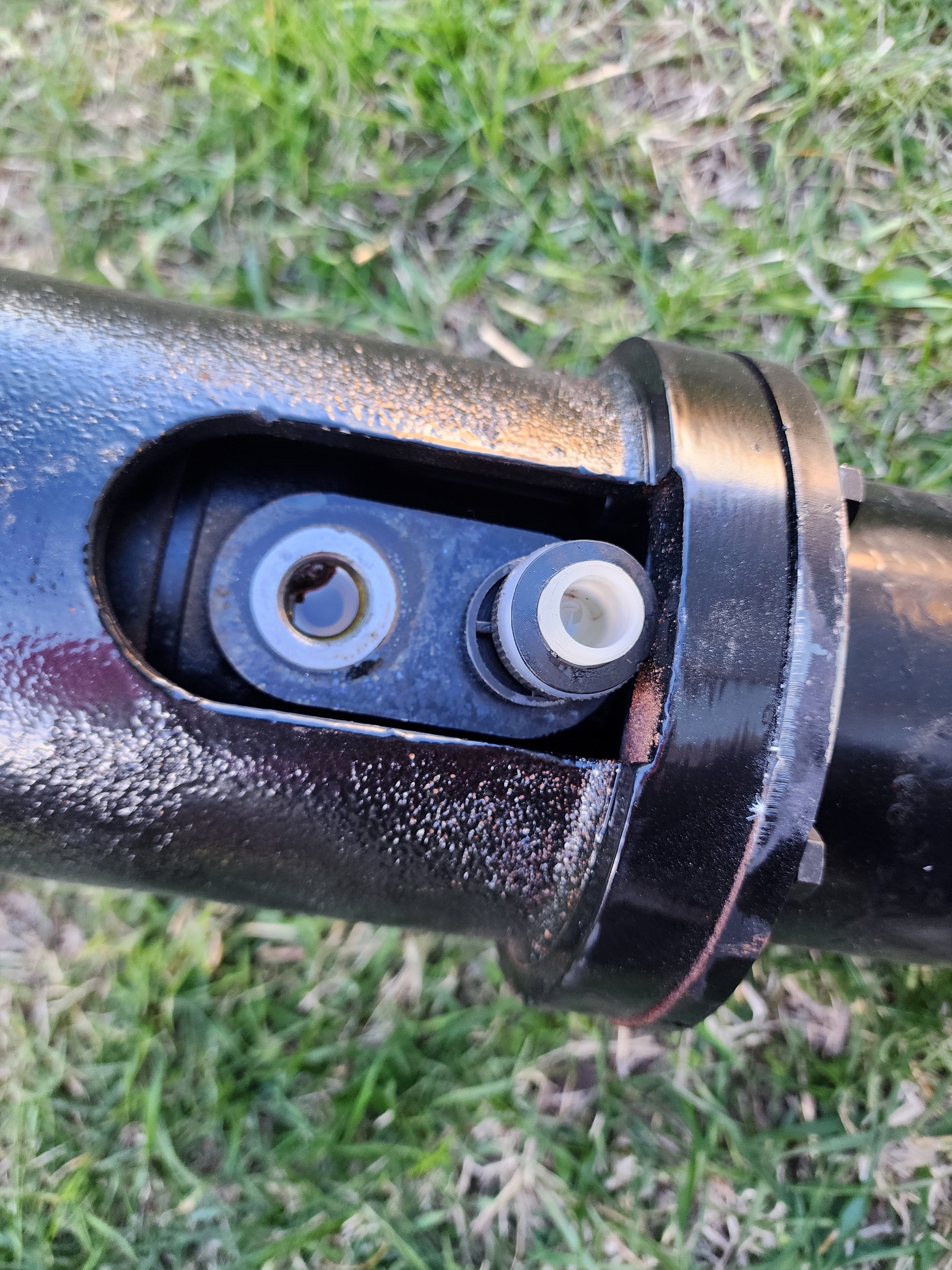

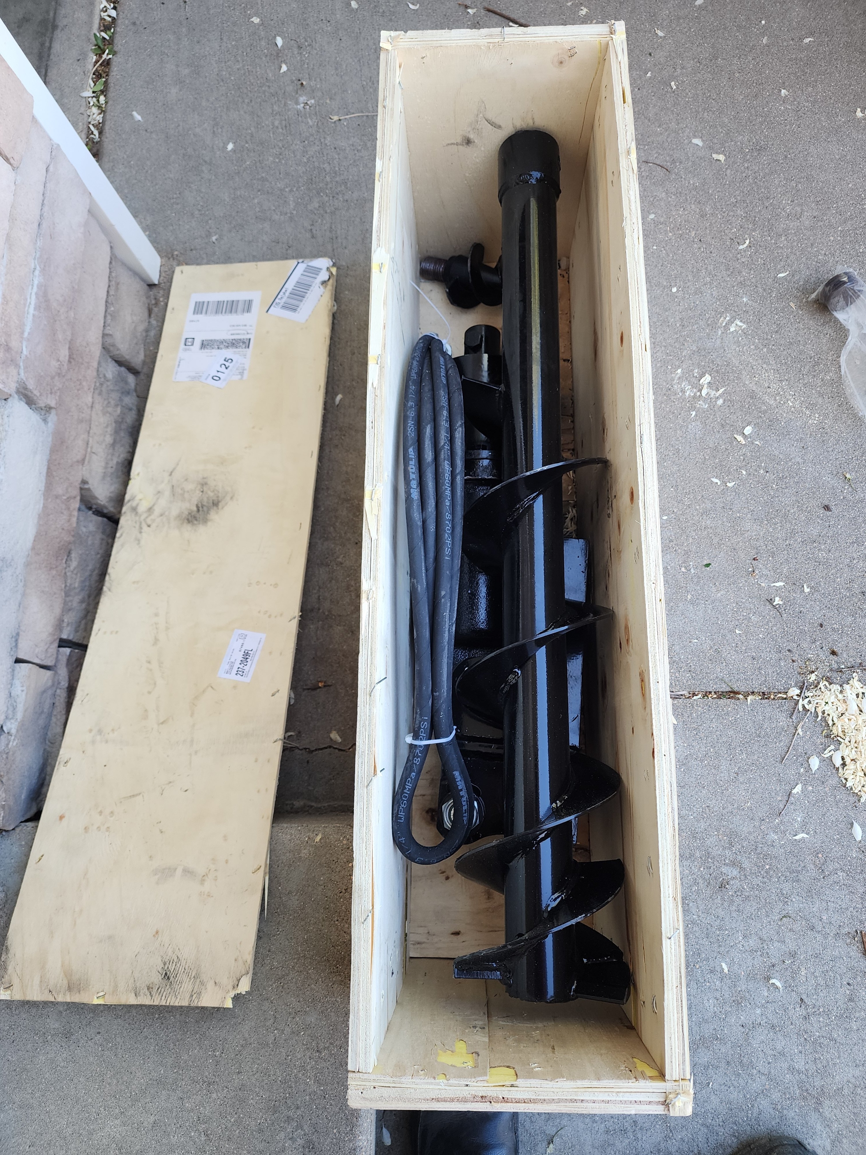

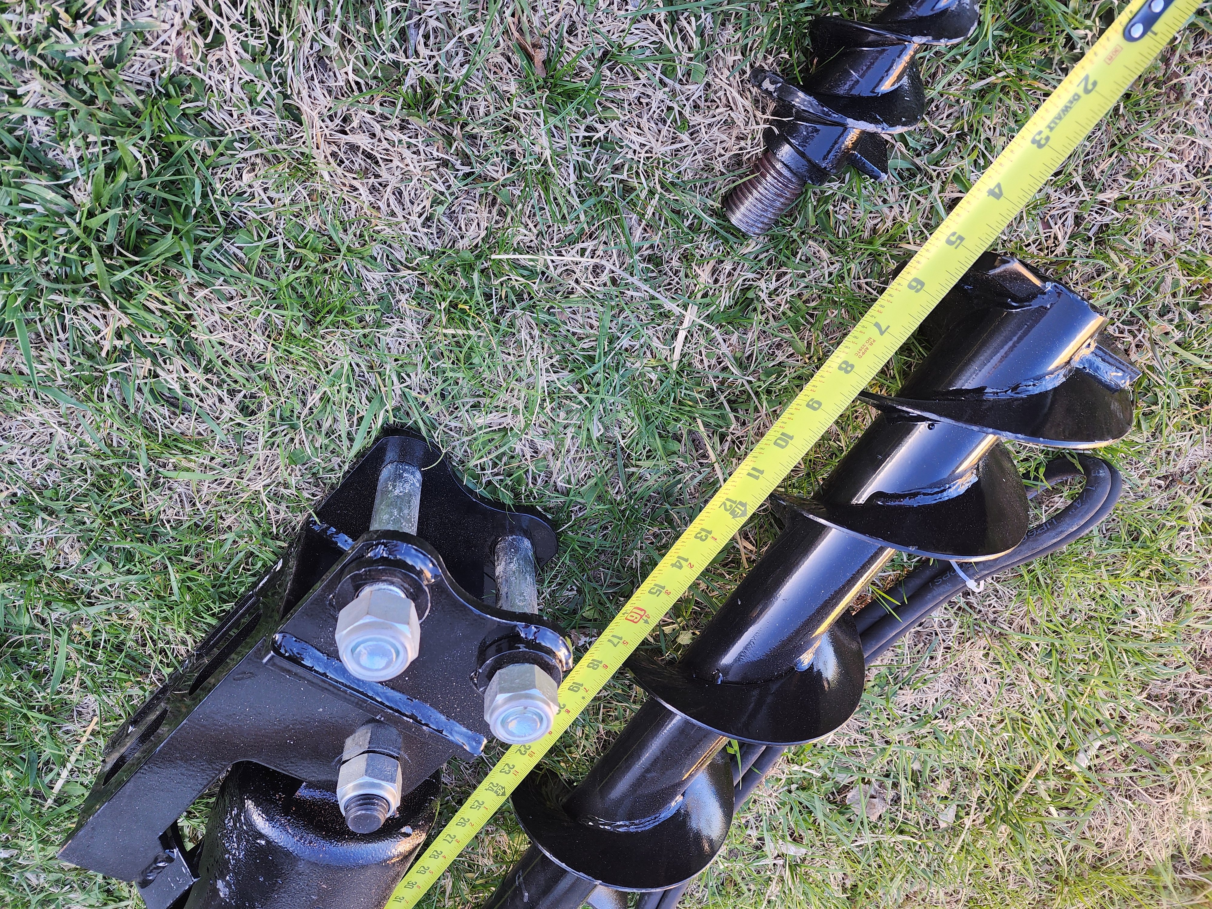

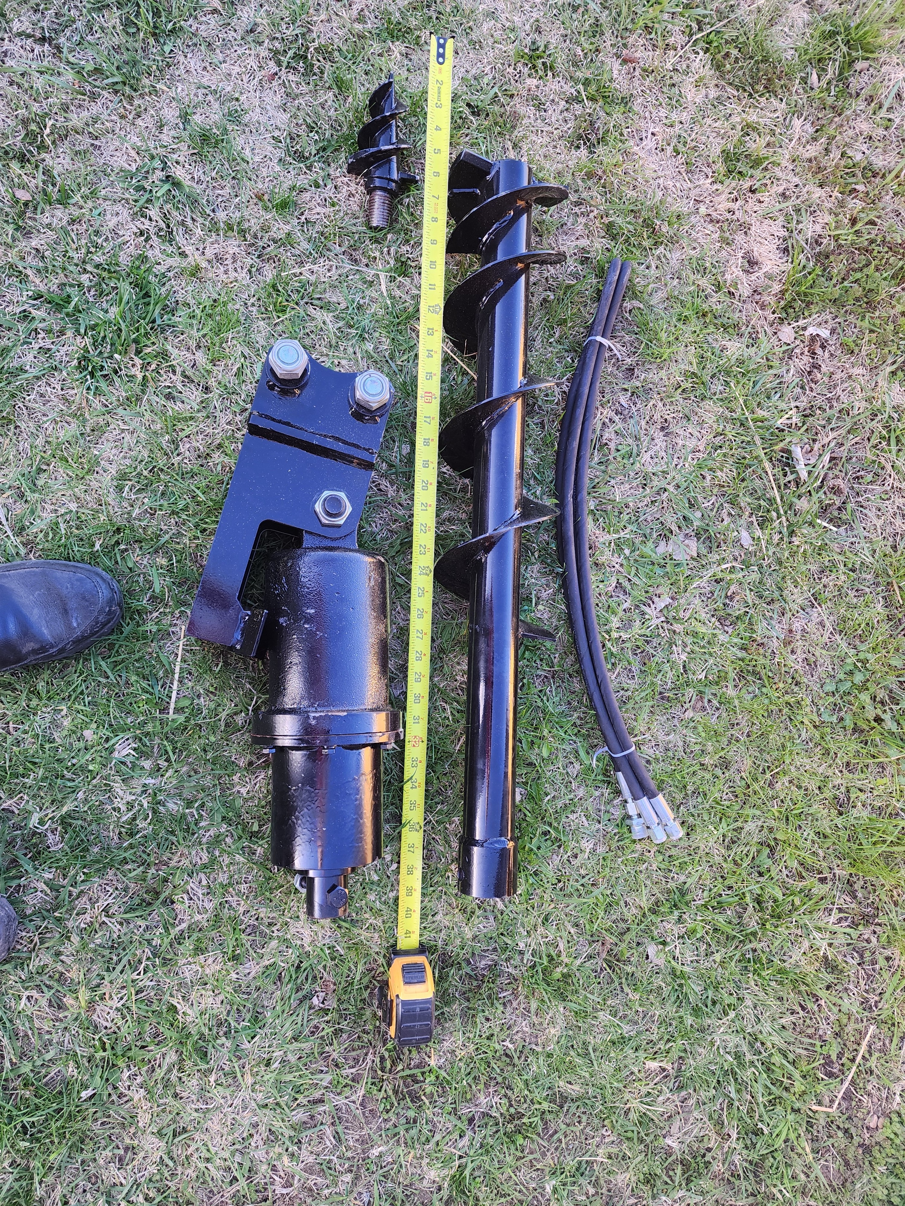

Received my 150mm auger today. 88 pounds worth in a plywood box. Ordered it Friday night for $352.25 that included tax. Shipping notice came on Monday evening and fed ex ground picked it up from Pasadena, TX. Got to Kansas today on Thursday.
Definitely a heavy duty model like used with a Bobcat. Motor must weigh 50 lbs with a 1.75" shaft. Auger point screws into the bottom of the auger. I couldn't lift it all together. Came with two 5' quarter inch din 6 hoses. Uses a male M18x1.5 Oring boss fitting going into the Motor. However my ff13 has 5/16" din 8 hoses so I have to order a couple adapters and probably should get quick connectors.

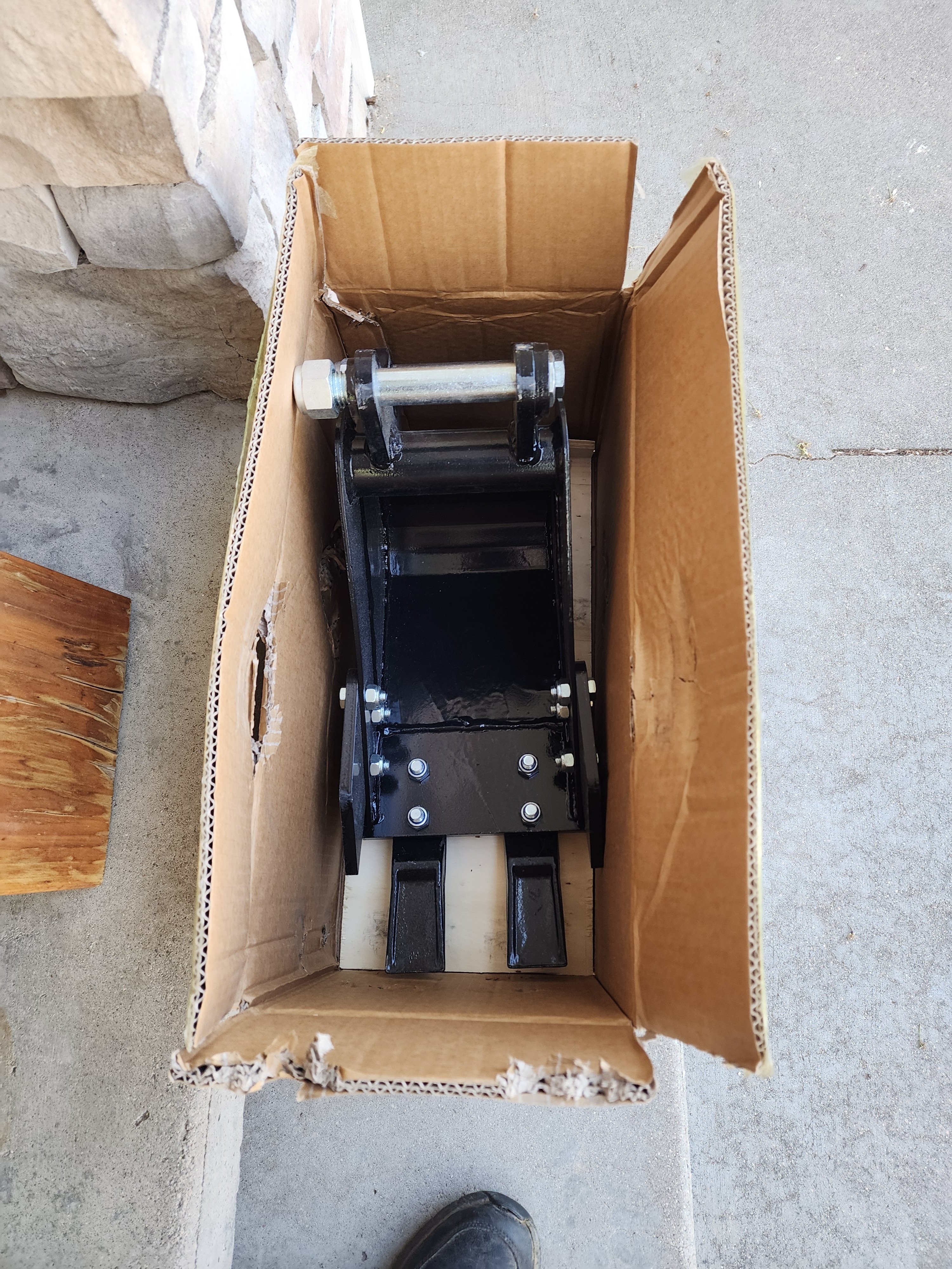

Got my 8" bucket yesterday. Measures 8" wide on those wings on the side and 7" wide for the interior of the bucket. Haven't tried it yet. Cost 151 bux with PayPal. Shipping notice prepared in Ontario, CA but shipped from the exact same rented warehouse dock the auger came from. The auger shipping notice came from the dock in Pasadena, TX.

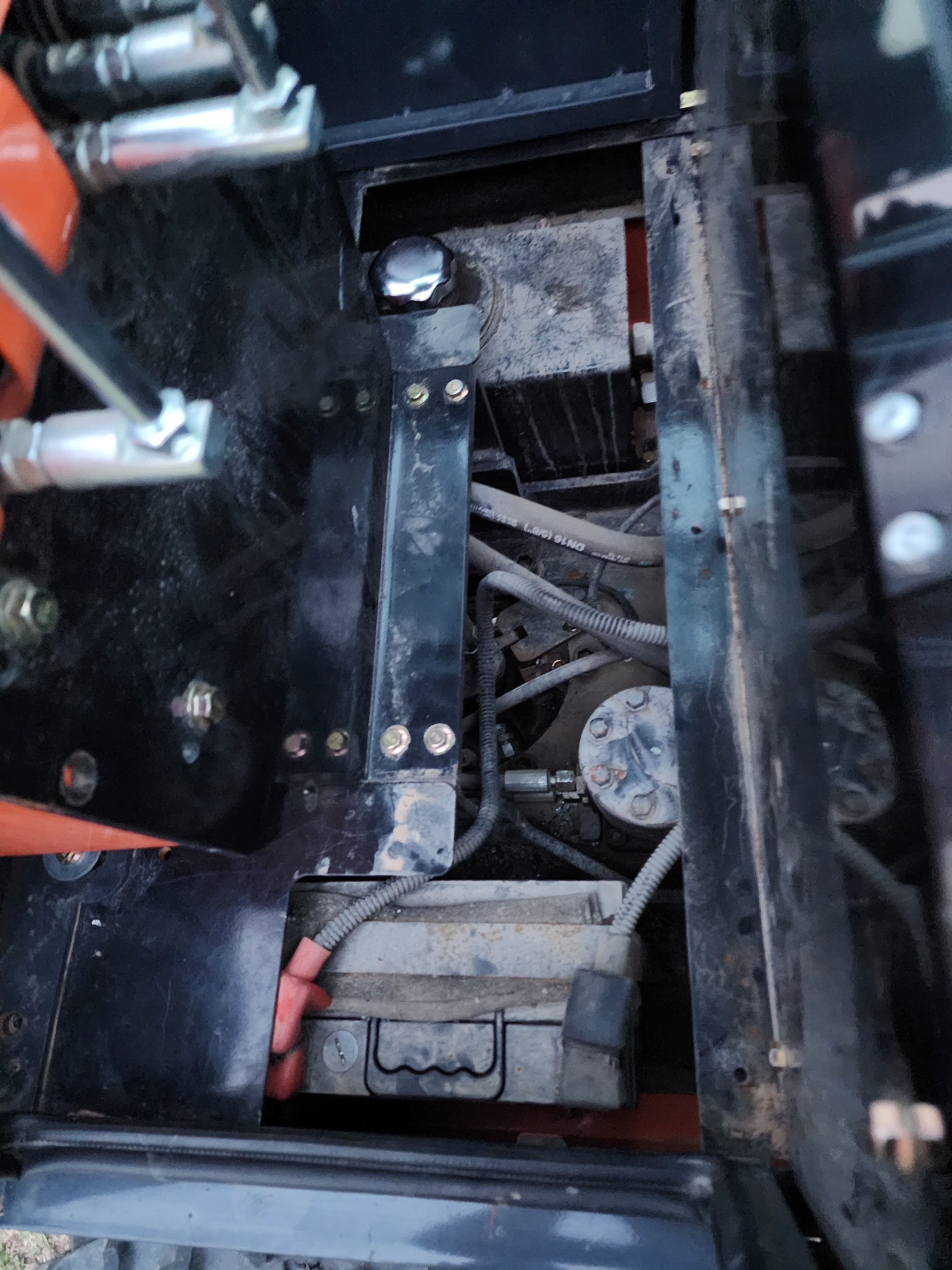

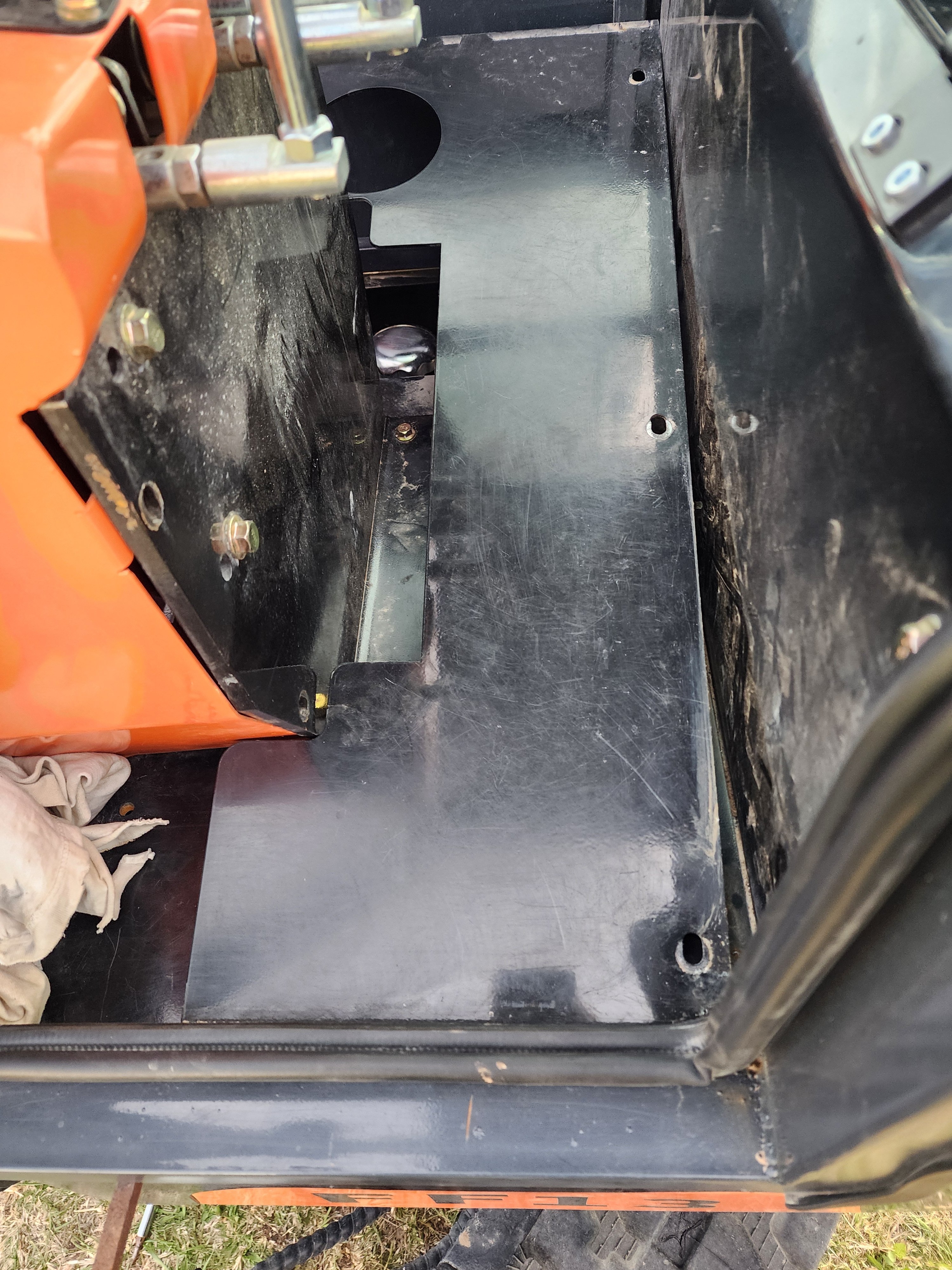

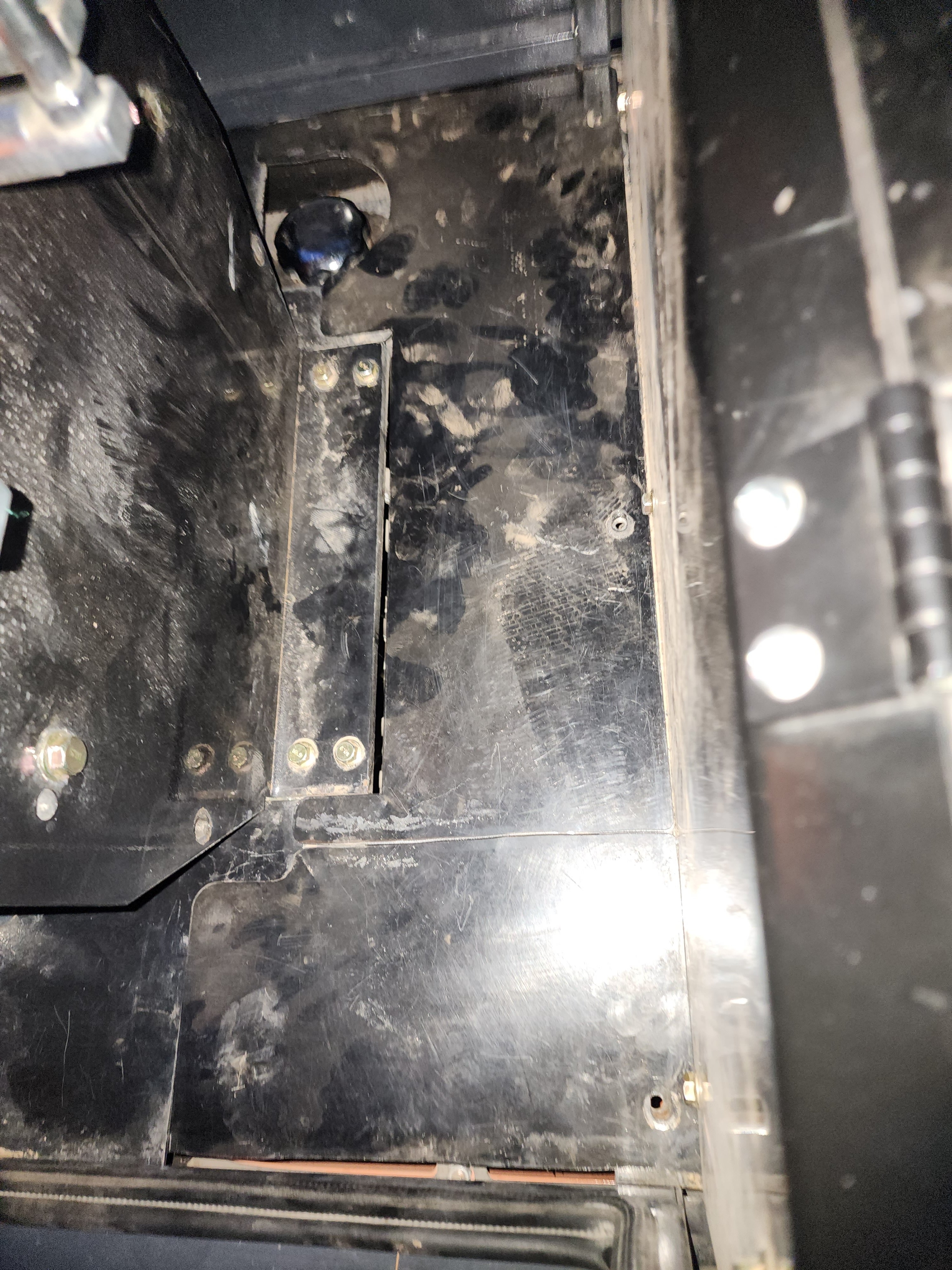

Been multi tasking but got back to digging yesterday for an hour then it died so I took a break. Tank half full and it wouldn't start but it would try to fire. Got worried I may need to access the battery to charge it.

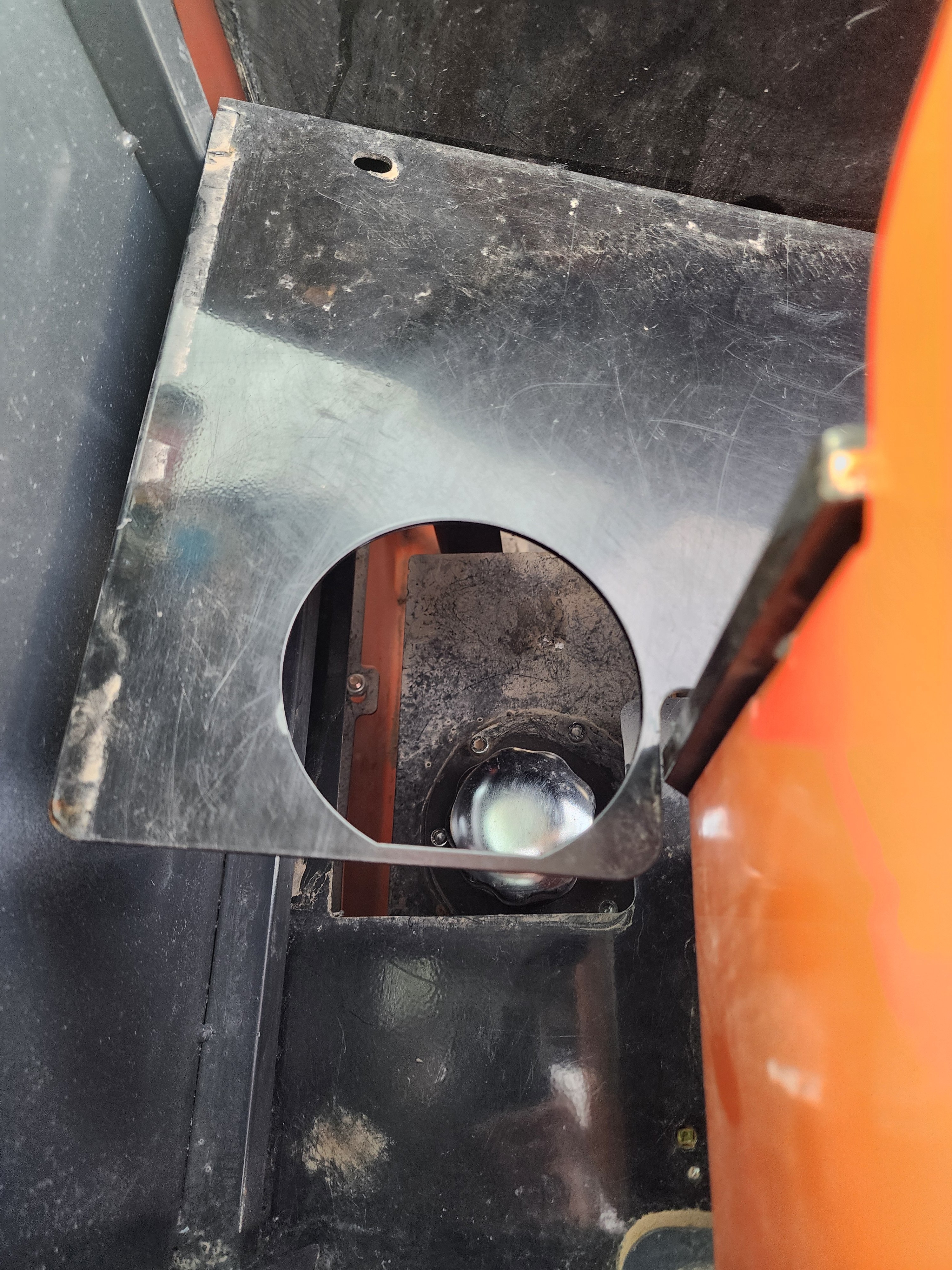

Tried to take the side panel off but it didn't come loose and it was holding the cab up.
Took the 3 bolts out holding the floor plate but the cab was sitting on top of it on both sides. Took out the 2 front cab bolts, shimmed it up and could slide the plate. Tilted one side up and managed to get it out after cutting off a piece around the hydraulic tank cap. Took a Sawzall and cut the sides of the plate off that were under the cab. Also cut the side of the plate in two pieces so one bolt accesses the battery.
The battery has a front plate that covers half of the positive post. Might have to move the battery and mount back or notch around the positive post as the plate is on top of it.
