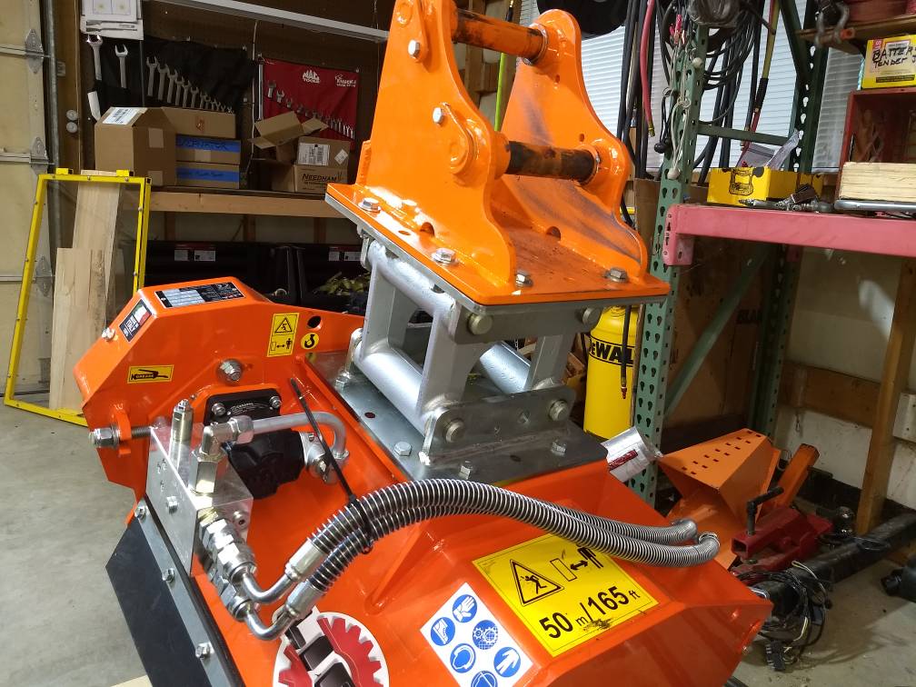

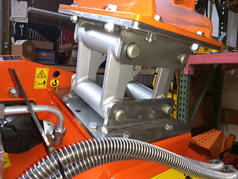

I contacted Needham Ag Technologies in Kentucky and talked directly with the owner Phil Needham. A very informed guy to talk with, answered all my questions plus important questions I didn't even know to ask. I needed a mount that fit my mini-x quick connect, they had a local machine shop make one up.The gpm flow rate is critical for the wellness of the mower as well as the mini-x. They installed a flow control valve and showed me how to match the mower needs to the mini-x. I needed hoses made to fit and since I am nowhere near a hydraulic shop their shop made them for me. Spiral wrapped hoses with quick connect ends. This allows me to run off the hydraulics from the thumb. Also ordered an oscillating saddle that goes between the mower and the mini-x to allow flexible up and down protection/movement of the mower.

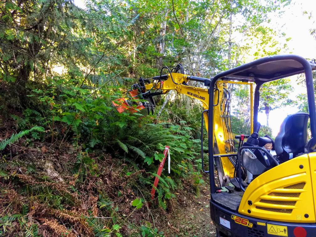

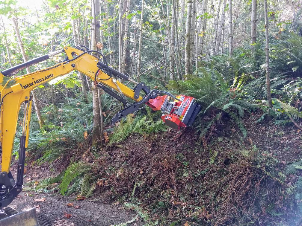

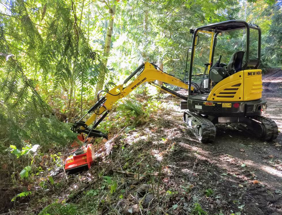

A couple pics... IMG_20201011_095620197.jpegIMG_20201003_150557148.jpegIMG_20201003_101411463.jpegIMG_20201003_092148651.jpegIMG_20201003_095518068.jpegIMG_20201011_095635967.jpeg

What's with the apparently articulated coupler? Looks like it will swing side to side? Or is it pinned somehow?

Very nice. What's with the apparently articulated coupler?
You set the weight of the mower on the ground. as you swing while mowing the coupler will flex and allow the mower to follow the contour of the ground.
Cool. I take it the mower has skids to keep the flails from digging into the ground?
