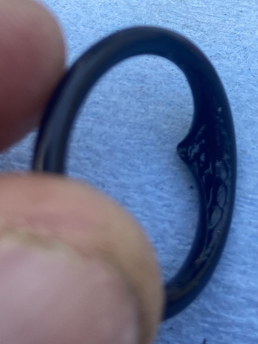

After a little bit of research, this sounds like an "extrusion failure". I believe that the Viton o-ring that I used was too soft (probably 75A). At the very least, I probably need to use a harder o-ring (90A), but I also have discovered that "backup rings" and "face seal o-rings" exist. Still digging into possible options, but maybe someone might have seen this problem and can offer the best solution.

OK, after watching the video, I see what's going on. This is a fitting problem and not a pump seal problem.
I have not had this happen with any of my metric (DIN) o-ring fittings. I have had problems with SAE ORB (O-ring boss) O-rings and back-up washers, but they work a little differently.
Does there seem to be excess clearance on the smooth part of the fitting where the O-ring seals? I mean clearance between the O-ring ID and the fitting.
You may have a poorly-made no-brand fitting. You might try a new fitting, or a thicker o-ring.

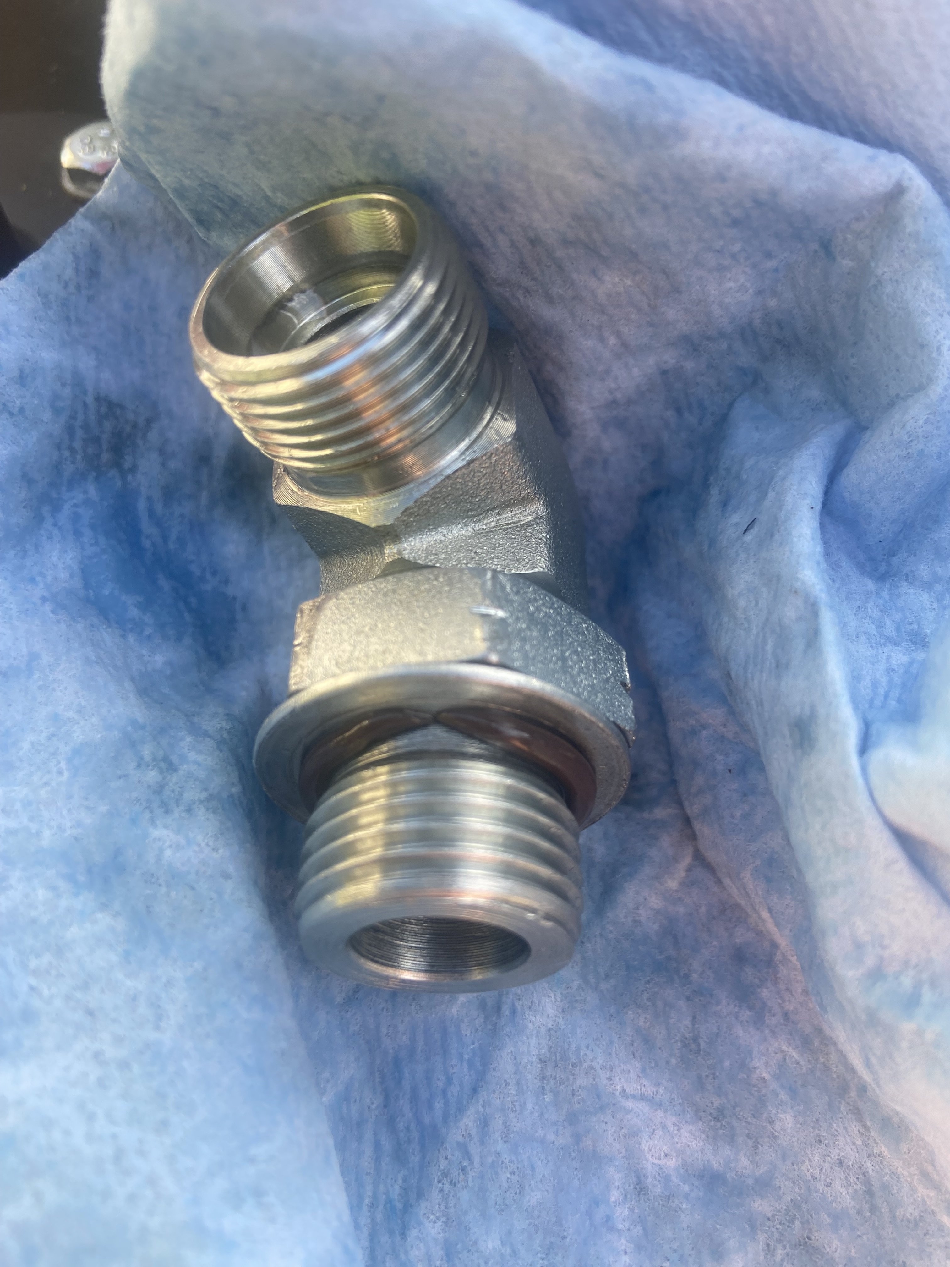

After more research, I believe that the pump outlet port fitting is DIN 3852-H (adjustable o-ring style); it has a locking nut, backup washer, and retaining ring. From that, I think a DIN 3869 profile ring (aka "D-rings") might be the best solution, particularly since the backup washer does not fit snugly on the fitting shank. The two o-rings that I installed have both been extruded through that gap between the backup washer and the fitting. The D-Ring profile has a flat top and outer radius; those surfaces would seat flush against the backup washer and retaining ring, respectively.
Assuming that analysis is correct, it looks like there are plenty of suppliers that provide these in Viton/FKM. But to pick the right one, I need to tear the machine down again and measure the fitting's OD and the washer's ID and thickness. With luck, I can find a local hydraulic parts supplier with the one that I need in stock, so I don't have another weekend or two of machine downtime.
If I can't find a suitable D-ring locally, I will try to find a standard FKM o-ring with 90A hardness. If I can't find either, I might try to limp along with another FKM o-ring (probably 70A) from the kit that I have on hand. Otherwise, I will be stuck waiting for suitable parts to be delivered.
Just looking at the spare metric O-ring fittings I have, and the DHH catalog, it seems the fittings that need to be "clocked" have to have a backup washer in addition to the retaining ring. So, in comparing a straight fitting to a 90-degree fitting (e.g. 6068 vs. 6069), the straight one has no backup washer.
All my spare fittings have a snug 0-ring.

I just went out and pulled the fitting to measure the seal dimensions. This time, I brought my camera and took a photo of the failed ring in the fitting. You can see from the picture of that the O-ring was pushed between the gap between the backing washer and fitting. Again.
Based on some quick measurements with my calipers, the fitting OD is ~18.12mm, the retaining ring ID is ~23.6mm, and the retaining ring thickness is ~1.75mm. Based on those measurements, I’m thinking an 18.5mm ID o-ring with 2.0 (or 2.4?) mm cross-section will compress properly and fill the space.
I just checked discount hydraulic hose, and it looks like this fitting is a 5069L? Viewing the various sizes available made me realize that I forgot to measure the thread pitch while I had it off the machine. Guessing it is M22x1.5?
