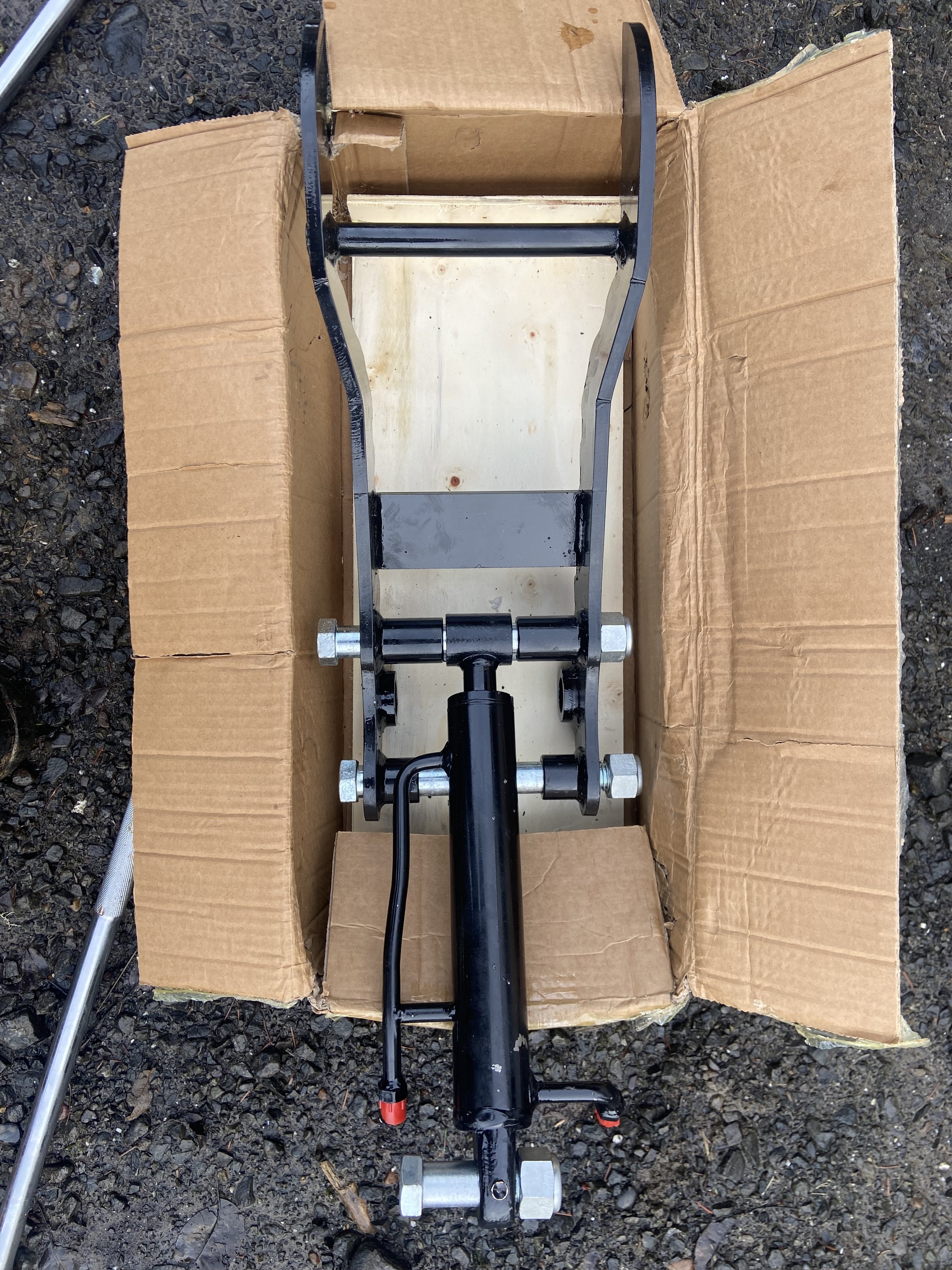

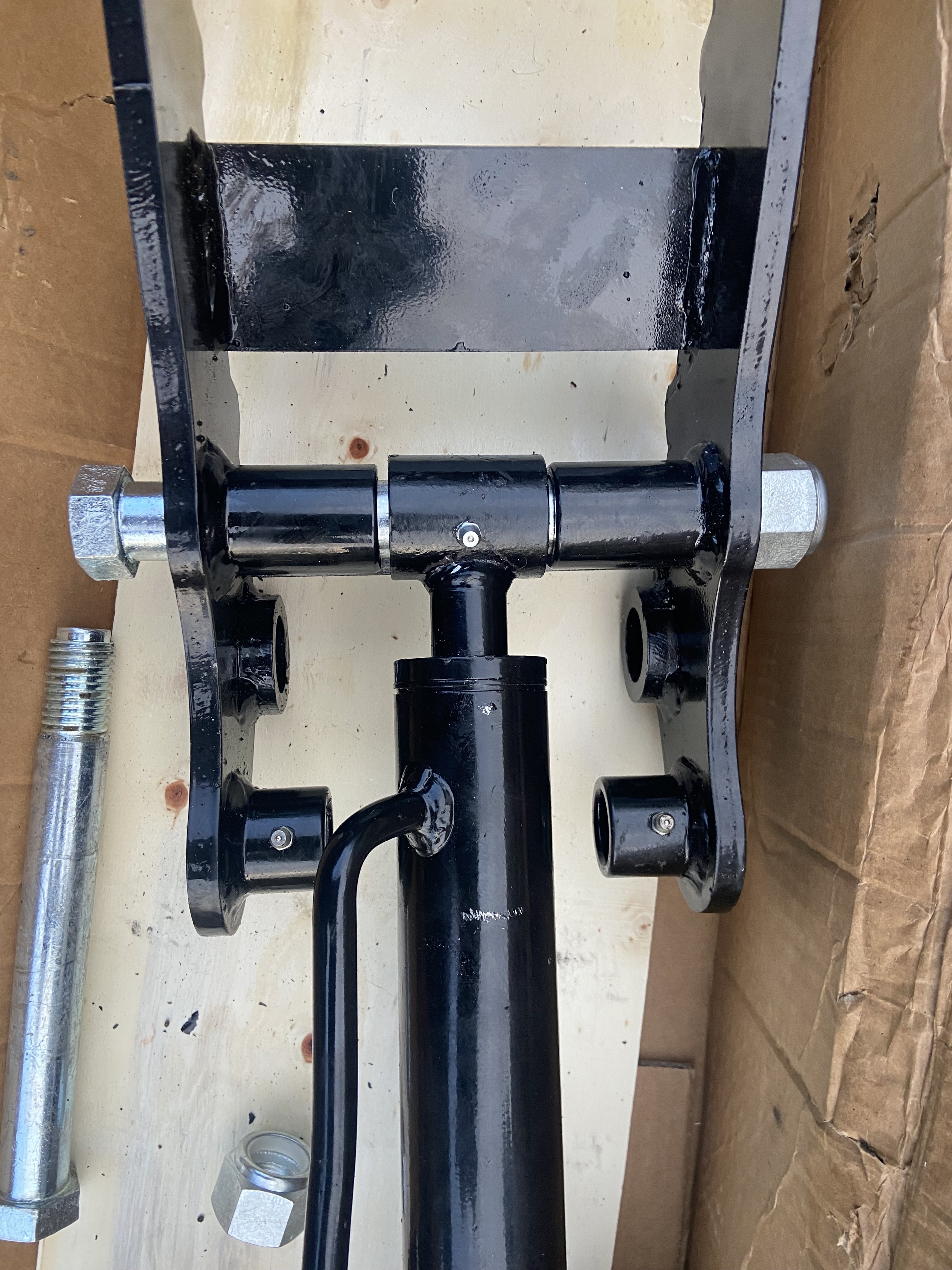

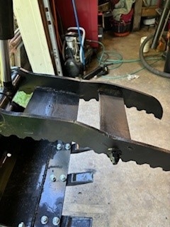

Here are links for the parts that I have purchased, though only the thumb has been delivered and installed at the time of this writing:
  1. Hydraulic thumb - Many identical/similar units available from a variety of sellers, all likely produced at the same factory/factories. The cylinder looks nearly identical to the ones already on my machine, down to the needle grease fitting.

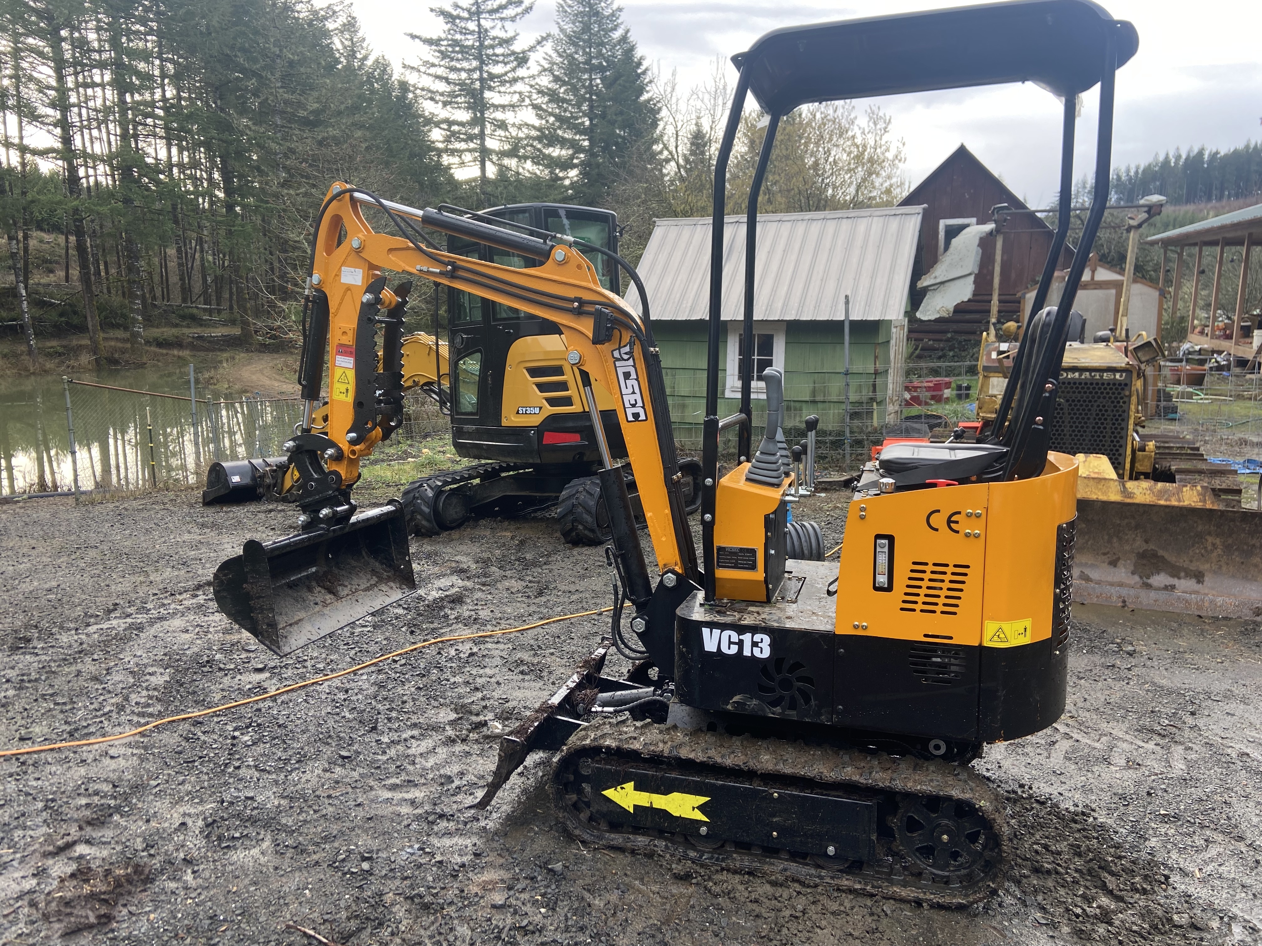

I have not finished installing the aux kit or new tachometer, opting to get out and work on some projects instead. Gotta make hay while the sun is shining.
First, I created a new landing for a pair of claw foot tubs overlooking one of our ponds; these will be turned into wood-burning "hillbilly hot tubs". For entertainment, I started this project with my Sany SY35U excavator, but it was far too big and clumsy. My mini finished the job efficiently and helped compact the loose fill afterward.
Next, I cleaned out our dairy cow shelter which had accumulated ~3ft of deep bedding in places. Here, the Sany can barely fit its arm under the structure's roof, so it was always a challenge to get clean. There were always spots that had to be mucked by hand. By contrast. the mini can drive around under it and reach every nook and cranny. While it took several hours to clean everything out, it still was much easier than in the past. In the process, I learned that the big excavator is better for loading into my dump trailer; the mini can reach, but just barely. As a result, I ended up using the mini to create a pile outside the shelter, then I used the bigger machine to load the trailer.
Finally, I started to level out a couple of paths near the shelter, as the mini was able to squeeze between a fence and structure where the bigger machine could never reach. However, it was around this time that I noticed the hydraulic fluid level had dropped considerably. Upon examination, I found there is a small drip at the output of the hydraulic pump. While doing research about these machines, I found a video of someone who experienced the same problem while breaking in their machine. The root cause there was an o-ring that got crushed between the two washers that seal that fitting. Assuming the nut is not simply loose, I suspect that my machine might have the same problem, but I will need to remove the side panel to find out. Two steps forward, one step back.
Despite that minor set back, I remain quite happy with the machine. It's got plenty of digging power, but I did notice that it's fairly easy to stall the travel motors. For that, I probably need to perform a pressure test and adjust the main RV, so that task now has floated up my priority list a few notches.

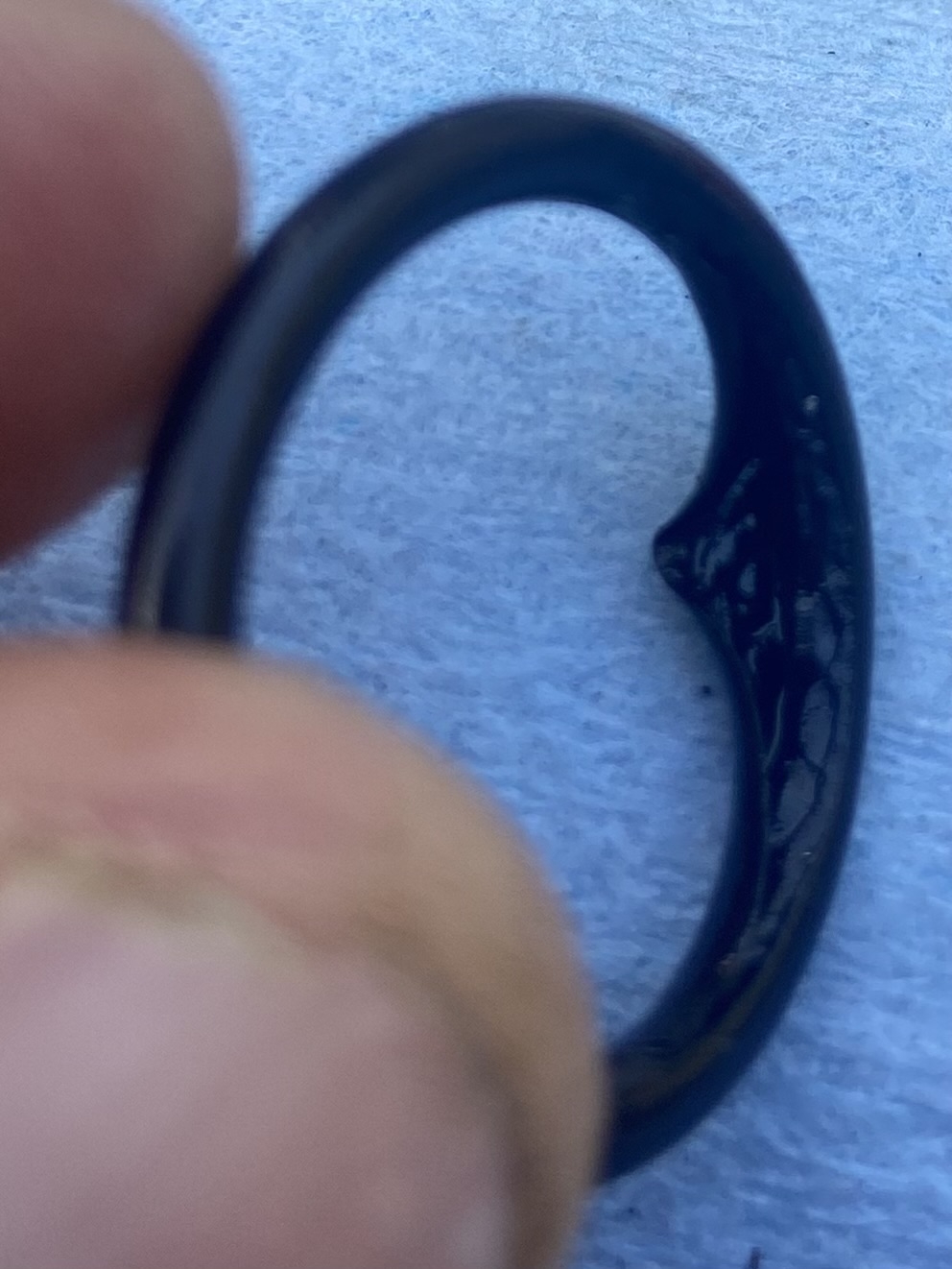

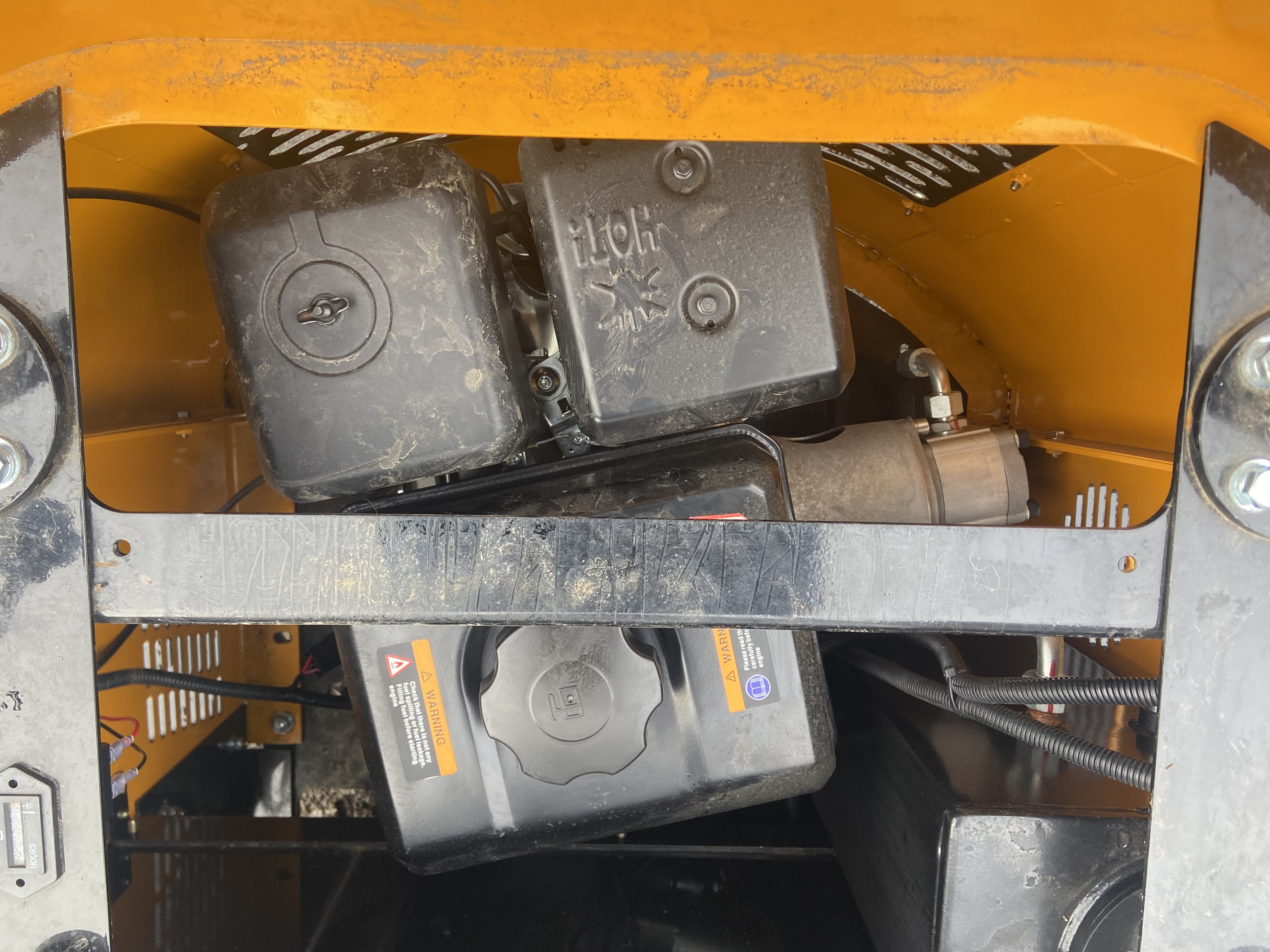

I tore down the machine today to investigate this issue. As the attached picture shows, the o-ring had indeed failed. From what I can see, it looks like this part was not made of solid material, but rather has a core with a skin. After replacing with a new one, that fitting no longer leaks, but I’ll be keeping an eye on it.

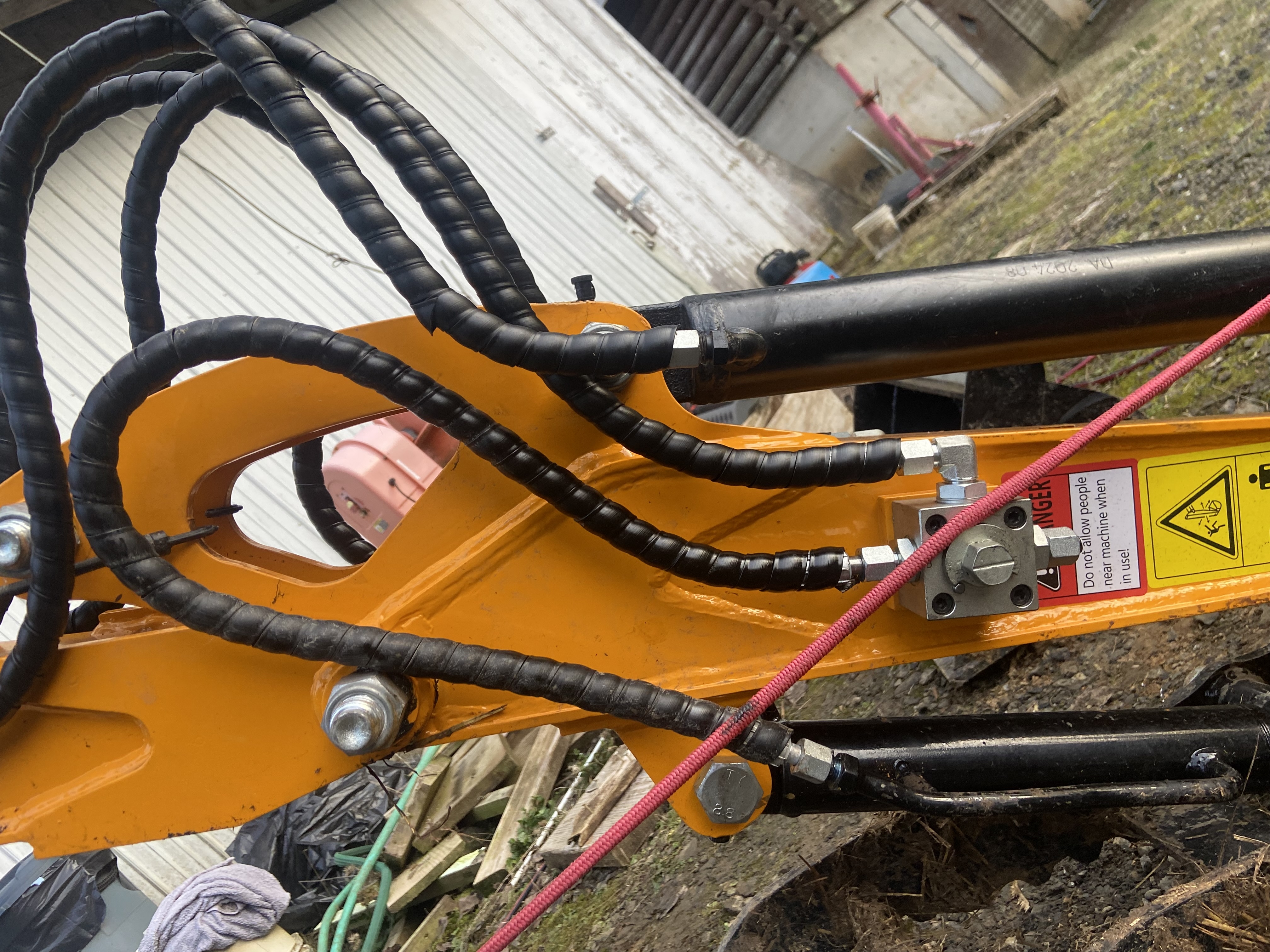

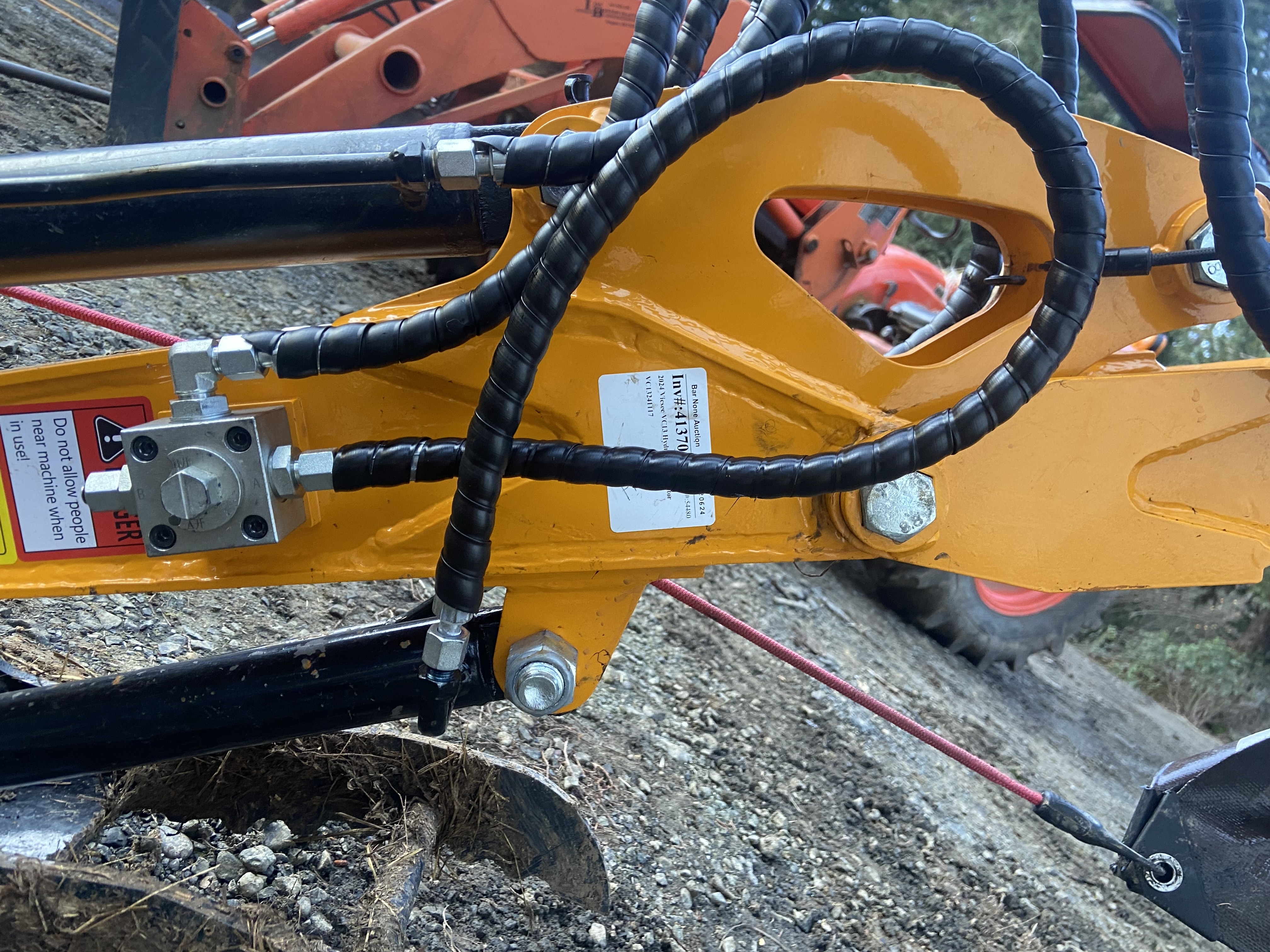

I also got around to installing the aux A/B valves today. I plugged the spare valve ports with the caps that originally came with the machine, both to keep dirt out as well as in case the valves get turned by accident.
While I was at it, I finished wrapping all of the hoses that go to the stick. For the record, 10 meters was not nearly enough to do the entire machine. I have less than 2 meters left and a half dozen hoses on the boom left to cover, so I will have another 10m on the way shortly.

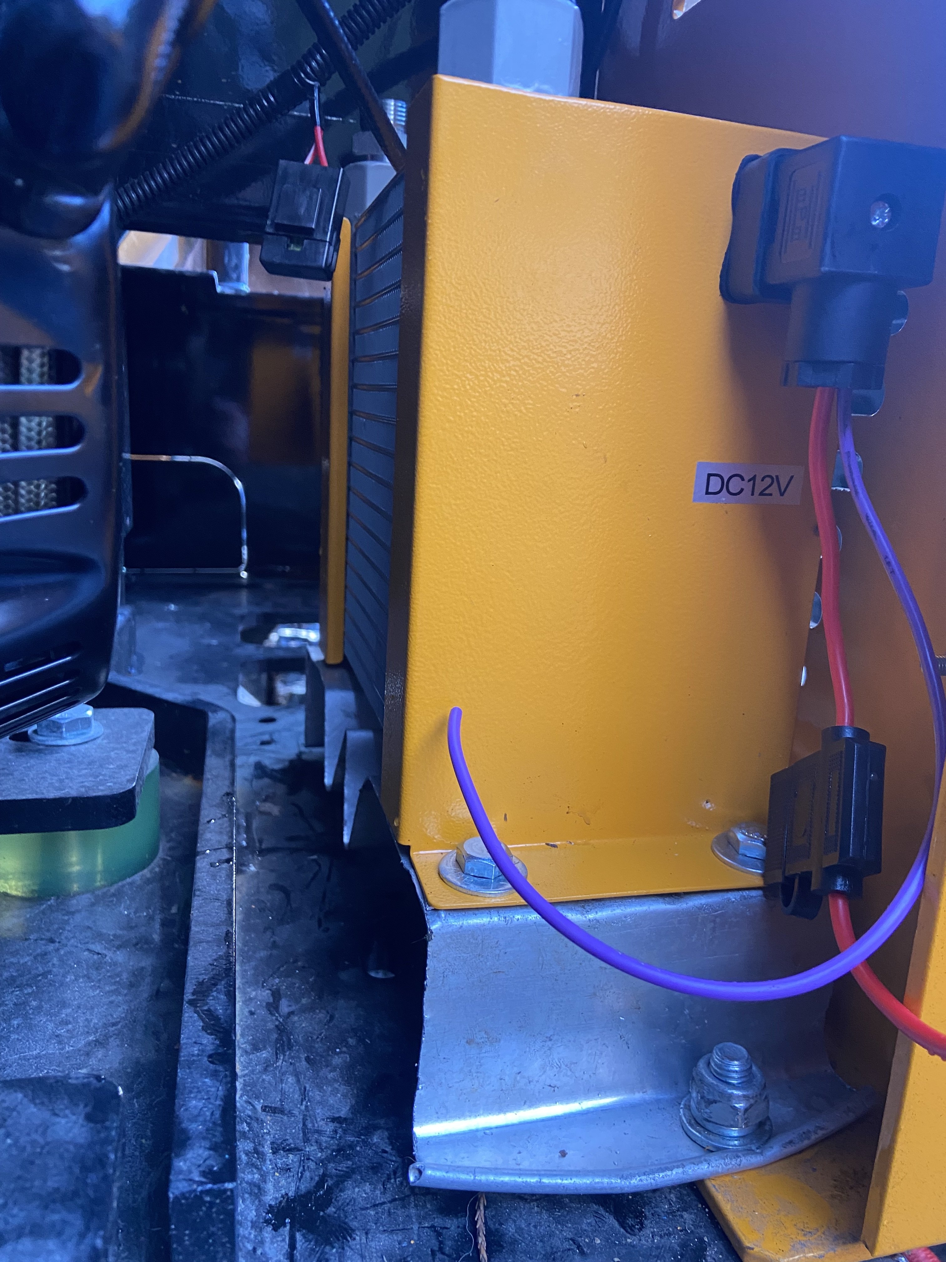

Since I’m posting pictures, I have also included a photo of my installed hydraulic cooler mount (prior to the hoses/power being connected). Seems to be holding up well enough after 10 hours, so I am declaring that one a solid win.
