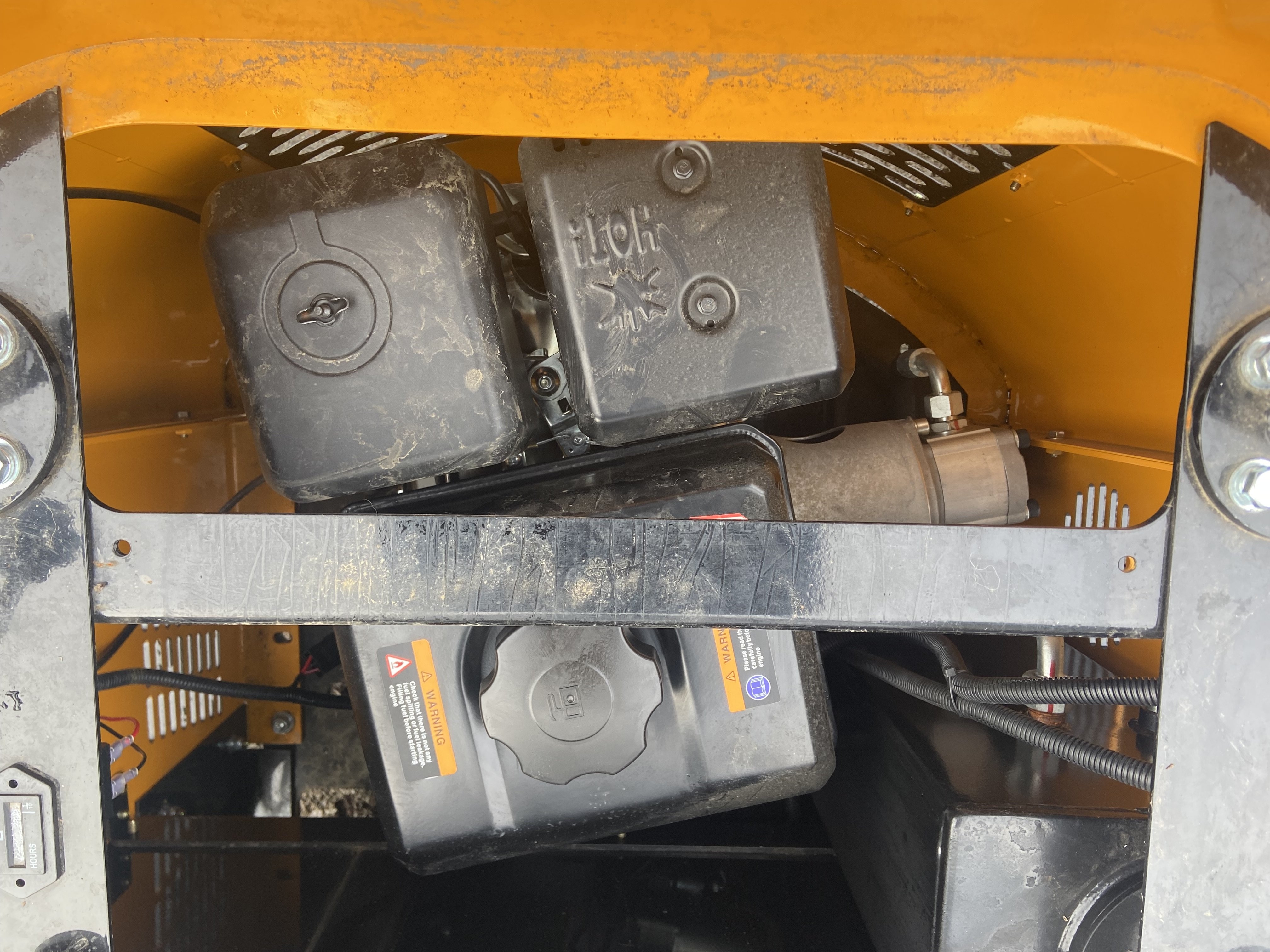

I have a digital endoscopic camera that I will use to inspect the tank. These cameras are inexpensive on Aliexpress (~$5), so I have dedicated one for checking my machines. It's great for looking in tight spots, and that describes a large percentage of their innards.

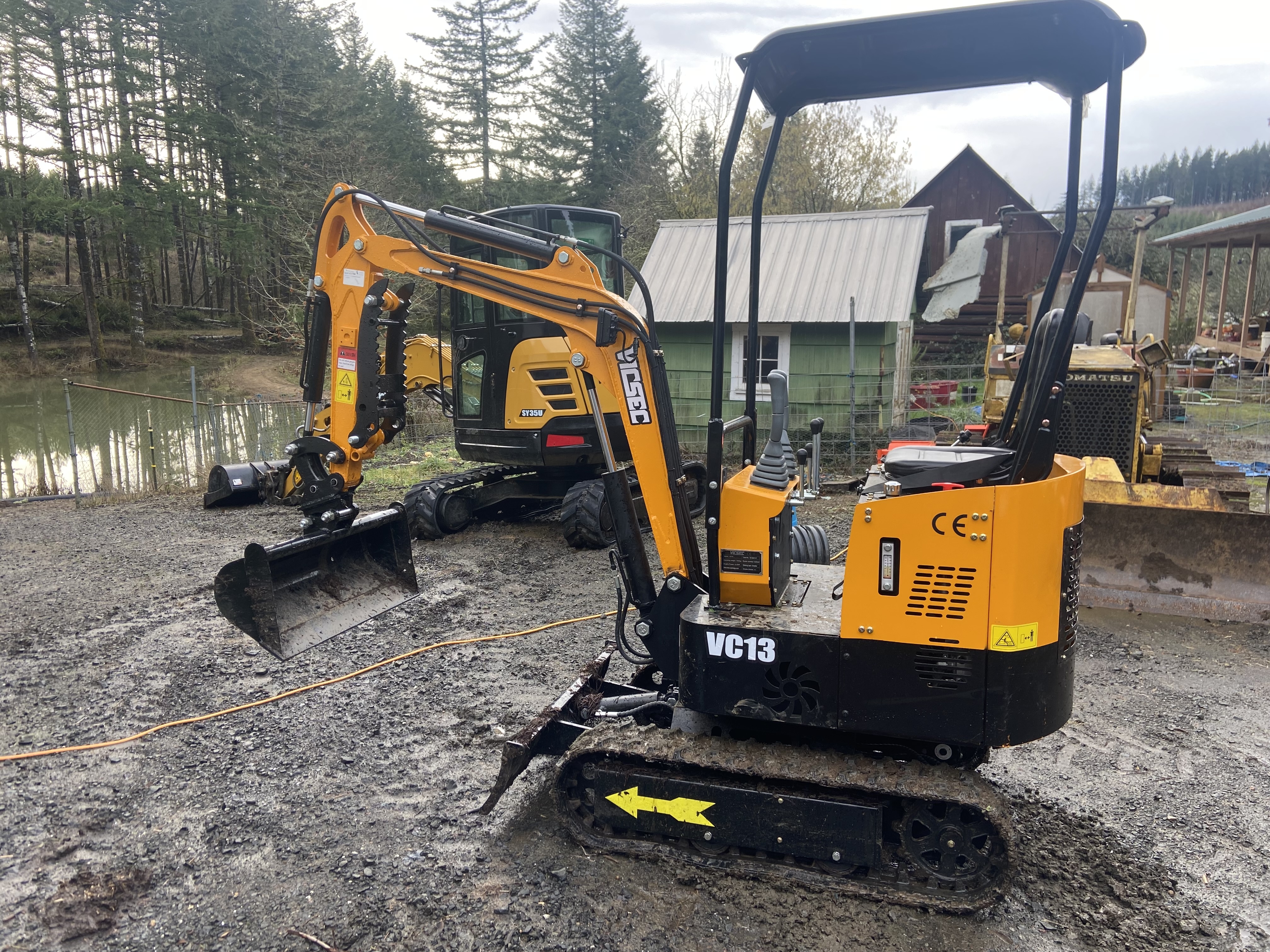

Post some pictures of your new digger and also some of your larger ones. My neighbor has the Komatsu D21 dozer 1300 hrs - its a very nice machine great for grading and small enough to tow with a pickup.

I had a chance to get out on my machine today and get some work done. The pictures that I took (coming shortly) aren't the best to show it off, but they do show why I chose to buy a smaller machine. Plus, I will be out less than $6K for the machine and attachments, even after all of the upgrades that I listed above. A bigger or better machine would have been beyond my current cash-only budget, and it probably would not have fit where I need it to go.

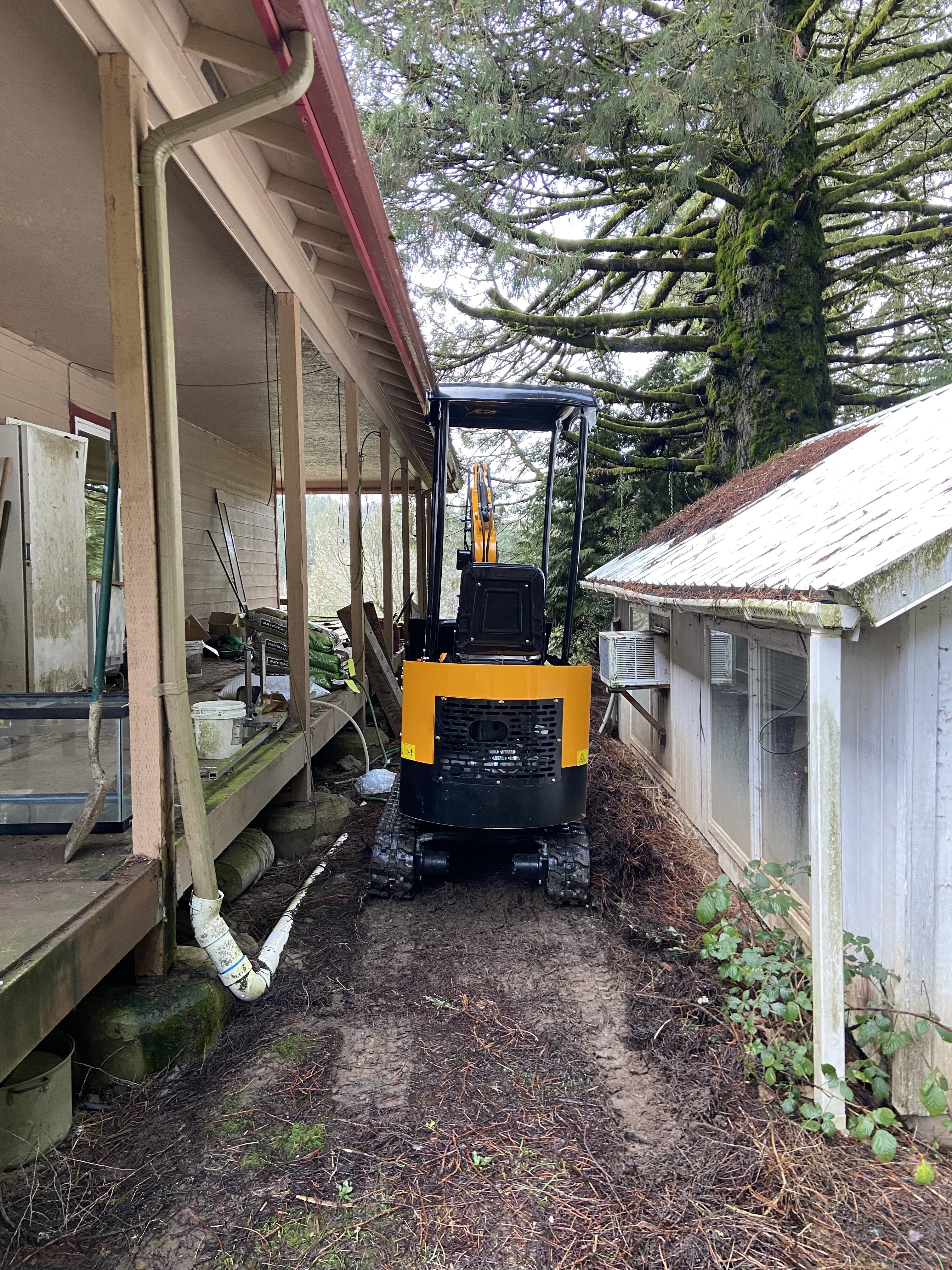

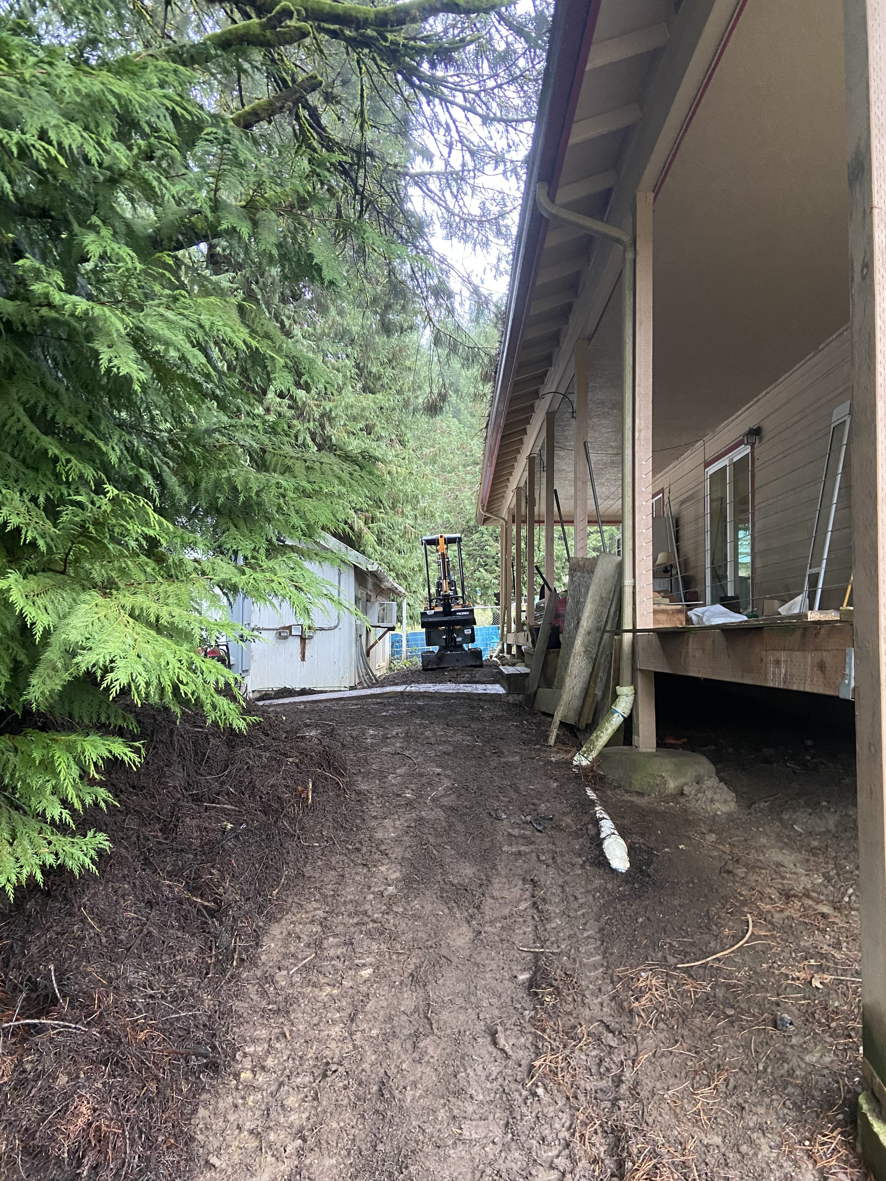

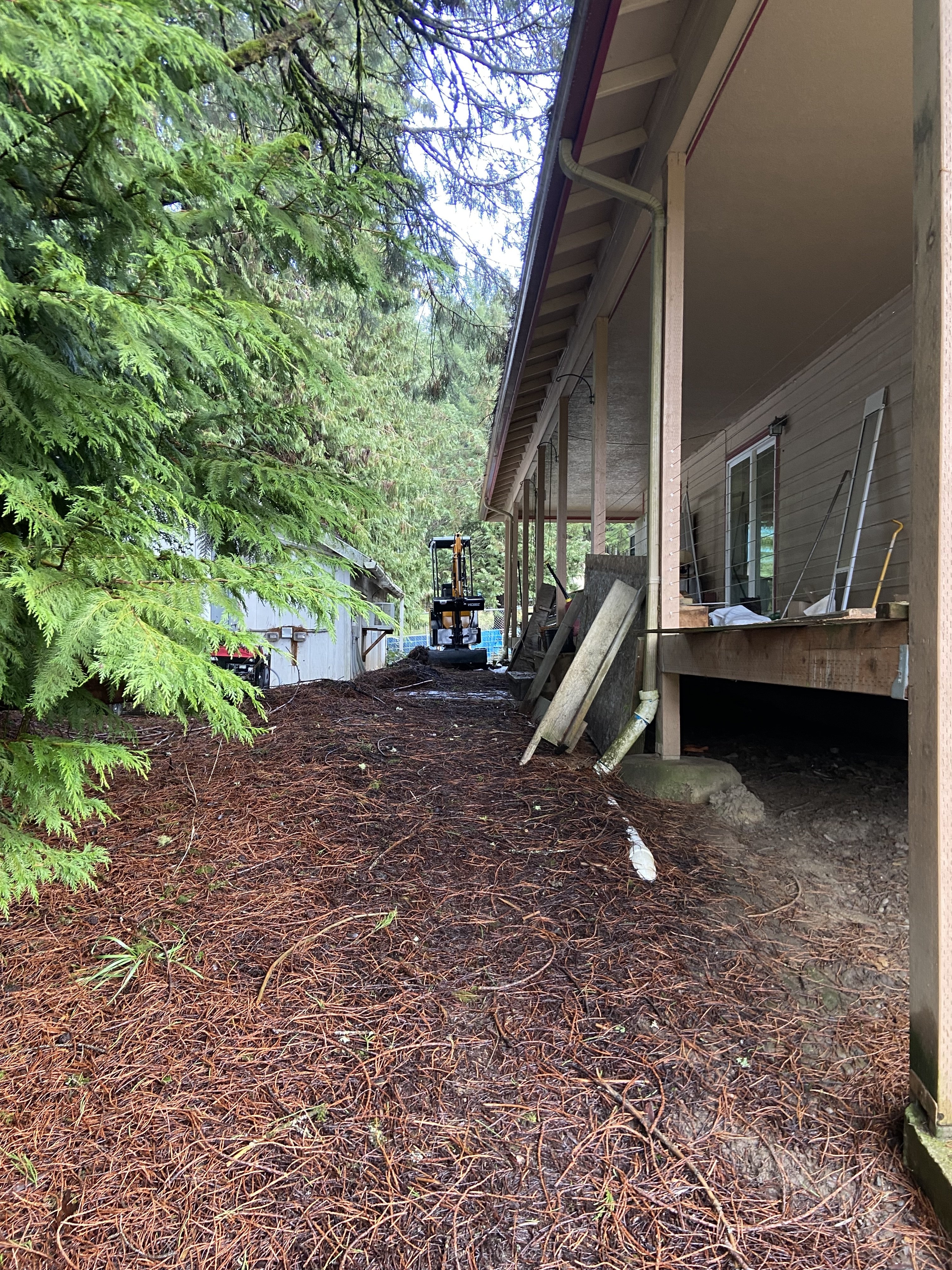

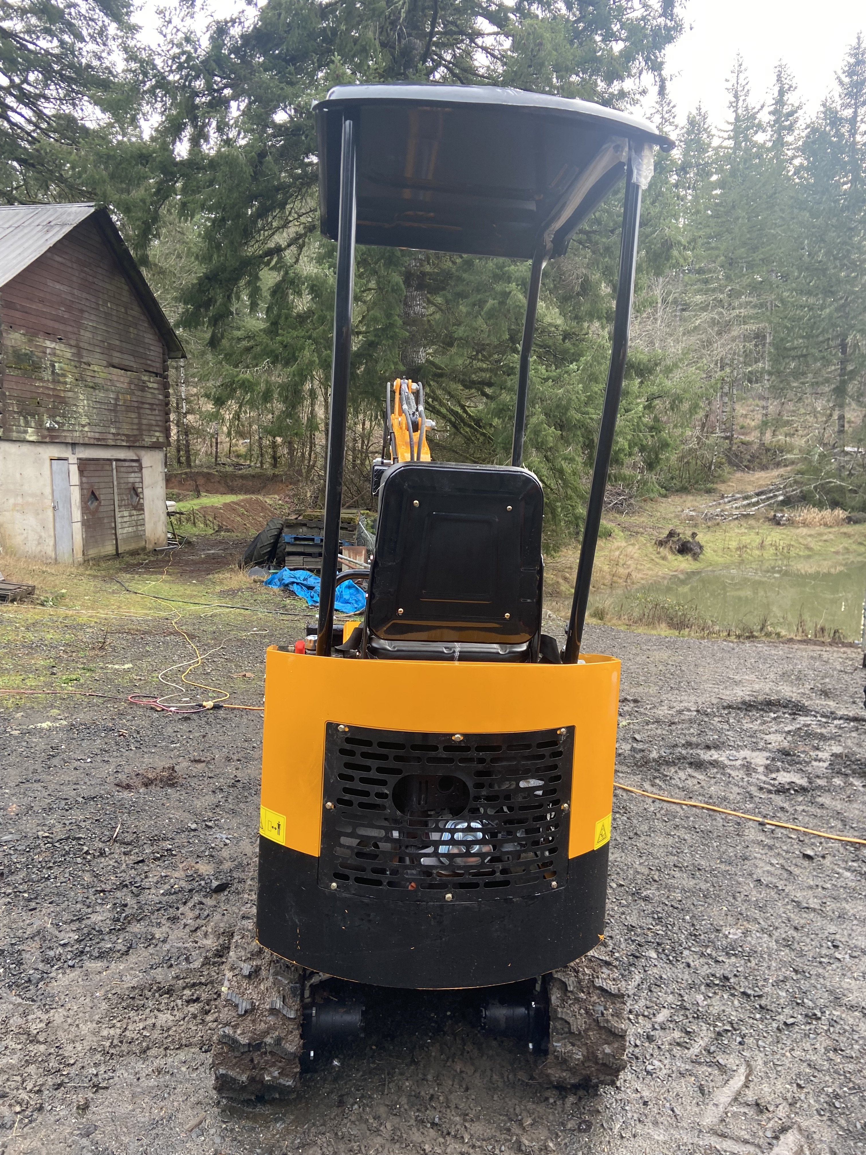

For my mini’s first feat, I cleaned up the sequoia and cedar needles that fall between my house and adjacent cottage. You can see there isn’t much clearance, but I was able to get everything pushed into a pile. I did manually rake along the cottage, but that was nothing compared to the amount of sweat and cursing that were usually involved by doing this all by hand each year.

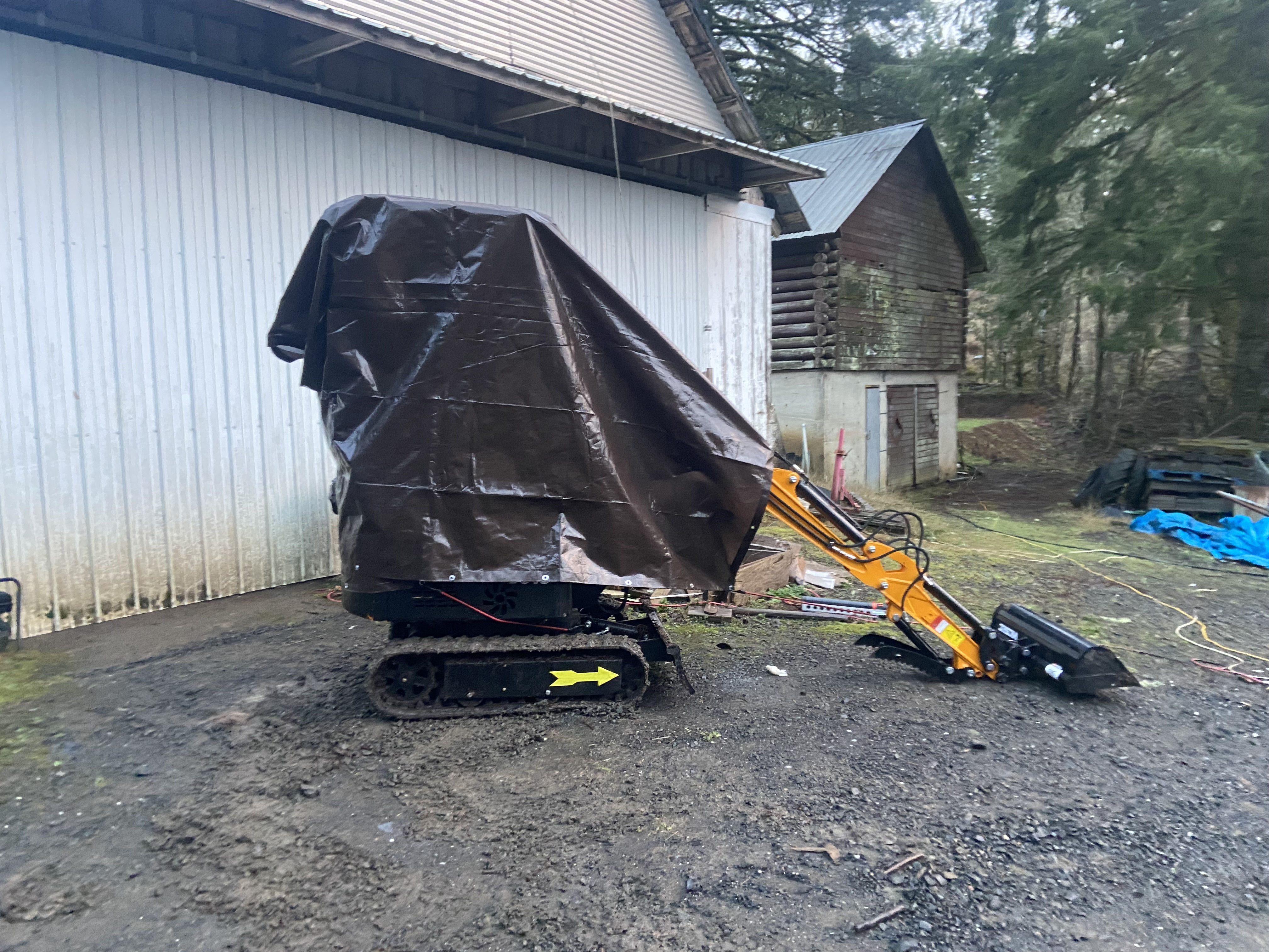

Performance wise, the machine ran great with the throttle set at 50%. Of course, raking up needles with the cleanup bucket wasn't exactly pushing its hydraulics to their limits, but the lower throttle setting did make it easier to get smooth motion out of the controls. It's definitely more jerky than my Sany SY35U, but that machine cost 10x as much as this one. At any rate, I can see why new operators would complain about jerkiness, but I proved to myself today that it's entirely usable for precision work if one is careful.
On the side of the machine, the hydraulic tank has a window with a thermometer that doubles as a fluid level gauge. With an ambient temperature of around 50°F (10°C), the hydraulic oil temperature ranged between 120°F and 140°F (50°C–60°C). That seems like a reasonable range, but I expect that the mercury would climb much higher on a hot summer day (or if I ran the engine at full throttle). The cooling fans and hydraulic oil cooler will be high on my priority list.
I also noticed that the machine will roll forward slowly on its own when sitting on a very minor slope. I plan to conduct some experiments to better characterize this behavior, but I know that these final drive motors do not have brake valves. In that regard, this very well could be the expected behavior for this machine, but I'm glad that I noticed this quirk before it put me in a potentially dangerous situation.

Not sure why the need for a New Thread but I wwilll assist in the "Gas Boil" issue
Take the EPA Guts out of the Gas Cap, Gas Boiling will be a thing of the past.

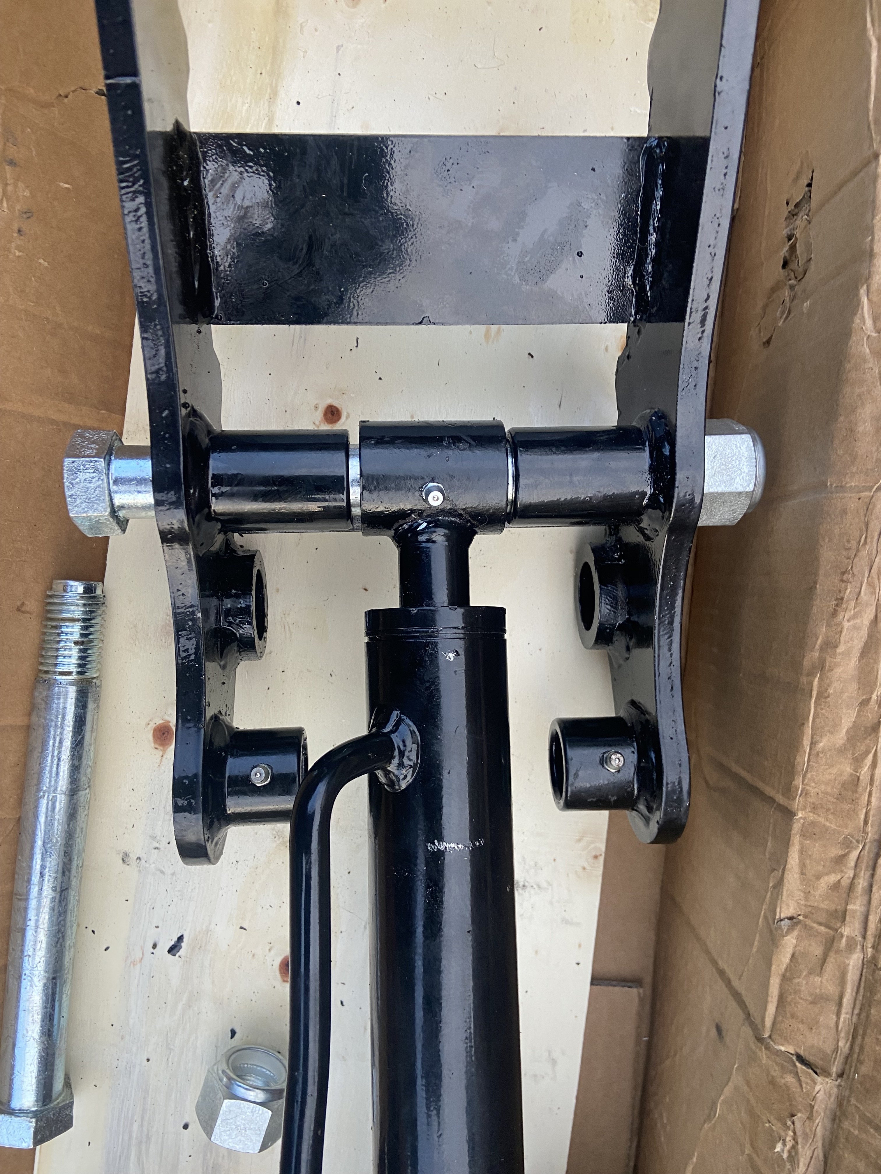

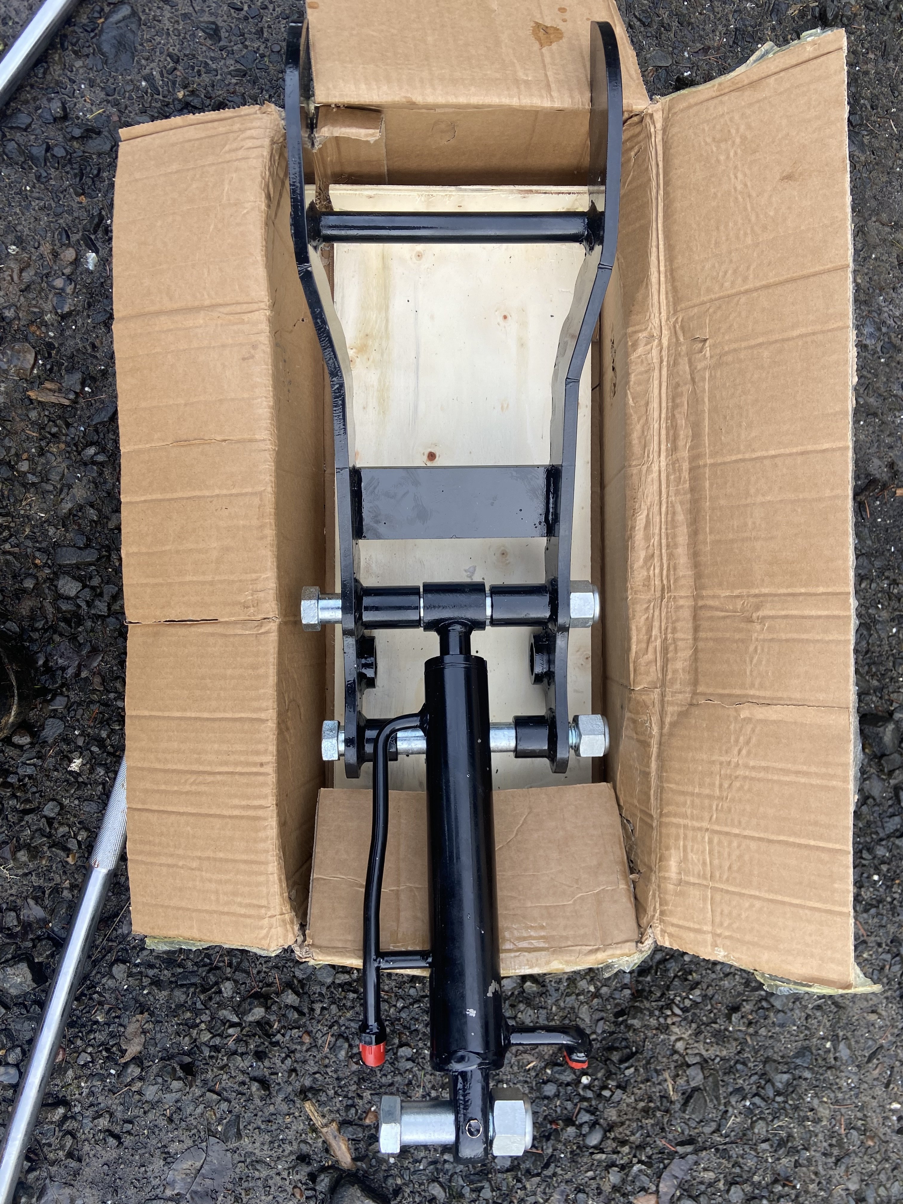

I managed to take a few photos of my machine today before/after installing its new hydraulic thumb. My Sany and Komatsu are in the background of the first. The last shows how I’m keeping it dry when not in use, until I can clear out some space in my garage (or I finish working on it and drive it down to the barn). The tarp works fine for now, but I will be much happier when it is parked under shelter.

As my last post indicated, the new hydraulic thumb arrived today, so I took some time to get that installed. It would have been a quick job, but there were no grease fittings in the cylinder rod eye and the thumb pivot points. Consequently, I spent a little time drilling and tapping ports for new zerk fittings. I also replaced the stock needle zerk with a normal zerk.
After I got everything mounted and plumbed on the machine, the new thumb worked perfectly… well, almost. While testing it, I noticed that the pivot pin rotated along with the thumb, so the new pivot point grease fittings are inadequate/ineffective. I will probably just go ahead and install one on the stick mount point where the pin does rotate, but I feel a little silly for failing to predict this outcome.

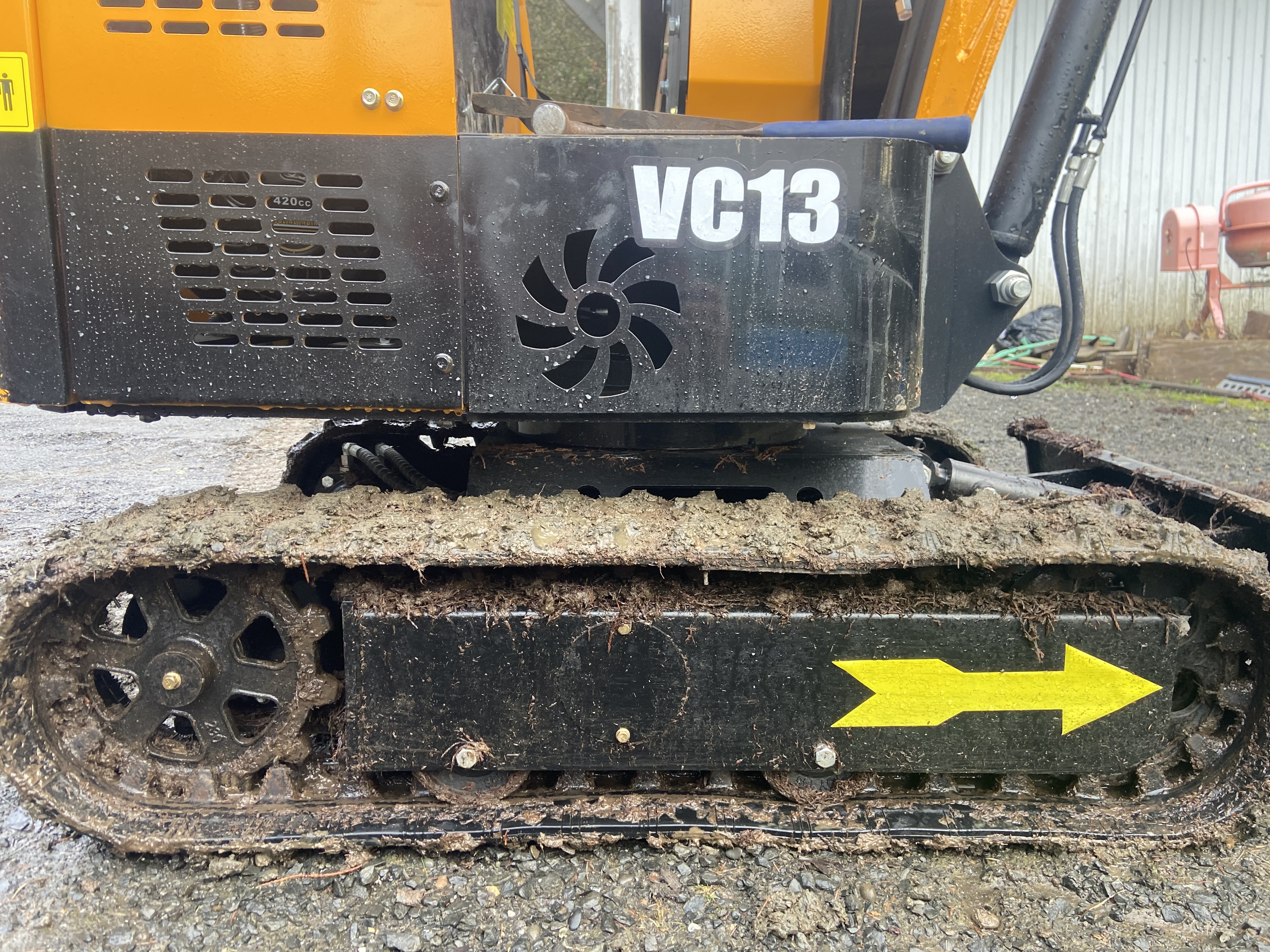

Sorta off topic but does this model come with splined shaft drive motors? You're going through with a fine-toothed comb and might have noticed. I noticed this on Miva labeled machines and the Vicsec look a lot like them. This was the reason I stopped bidding up the price on a Miva.
I posted a picture of one of the tracks. I can't see the drive shafts directly, but perhaps the picture is enough to infer? Otherwise, I am sure to throw or replace a track eventually, and I'll take a better look when that time comes.
/ Vicsec VC13 mini-excavator #17
I haven't seen one taken apart yet either.

Thanks for the pics - my machine had a similar thumb and we have a lot of rocks and boulders and the tines were flexing too much for my liking so added two pieces of 3/8" x 3" steel braces between the tines - but still allow for clearing the boom and mating to the bucket properly.
