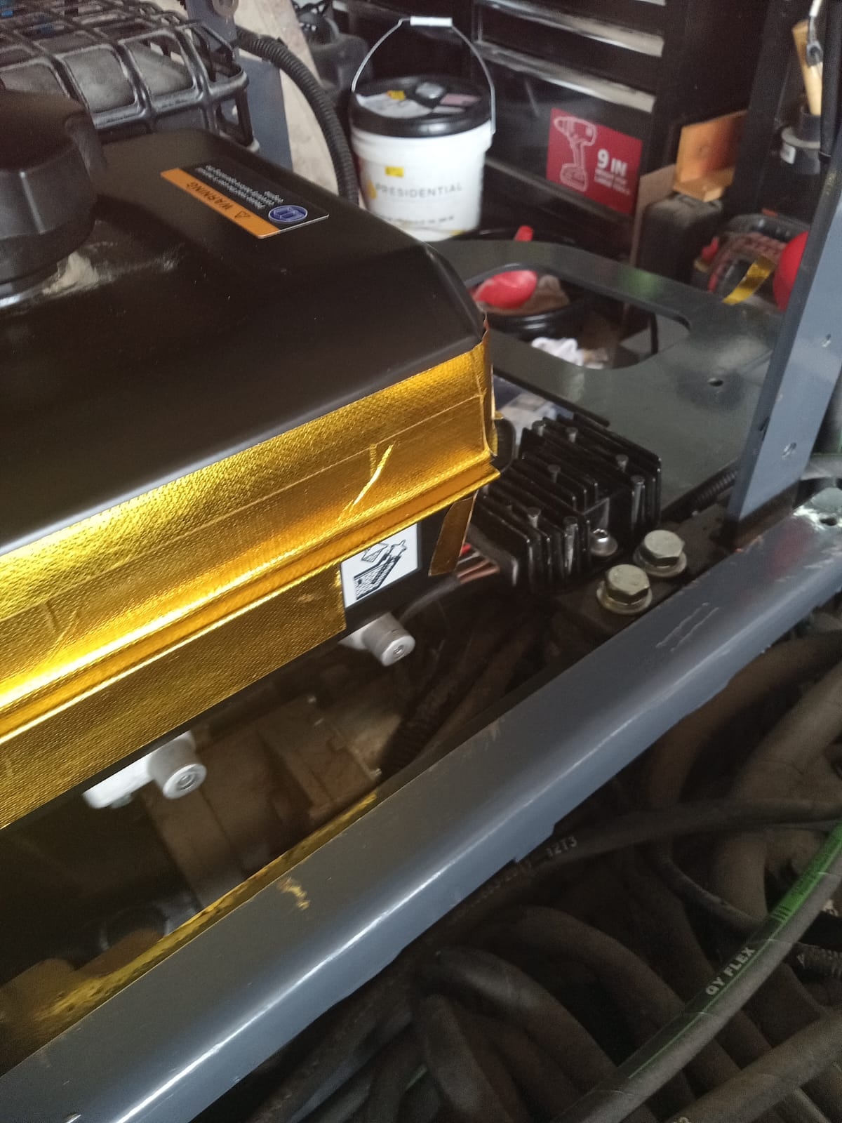

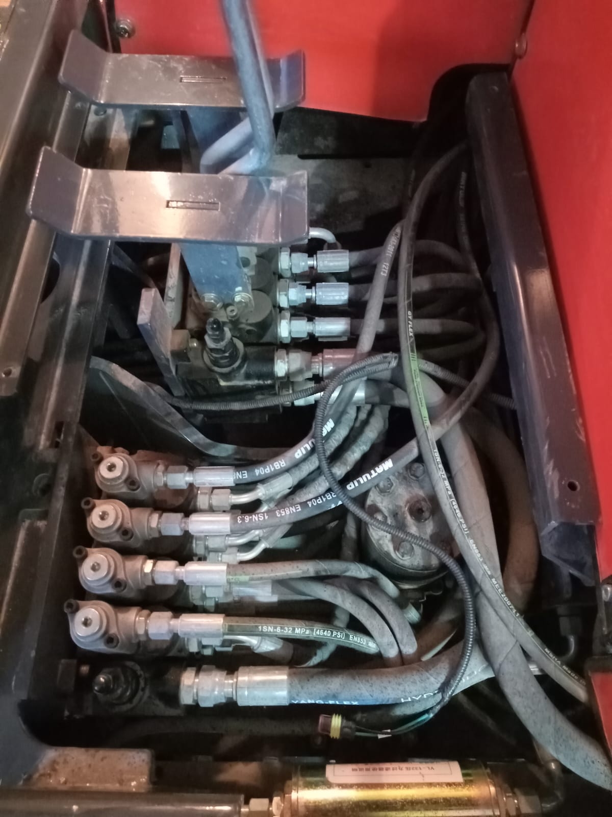

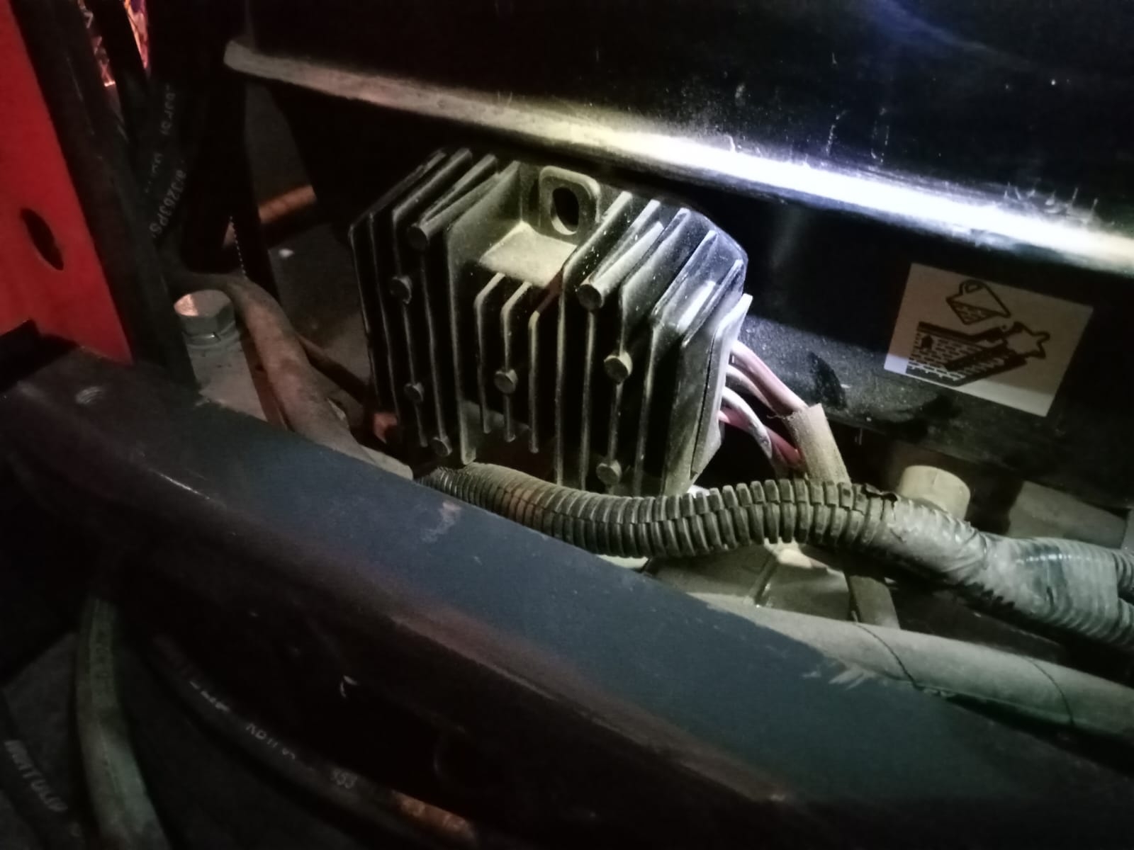

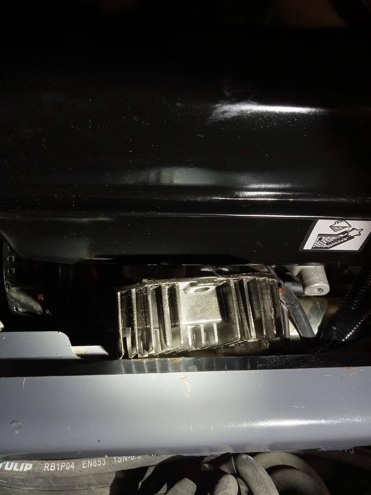

Hi Team,
I recently purchased an FF Industrial FF18R mini excavator from the auction, this is the model with the RATO 420cc engine. The unit has the pilot controls and I decided to remove all the panels ready for a complete check of fittings and a fluid change as most have advised with these Chinese units.
Please can anyone advise me if this location of what I believe is the voltage rectifier regulator, hanging loose on a small lug next to the bottom of the gas tank is safe ? it was only held in position by one hex cap screw which was not even threaded into the aluminum lug,just poked in ? I am now wondering if I will have to extend the wiring and relocate away from its present location which will be a frustrating exercise as I am no electrician.
Does anyone with an FF15 /FF18 running the RATO420cc engine know the correct location where it should be fitted in the engine bay ?
Has anyone installed a cooling fan in this FF Mini ?
Thanks in anticipation, ;)

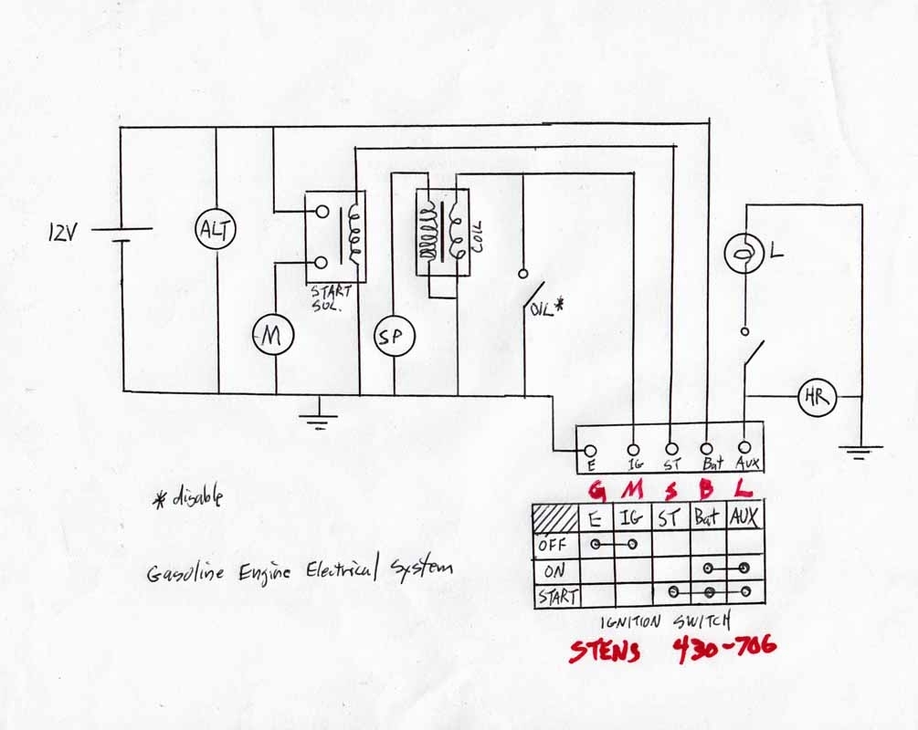

@dkrug posted this a while ago.

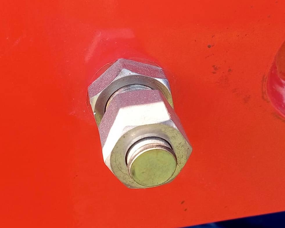

Would any one know the fitting size for an elbow for my FF18 hydraulic take off for a Thumb attachment which is in photo. Thanks ?
If you have not already secured your regulator/rectifier, it has vibrated loose from its mounting on the engine.
I like to relocate the Reg/Rect to the firewall of the machine. This avoids vibrating loose again, and it helps it stay cool.

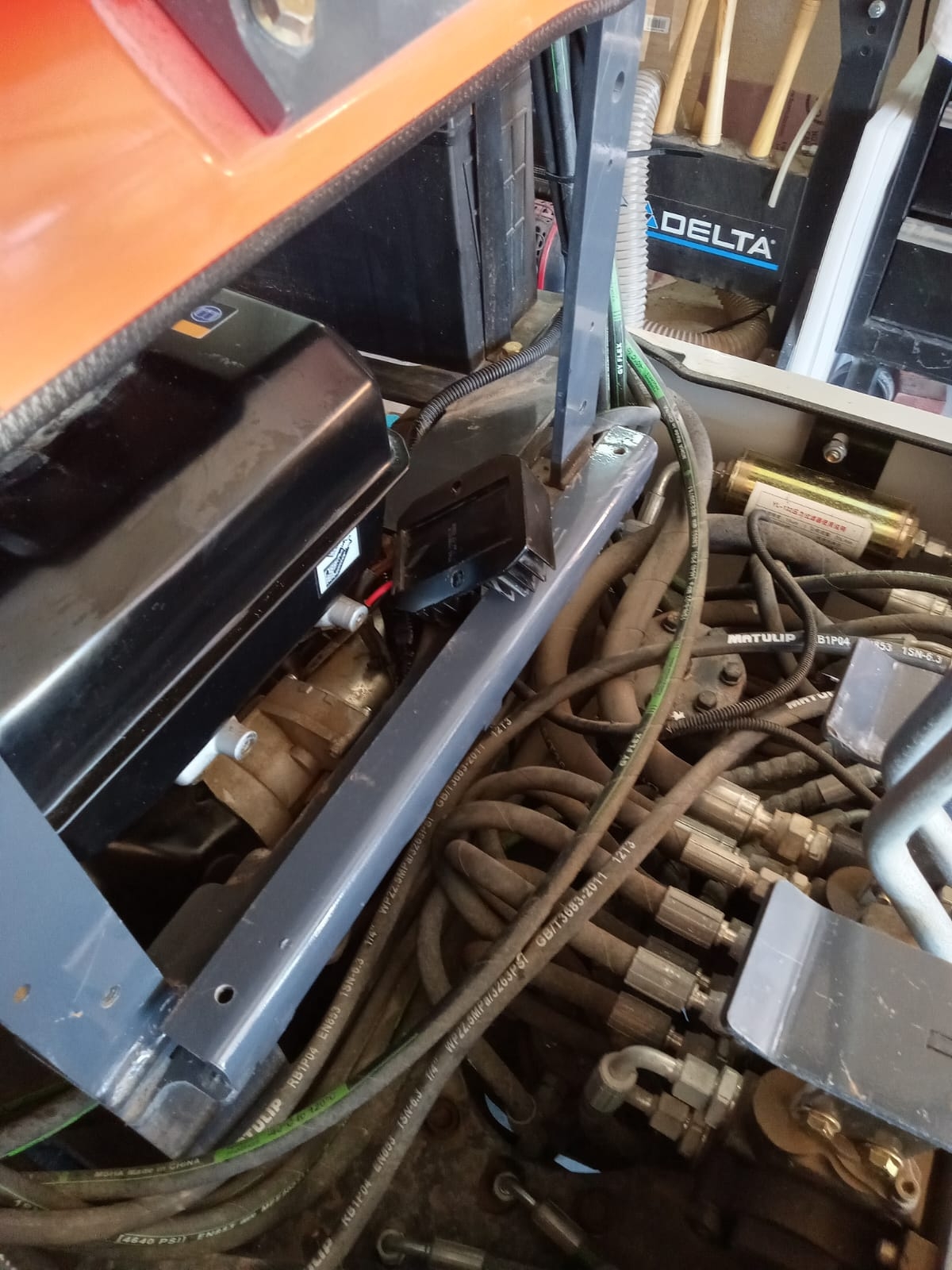

Thanks for your reply. I did end up relocating and securing onto the battery platform. , see photograph.
