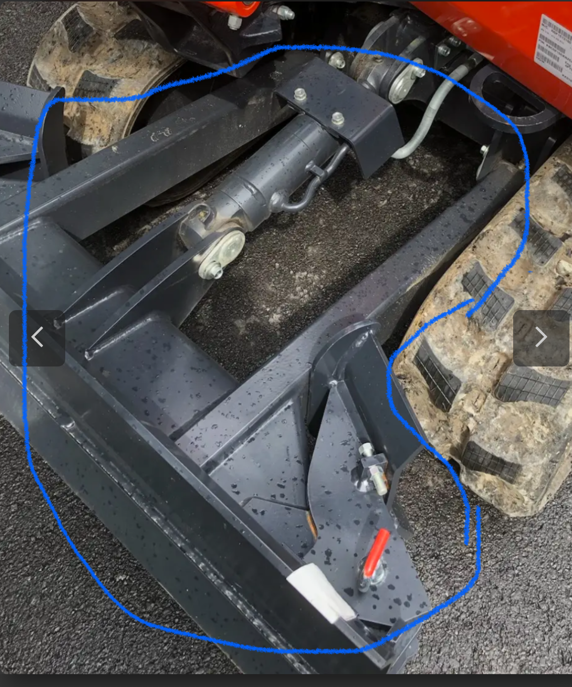

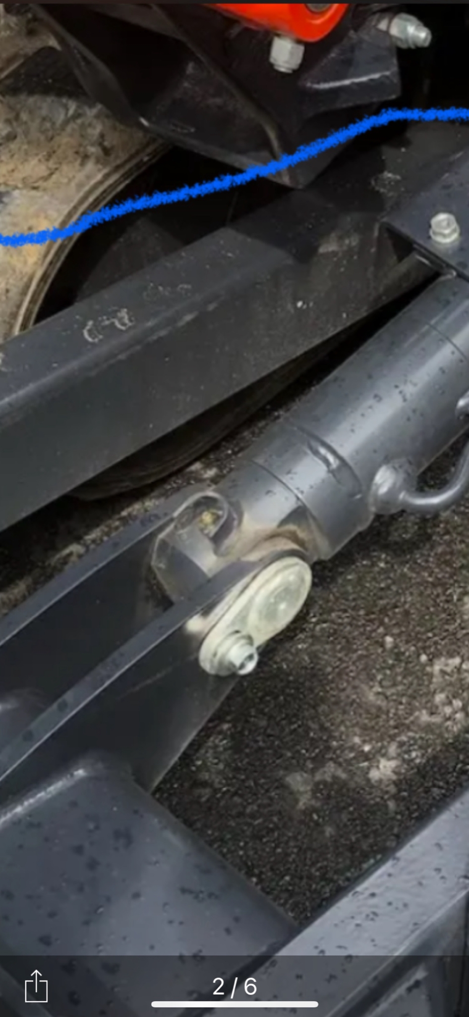

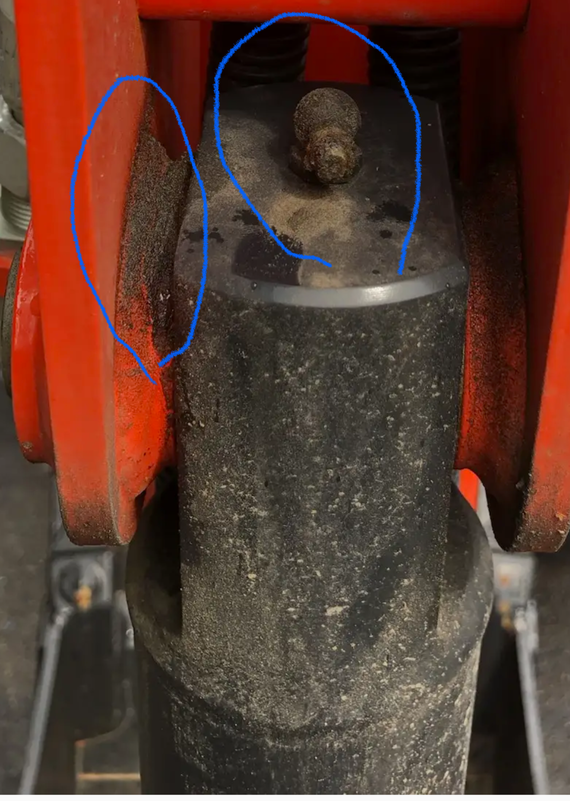

I’m wondering if the dealer didn’t get back that excavator from somebody with 7 hours of use, and had an issue with the plow assembly, and swapped it out with a new one?
Notice how the whole bolt-on plow assembly looks brand new , with …… no dust or dirt on it.🤔
Did I miss the “technical “ explanation from one of the equipment experts here, why the entire core machine is dirty and used looking, except for the bolt on plow assembly?
Contrast it to the boom cylinder, which to anyone unbiased, shows dirt patterns that develop with use, ..not from simply sitting
The blade has the same grease stains around the pivots and the folding wings have some rust around them. It doesn’t look out of place to me.

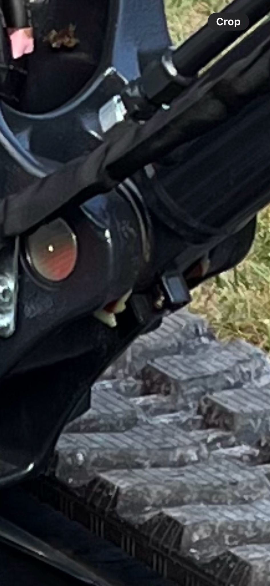

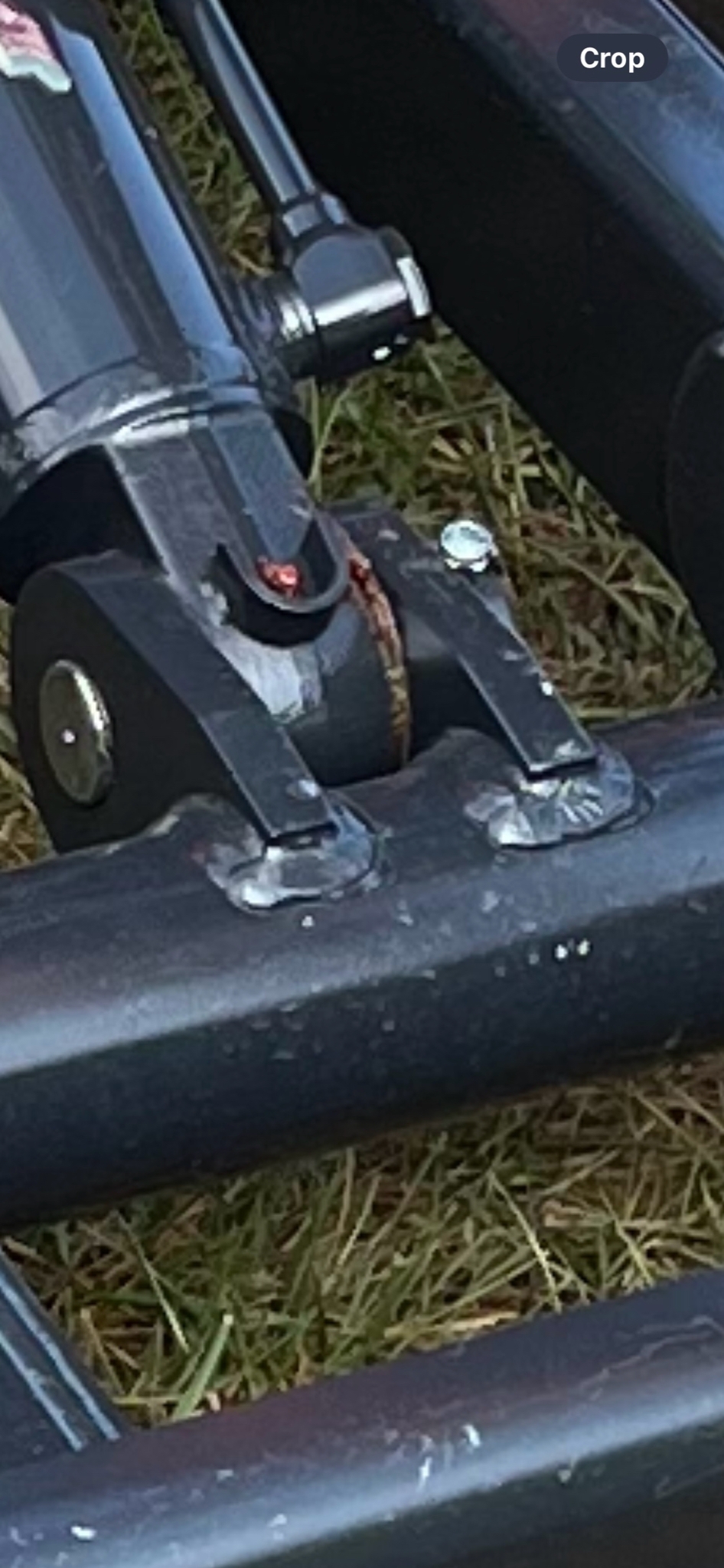

This is my 40 when it was new. Those pictures are timestamped August 29th last year, the same day I picked it up. Look at the grease around the pins. That’s not quite as bad as the op,s machine but let’s park it on a dusty lot and drive around it with a bunch of forklifts kicking up dust and see what happens. And for the 20th time I’m not defending the machine being dusty. The dealer should have washed it. I’m defending the idea that that machine is used. It’s clearly not.

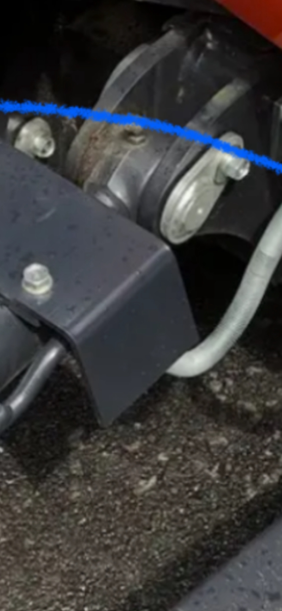

This looks like the same grease caked with dust stains on the blade to me. And while we’re inspecting the blade do you see any dents on the pins from driving them out and back in? Any scratches on the bolts from taking them out? Any paint chips on the hose guard where it’s slightly misaligned under the bolts? They would have had to take the hoses off to change the blade. Do you see any hydraulic oil statins on the blade? Either that’s the work of the most careful mechanic in history or that blade is original to the machine.
