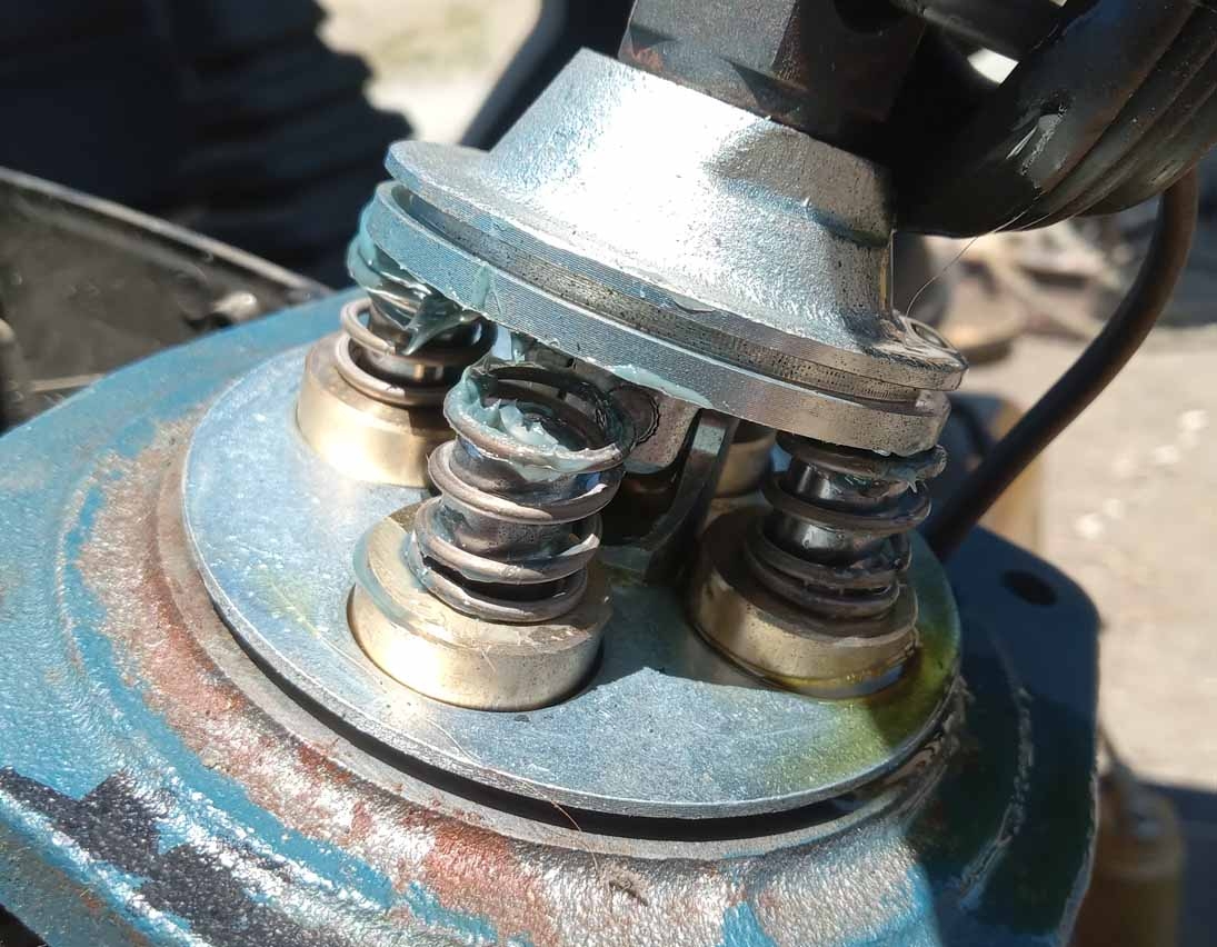

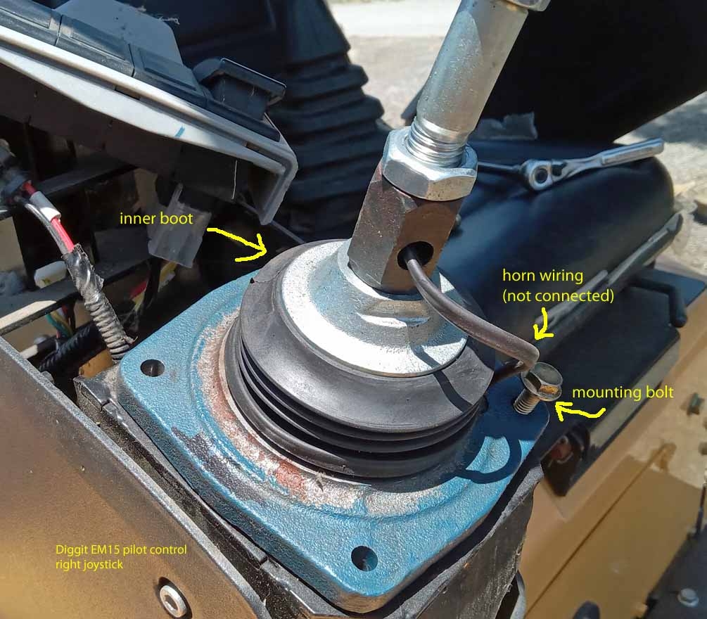

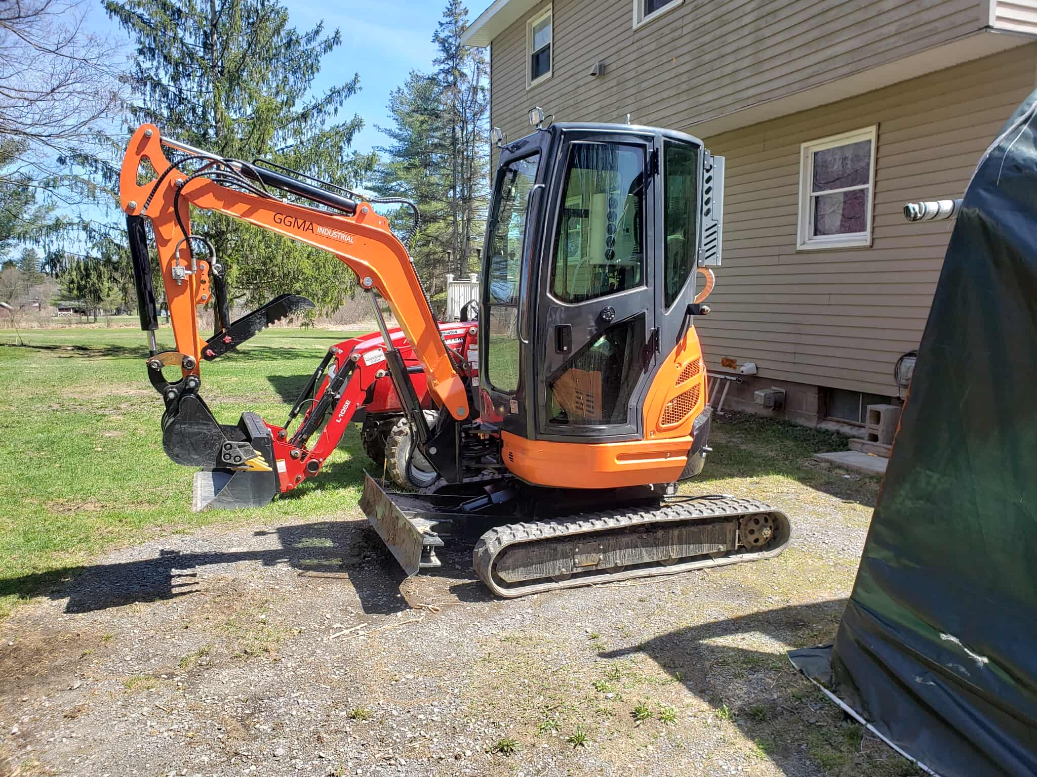

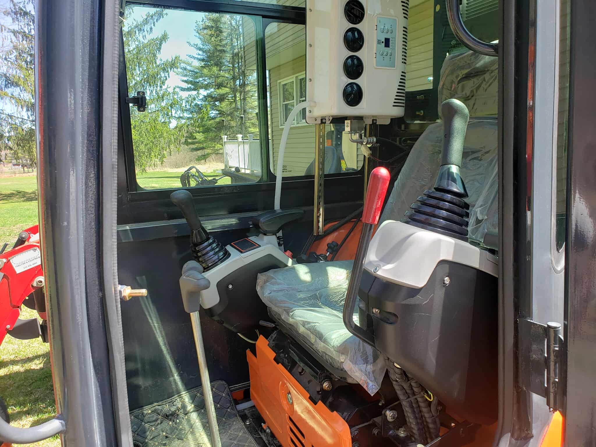

OK, James, I installed the springs into my friend's Diggit EM15, and we both like the improved feel. Adding more resistance to the the joystick motions is a plus. Worth trying, IMO.

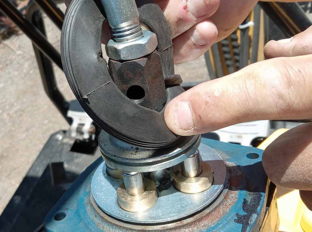

Here are some pix. The install is very easy, but there are issues with how this joystick is made. The inner boot has is too thick to fit in its upper groove, so it was loose. You can see damage where the installer tried to force it in. The outer boot really needs a plate to secure it, and keep the mounting bolts tight. There aren't even washers there.
The spools should be greased, and the inner U-joint needs some thick oil. That was done here (photo).
@dfkrug Awesome download form your GEN2 install on the Diggit EM15...thank you!!! I am seeing what you saw as far as install and boot configurations. My AGT has the main outer boot with plate PLUS an inner boot that pops on/off. My inner boot requires some extra attention where the wire crowds up tight to the lip...but it will slip on eventually. Curious what grease/oil do you like for the install? I ran with Super Lube O-Ring Silicone Grease. I steer people away from petroleum based. Thanks again! Your thorough and objective view of the mod means alot.

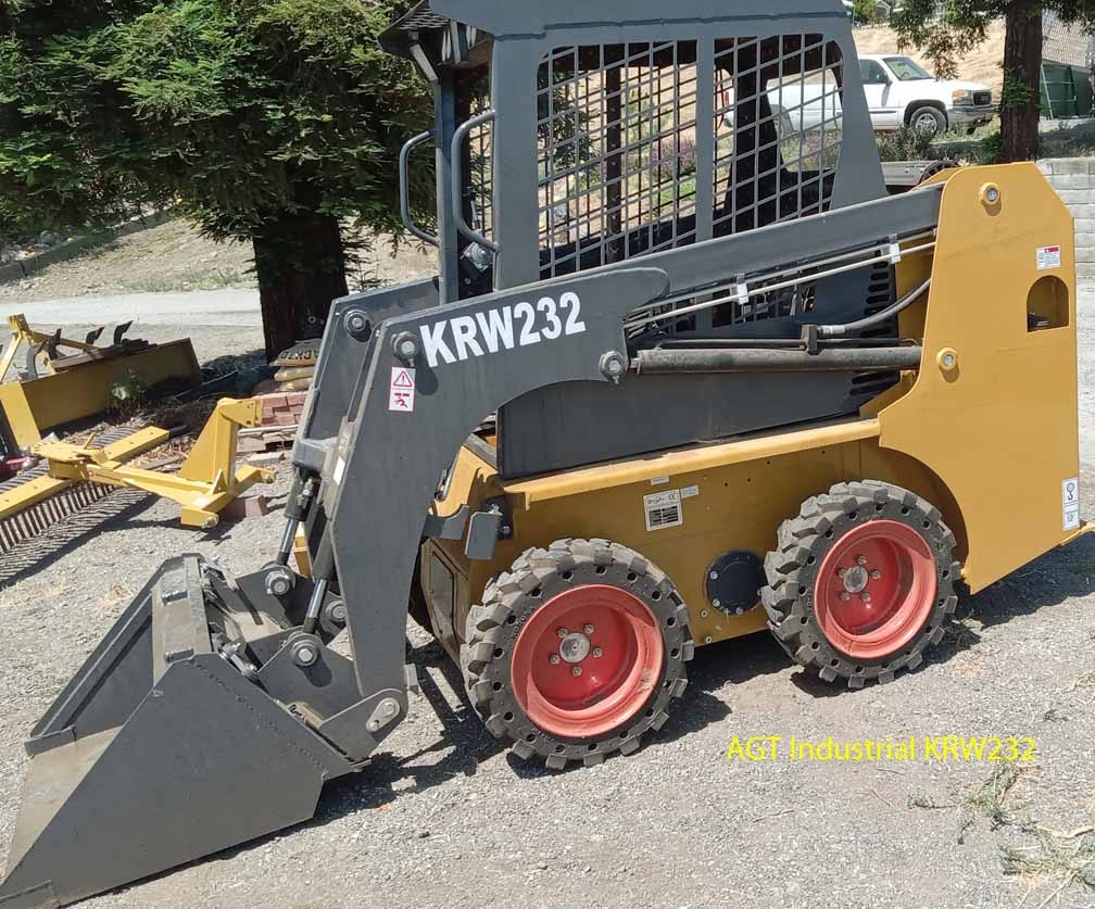

Here is another pilot control that needs help: an AGT Industrial KRW232 skidsteer. This joystick is slightly different than the above, with only one boot, and a different way of retaining it.
You can see the rubber lips and the plate that secures the boot, but it was loose. Greasing the spools is a must, IMO, plus keeping dirt out. We will put the GEN1 springs in there.
This skidsteer suffers from the same problem the 1T excavators have: they are so light that they are VERY jerky. This KRW232 is borderline unusable on pavement due to high traction and powerful hydraulics (V-twin gas engine).
It will be interesting to get your comparison feedback after installing the GEN1 into the KRW. I work with a dealer in New York who installs the kits pre-sale into his KRW/TK skid loaders for all the reasons you laid out. The owner likes the difference the kits make. Thanks!
The grease we used for the spools is the reddish lithium-based stuff in the grease gun. Silicone grease would be fine, too.
The oil for the U-joint is a thick motor oil in a pump oil can. You need something liquid for that.

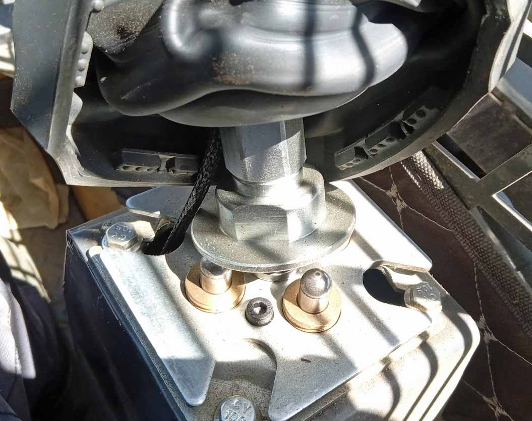

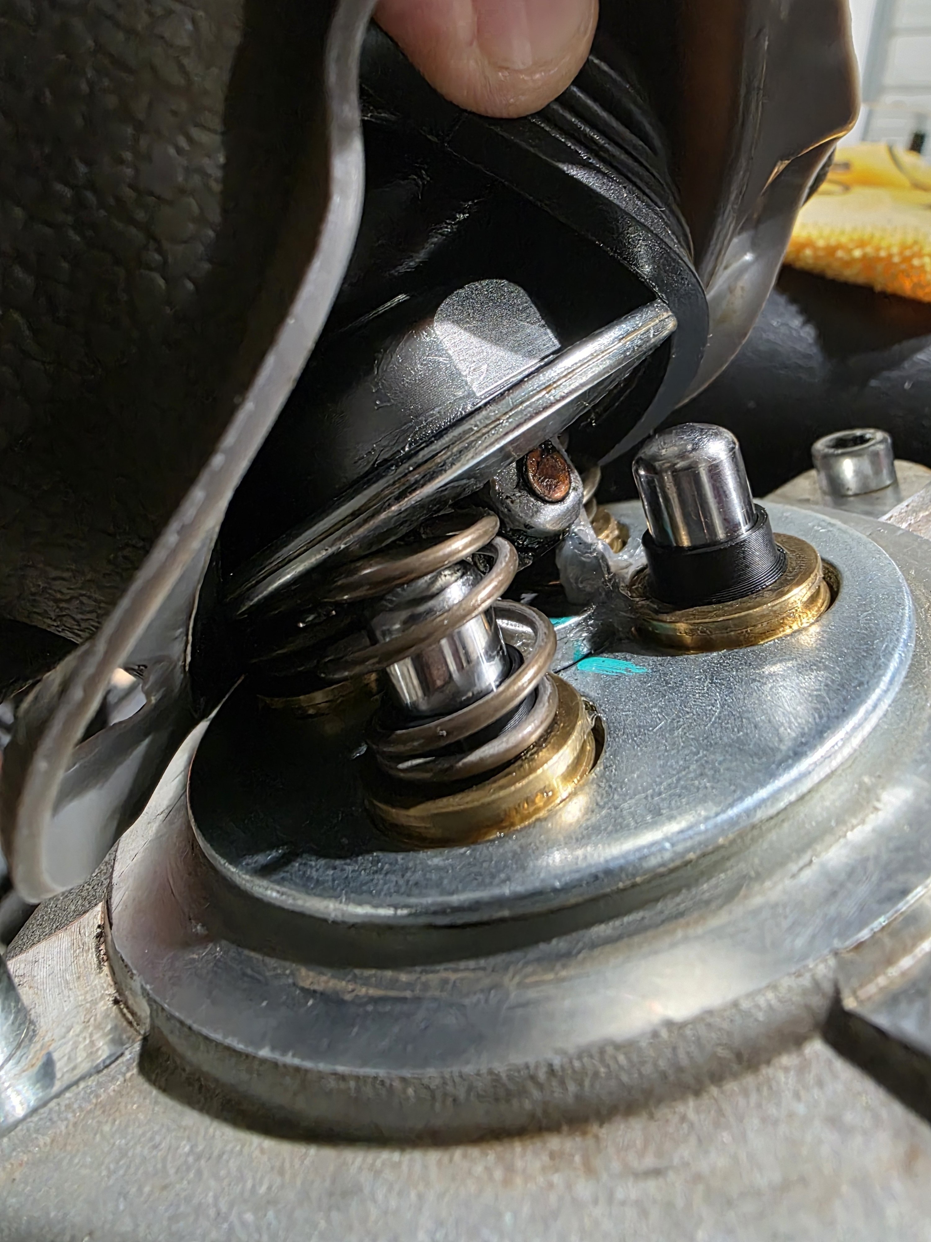

Installed the pilot spring mod to my TT-17. Bit of a guess how to get the boot off and on the left hand joystick I took off the plastic top of control cover (2 side Phillips screws, a 10mm bolt hidden under armrest stem and disconnect wires.) to find out I could simply pop the rubber boot off to get at the control plungers to add springs. Helped though for stretch fitting boot back on the base.
The right hand joystick I just worked the base of the boot off in the arm recess and added springs before working to stretch it back on. Not sure if I got it perfect but I will find out. Tight quarters in this cab unit.

Thanks for this update @MattB4 ! I have noticed that the majority of installs are around 5-15 minutes. Mine (AGT KU18e) was a bit more involved and probably took me 20 minutes or so. Nothing special needed as far as tools go. Looking forward to your thoughts after taking the kit for a spin.
