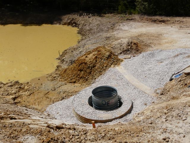

The rock is left over from my driveway paver project. I used it as the base and compacted it and then put sand on top of it, leveled/sloped it then tapped in/set the pavers and then used polymer sand to bind it all together. Well, the first 500, I still have 12,000 to lay after I finish the last 160' of curbing.
Kyle the water is flowing from all sides, I can't really pinpoint a specific spot. Is this how a spring flows?
It seems like the clay has fingers of sand running through it in it and the water is following through the sand fingers, straw size.

Pacerron, The PVC pipe in the first pics was a stand for a solar panel and was on the other side of the pond. It has been removed. The plan was just to clean the pond out with the track-hoe and be finished. But then Jim mentioned about a culvert and that started another realm of projects that seem to be mushrooming.
I bought a 30" culvert 6' long this morning that I will use. I will level the top of the 30" culvert so that it is above the spillway. The large culvert ring will be raised slightly and filled with gravel for a solid platform leading to the 30" culvert. There ares several other options available and I'm thinking of new ones daily. Monday when the digging starts I'll figure it all out.
Do I need to drill holes in the side of the 6' culvert on the bottom half and then put rock on the outside?

Thanks for the explanation. I combined 3 of your pics and think I've got it now. It looks like the field has always been draining to that area.
I can see a need for the holes and rock around the outside of the culvert on the bottom half if the 6' culvert will be somewhat above the present 5' ring grade, which it looks like it needs to be. In fact I think you should have rock fill between the culvert and the hill where the water is seeping out. Some folks like to shoot the holes in the culverts with a r**** for fun and saves a lot of drilling.
Jim probably has some ideas about placing the culvert and the holes.

Don, if I was looking for gravel that water would penetrate easily, I'd use pea gravel. That's what well drillers use up here around well casings before sealing the top with concrete. It should be available at materials places and in small quantities up to a yard at many landscapers. Of course, you aren't exactly surrounded by a metro area there in Lee County. You might check with a well driller to see if they have some they will sell you. For water penetration, I've never seen them use anything else, but that may not be the case where you are. I'd at least check to see if you could get some river rock type gravel or pea gravel. The pea gravel is round and individual pieces won't bind together with small amounts of clay like flat chips might.
Do I understand that you are putting a smaller culvert inside your larger one? I think that's a good idea. I also think if you had a trash pump, you might be able to pump water in between the culverts and wash out silt so that the inner culvert drops down as silt is removed. Did I mention that you'll probably get really dirty/muddy too?;)
When you get your culvert into final position, wait to see how high the water will rise inside it and then cut holes about 6" below the maximum static level. You might even get better flow by going 1' below. You just want to have the maximum flow while still having some amount of silt dam. That's my unscientific opinion. It will be the best tradeoff between flow and silt-in protection.
