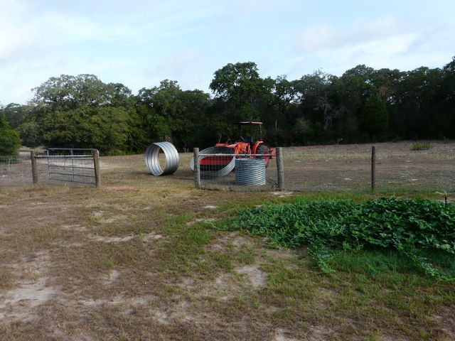

I have several steel culverts from with diameters of 3.5' to 5'. See photo.
My plan #1 was to put the largest one in dig it out, put in next, dig it out etc....and then put gravel in the bottom.
Don,

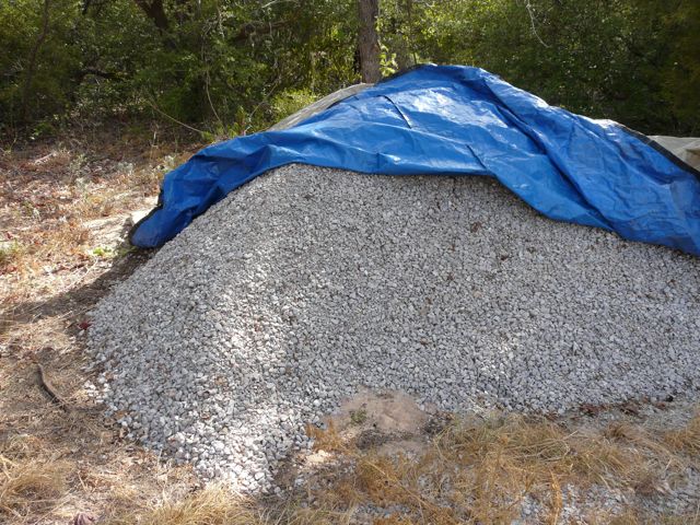

I sure don't know anything about Texas stone. Up here we would call the aggregate in your picture... limestone. Our gravel comes from rivers of past centuries and present rivers. It is irregular in shape but somewhat round in shape.
What it is called doesn't matter. The difference is that gravel does not pack together under pressure so it allows the water to continue to come up into your round culverts from underneath. Limestone or sharp cornered crushed stone packs together and forms somewhat of a block.
That may be your intention?

pacerron, That is white rock - 3/4 inch, it is not limestone. Around Austin there is nothing but limestone and this is not that.

Thanks for the explanation. As long as it is not sharp triangular edged, like crushed limestone, it should not pack so tight as to block most of the seepage upward.

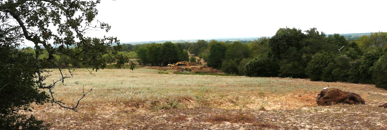

Pacerron, I was thinking the way you described it to be the easiest. I can dig down 9' so I will have to get pretty close and low to the hole. That is where the problem comes in. The sides are very steep and the lower I go the less stable the soil is. I might only get two culverts in.
Another consideration is that this spring is at the bottom of a very sandy hill. The sand is like beach sand and will erode easily and fill up the spring, so I have to watch the drainage of any angle cut ins and deflect the water around the hole with berms.
Brandi, The sides are really cut steep, and by cutting them some parts will be vertical and unstable in the rain. This will be fun and a challenge. (I may still be working on it after your surgery)
I'll post pics of the progress. Here is an overall picture from on top of the hill when the track-hoe was here. The border fence is in the tree line on the right, right up against the spring pond.

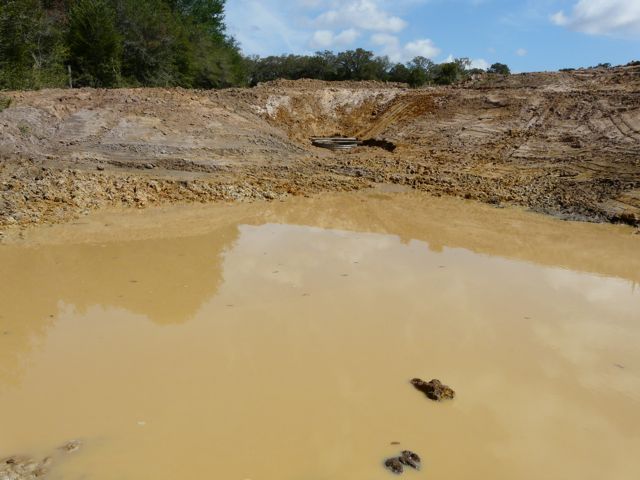

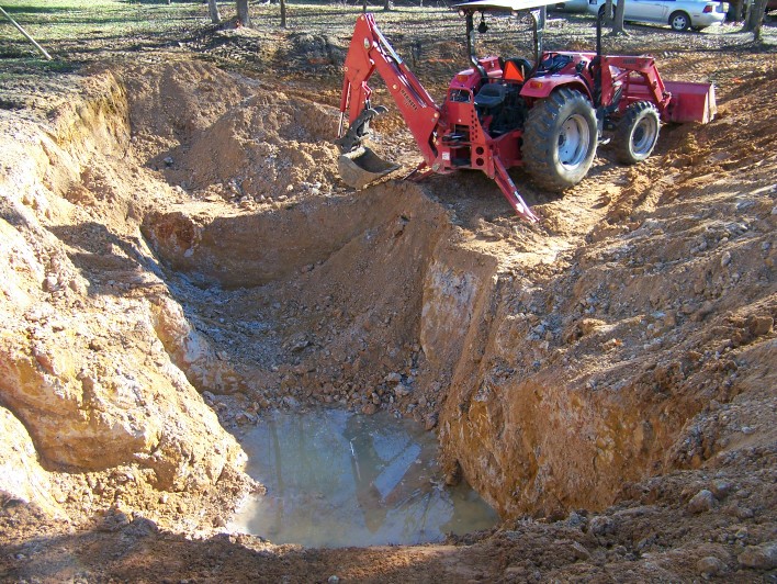

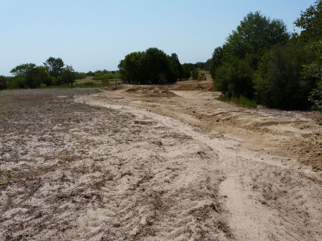

After a few days of box blading I have a back hole access. I set a 12' concrete curbing for the BH outriggers. As you can tell the water is constantly rising and I have about 2 weeks to finish this project.
The muck is still wet after a week and final grading is still on hold.
Time to take the box blade off and put on the BH to set the culverts on edge.
Temp - 104
Maybe tomorrow morning.......

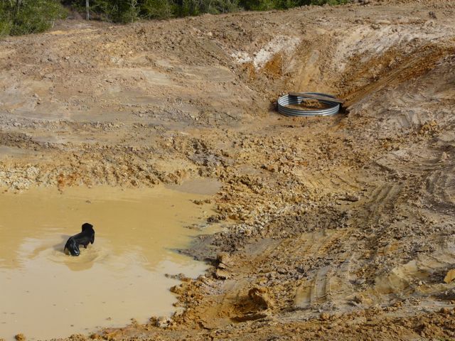

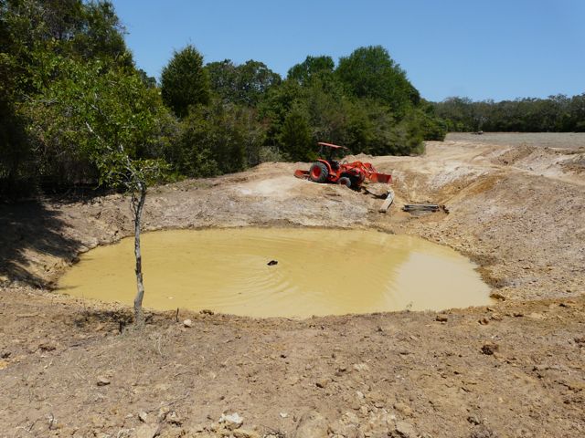

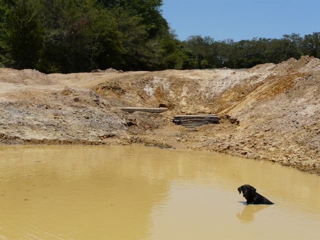

The dog is in the first picture also, but the water is deeper in the middle so he has to actually swim. All the cows were drinking out of it yesterday, so it now has officially two uses. :D
/ Opening up a spring with a track-hoe #34
Don,
It looks like you should have plenty of time to do your backhoe work unless something goes haywire. You were asking about a pump the other day. I can't tell from your pictures if the area that has trees next to the pond has any dips or holes close by that are lower than your water level. If so you might be able to rig a siphon real cheap to keep the water level down so you can finish.

The dog is a stray that wondered on our place last year and has not left. The DNA test show she is part:
Cocker Spaniel
German Shorthaired Pointer
Greyhound
Poodle
Bichon Frise
Great Dane
She like to bark at snakes and has an awesome coyote howl, (bilingual).
We thought she was a Whippet and name her Whipper (Whip for short).
There is no place lower than the spring pond. I think I will have enough time now that I have watched the water's slow rise for a week.
Stuck??? How do you define stuck? If I can push myself out with the FEL I don't think of it as being stuck.....So I haven't gotten stuck yet. I will try to find an anchor to chain the tractor to in case there is a major cave in. Thanks for the suggestion! The soil under the curbing is saturated. I picked that side of the culvert because it was the lowest and had the least amount of cave ins from springs.
The curbing was a mistake I made on the paver driveway. I angled it too much and the circle was too tight so I had to cut out 12' and re-pour it. I'm glad I found a use for it. I'll start a thread on the circular paver driveway when it gets cooler.
