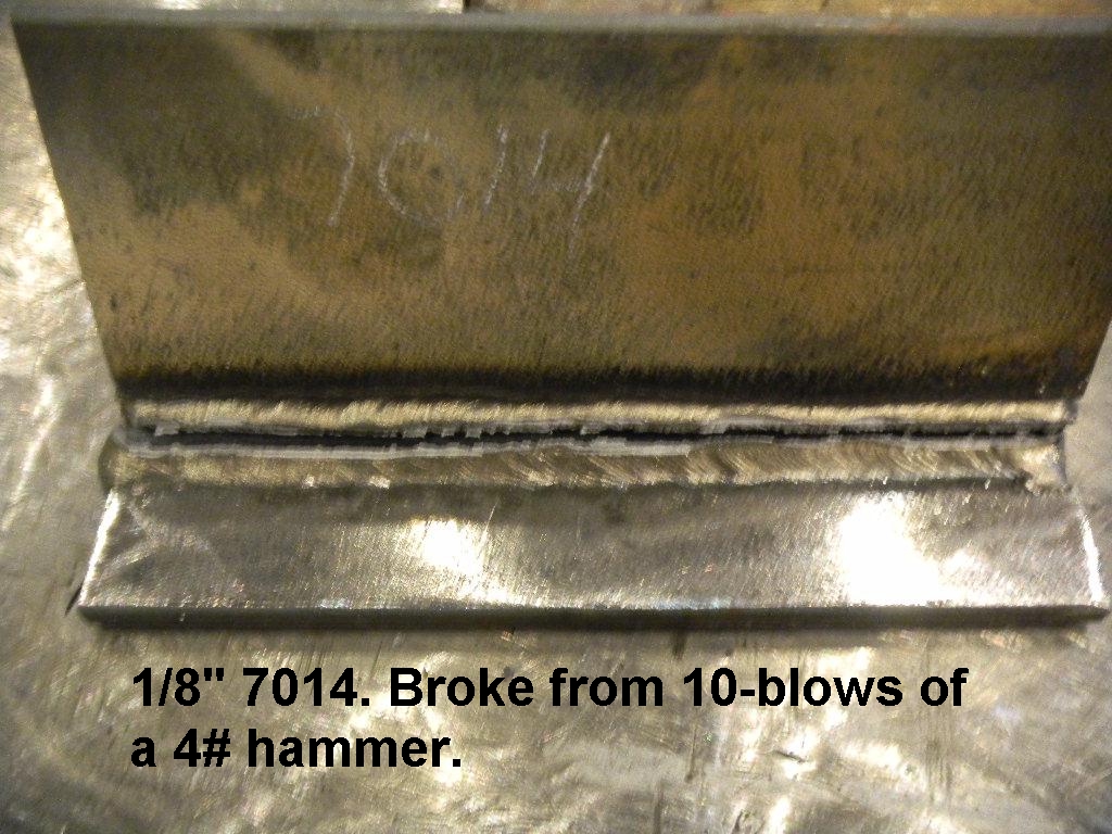

In the 1970s I worked in a fab shop. Our number 1 contract was building nuclear waste tanks. The lifting ring, was 4-inch X 8-inch flatbar rolled to 8-feet in diameter. We had to make a 1 7/8-inch fillet weld top, and bottom of the lifting ring. I don't think there is a limit to how much you can stack welds!
This pictures is a 3-pass fillet weld, with Mig.

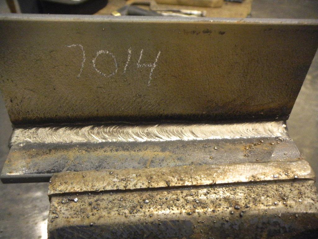

Here is a 6010 fillet weld. Stacked on top of each other. Pipe welders stack 6010 when welding pipe.

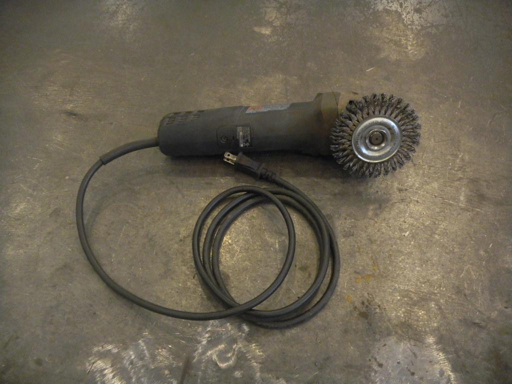

If you're going to run a lot of 6011, or 6010. A wire wheel on a small grinder really cleans the slag off nice.

Added in the wire cup brush just for you Shield Arc, thanks for the recommendation!
