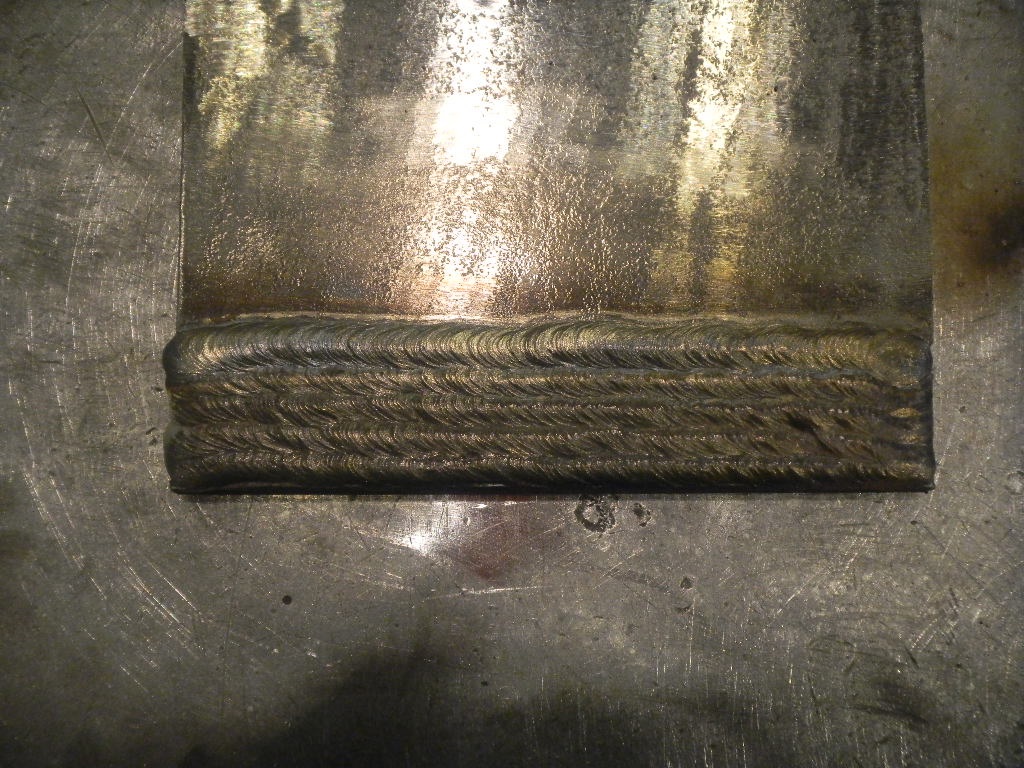

WOW! Those look really good!:thumbsup::thumbsup:
Now do it like when you're in welding school. Stack each weld half way on top of the other! Do this for a while, then move on to lap welds, and fillet welds.

/ New to welding #139
Not bad at all. It will take some time to get the perfect stack of dimes.
Little trick for you. When you get ready to stop, back up just a touch, and push the rod into the puddle some. This will help fill in the crater. An under filled crater is where a crack will start.
