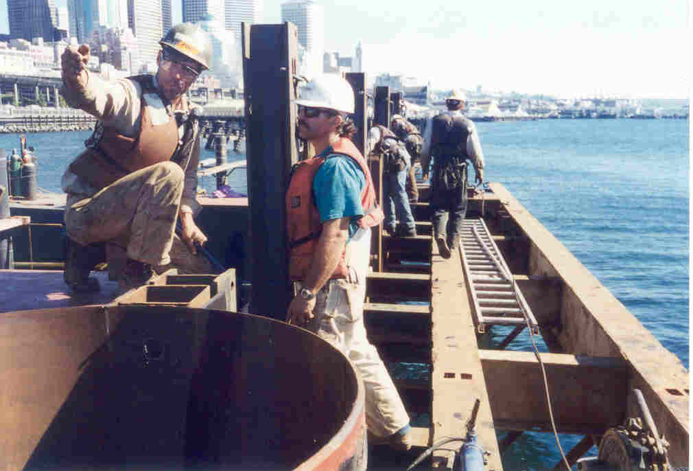

When we built the Pioneer Square Station of the Metro bus tunnel down town Seattle. We lowered the beams down with a crawler crane setting on 3rd avenue. Track loader drug the beams to there locations, and an excavator set them in place. Before setting the beams in place we had to cut them to length, and weld plates on the ends. We used self shielded wire. Majority of the beams we didn't clean as well as we should have.:eek:
We placed over a million tons of falsework iron in that station!
Is that you in the second picture? Pretty cool pictures btw, thanks for sharing them.
No, that is Harvey. I forget why, but Harvey died not to long after that project.:(
This is me in the blue T-shirt. Working on the Seattle water front.
Sorry to hear that SA.
That's pretty cool man, much respect to you guys who build the huge structures. Very interesting stuff to me.
Great pic SA! Back in the day! It might be time for another lesson this xmas time. I want to learn TIG but I don't have the machine yet. :D
