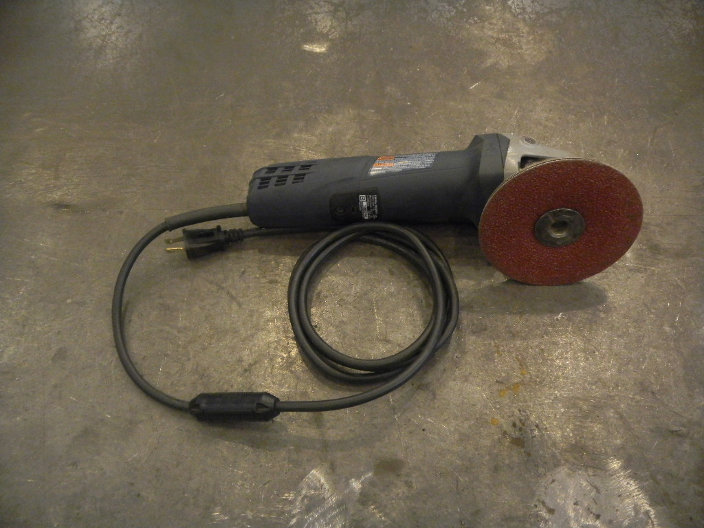

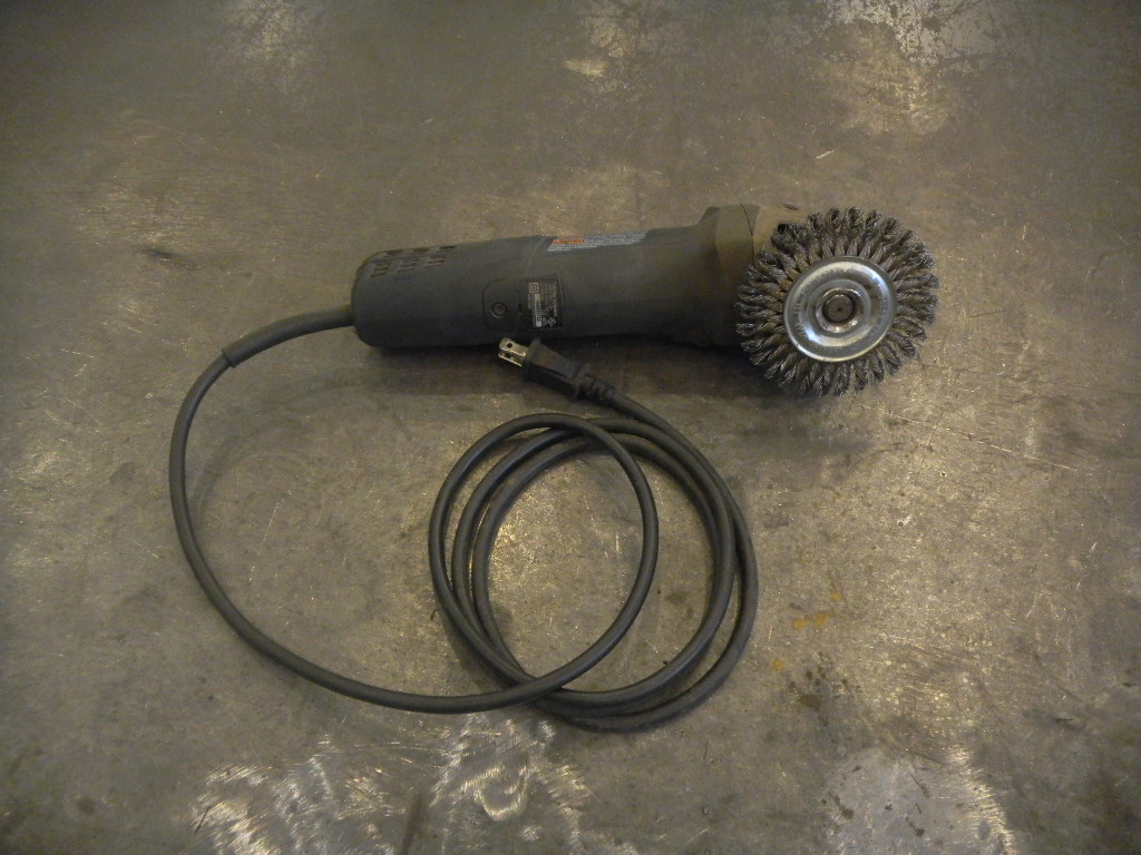

Airgas, and Praxair welding supply general carry ESAB rods. I like 1/8-inch and 3/32-inch 7018. Also 1/8-inch 6010. I do have 5/32-inch 7018, but if I have to use much of it, I'll use my wire feed welder.
I use a sanding pad on a 4-inch grinder, or a wire wheel on a 4-inch grinder to do most of my cleaning before welding.

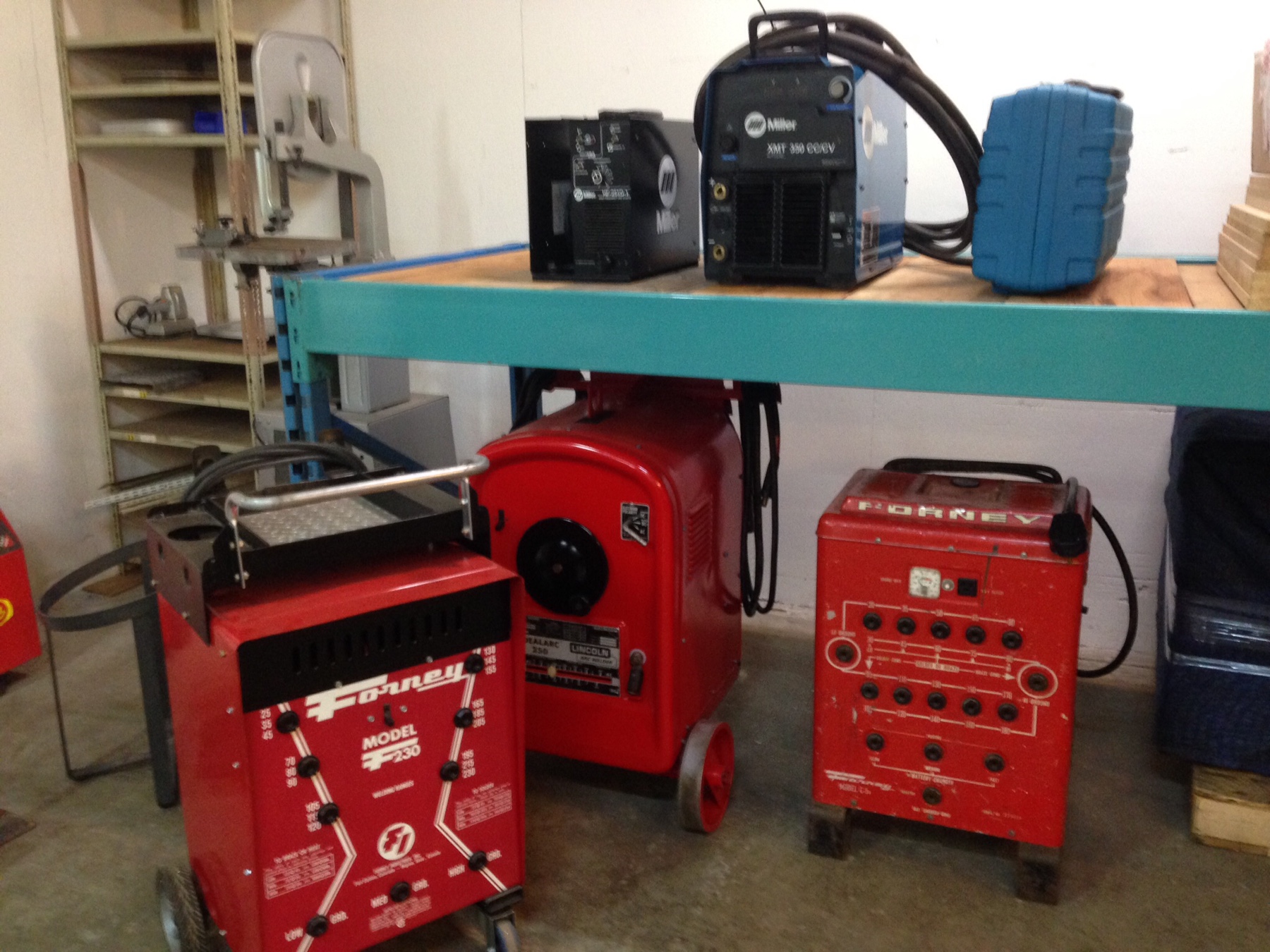

From the pictures of your shop --- (it looks like you never use - except for cleaning and polishing). Then you show something you made and you had to make it somewhere. I'd say you learned it somewhere even if you didn't pay attention. :confused3:
