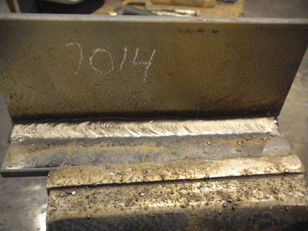

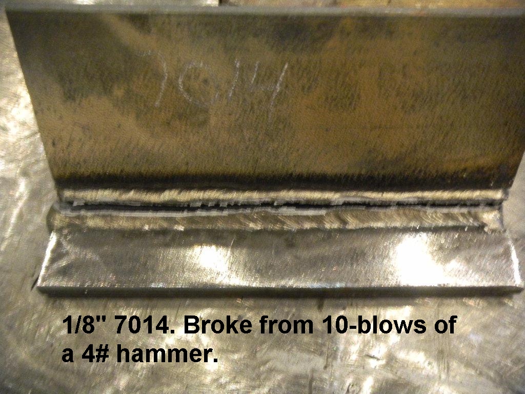

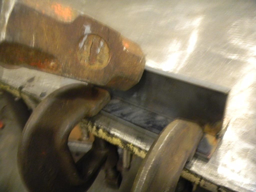

I never seen 7014 on the job site. Until seeing guys on these forums talk about 7014. I bought some, and later did a fillet weld break test with it. I was not impressed with it. 7018 that never seen the inside of a rod oven, broke with 18-blows from a 4-pound hammer. 7018 right out of the rod oven, broke with 23-blows from a 4-pound hammer.
Now to start learning to weld, 7014 is child's play to run!
