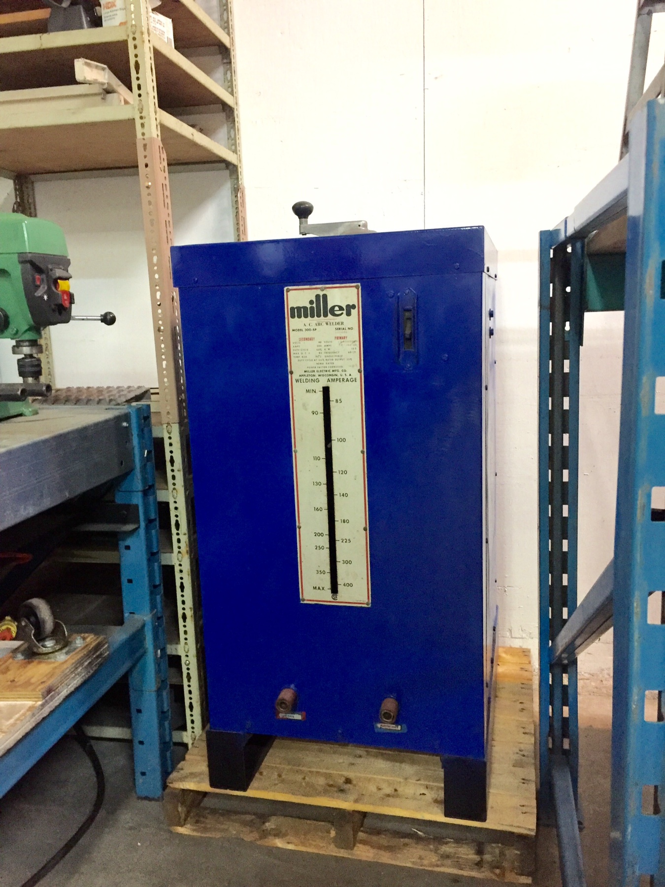

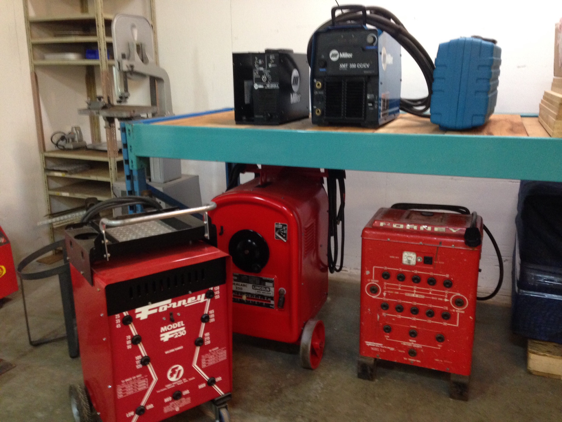

If you decide to go stick, my opinion on options are:
1. An older transformer welder. $0 - $250. (Similar to my red ones in first photo). AC or preferably AC/DC. You will always get your money back most likely for scrap copper value alone. The downside is they're somewhat heavy. IMG_7979.JPG
2. A "modern" dual voltage inverter welder like MinnesotaDave suggested. I like my Miller Maxstar. (Pic below)
3. Not the best option but if portability isn't a concern and for some reason you've bypassed the power meter from your street transformer.....
These can be had for a song and weld okay.

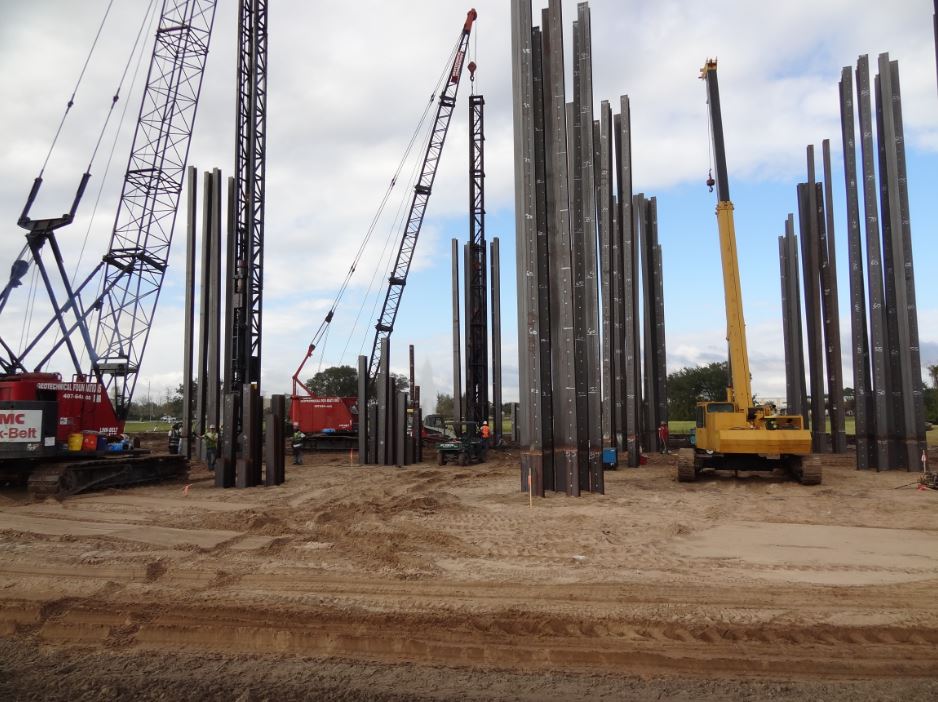

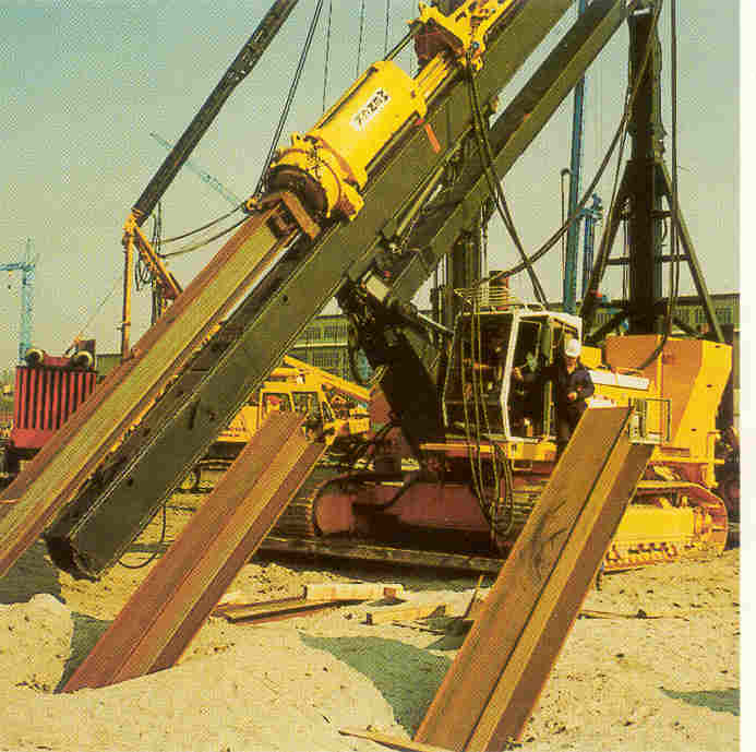

SMAW with AC really helps if fighting arc blow. When we drove H-beams in the ground, arc blow was always a problem when welding another H-beam to it. All of our welders were engine drives, so we didn't have AC. If changing direction didn't help. We would heat the weld zone, and let it cool before welding. H-beams can have arc blow without being hit with a hammer 100 to 150 blow per foot.
