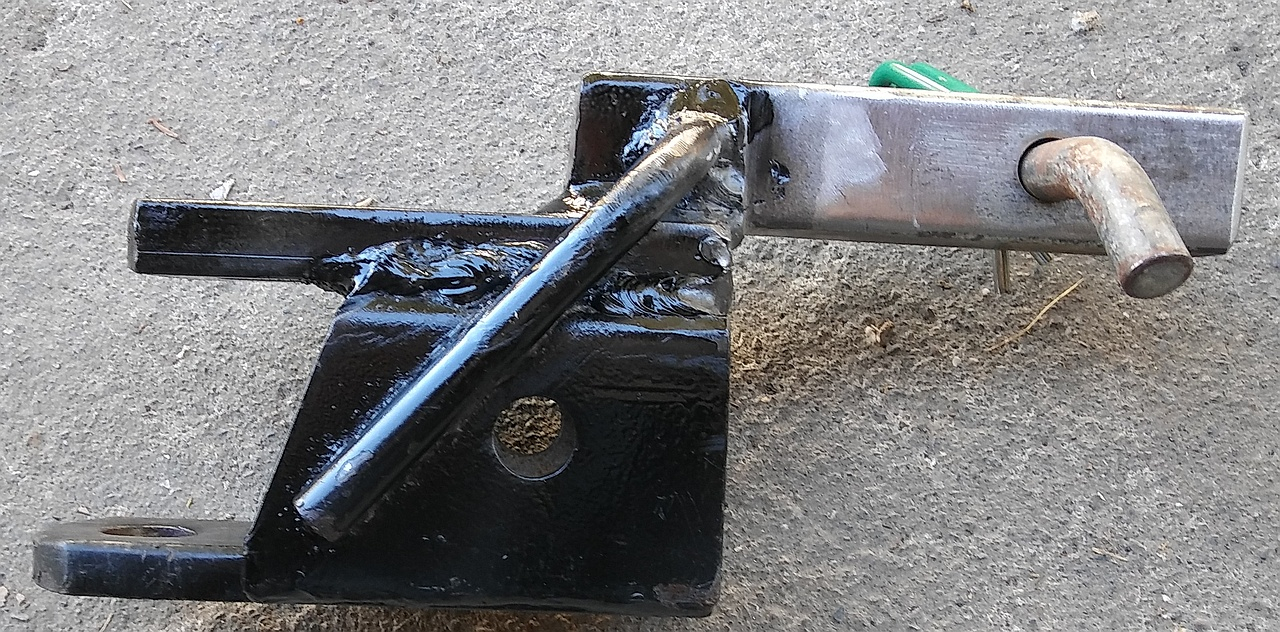

I have some farm welding to do to make an adapter for front bucket to use on other machines. I’ll be using 1/2” steel plate. Have Millermatic 211. Have heard that using flux core wire with shielding gas will make deeper welds. Any thoughts on this? I know I can’t do a one pass weld, will need to build up. If gas + flux core wire is better I might try using. Thanks.
There is a welding process called dual shield that uses a flux cored wire along with shielding gas. It is used for putting down lots of metal fast. For regular flux core wire adding shielding gas won't help at all. To get better penetration just pre-heat the work. Get yourself a propane weed burner and heat up the plate. Even heated to 400 degrees will help a lot. Been there, done that. More than once. I learned this technique from an excellent teacher in a wire feed welding class.

Eric,
Thanks for the tips. I will get a weed burner to pre-heat. So it sounds like dual shield wire is flux cored that is intended to be used with a shielding gas, whereas regular flux cored wire is not meant to be used with gas? Do I have that correct? I’ve put off the heavy projects for fear of not doing a strong enough weld. Was suggested I get a tombstone arc welder for the heavy stuff, but prefer not to go that route yet. Thanks again.

Eric,
John
Yeah, you have it right about dual shield. I use it sometimes but only when I need to really lay down a lot of metal. And I wouldn't even use it if I hadn't been given a brand new 30 pound spool. I think it's 30 pounds, it's huge and heavy. I use it in my big Miller, which is a 300 amp beast. Anyway, you posted that you have a Miller 211. They are good for welding 3/8 material in one pass. So If you pre-heat you should have no problem getting proper penetration. After you have run a bead or two the metal will be plenty hot. I suggest, for your own peace of mind, that you take a couple pieces of 1/2 material, weld them in a similar manner to what you plan to do for your project, and then put the pieces in a vise and beat the crap out of them until the weld breaks away from the parent metal or your arm gets too tired from whacking away at a weld that's not gonna fail. Then you will know if your welds are adequate. I would not hesitate to weld 1/2 steel with a Miller 211, I would just pre-heat to make sure the penetration is proper.
Eric
