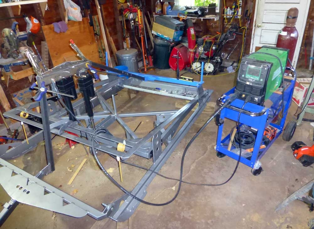

I sold my Lincoln TIG machine as well as my Hyper Therm plasma cutter and replaced both. A 205 Pro-Tig and the pair of plasma cutters. The 205 Pro-Tig is a fine machine btw. My good friend is a nuclear certified welder and he's used it in the past and was amazed at how well it welds (of course TIG welding takes skill) and the Titanium plasma cutters, the consumables are 1/4 the price of the Hyper Therm consumables, why I sold it as I use the larger one on my CNC plasma table so I burn through a lot of consumables. Other nice thing about the Titanium Plasma cutter is, HF sells it with the CNC interface already installed so it's basically plug and play CNC. Had to wire the HT to run on the table.
Only thing I added to the 205 was the Everlast water cooler and a CK Worldwide Series 20 flex head TIG torch. The 205 comes with everything including the foot pedal but the torch is air cooled and an air cooled torch don't work well with aluminum at higher amperage, consequently, the water cooled torch. I don't like getting toasted fingers.
