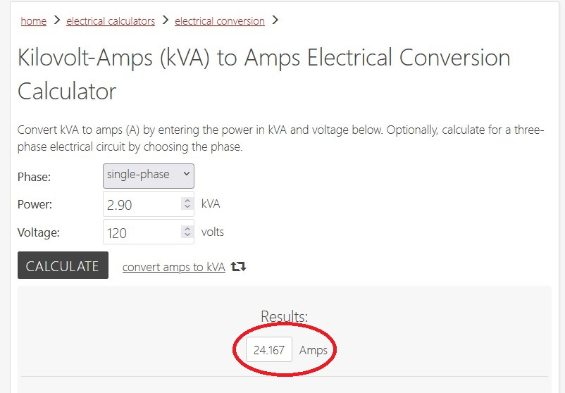

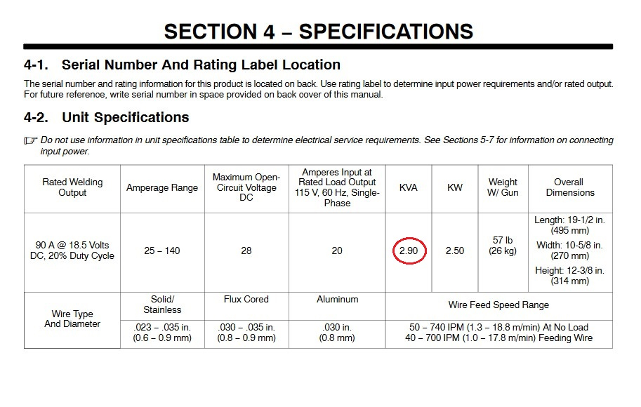

A little bit you can learn from welders owners manual, why you keep popping your 15 amp breaker....
From Hobart Handler 140 manual...
And A little internet electrical conversion...
That FC90 will trip a 20 amp breaker, ask me how I know.

About your 20 amp breaker trip..... My Hobart 140 running near top settings drawn about 24 amps.... Yes the 20 breaker rating in manual is a joke.... Installed a dedicated 30 amp breaker with 12 gauge wire and all is good.... Yes by national electric code it good.... Check manual on you Amico and see what actual KVA load is when full out....
Manual for this is a joke, just generic instructions that would apply to anything similar. Extension cord size, safety, diagrams of good/bad welds, etc. I can't find KVA.
Specs from Amico website:
  • Rated Input Power: 230V~15 Amp & 115V~30 Amp
  • Current Range: 130 Amp @ 115V & 230V
  • Rated Duty Cycle: 80% @ 130 Amp
  • Nominal DC Open Circuit Voltage: 60V
  • Power Factor: 0.93
While that 80% duty cycle looks impressive ...I'm glad I also bought the $30 3 year warranty!
