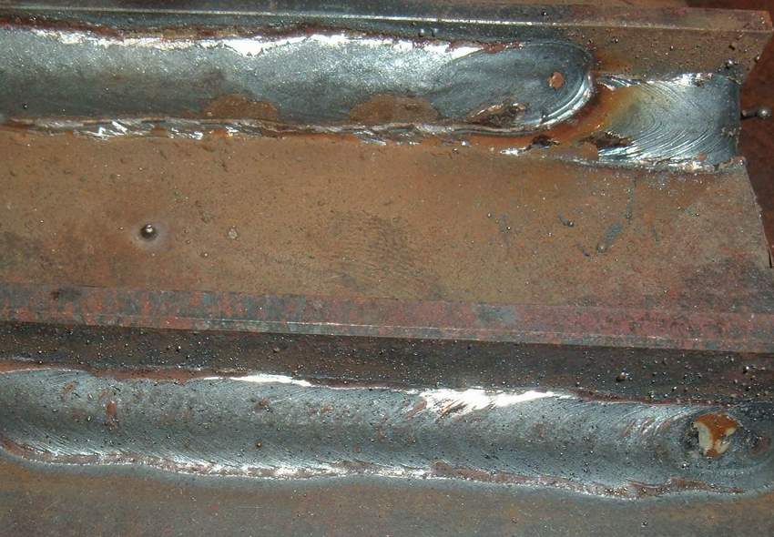

/ welder circuit #14
The 210 is in this class. Its minimum wire is 14 on a max 30 breaker (single circuit in pipe) so it needs to be a size larger for cable and a 10 is 2 steps up, makes it an excelent circuit for that machine. I looked for giggles and the 230 is a heavy bugger, will output way more than its rating. Needs an 8 cable (10 in pipe) A 210 is a really good machine, can turn it up to do 1/4, enough to take the ripples right out. Hobart 210. Those would wet out even a bit better if the plate had been cleaned, I should have wire wheeled them after for a better view. I hadnt intended to show them like this at the time.
Yeah that's what I want in a welder. Found it for $839 shipped. Thanks S.

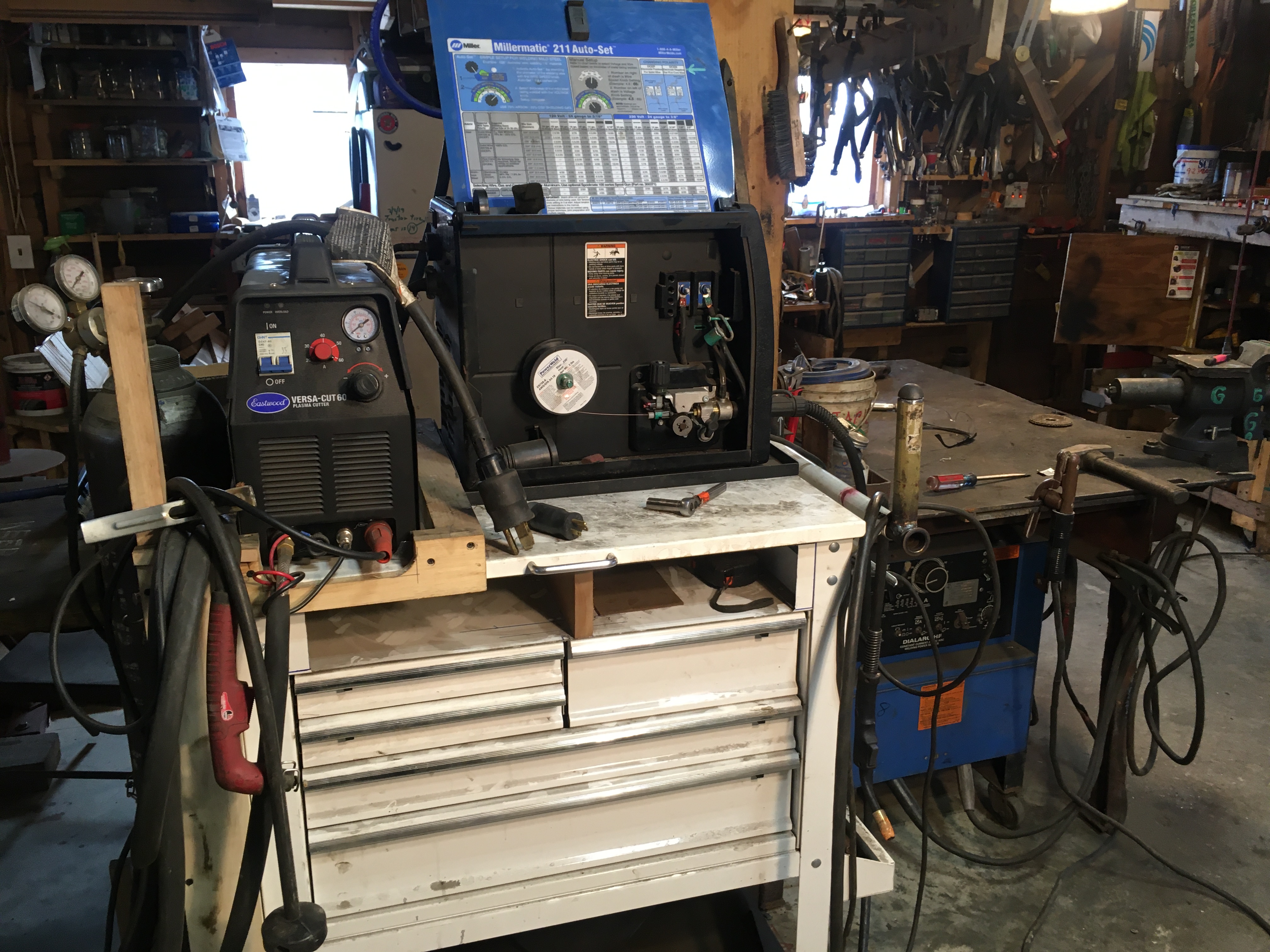

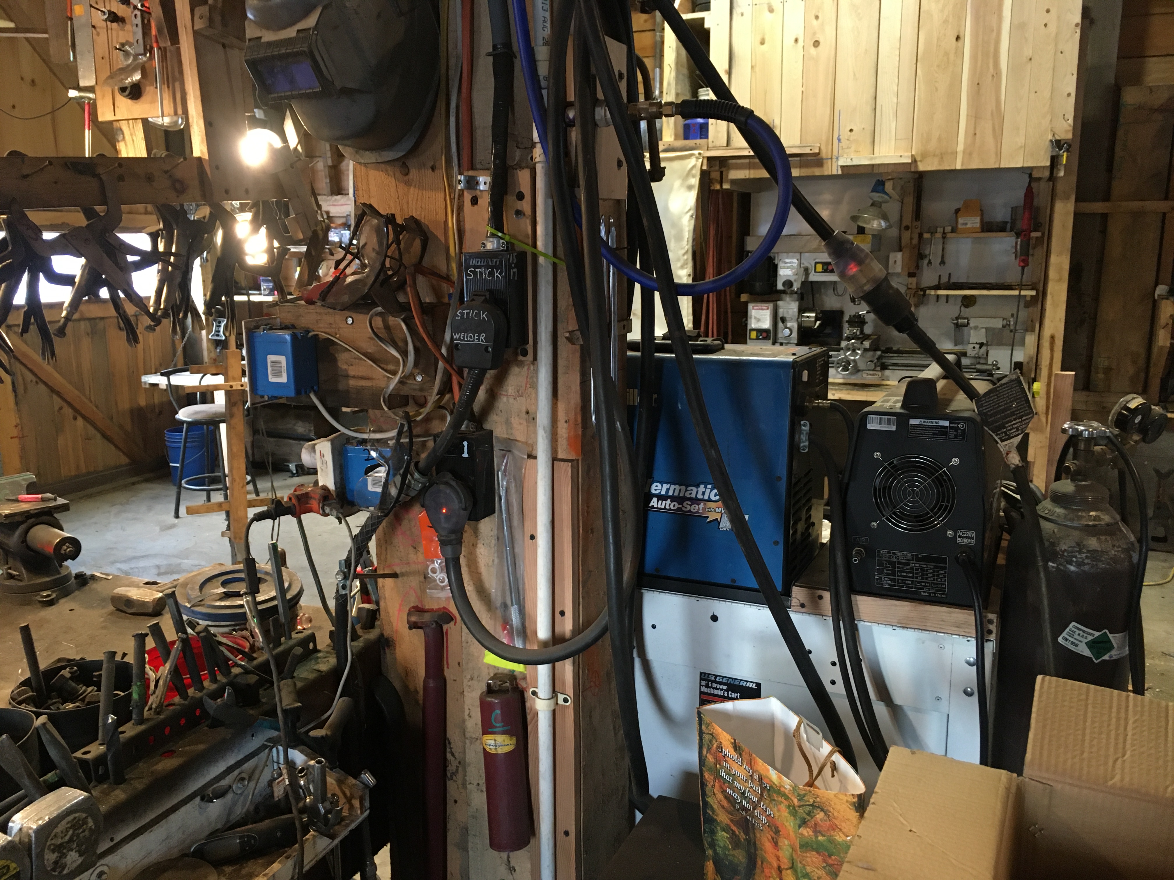

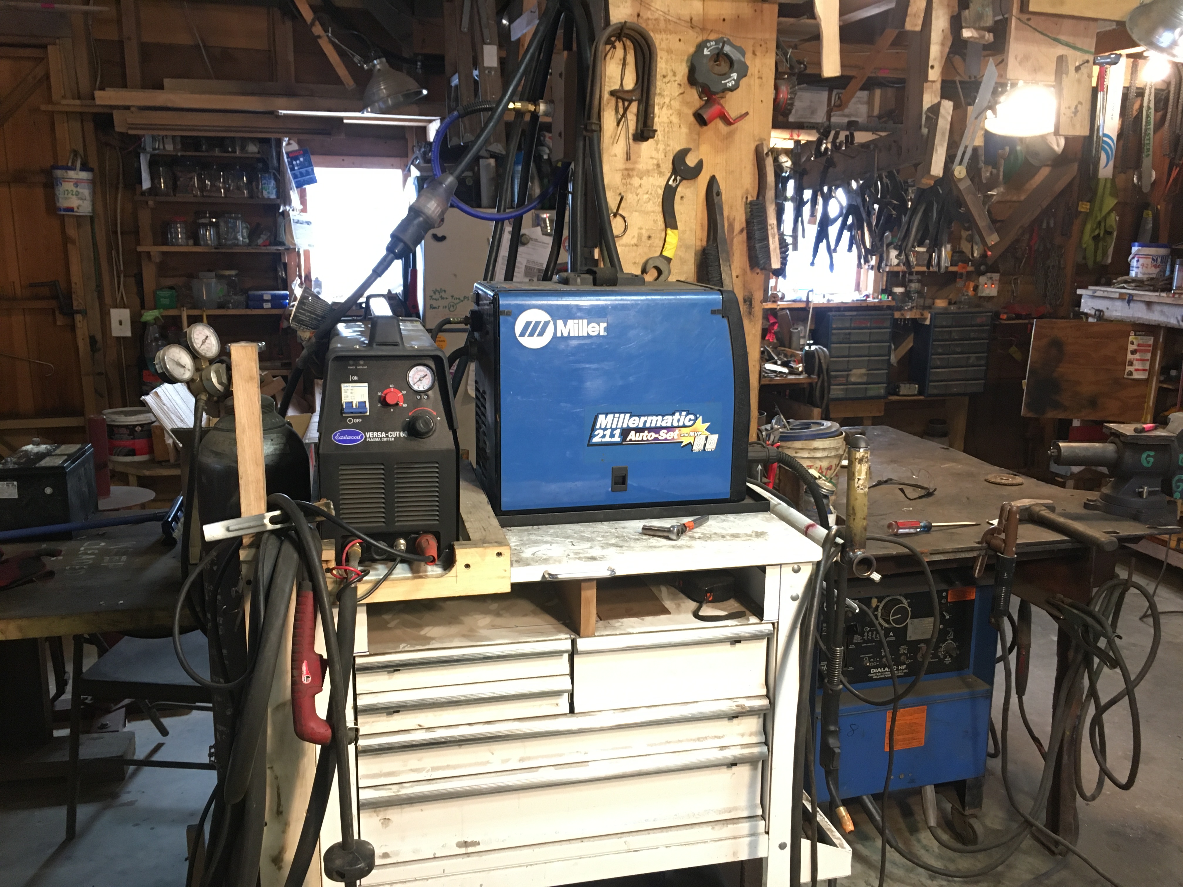

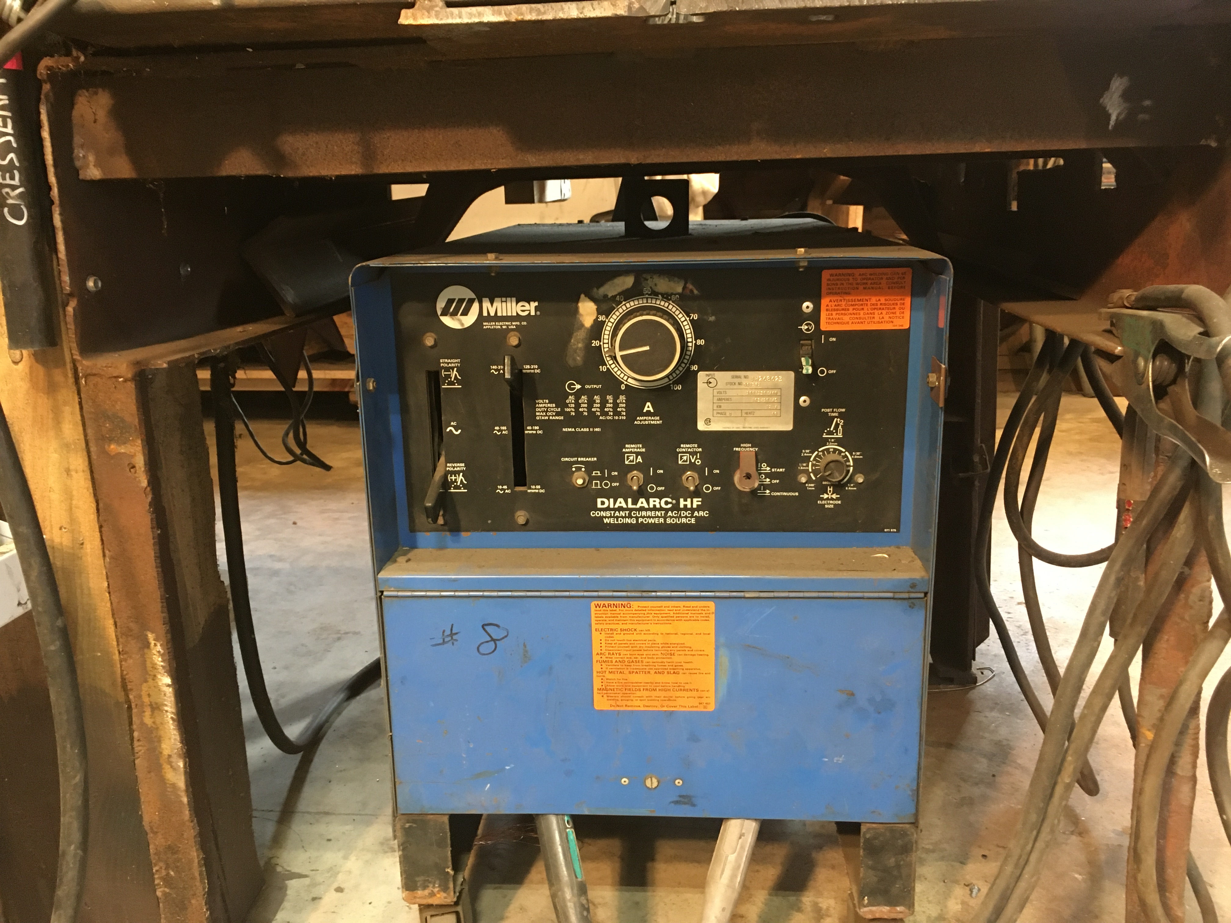

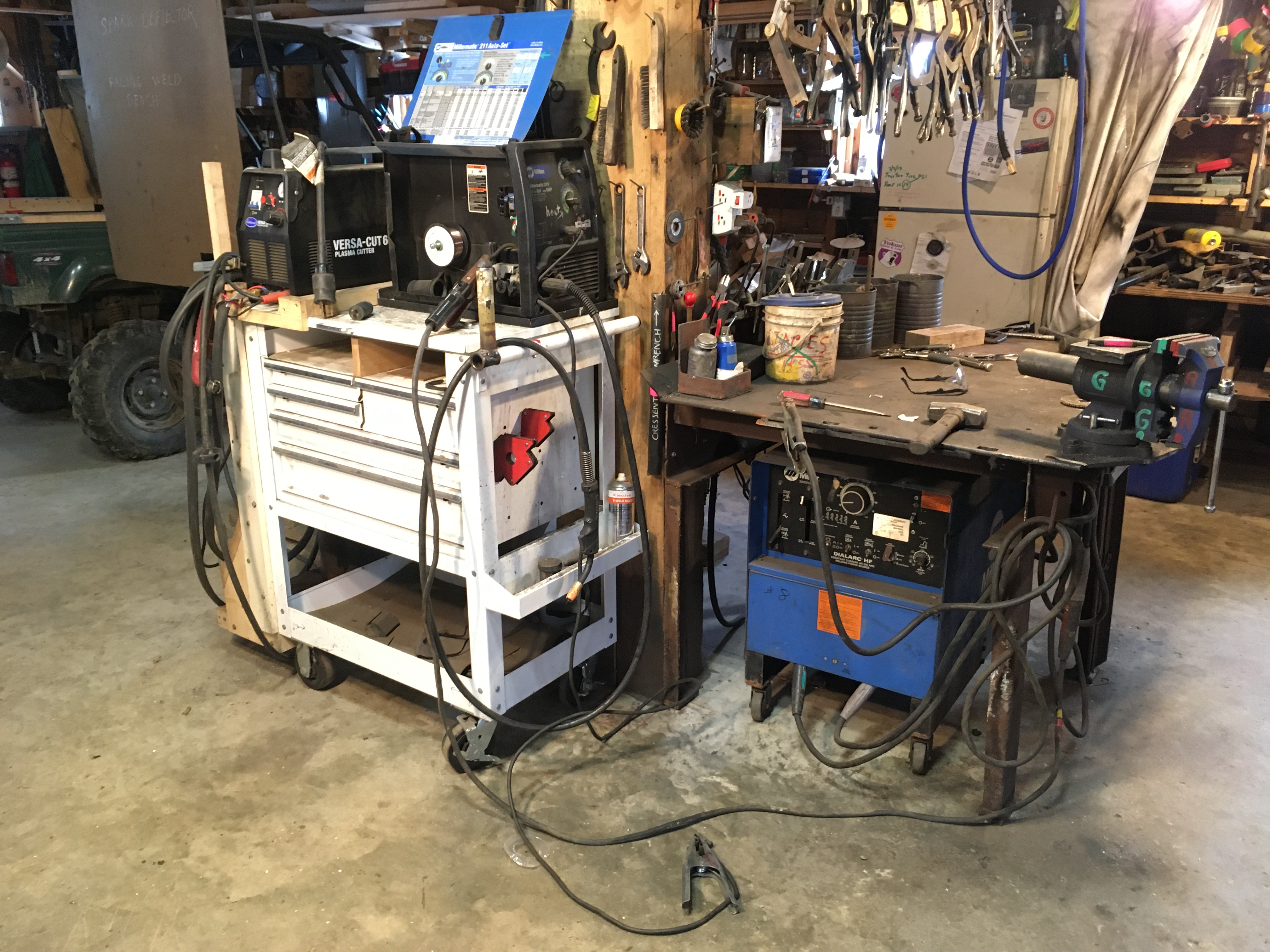

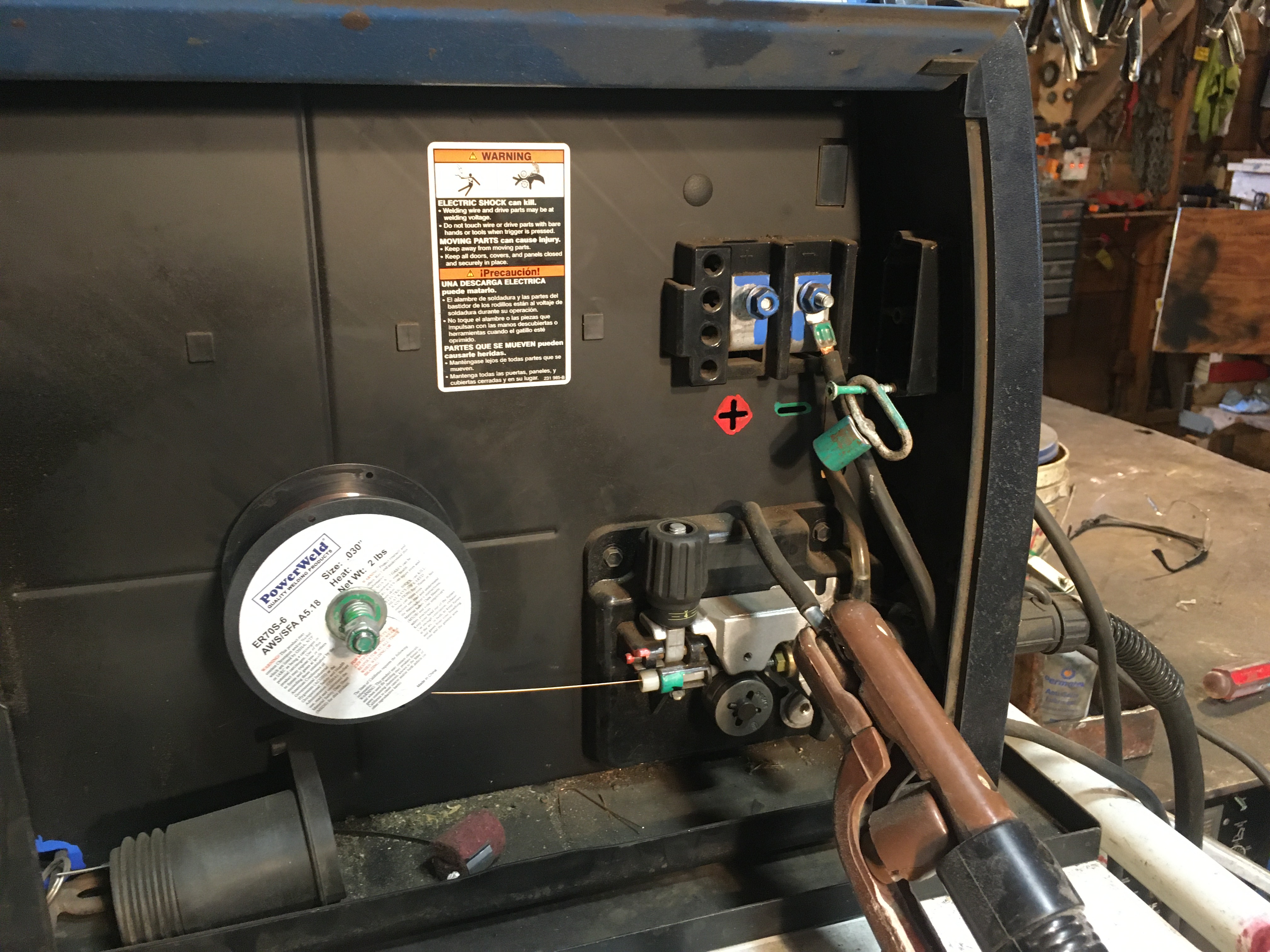

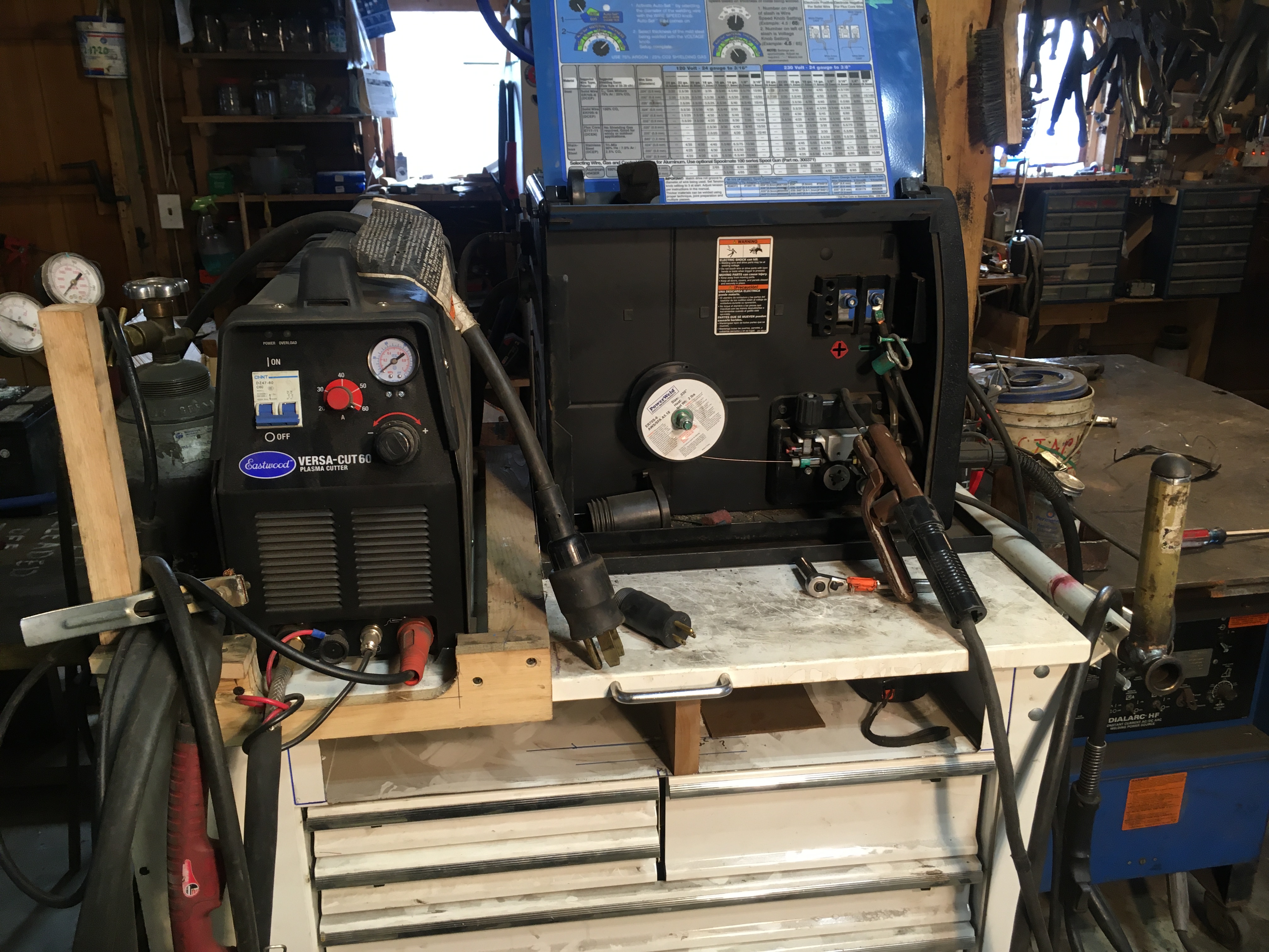

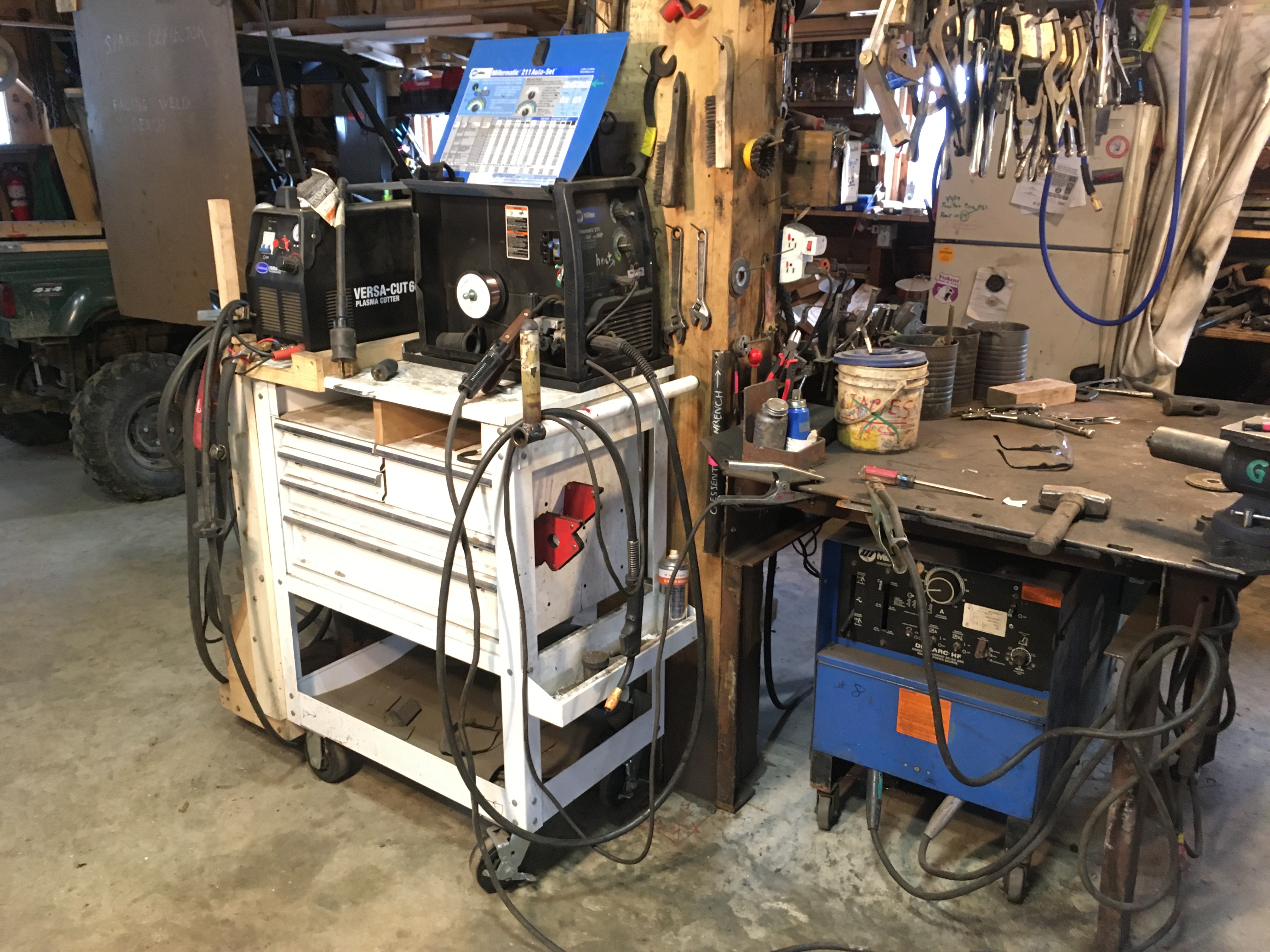

It's no longer 115 input volts, it's 120 input volts on one hot wire, 115 is on the low side, a multi-metor would show 118-121volts, standard house entrance is 240 volts to a 100-200 amp panel.
My Miller-matic 211 can run on 120 volts or 240 volts, its plugged into a 240 volt outlet on 10/2 wire, into 20-30 amp breaker. My old Miller Dialarc can run 480 but is set on 240 volts and also plugged into a 240 volt outlet on 100 amp entrance cable into a 80 amp breaker.
You small mig welder on 115- 120 volt cant be change, but if I understand you half right you want more weld heat out of it, so there is a way to get more heat out of a small mig welder by using a DC stick welder, which means you can go to a next size up mig wire. If your stick welder is a DC welder, disconnect the wire off the mig gun side, clamp the stick welder rod holder to that wire, use ground on stick welder and dont use ground on mig welder, the wire in mig welder stays hot like a welding rod so have to be careful with mig-gun placement, now you have more mig gun heat.

I have an old Dialarc just like that that I don't use anymore. Have the tig gun as well. Mine has the water cooled option.

You are correct about wanting more heat. The puddle on the Forney Easy Weld 140 is almost non-existent. I bought a $200 Miller hood just to see it better. The Forney is prolly operational for sheet metal where you use .023 wire. Even .30 wire on 3/16th was a struggle for it.
Yep can flip the bottom panel up on the Dialarc and hook a tig torch on. I dont really have a need for tig welding but wouldn't mind having one.
