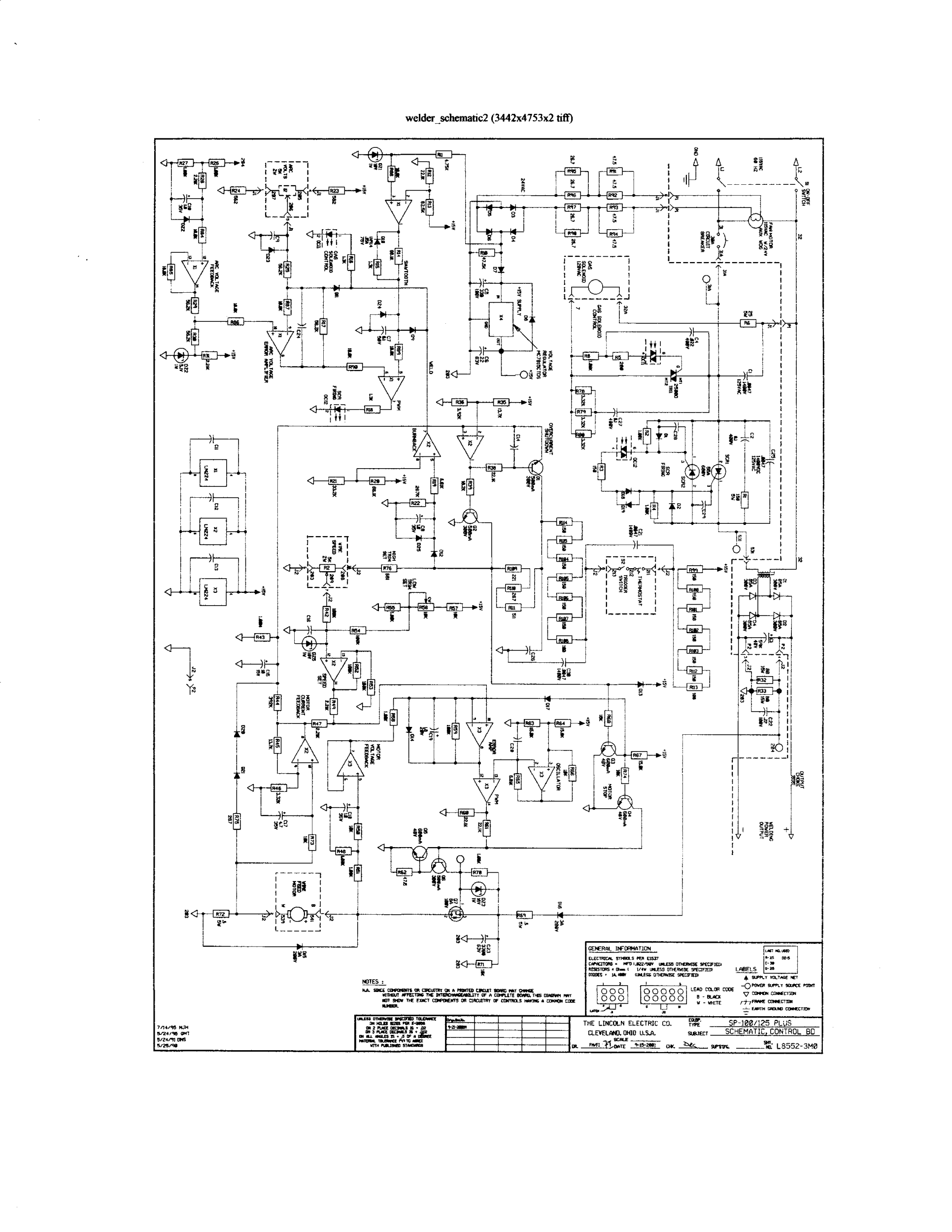

I bought my SP-125 Plus machine about 20 years ago. It was used. In an auto body shop. About a year after I bought it I took it apart because I wanted to add a purge button so I could have shielding gas instead of air in the whip when I started welding. That's when I discovered its previous life in an auto body shop because of all the Bondo dust inside.
Adding a purge button to control the gas solenoid turned out to be not as easy as anticipated because I wanted the purge button to control low voltage and the gas solenoid requires 120 volts. So I had to figure out what the circuit board inside the machine was doing to control the gas solenoid because low voltage was being used to switch the 120 volts going to the gas solenoid. Anyway, I figured out what was going on and added a push button into the circuit and ever since I have had a purge button on the panel of my SP-125 Plus.

I might like to try adding a purge button (some day when the weather is better) so I'm curious to know just how you did that. That first few seconds of splatter before the gas reaches the arc can be annoying.

I documented the changes I made to the circuit board and if I can find I will post it. Somewhere the circuit board schematic is available because I have or used to have it. Since the specs are identical for both machines I suspect the circuit boards are the same.

I looked on the web and found where I had posted the schematic and instructions to add a purge button to rhe SP-125+ machine. See the text below. See attached .png file.
Circuit changes resulting from the addition of a gas purge switch.
Additions:
A relay, pushbutton momentary switch, diode, and several wires were added to the control circuitry.
Operation:
When the button is not pressed the welder operates normally. When the button is pressed the relay coil is energized which causes the relay to switch the connection of resistor R16 from diodes D9 and D11 to the out pin of Voltage Regulator X4. This turns on the Gas Solenoid Control opto-isolator OC11 which then turns on triac TR11. Triac TR11 then energizes the Gas Solenoid.
Circuit Changes:
One lead of resistor R16 was unsoldered from the circuit board trace that connected R16 to diodes D9 and D11. A wire was then soldered from the trace to the NC pin of the relay. A wire was soldered from the free lead of R16 to the COM pin of the relay. A wire was soldered from the OUT pin of Voltage Regulator X4 to the NO pin of the relay. A wire was soldered from the GND pin of X4 to one of the two coil pins of the relay. A wire was soldered from the other coil pin to one of two male spade connectors. Another wire was soldered from the out pin of X4 to the other male spade connector. These male spade connectors connect to the female spade connectors which are soldered to wires from the pushbutton switch. The added diode was soldered reverse parallel across the coil pins of the relay.
