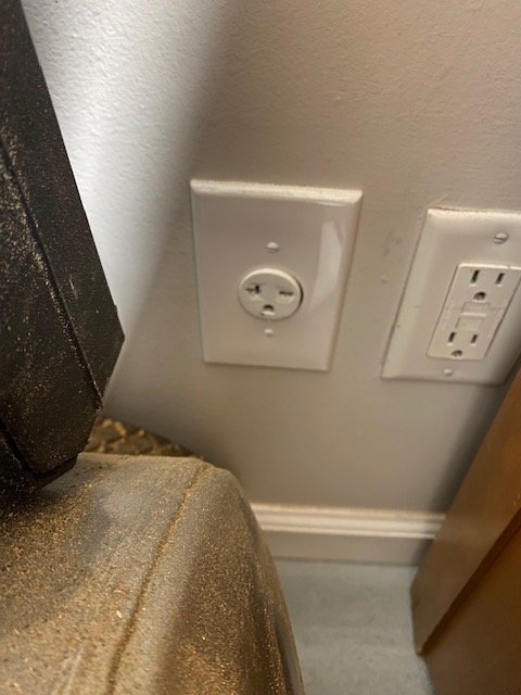

That is a NEMA 6-20R receptacle. It is rated 240V at 20A. A 15A 6-15R cord will fit in it as well. I just had one installed for my new air compressor that needed 15A. I can also use it for my kiln that needs 20A.
