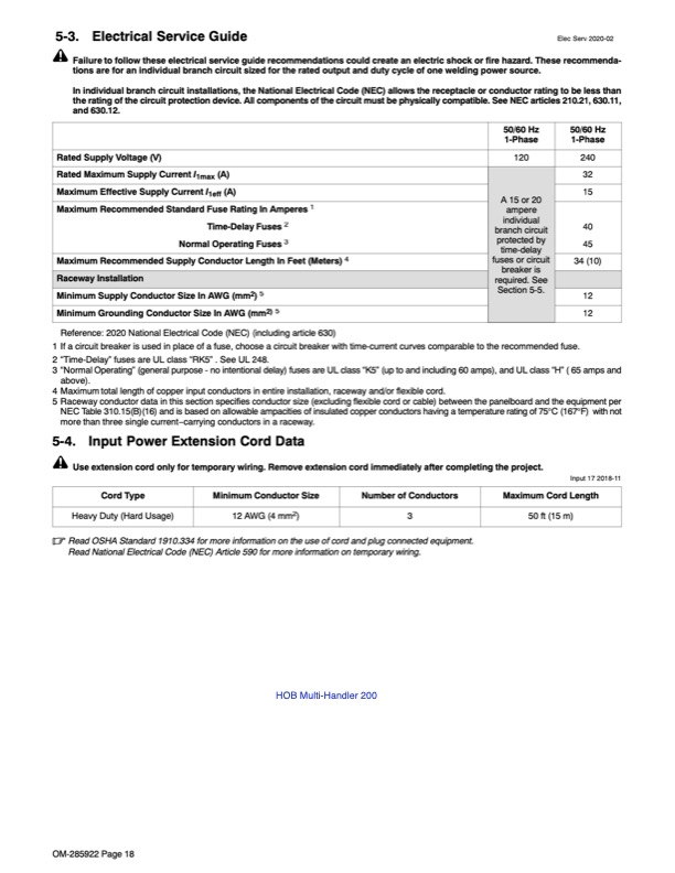

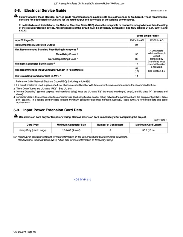

pulled a page from the owners manual 24 amps on 240 volt so that is 80% of a 30amp circuit breaker so you will need a 30 amp CB and #10 wire unless it is a really long run.
Copied and pasted this note from your attachment.
4-4. Unit Specifications For 230 VAC
Do not use information in unit specifications table to determine electrical service requirements. See Sections 5-8 and 5-12 for information on con-
necting input power.

/ Welder / Wiring for Small Garage #45
Copied and pasted this note from the your attachment.
that is interesting, did not read that but then again we are not sizing a service we are sizing a feeder and the specified current draw is exactly what is used for that calculation.

The answer to your requirements is in the printed information under the voltage/amps chart. It states that the power cord is 240v 50 amps.
Good luck plugging that 50 amp cord into a 30 amp receptacle. If you replace it with a 30 amp plug—bye bye bye to your warranty.
The chart also shows in the last column 34 max amps.

In the Manufacturers Manual for these welders there is a note (Section 5-9)that says,
5-9. Input Power Extension Cord Data
Use extension cord only for temporary wiring. Remove extension cord immediately after completing the project.
Cord Type Minimum Conductor Size Number of Conductors
Heavy Duty (Hard Usage) 12 AWG (4 mm2) 3
. Read OSHA Standard 1910.334 for more information on the use of cord and plug connected equipment. Read National Electrical Code (NEC) Article 590 for more information on temporary wiring.
Input 17 2018-11
Maximum Cord Length
50 ft (15 m)
Heavy Duty (Hard Usage) cord is rated for 600 Volts. So Cord type would need to be type SO cord or type ST cord.

At least for the last 25 years of doing electrical drawings the minimum conductor sizes for welders was given in the operators manual for each welder. See attached sheets that have been previously posted showing this. I have never placed an approved stamp on a one line drawing without looking at the engineered data in a welders operators manual. The engineering calculations are placed in the operators manual, so I never bother with figuring it out. It has become thier liabilty.
I did at times have to have pictures of nameplate data sent, so I could size conductors and overcurrent protective devices.
From the welders manuals in this thread. One manual stated the minimum counductor size being a #14, the other manual stated the minimum conductor size as being #12. Both manuals stated that a "hard service cord" of #12 conductors were the minimum for an extension cord for up to 50 feet in length. The manuals also had the sizes for overcurrent protection provided.
