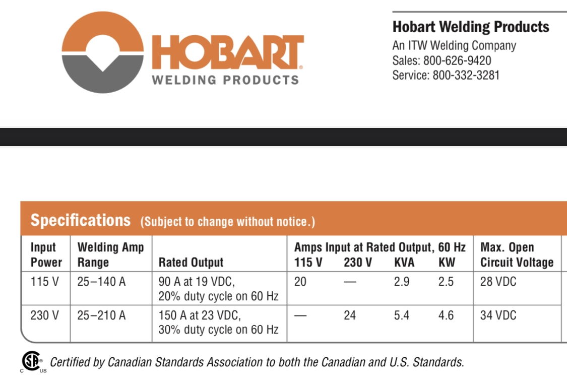

All, question on wiring and breaker for my personal use small garage.
I have a 50 amp circuit from my house to the garage on 6/3 wire (black, red, white and ground).
I planned to wire a 30 amp circuit for welding with 8/3 wire, but is that enough for say a Hobart Handler 210MVP or a Mult-Handler 200 Multiprocess? I wouldn’t ever need to weld anything thicker than 3/8”.
Handler® 210 MVP™ MIG Welder | HobartWelders
Multi-Handler 200 Multiprocess Welder | HobartWelders
Will a 30 amp circuit with 8/3 work?
Will a 30 amp circuit with 8/3 work? yes, but if inspected it may get a correction notice.
MVP 210 gives a minimum conductor size as #14 copper (see note 4 on sheet). Edit: text moved from here to below.
HOB Multi-Handler gives a minimum conductor size of #12 copper (See note 5 on sheet) Or MC cable concealed in a wall if exposed to damage.
Edit in bold to indicate text moved to correct location: but must be rated for 75 degree C. Which would limit you to individual conductors in conduit. Or MC cable concealed in a wall if it is exposed to physical damage.
This will get you by an inspector if this is being inspected.
Personally, I would use the 240 volt option with #12 thhn in conduit with a 30 amp breaker for the Multi handler. Your mileage may vary?
Same for the MVP 210, but use a 25 amp breaker. Again, your mileage may vary?

pulled a page from the owners manual 24 amps on 240 volt so that is 80% of a 30amp circuit breaker so you will need a 30 amp CB and #10 wire unless it is a really long run.

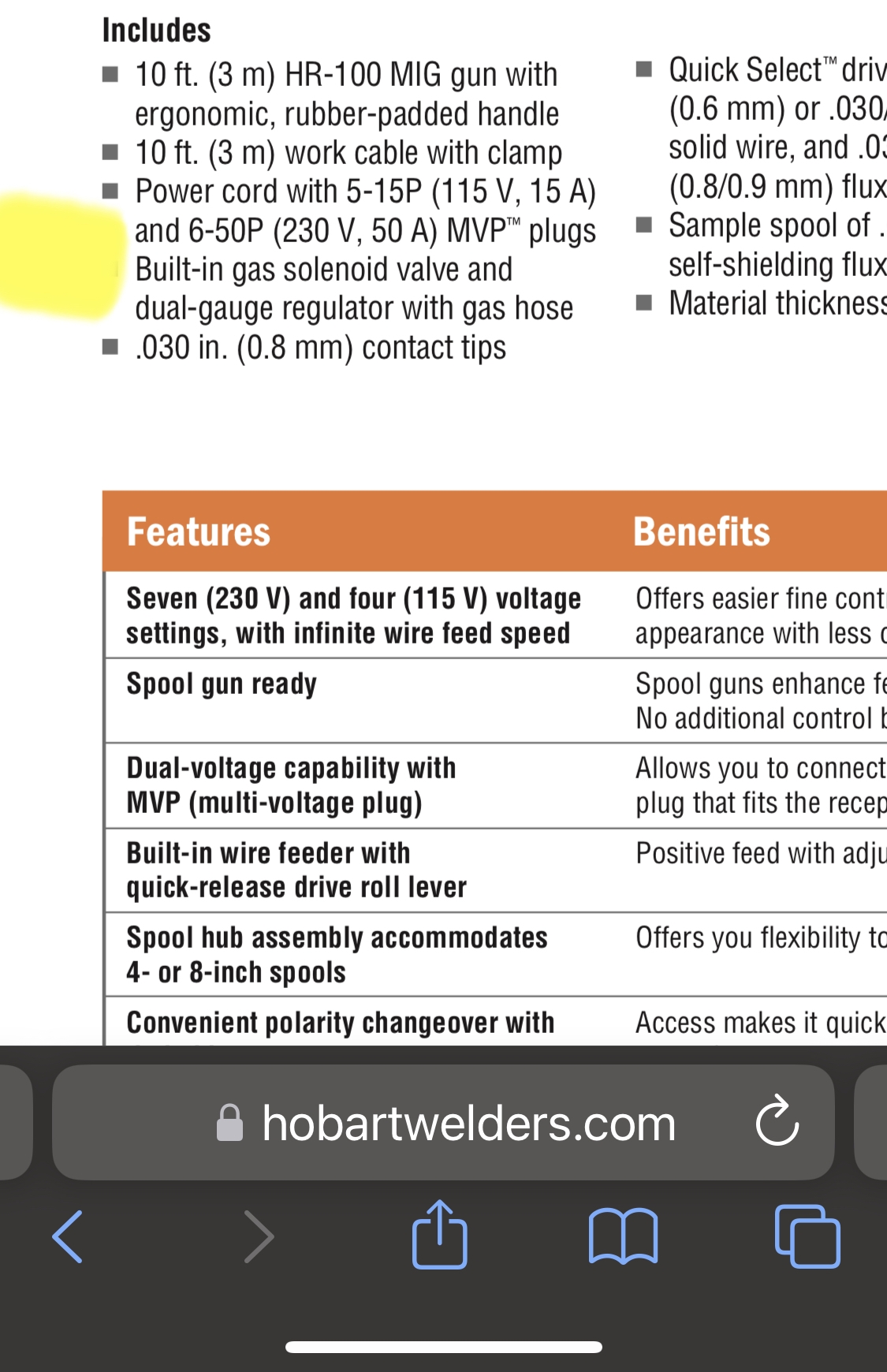

It does, but it also shows a 50 amp plug for 220 volts.
The answer to your requirements is in the printed information under the voltage/amps chart. It states that the power cord is 240v 50 amps.
Good luck plugging that 50 amp cord into a 30 amp receptacle. If you replace it with a 30 amp plug—bye bye bye to your warranty.
The chart also shows in the last column 34 max amps.
I would do 1 central 50 amp plug centered on the non 30’ wall and build up 1 50 amp cord to be able to reach several feet out of the bay doors (50 feet?).
His welder draws a max of 24 amps. A 30 amp breaker with #10 romex to a 50A outlet will be fine.
