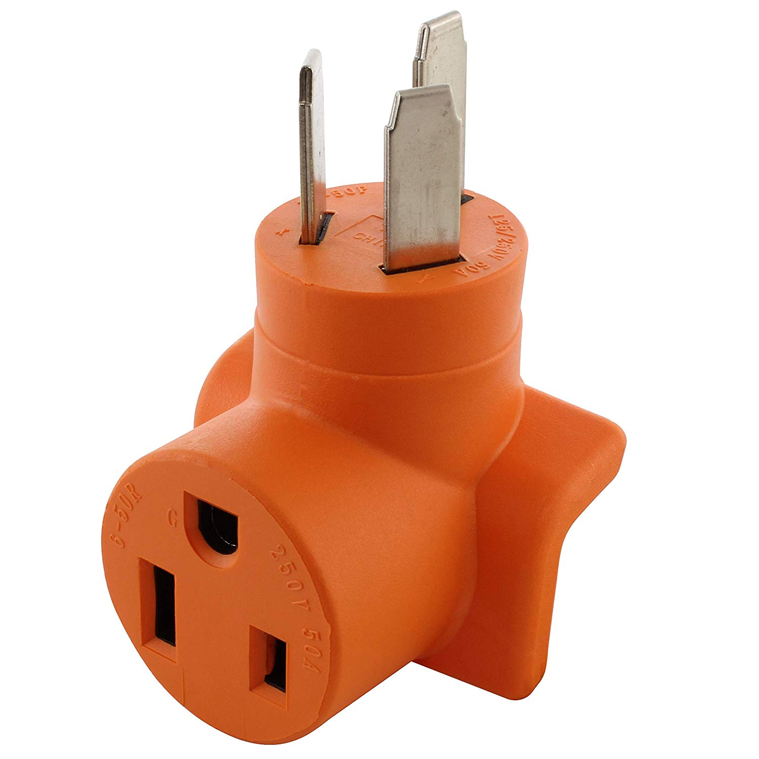

Per OM for Power MTS 251si:
3.Power Input Cable and NEMA 6-50P Plug. This is the standard plug for welders operating on 240V in the US and Canada.
4. Fuse. 30A, slow blow. (internal) This controls the main power to the panel and fans... It’s a standard automotive type 30A slow blow type available at many auto parts and electronic supply stores.
If the wire feeder quits feeding, and all other signs are correct, it may be another fuse issue. The unit has an internal fuse on the board which is a 5A fuse."
Seems we don't need as much supply current with IGBT welders as with our buzz boxes, of which mine want up to 40a and I give 'em all a min of 50 with 10-50 gear (all the way adapter as needed for MIG/plasma). btw, lotta book to read, but all one could ask for. (y)
