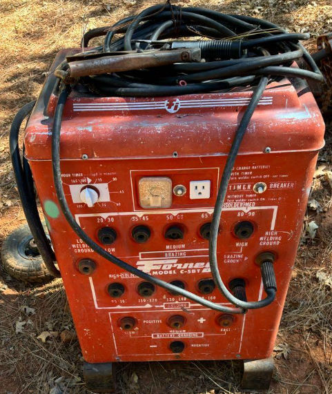

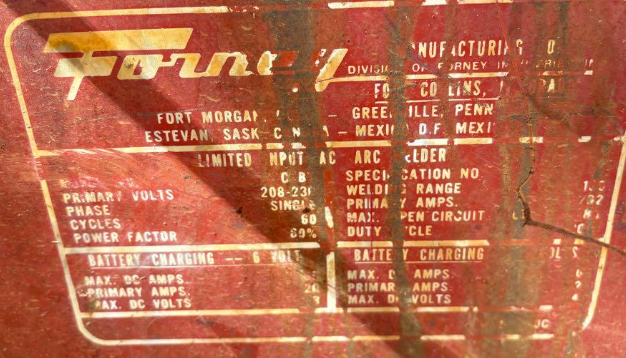

Someone's selling a Forney Model C-5BT Welder nearby. $60.
View attachment 1631505View attachment 1631506
Currently I've got an old Miller... 130? It's a 120v unit, I use it with flux core reasonably successfully. It's definitely got its limits, and won't do much to thicker metals, so I've thought of getting another welder from time to time.
I assume that I'd need to get a bottle of ... some sort of shielding gas... to use it, and then lots of practice to learn stick.
I have a 240v plug in my shop that the original occupant used for a welder.
What is this Forney welder capable of?
How would you test it?
Is it a deal at $60, about right, or run away?
That machine is a stick welder. No gas needed. Just welding rods. It looks like it is also a high current battery charger. So it has a DC as well as AC output. If you want to learn a new process then get it, the price is right. And it will certainly weld thicker metal than a 120 volt wire feed machine. For 60 bucks I would go for it if you want to do stick welding. To test it plug the thing in, put a rod in the clamp, put the ground clamp on a piece of steel, strike an arc and weld away. Except you don't know anything about stick welding. Better ask a friend who knows how. Or get the seller to demonstrate the thing. In any case 60 bucks for a brute force welder ain't bad.

That Forney is extremely heavy and welds only with AC. As Etpm said, it's a brute force machine.
I have a similar 1960's Montgomery Wards 230-AC welder. Heaviest thing I welded with it, was to put a salvaged trailer ball mount onto the back of my box blade. I think both materials were 3/8", maybe the box blade is 1/2". Running about half of the welder's claimed 230 amp capability was sufficient.
As soon as I bought a 180 amp MIG welder, I've never used the monster ever since. But the MIG welder, using .035 flux core, was at its limit sticking 3/8 material to 1/4".
You might want to buy the Forney just to play around with welding on heavy material, thicker than 1/4", if you have an application for that. That's what it's good for, heavy crude but strong farm welds.
In contrast to the elderly but indestructible Forney, there are a lot of modern welders like what Paulsharvey suggested that can do nice work. If you never weld heavy stuff then the Formey would be wasted money. But heck I would buy it just to play with it. :)

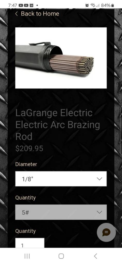

Anyone notice the Forney has a brazing plug? Is there a way to arc braze? That's a process I've never even heard of
