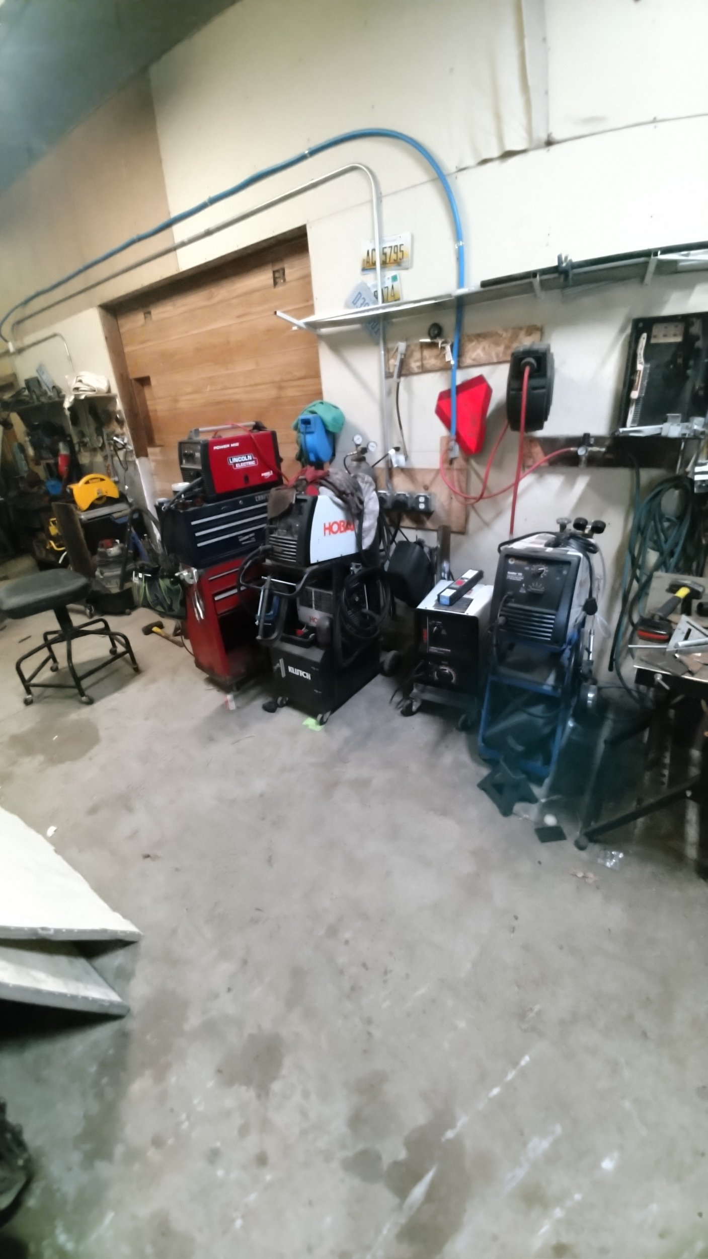

Imo Hobart is the way to go, I have a 210 mvp for mig, 190 with spool gun for aluminum, 235 lx ac/dc for stick and a lincoln 140c for flux core light duty out door welding. For heavier steel I'd try and run it off a 50amp breaker as I have tripped 30 and even 40 amp breakers when it's cranked. My only complaint on Hobart is the tap settings for amperage. Side note I'm not very familiar with hf welders except the cheap ones. Funny story I was welding for a buddy at his place with his hf flux core welder touched some rather hot steel burnt right through the lead, funny to see they use cocktail straws for the liner. For comparison at my old job I've ran over the leads of a lincoln mig welder with a fork truck did nothing and still functioned flawless.
