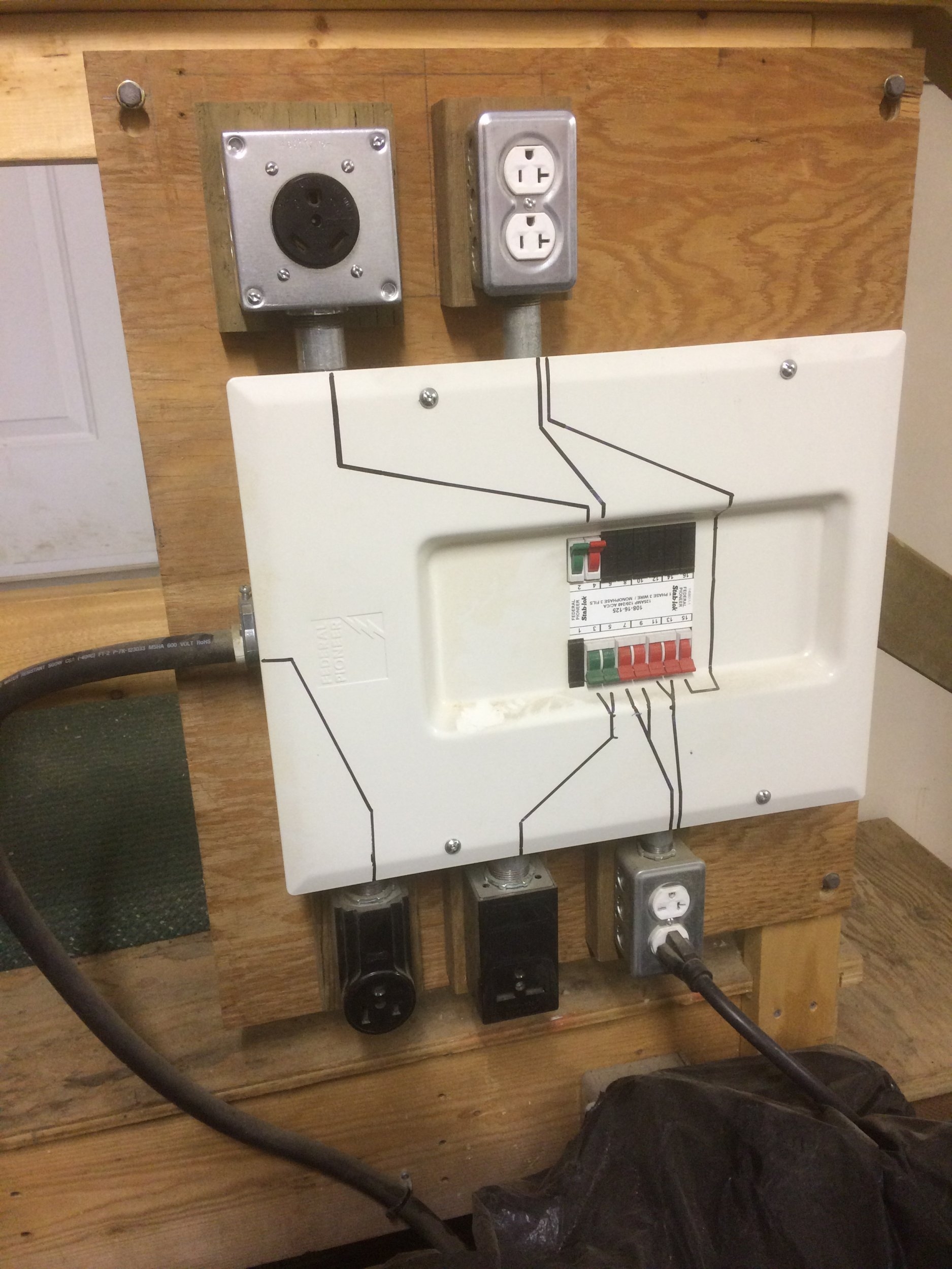

Here's what I use until I get my new shop finished. This is not permanently attached, it plugs into a 50A 4 wire outlet

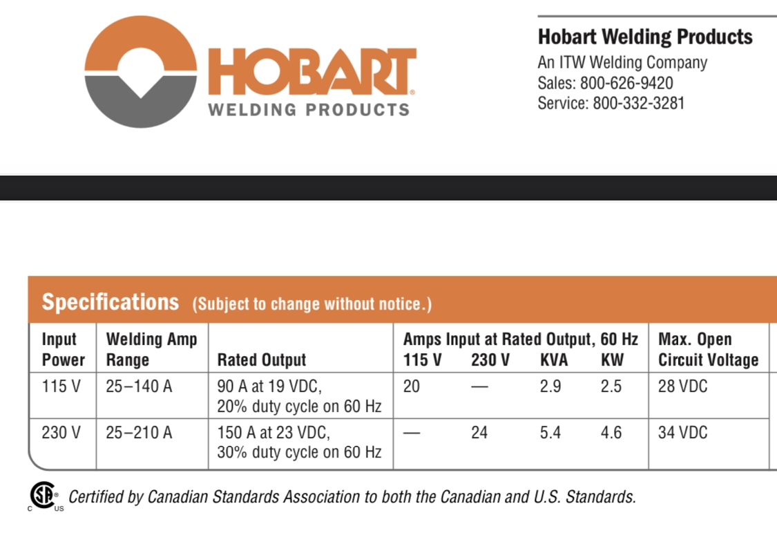

Doesn't that page for the 210 say it'll pull 24amps at 230V?
And the 200 says 19 amps at 240V?

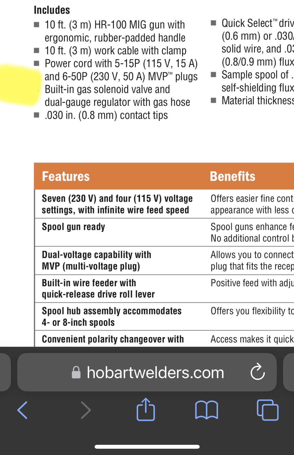

It does, but it also shows a 50 amp plug for 220 volts.
I think this class of welder typically uses a 50 amp plug as the default connector, but that doesn't mean it needs a 50 amp circuit. I have that plug on my Lincoln that I run off a 30 amp circuit. Also, if I recall correctly, a welder extension cable can have smaller wire because of the limited duty cycle, as opposed to a continuous load like a motor.
/ Welder / Wiring for Small Garage #16
I agree, the NEMA 6-50 receptacle seems to be the modern standard for welding equipment.
And, in my experience, they are commonly only wired to a 30 amp circuit.

Two things... The 50 Amp plug shown in manual is industry standard for most 230 volt welders in this class no matter what the amperage draw is for welder....
And the amperage draw shown in chart is for midrange weld not for maximum.....
If wires size dictates it can be capable of amperage draw for welder, it still may be a case of breaker being to small for load....
I have Hobart Handler 140 the stated max draw at full out is 20 amp.... But I kept popping breaker .... When I did calculation of the KVA value at 120 volts it stated max draw was actually 24.6 amps...... Had to go to 30 amp circuit too keep from popping breaker on my machine at full amperage/voltage settings...
