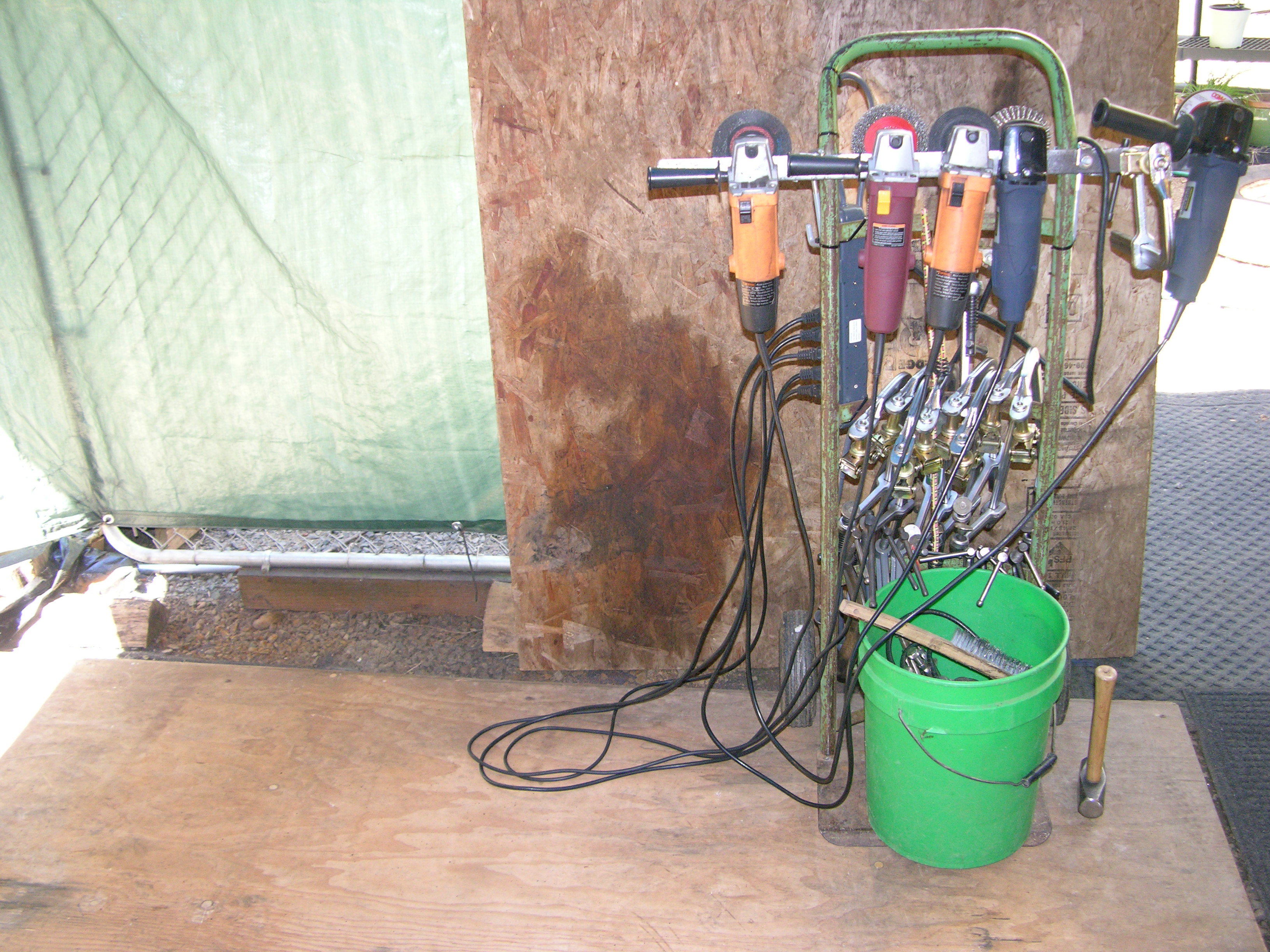

/ New to welding #113
Re-purposed hand trucks - this one has a power strip tie-wrapped to the back, so just ONE extension cord needed - looking at your situation, you might wanna relocate the axle to use bigger wheels (same for me, just haven't got around "tuit" yet); 13" are MUCH better)
piece of 1/8" FB lets MOST side grinders just slip over it and hang. For transport, I just grab the whole bundle of power cords somewhere near the middle and hang it up over the hand truck handle... Steve
BTW, as shown these can be a little tippy - I later put a couple of those rectangular buckets kitty litter used to come in, moved clamps down to those - improves balance noticeably - the OTHER advantage: easy to move those "too portable" goodies back into secure storage when yer done...

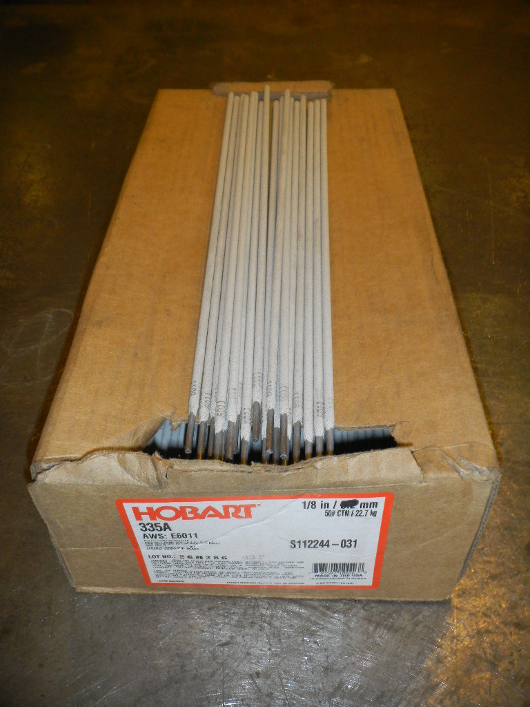

#116
These were 1/8" 6011's ran at 70-95 amps. Should I have tried hotter for it to arc and not stick easier?
/ New to welding #117
Did you put the ground lead in the 6010 port on the welder?
I really like Hobart's 335A 6011.
/ New to welding
#118
SA, that's actually a really good question, and gives me hope I had it hooked up wrong. I was between packing when it was delivered & I remember deciding between 3/32 7014 or 1/8 6011 after my leads were hooked up. We'll see when I get in Sunday or Monday I'll be sure to hook the leads up correctly and see if it gets going easier. I do know after I got the weld going it was easy to keep it going, it was just getting it started! But I can see the addiction, watching the Puddle and the arc digging in like I've watched videos of and read about. Pretty cool stuff!
/ New to welding #119
I've found with my PowerArc 200ST. ESAB's 10P-Plus 6010, and ESAB's Acclaim 7018 run the best.
When running 6010, or 6011 make sure the ground lead is in the 6010 port on the welder.
