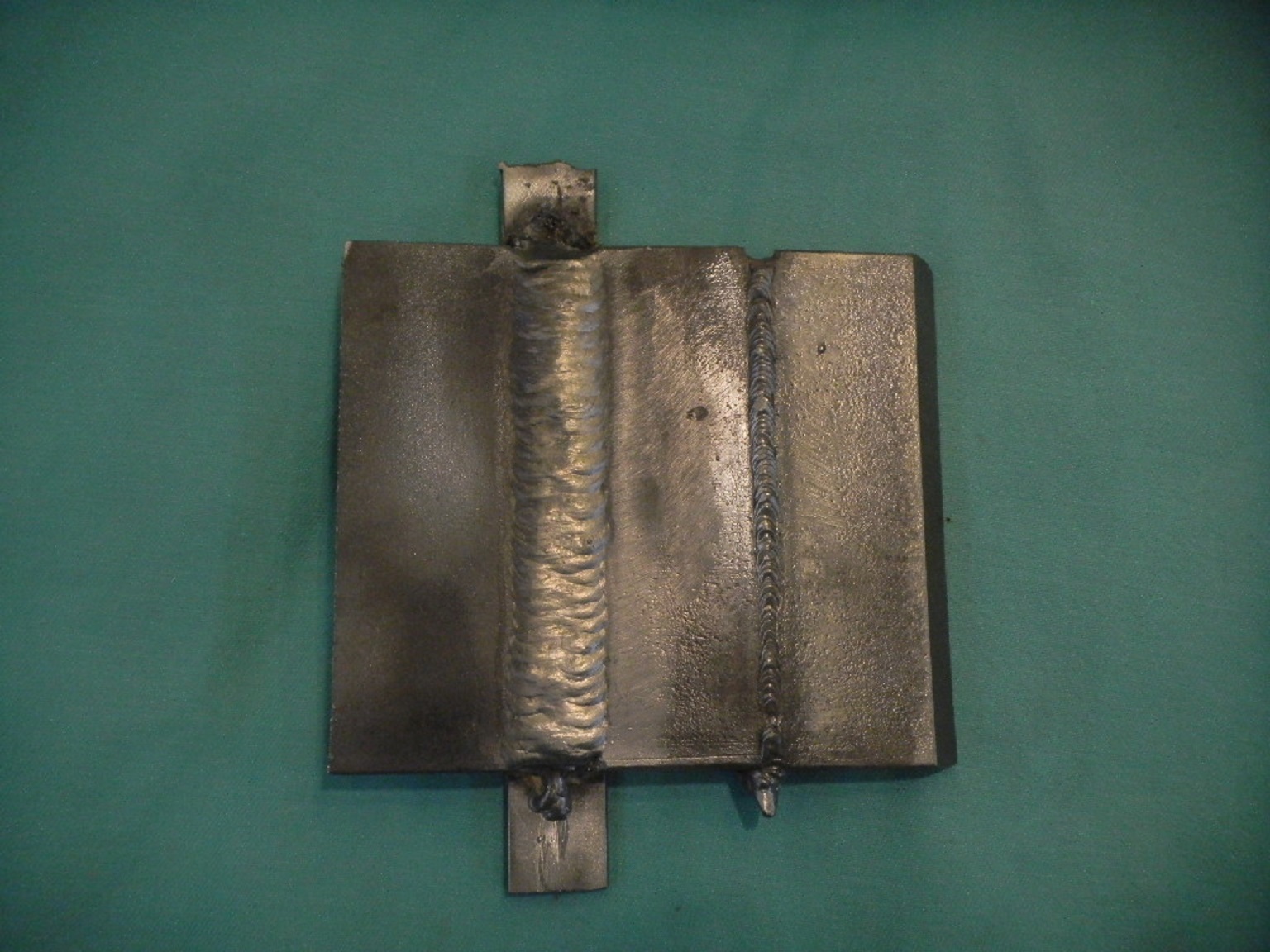

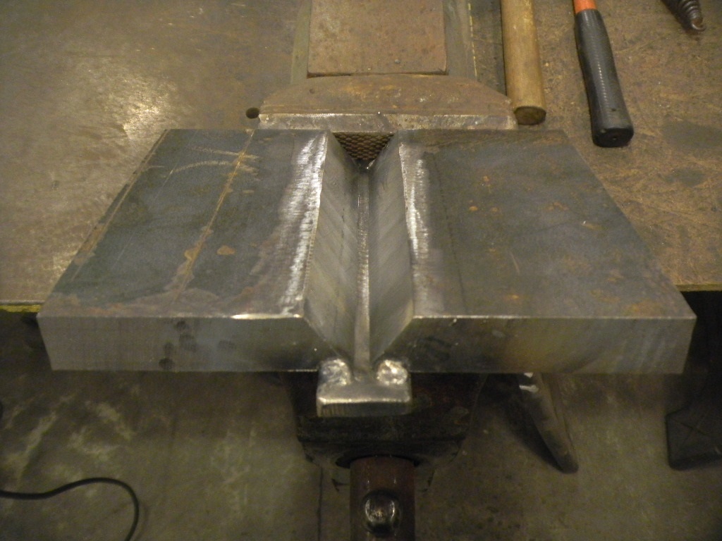

Question, can I run stringers vertical and make multi pass beads that way until I get good enough to weave? Or is it best to do a single stringer & learn to do a weave over that?
When I was in welding school. We had to pad weld in all positions. Flat, horizontal, vertical up hill, and over head. Personally, I wouldn't spend a lot of time on pad welds. Fillet welds like I posted, and lap welds, are more real life welding. Not very often do you pad weld a flat plate in real world welding.
When you do fillet welds, you can do 3-pass welds, 6-pass welds. Really there is no limit to how many welds you can make.
V-butt plates are very good practice too. If you have a way to put a 30 to 37 1/2 degree bevel on the plates. You can run stringers to fill the V-butt, and a weave pass for the cap.

Definition of 'pad weld'?
Also, is that backing plate welded integral with the heavier plates, or somehow not bonded and removable to leave a flat back?
