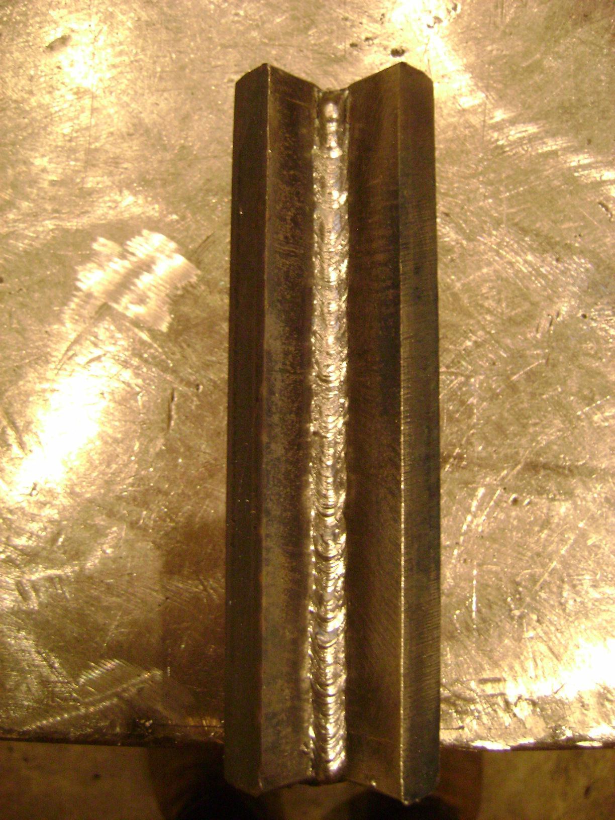

Coming from the structural welding world, I don't believe in welding vertical down hill. Now pipe lines, and a lot of pipe is welded vertical down hill every day.
This is 7014 vertical up hill.

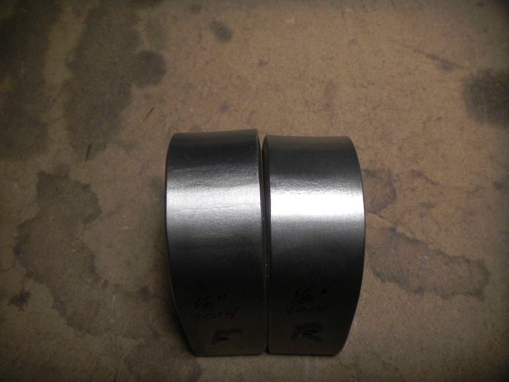

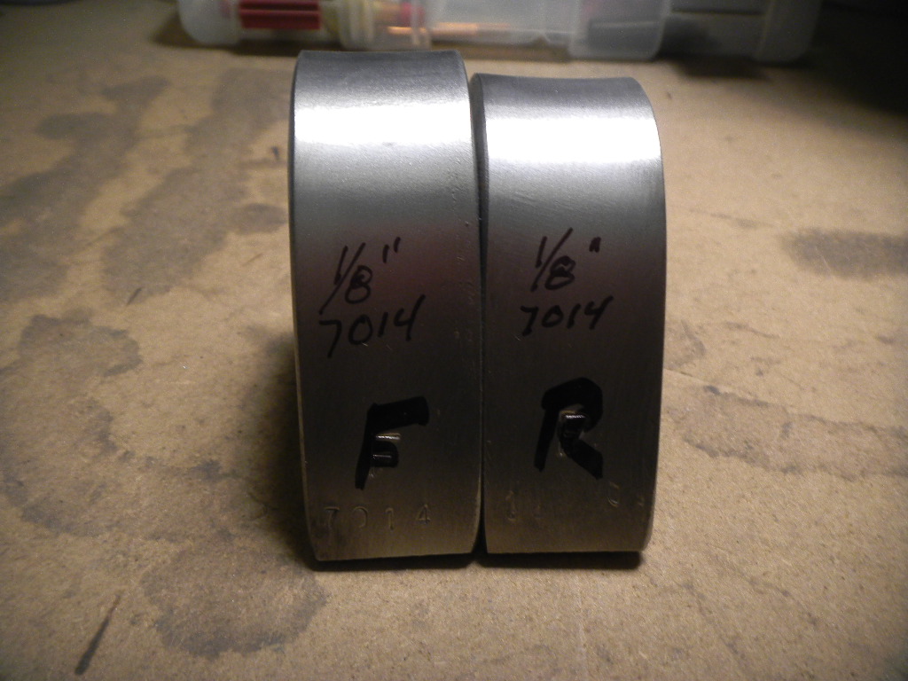

Here is some more 7014. For the majority of the welding that members here will do at home. Anything that can pass a bend test, is good enough.

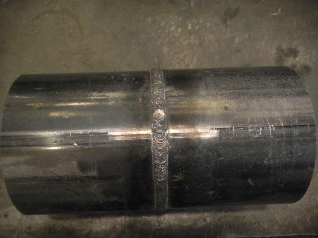

Just something for you to try, to see if you like it. When doing fillet welds, or V-groove welds with 6010, or 6011. Run a U pattern. At the bottom of the U close up the arc length, so it fills in better.
I used a U pattern on this pipe weld.
Do you slow down also like a slight pause at the bottom of the U? Or just close up the gap as you get in the bottom then start to lengthen it away from the plate as you go back up at one fluid speed?
I tried the inverted T I think is what it's called. Where I go up, come back half way and wiggle side to side with a slight pause each side letting the puddle flow in. It definitely laid more metal in but I was inconsistent and felt like I could fall out of practice with it pretty easy.
/ New to welding #220
At the legs of the U I have a longer arc length. This helps cut out any wagon tracks on the weld underneath.
At the bottom of the U I close up the arc length to fill in better. I try very hard to keep moving, never pause!
