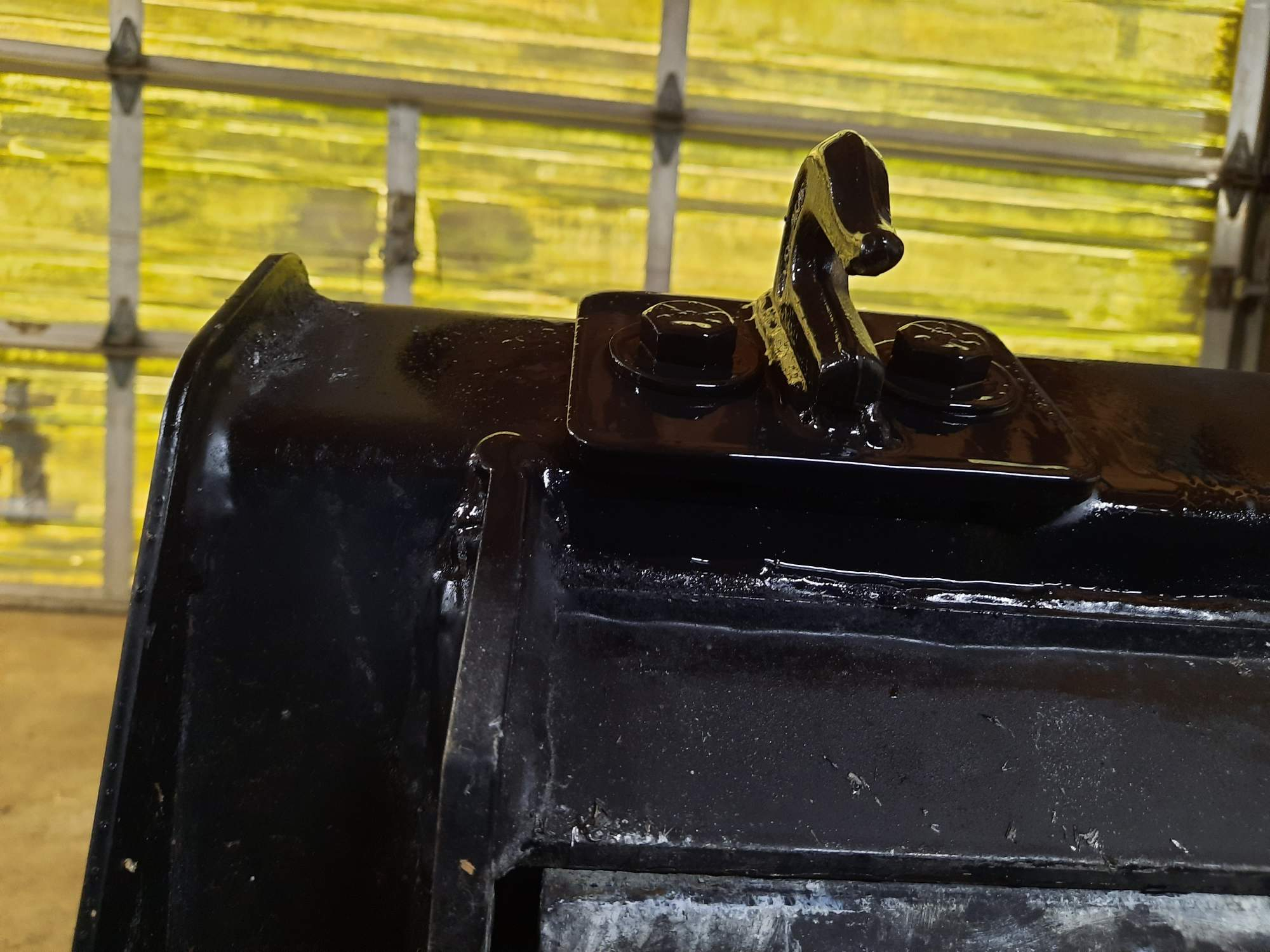

I used Bolt On Hooks also, Two on the bucket. My dealer offered to weld them on, but I decided to drill instead. I guess I didn't want to mess with the paint job. Like it matters on the bucket anyway. Larry

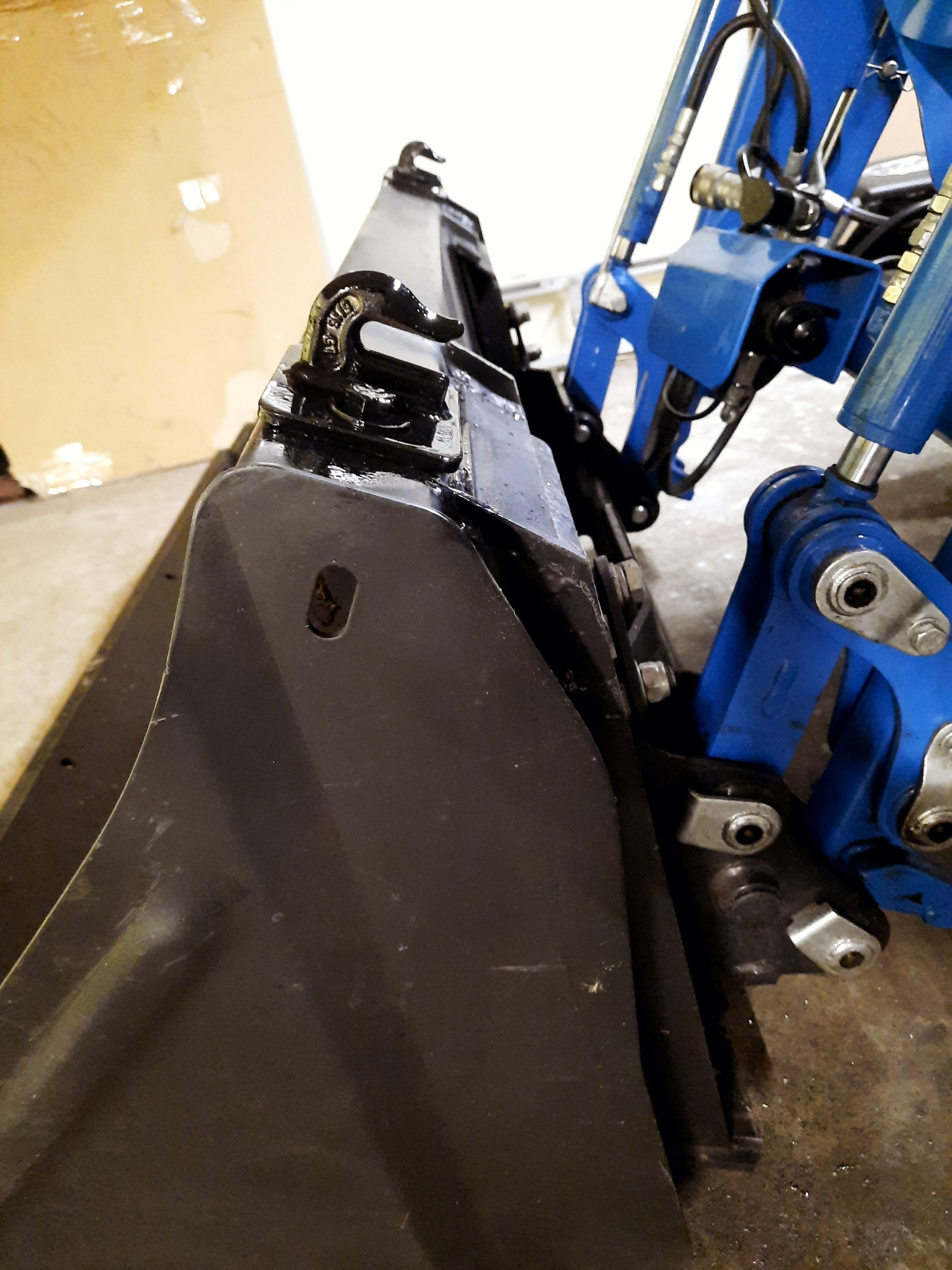

Welded 3 hooks on a 1/4 plate, and mounted the plate on the top edge of my bucket. One hook in the center, and the outside ones in line with the lift cylinders. Used 1/4 U-channel underneath the bucket top edge as a back-up plate, and grade 8 bolts and tight washers. It isn't going to bend. At least, not with anything my tractor will lift. Lifting a heavy load with a hook on the outboard portion of your bucket can easily tweek your loader frame. It will also get the rear wheel opposite the lifting hook up in the air. Have done that even with my configuration. That can get exciting, and make you lower that load in a hurry. Learned to spread out the load side-to-side evenly using at least the 2 two outboard hooks.

Did they come with a plate to backup under the bucket? Some buckets are kinda thin on AG tractors so they tend to distort when working the hooks hard. Especially when mount far from the welded ends.
Yes they did come with backing plates.

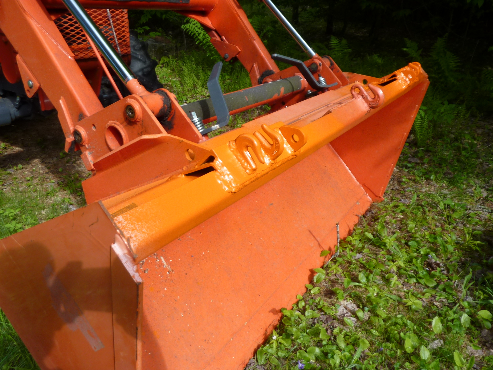

Mu Kiotii came with holes already in the bucket. I have a welder but Im not good enough at it yet so I use this, one set on each side of the bucket. Works great. If anyone is interested here is a link to the carabiner. Plenty strong enough

Carabiners are generally not for hoisting or lifting. Not near the safety factor. Some Okay for for personal fall protection.
Done my share of down on the farm rigging before learning the importance the right way and right equipment.

I have three hooks. always have always will. Hooks on the side for light work.
hook in the center for HEAVY work. It doesn't do the mechanism any good to reef the heck out of one side.... plus you can get your tractor airborne.
Welded on or bolted on, is the best. I see the guy with the grab hook attached to a hole with some hot link or shackle. I know it works, but it's a bit awkward. Buddyamine did that to a small tractor and it's kind of a pain in the butt compared to a fixed sold mount.
I use two hooks in line with the lift arms, but never lift with just one. Fasten chain to each hook and connect in the center of the bucket. The lift chain drapes in the center of the bucket to maintain balance when lifting, but the stronger sides of the bucket support the weight evenly.
