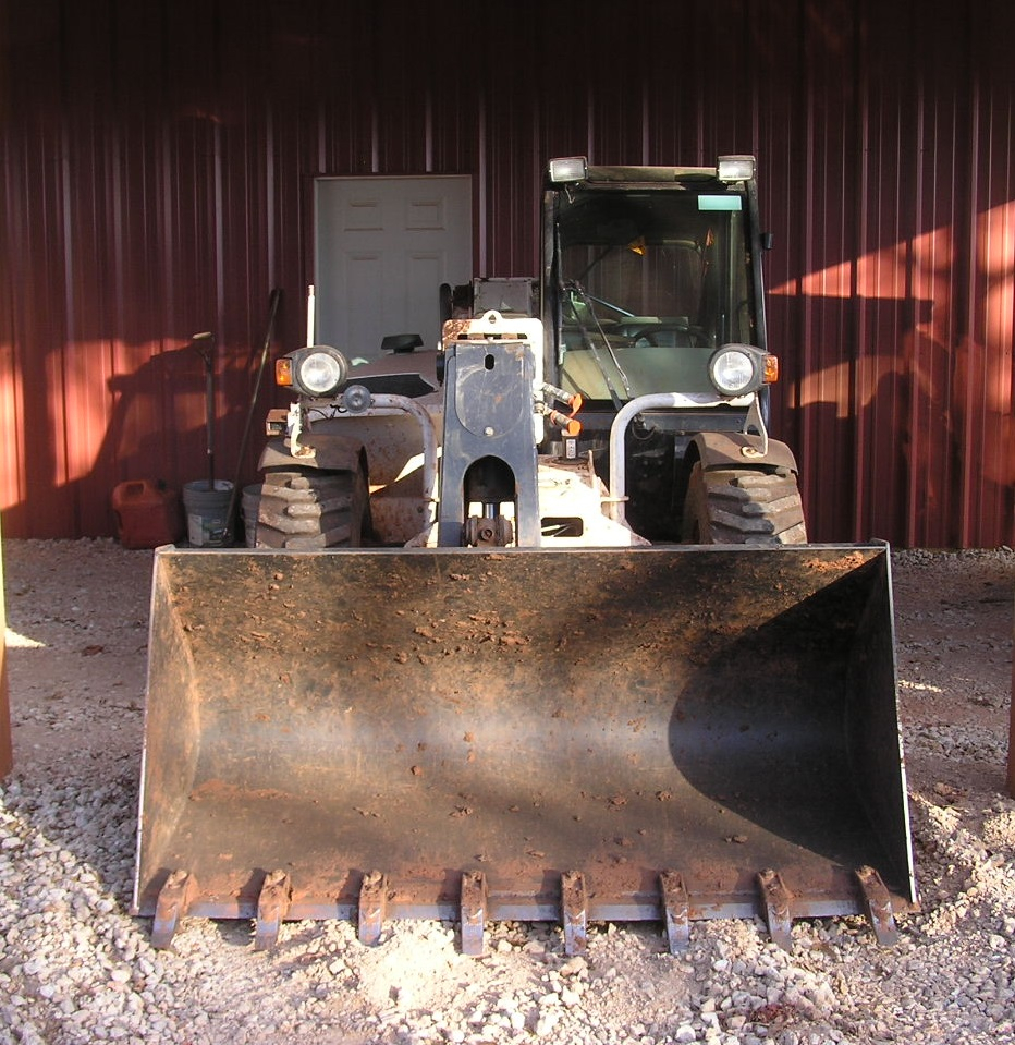

The SSQA on the V417 has chain slots:

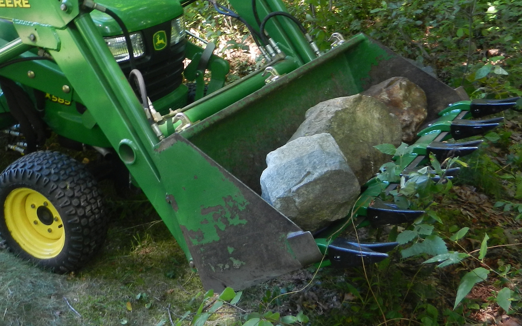

I use two, and use something off the center for heavy loads. Use the lifting tongs to hold logs off the ground for bucking. Weight stays in the middle.
This was just a glamor photo, lol.

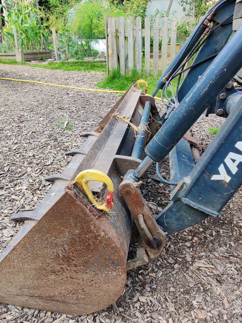

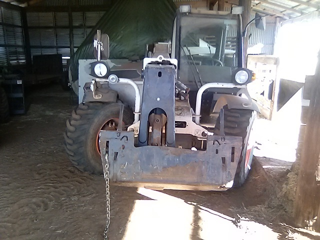

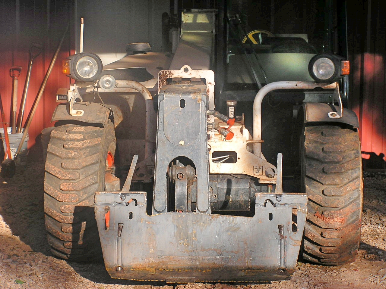

Actually.... You could use the ovals...
There are on sides of my FEL bucket, took a while to figure out what they were for........
/ Hooks on FEL Bucket #55
Good idea, I will look on the backside to see if it is flat.
That would be perfect for the chain in the picture since it only has one hook (y) .

/ Hooks on FEL Bucket #60

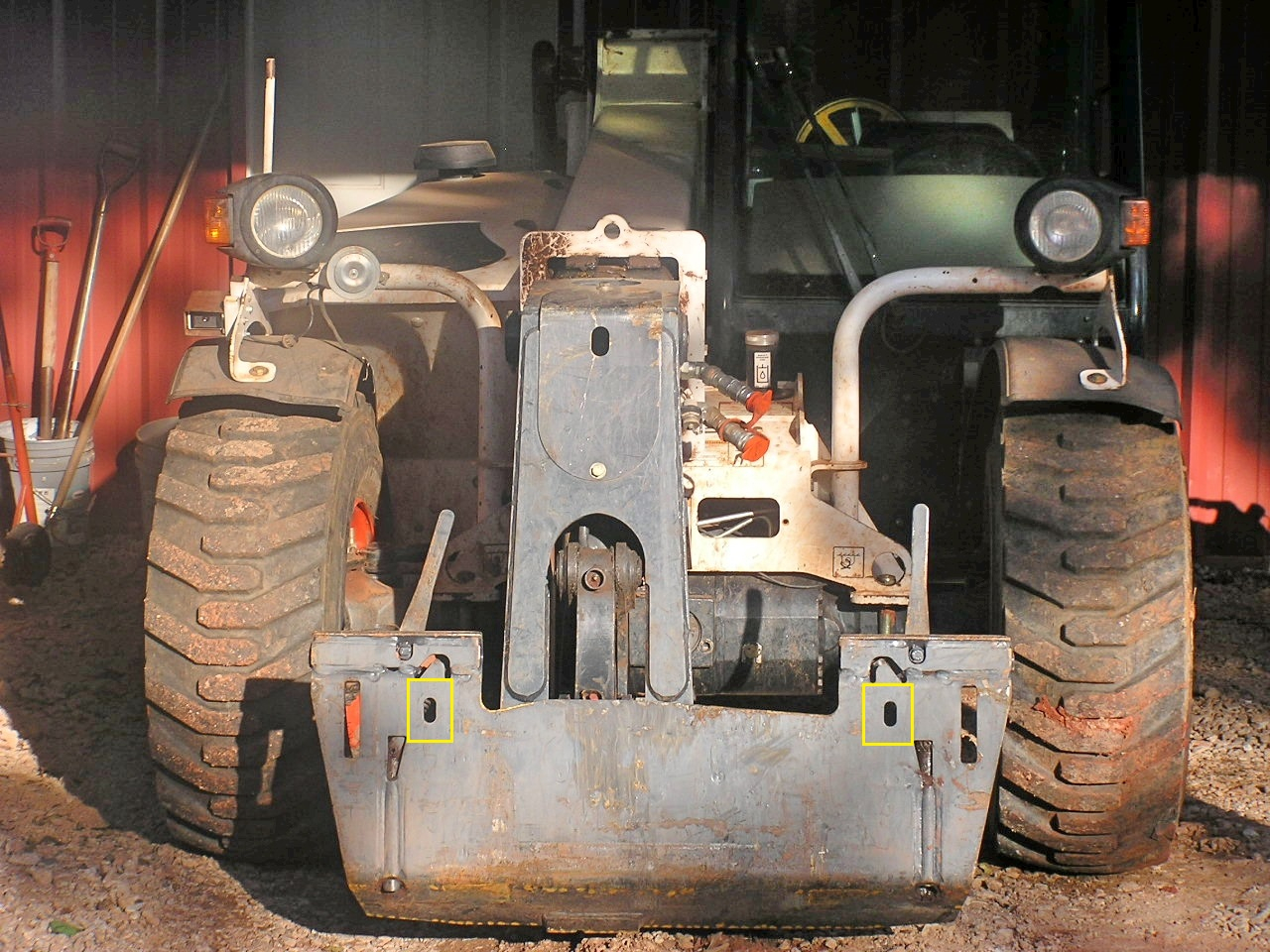

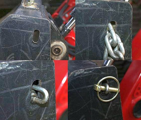

The ovals will work, thanks for the tip.
Found a picture of the backside that shows the oval holes:
