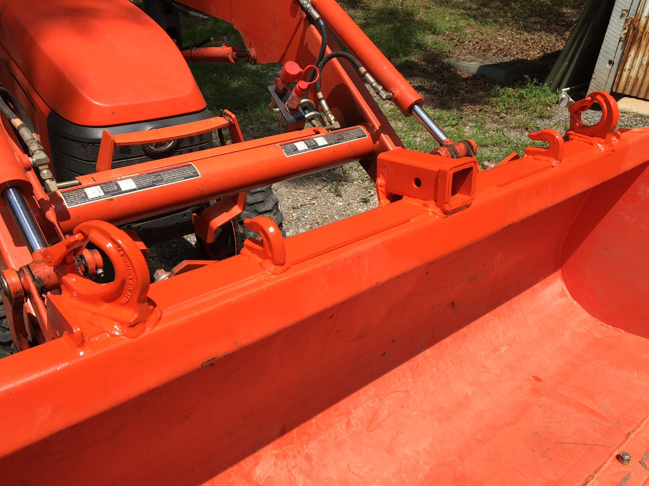

New tractor coming and I want hooks....any difference between weld-on and bolt-on...? Rather do bolt-on than have to pay a mobile welder....
   / Hooks on FEL Bucket #82
Your dealer's service department could probably do it, if you prefer welded on
If you go with the bolt-on, you might want to add a doubler plate on the inside of your bucket
   / Hooks on FEL Bucket #83
Biggest difference would be how it spreads the load into the part of the bucket the hook is attached to. Lots of variables there. One good thing about bolts vs welds is sometimes things just 'look' welded but the weld is poor and sudden catastrophic failure of the weld is possible. If a bolt is going through a hole it isn't fooling you.. it's bolted and it's about as strong as it's gonna be. So a bolted connection is better than a POORLY welded connection.. but with good welding the welded hook is probably overall stronger as it will spread the load into the bucket over a larger/wider area rather than pulling up just on the areas right around the bolts.
In practical terms though the buckets strength where the hook is attached is going to be an issue way more often than whether it's bolted or welded.

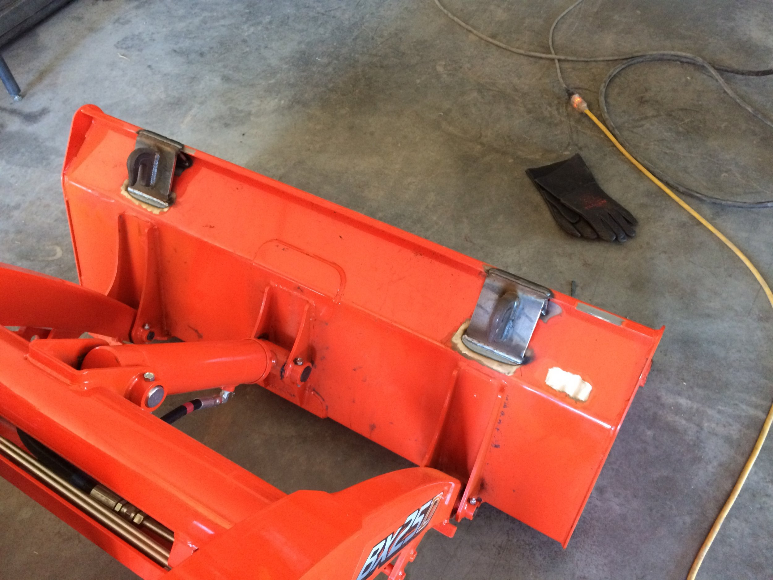

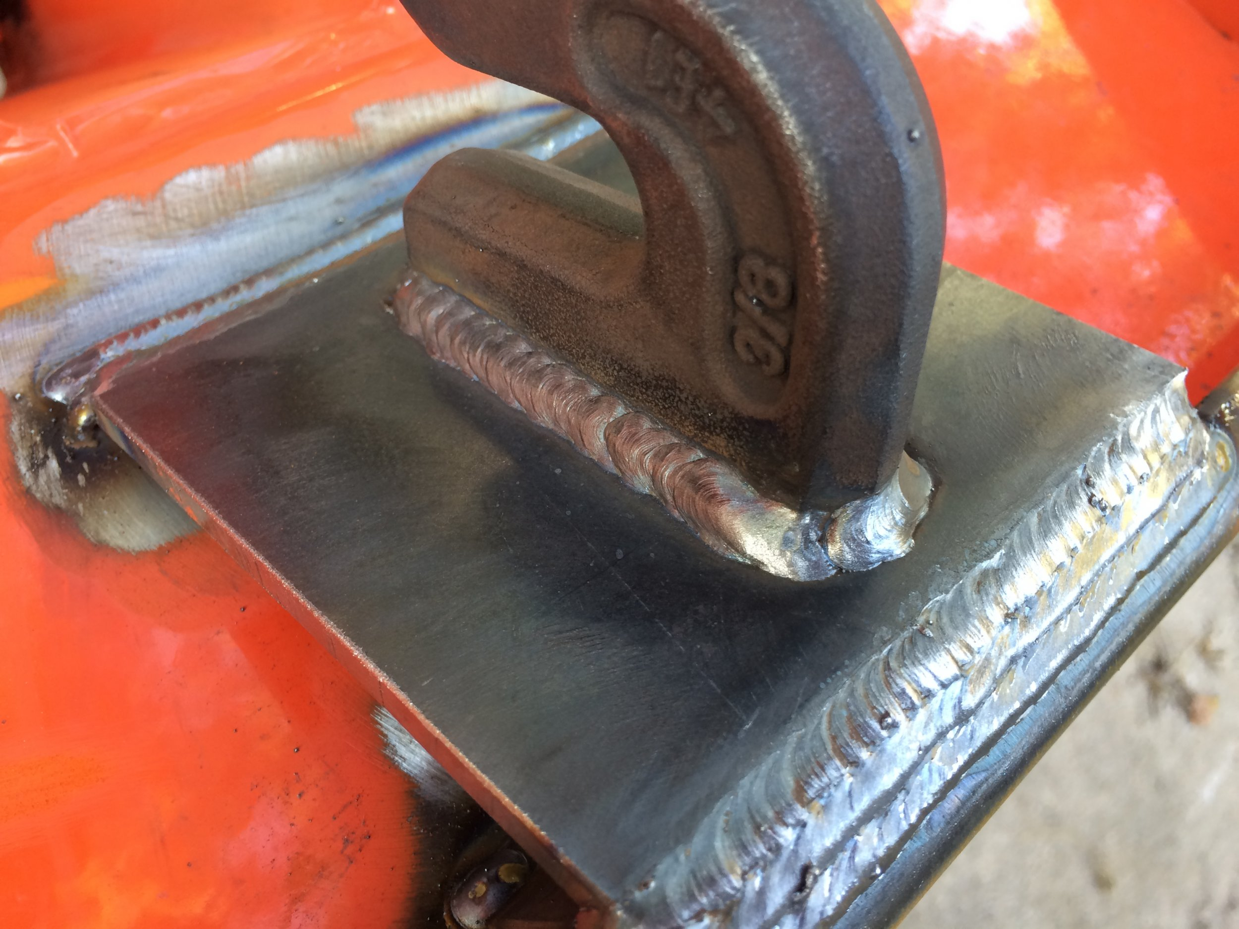

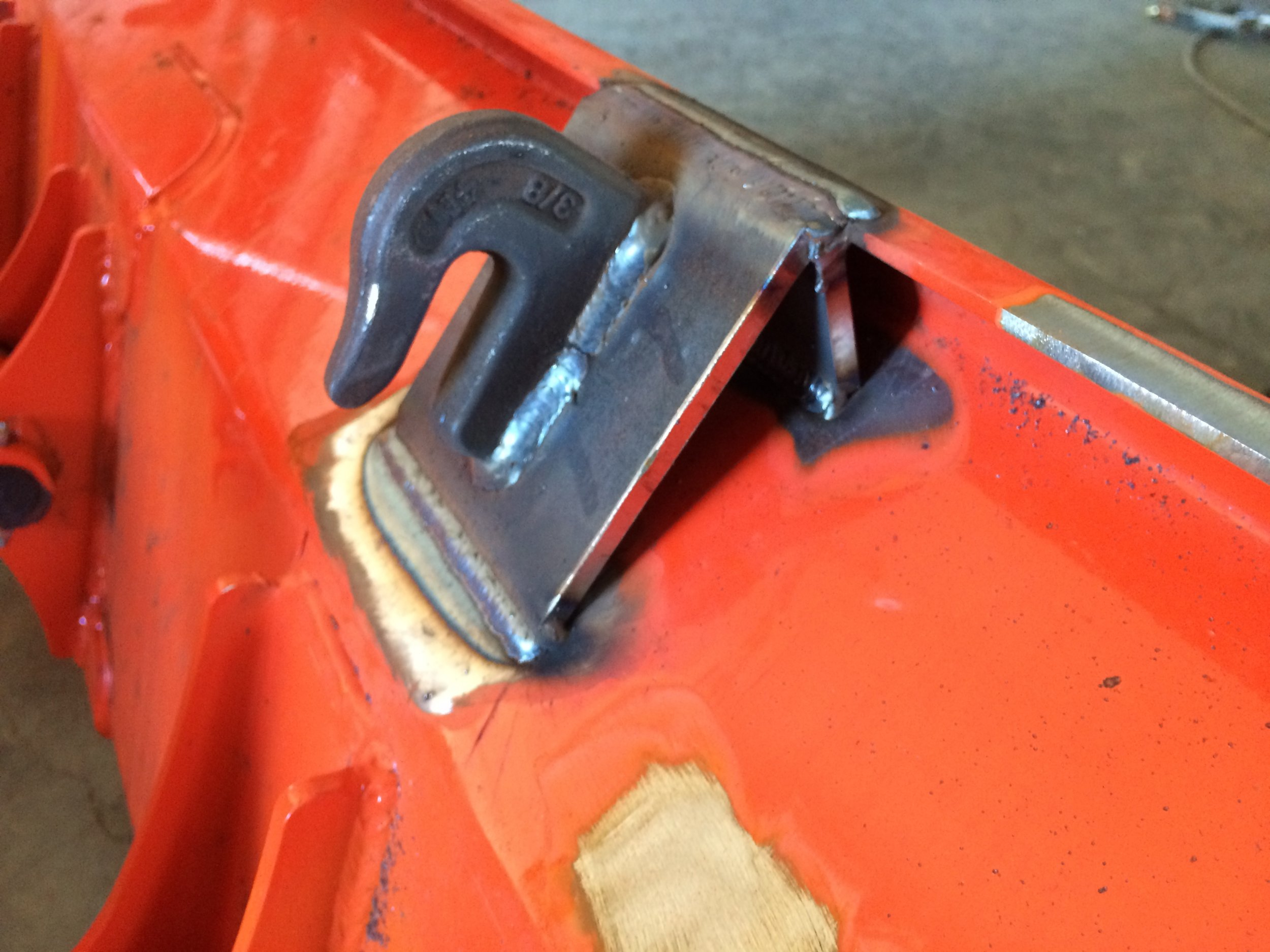

What I did was to use a standard 3/8" hook that I modified to look like the special weld on ones and I then welded that hook onto a 3 x 4 solid plate* (1/4" flat) and then welded that plate onto my FEL bucket.
Total cost? $0.00 as I had a spare hook on hand.
That's probably 12 or more years ago and I shur have worked it often to the point of lifting my rear off the ground.
* thought was to spread the load.
No welding required.... 2x2x1/4 angle iron, hacksaw, grinder, 'lectric drill....

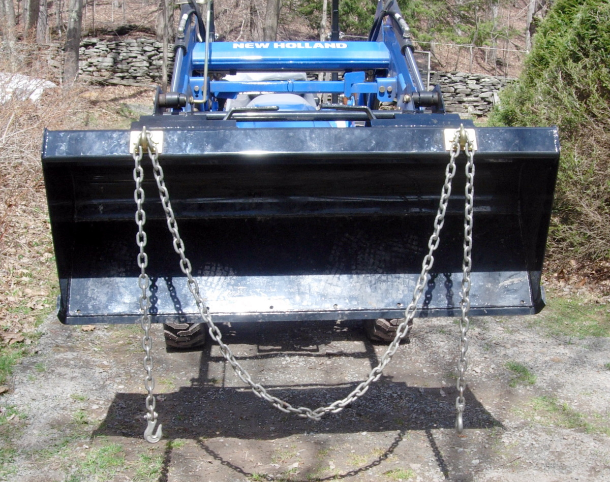

You can just get a 1/4” piece of flat steel that is the length of the top of your bucket lip. Take that to a welding shop and have them attach hooks to the steel. Then drill and attach the bar to your bucket lip with grade 8 bolts. This is a better approach than just welding or bolting the hooks to your bucket because it strengthens the entire bucket lip. I actually used angle iron instead of flat bar, but either provides some additional strength.

Mine came with a single hook in the center of the bucket. Quite often I wish that I had two, especially when lifting things out of the back of the truck.
You must have seen my welding skills. For that reason I'll be buying a pair of bolt on hooks, mounting them above the loader arms. My bucket is stout enough so that bending it is the least of my concerns, but I don't want a load that far out on my bucket.

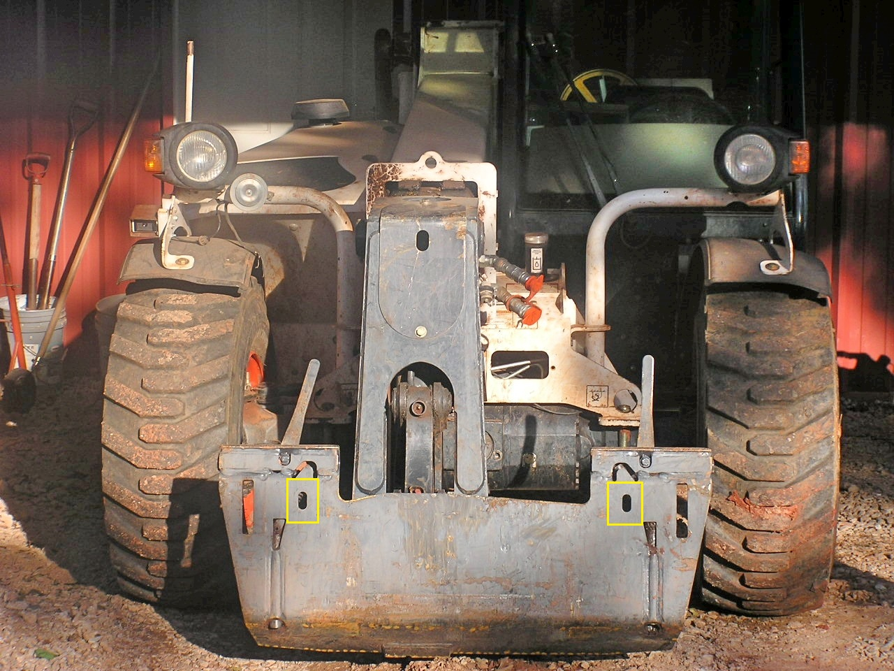

IF you need to tow something from front end.... Go right to tractor chassis. As my SCUT didn't have anything on front to attach to, solution was simple....
dsc02246-2-jpg.694616
img]
I agree with that. Like you said IF you need to tow from the front, that's seems a lot safer. Tractor time with Tim just did a video about weight on the front axle, using the loader. I would like to see how much pulling from the front changes the weight distribution. If the chain connection is at a point higher than the axle, in my simple mind, it has to increase the weight. Even with rear ballast.
