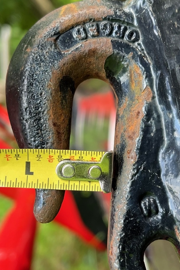

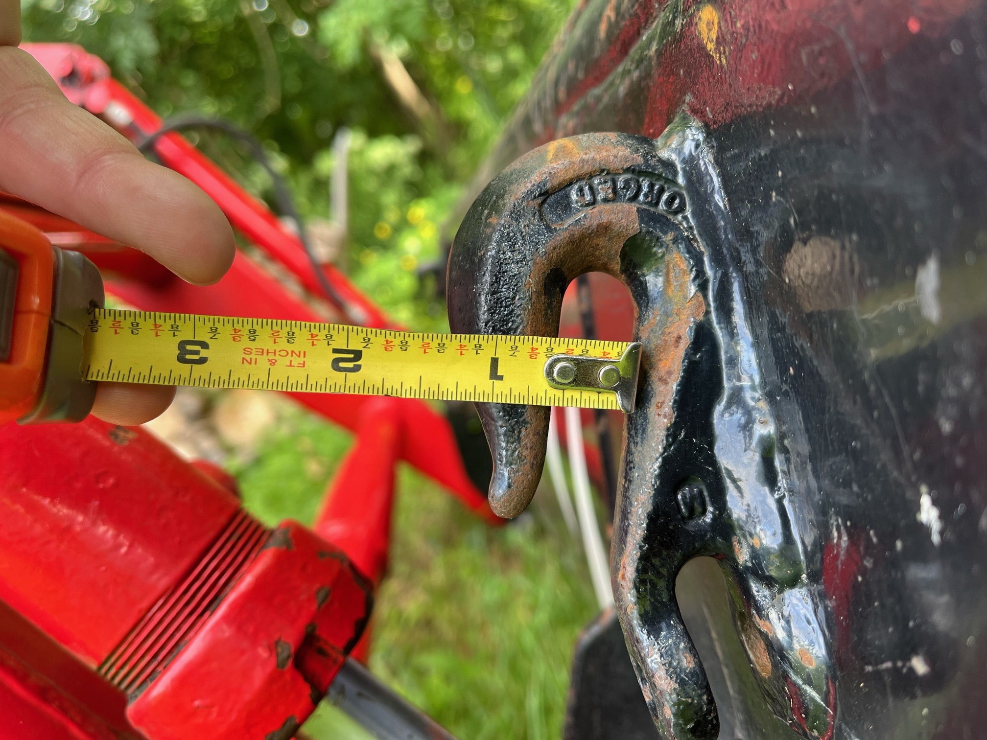

I recently bought a tractor that has hooks welded to the bucket. No marks on the hooks telling me what size they are.
I believe they are 1/2". Is that correct? Planning to buy a chain and want to get the right size.

Those do appear to be half inch hooks. You could use half inch chain but if you go down one size they'd probably be easier to work with.
/ What size are these hooks? #3
Can you read whatever is cast into the hook? May help. I'm guessing they'd work better with 3/8".
/ What size are these hooks? #4
Standard hook opening measurements are as follows:
Chain SizeHook opening
5/163/8
3/87/16 to 1/2
1/25/8 to 11/16
This can be verified by checking hook drawings and dimensions in the McMaster-Carr catalog, which is from where I lifted this information.
