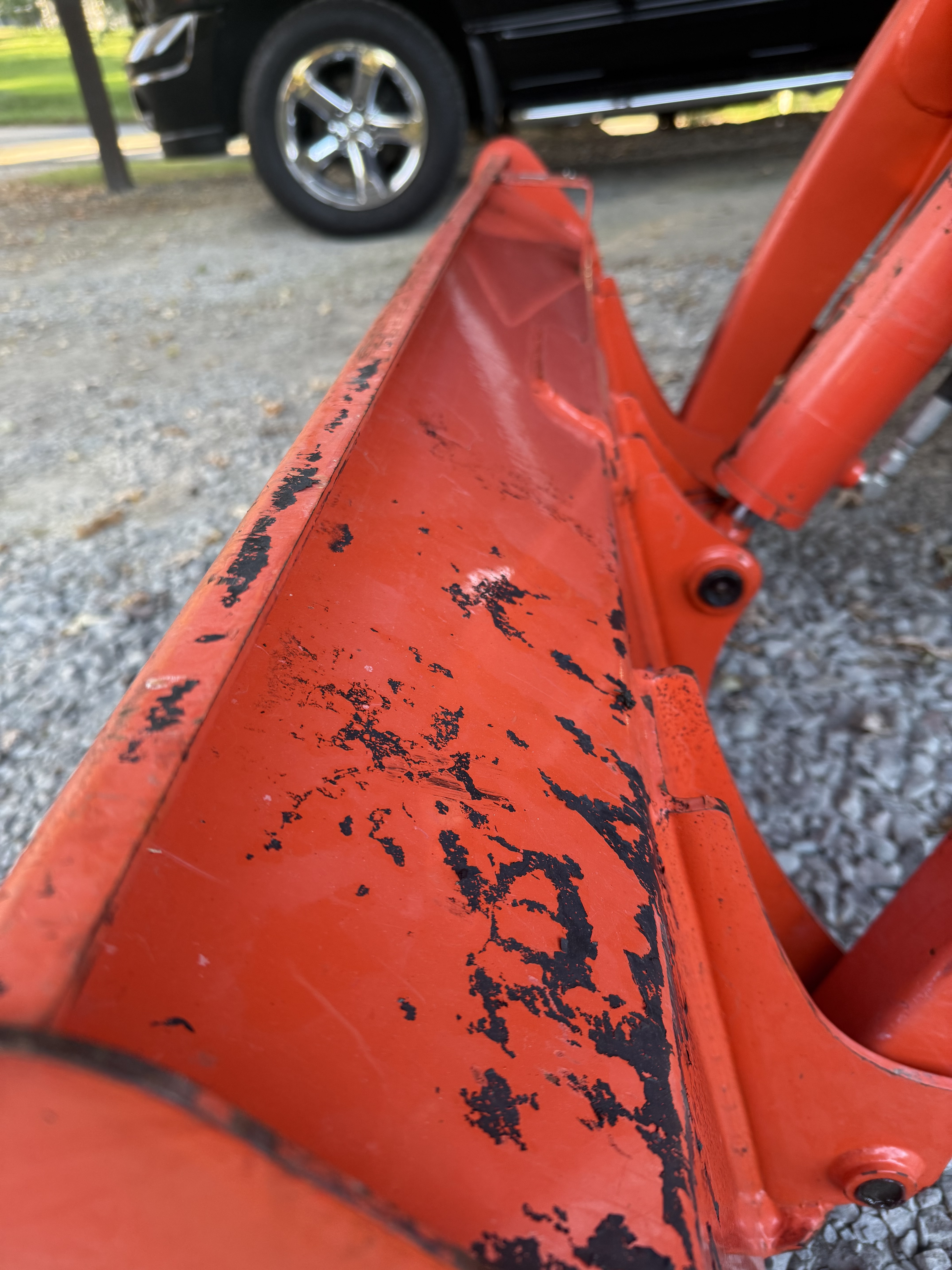

Kubota BX 25 I want to add Bucket hooks, are these good? which style?
Thank you for the help.

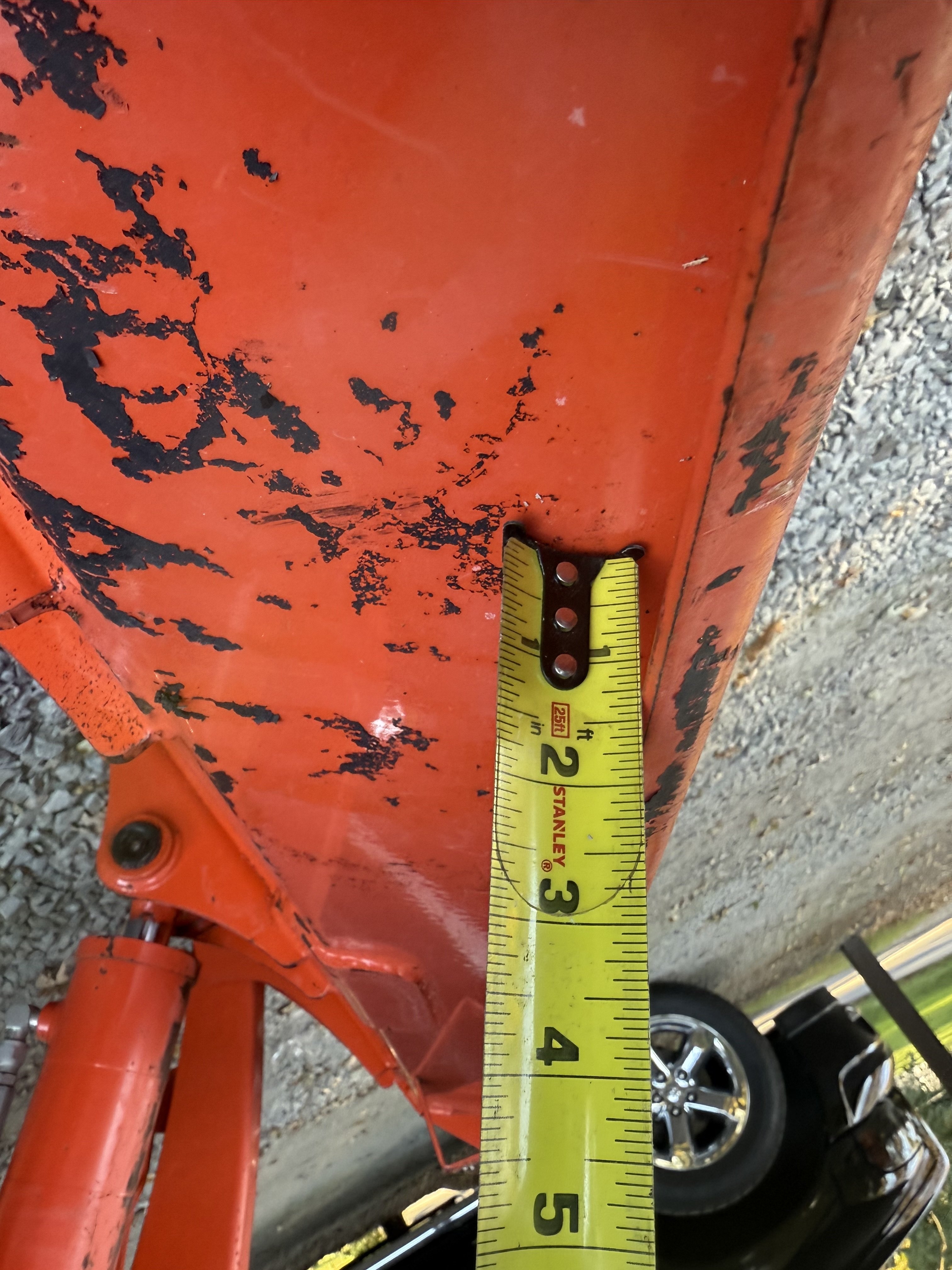

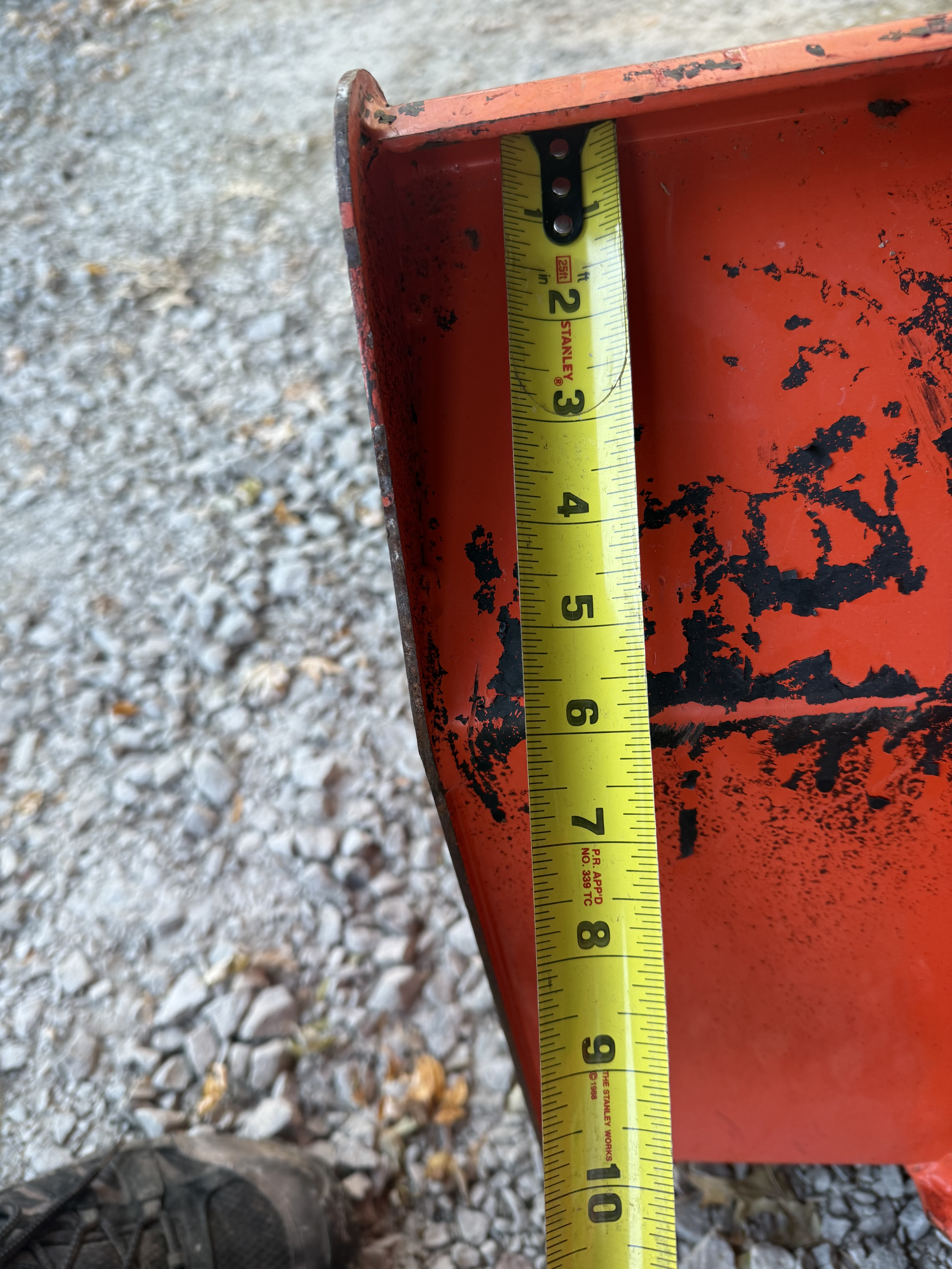

Ken I will send some pictures in a day or two. Thanks
   / Kubota BX 25 Bucket hooks, are these any good ? which style?
#9

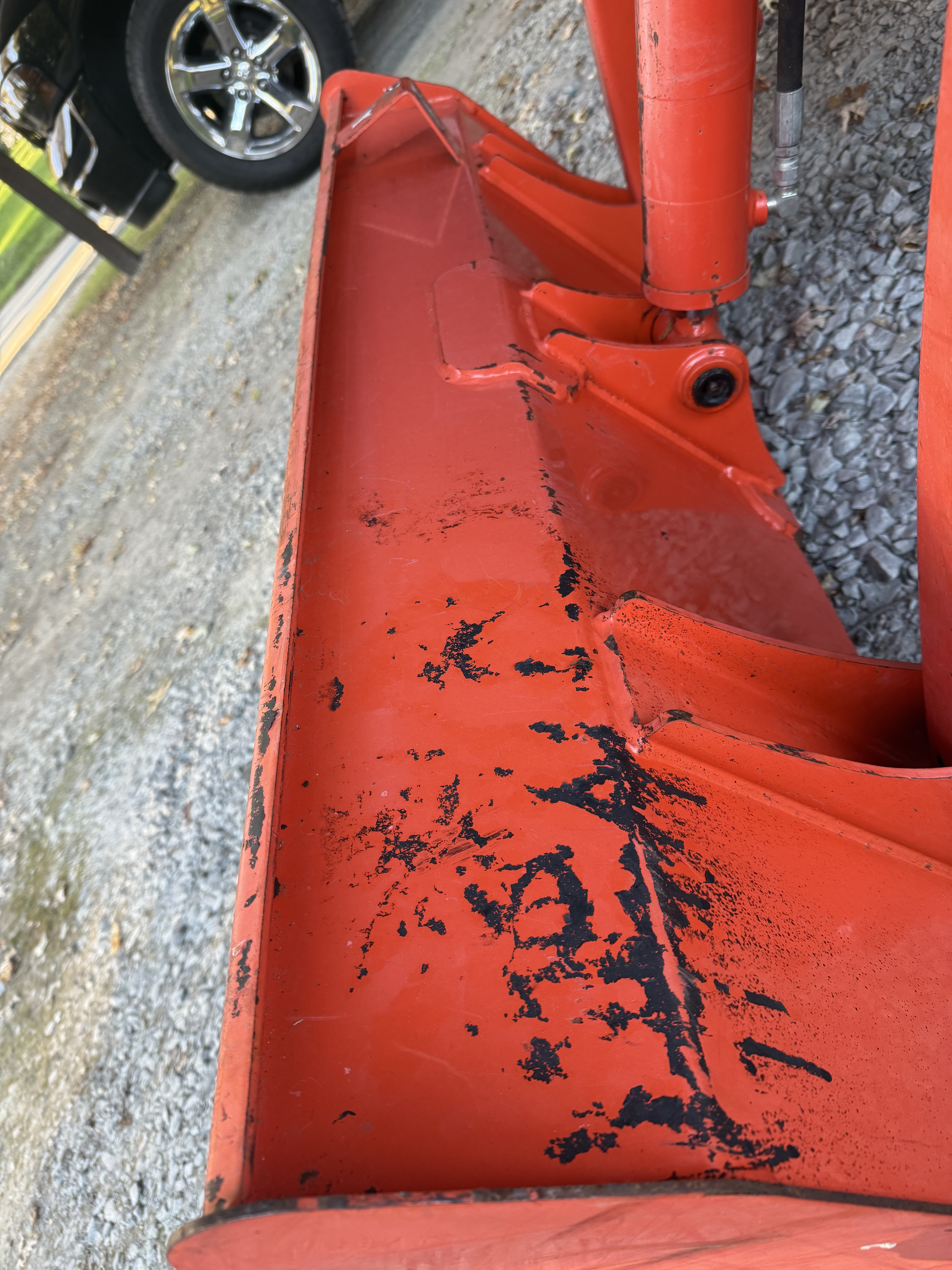

Ken I am not sure why the pictures posted like this but they should open if you click on them.
   / Kubota BX 25 Bucket hooks, are these any good ? which style? #11
Looks like you need our 1-5/8" spacered hooks, the ones in the "pin-on" section of the website I linked earlier. There are also measuring instructions on that page.
