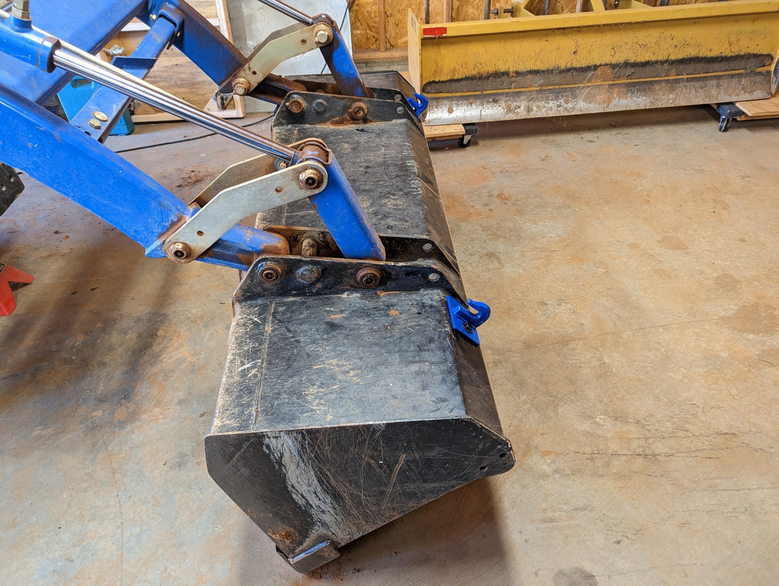

/ Bucket hooks #1
Hughman
Platinum Member
May 31, 2011
595
La Grange, CA
NH TC33DA
/ Bucket hooks #4

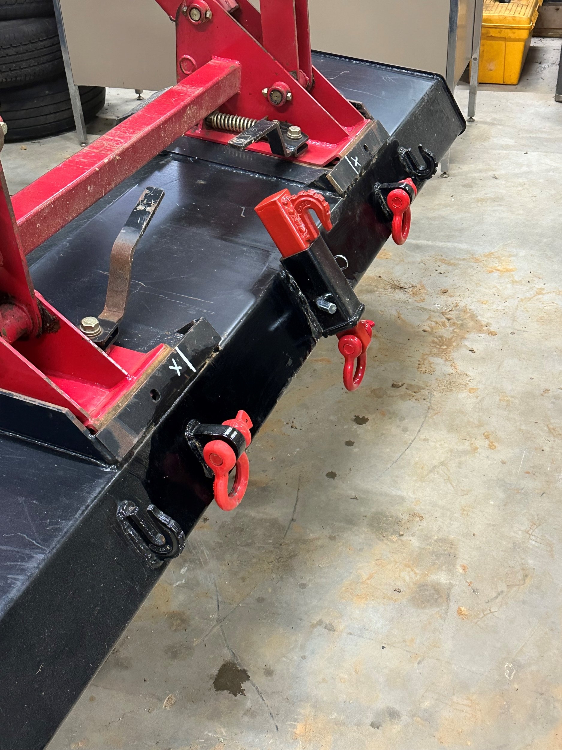

Nope, you want the blue ones. You did good. I got Red ones since my tractor is red. I need to install some on my MILs tractor, already have them bought.
/ Bucket hooks #5
Black ones cost $39.99........same with John Deere green or Kubota Orange (they know money is no object with those guys! :) )
Blue, red same hooks $23.99, 1/2 the price.

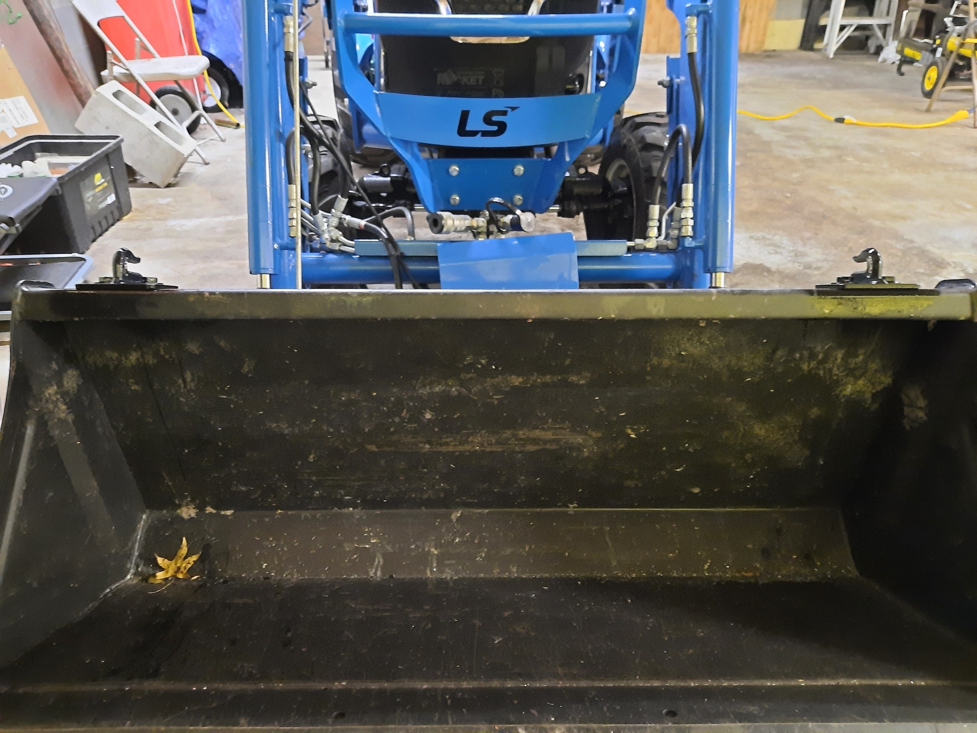

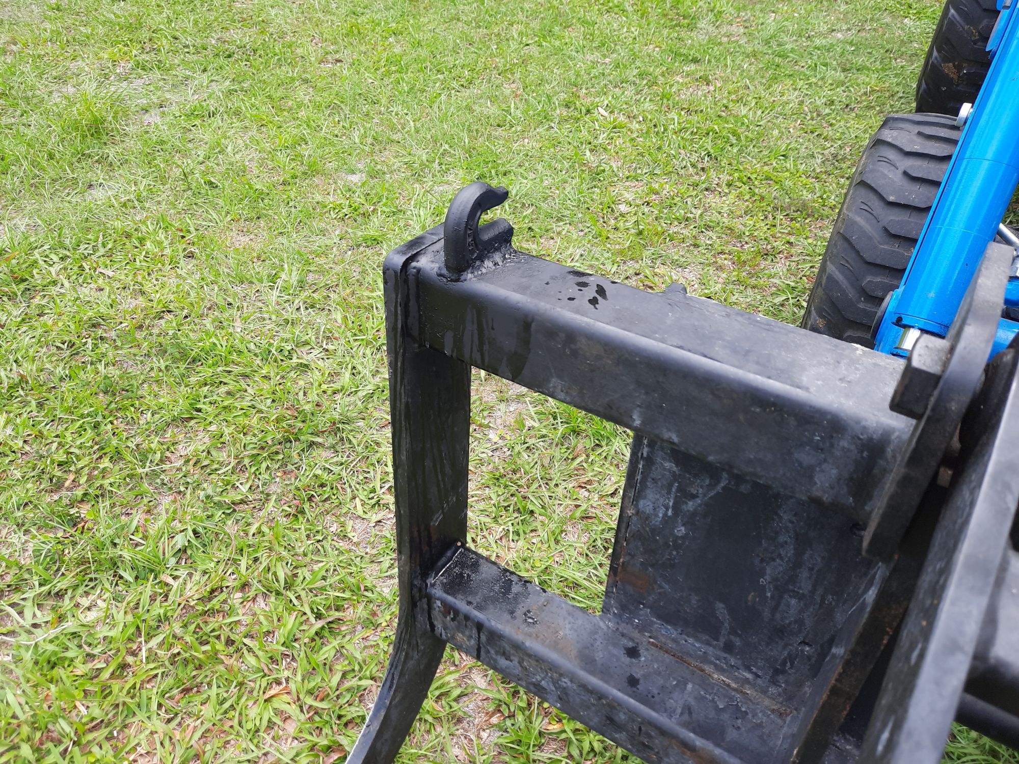

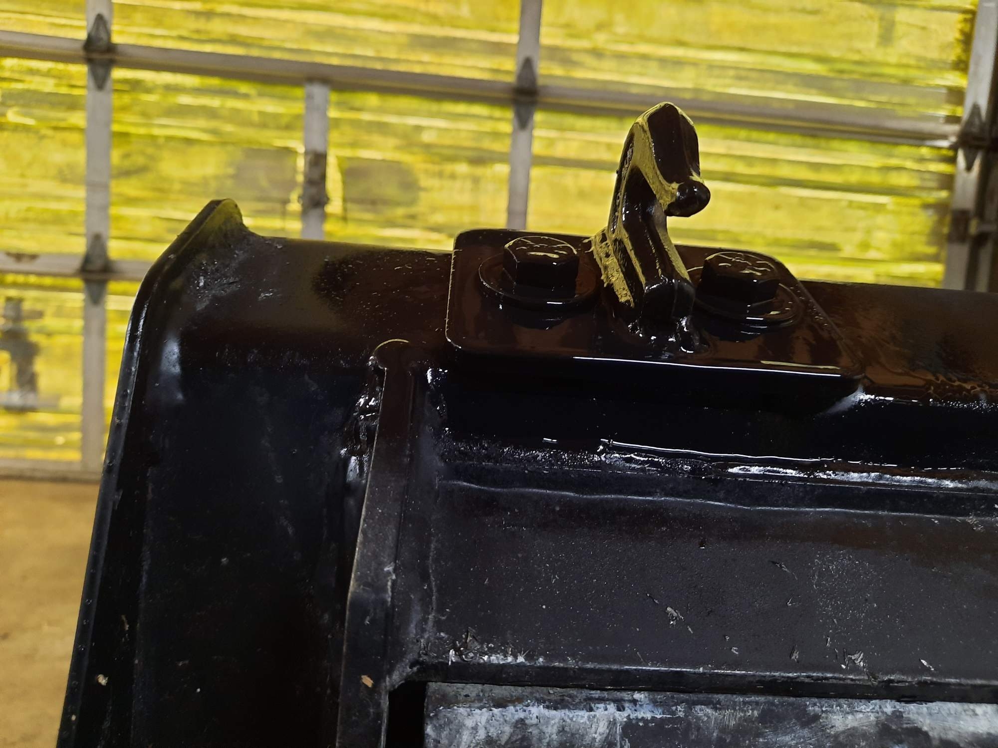

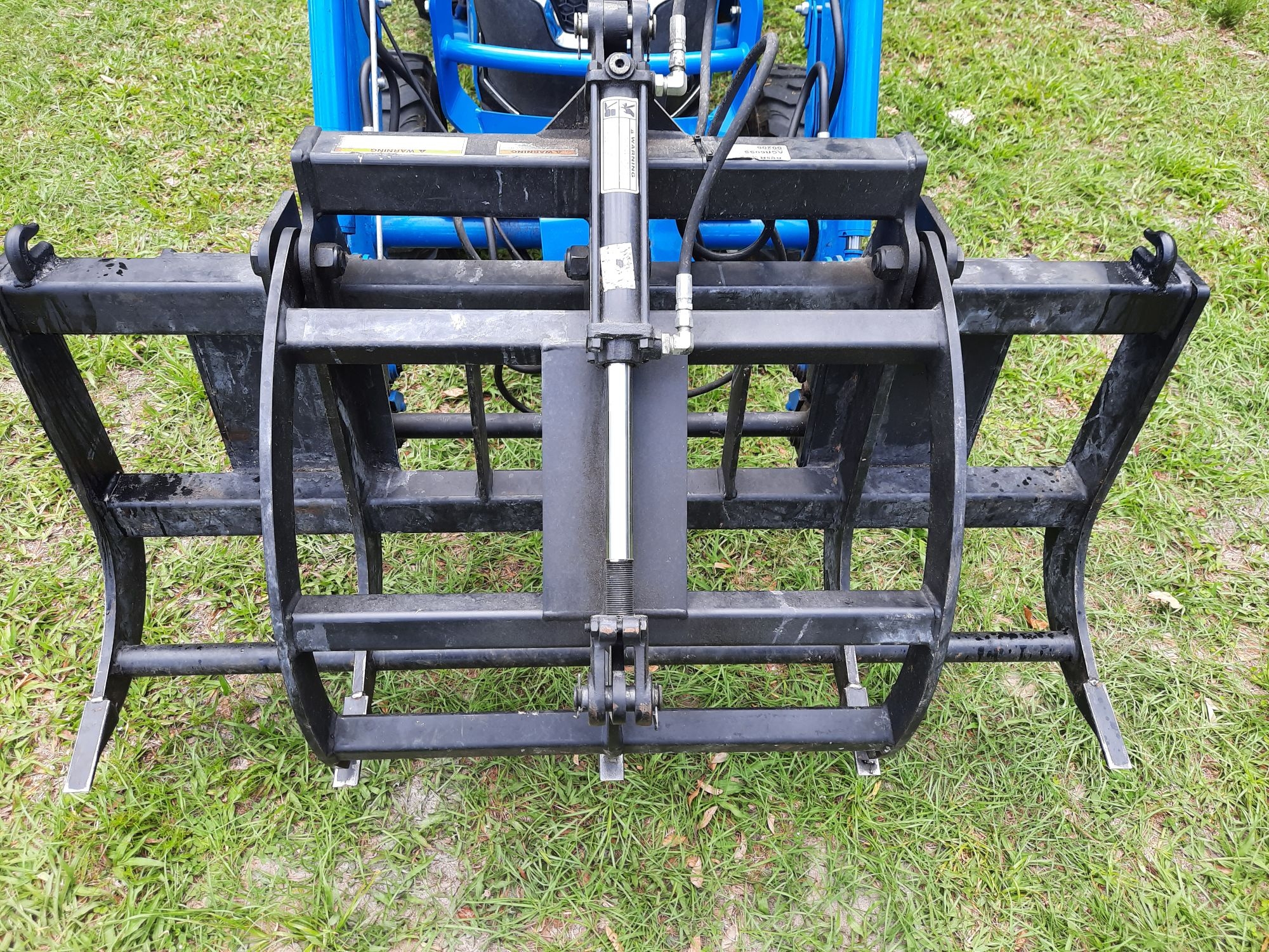

Got to be at least 10 thread already on installing bucket/chain hooks..... I oped for home made...
slots-3-jpg.577844
Those are cool! And home made. Real fabrication deserves a thread, not a $23.99 hook set and drilling 4 holes.
nice design!
/ Bucket hooks #15

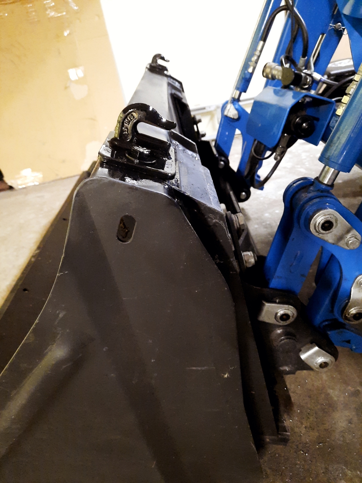

Am I the only one that wants hooks down low on back of bucket much closer to the tractor ?
so much better for lifting heavy objects imo
Nice work there. One thing I like about hooks on the top of the bucket is the ability to pull up on the chain using the bucket curl.

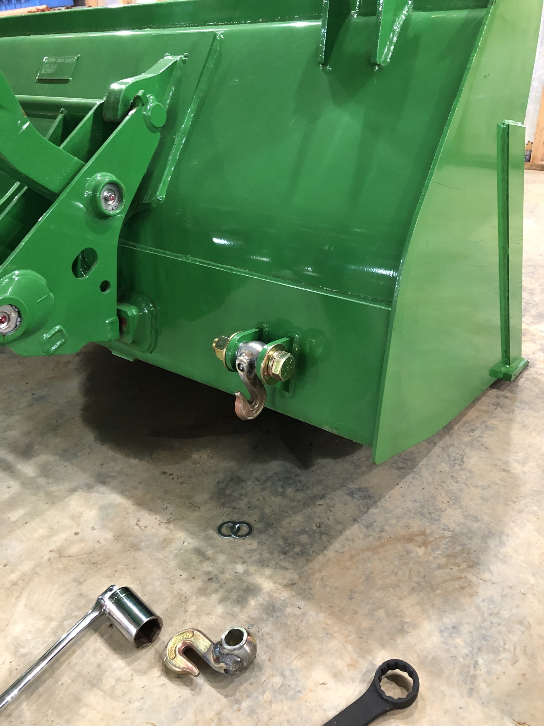

/ Bucket hooks #16
They would have to be welded on as you did or the bolt heads could cause material to stick in the bucket.
/ Bucket hooks #18

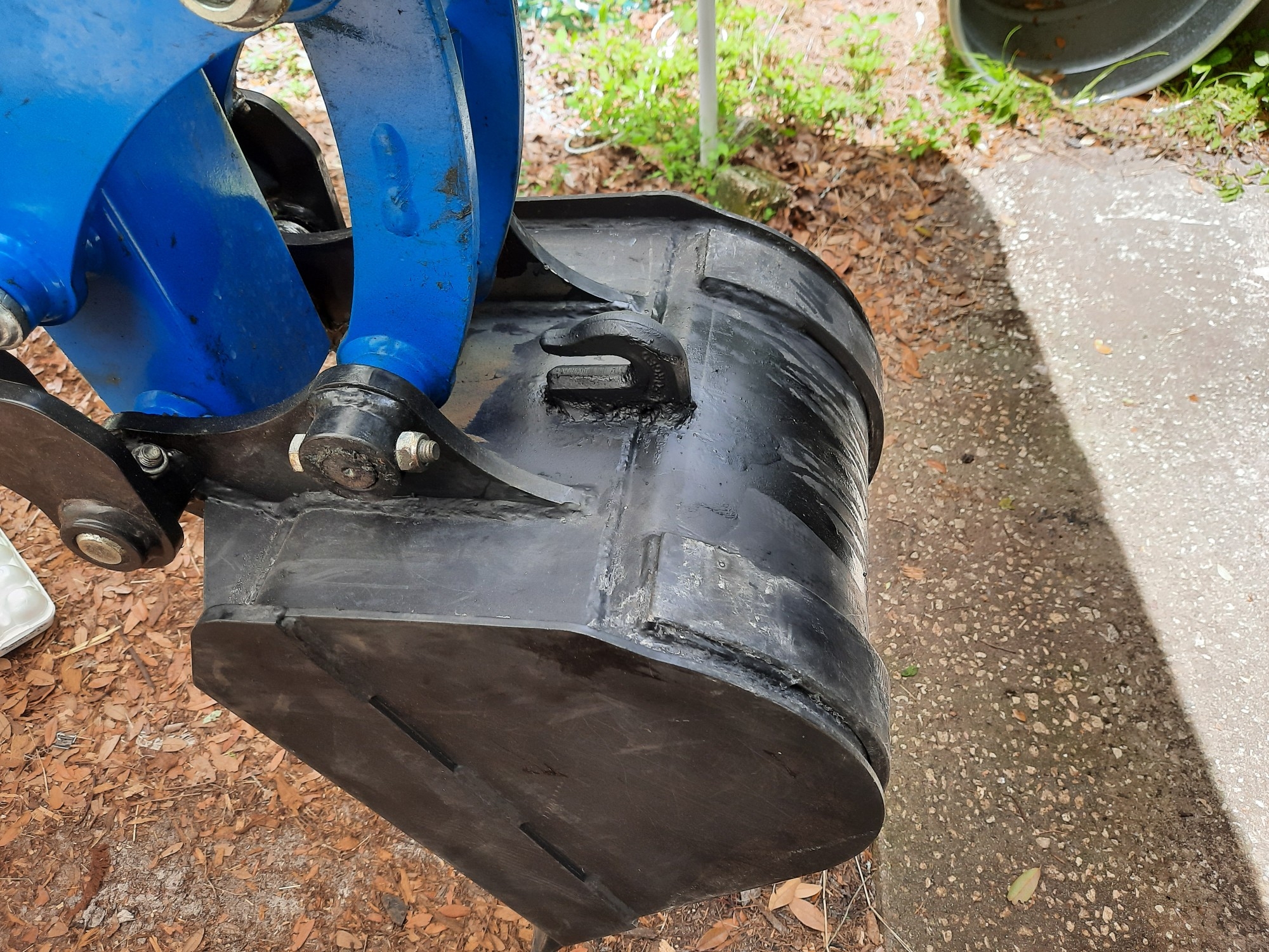

No, mine is on the back of the bucket. Used an existing hole:
Flips up for over the front:
/ Bucket hooks #19

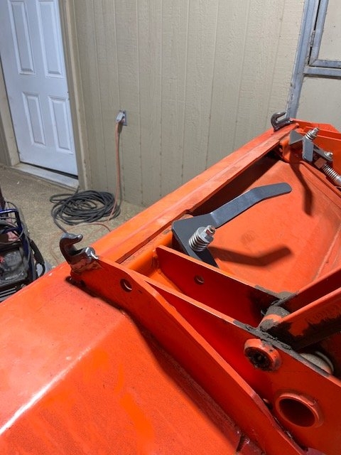

The back of JD OEM buckets are double walled
/ Bucket hooks #20
Then welding is the only option on the back of that JD bucket. No way would you want to drill & bolt thru both walls.
