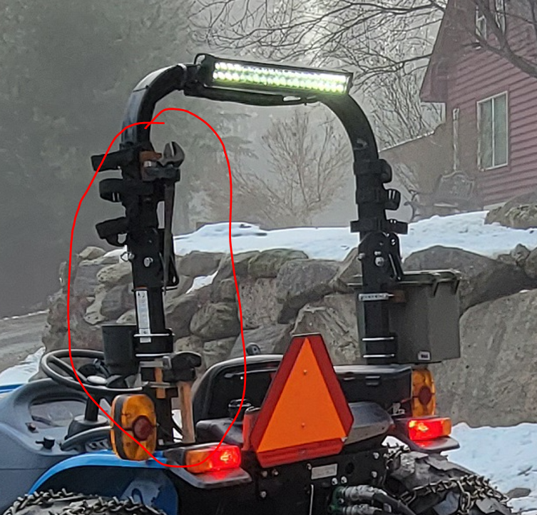

That's a really neat idea; what are you using to strap them down?
So sorry, totally missed this question. I bought some "shovel" mounting hardware, screwed it to a piece of wood, and used hose clamps to attach it to the ROPS. It would look better if I had used a smaller piece of wood and painted it black! I might have to clean that up over the winter...
Love that spud wrench though!

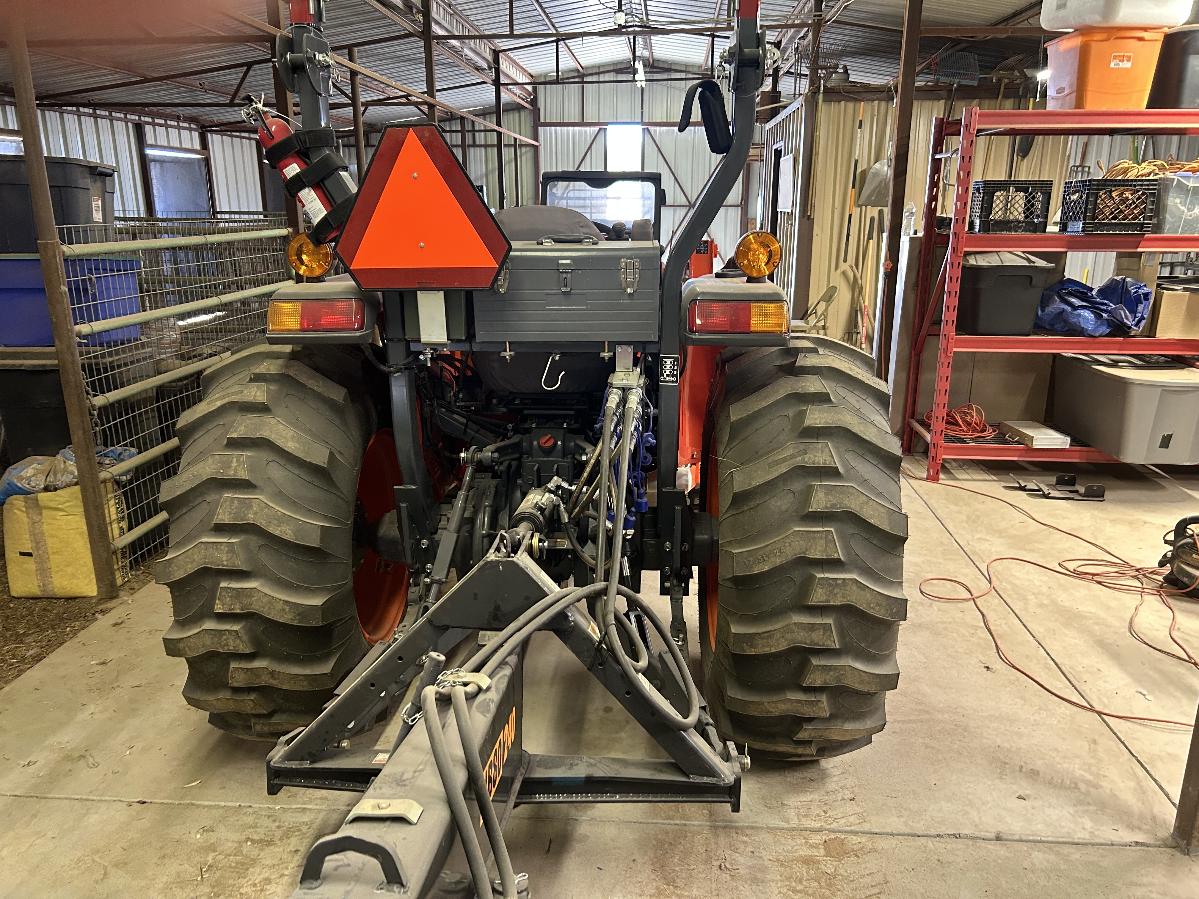

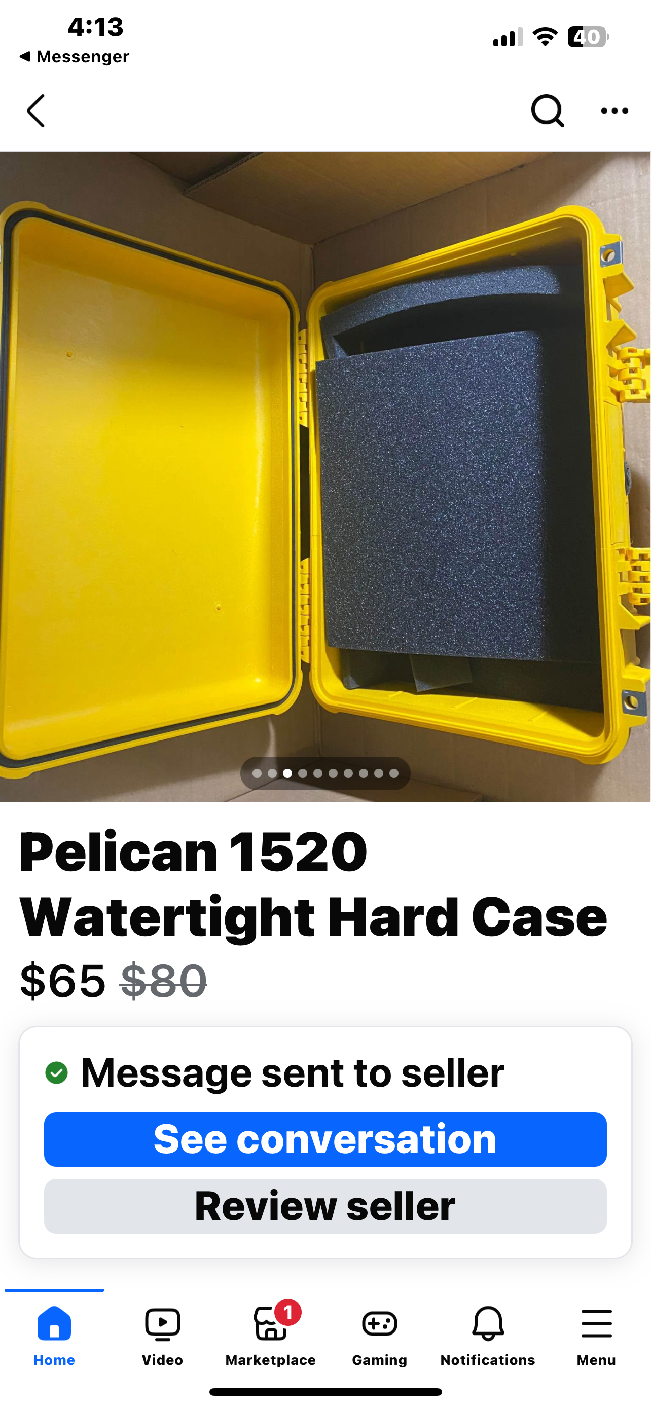

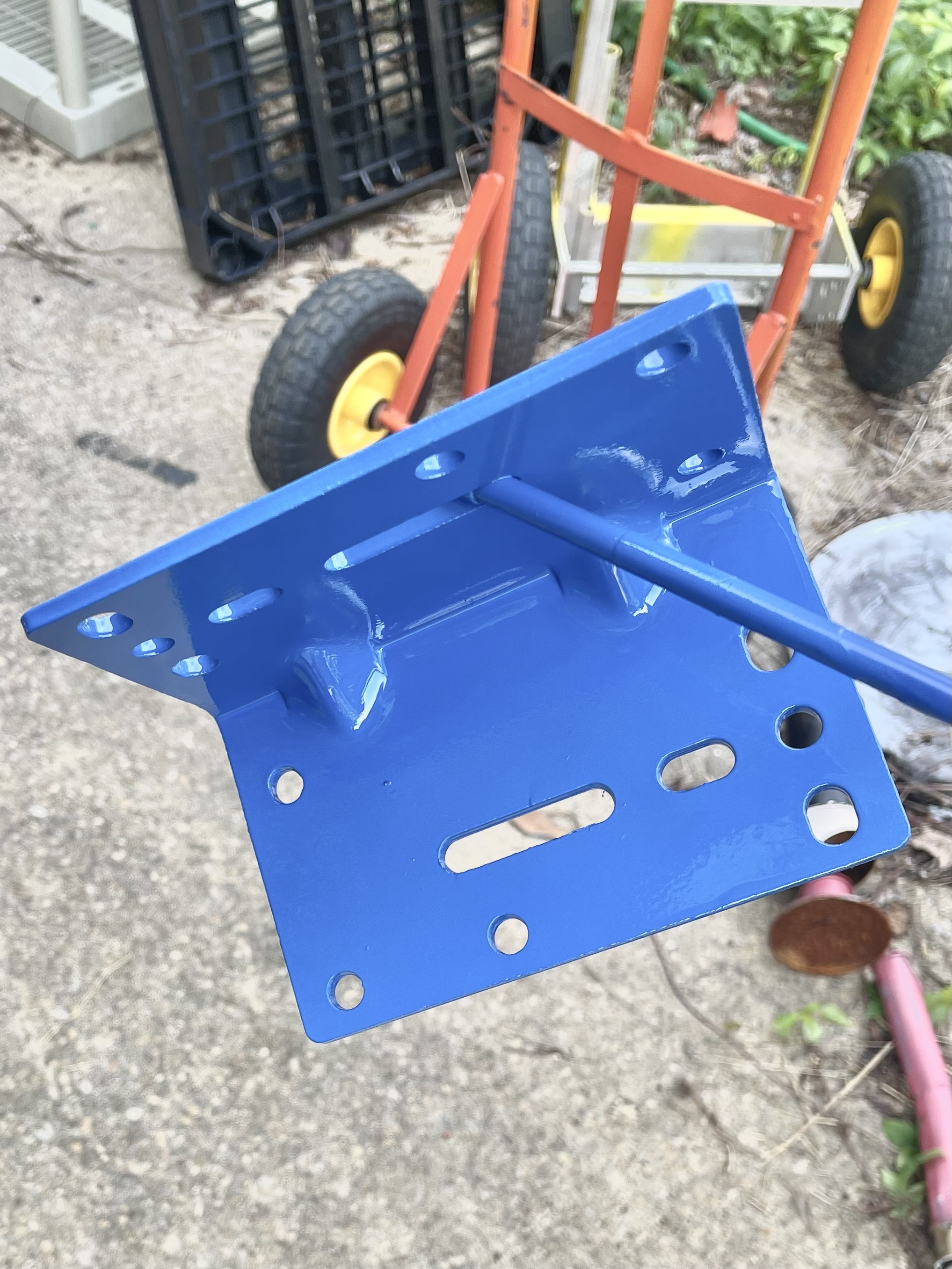

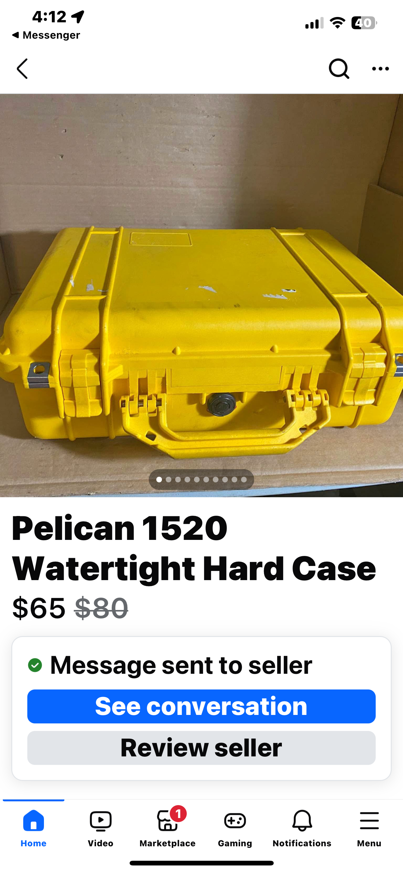

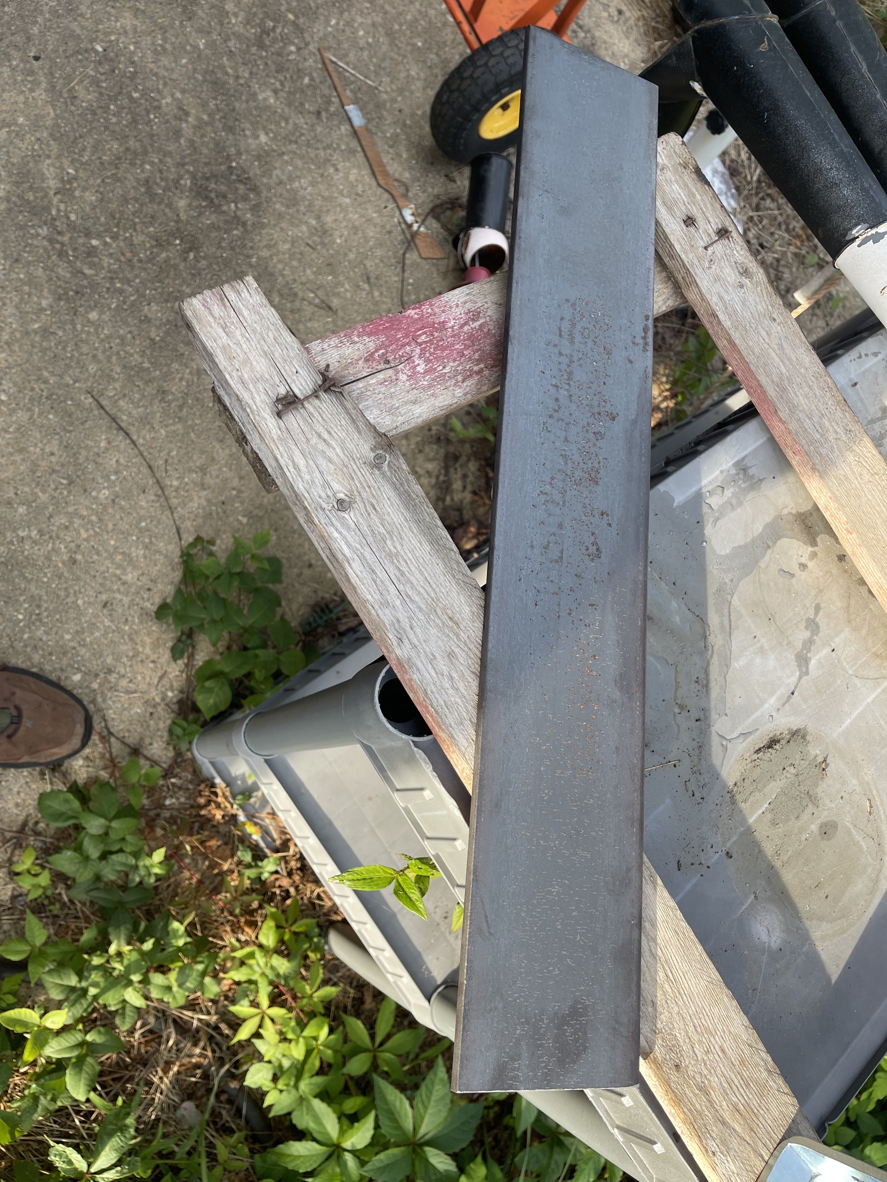

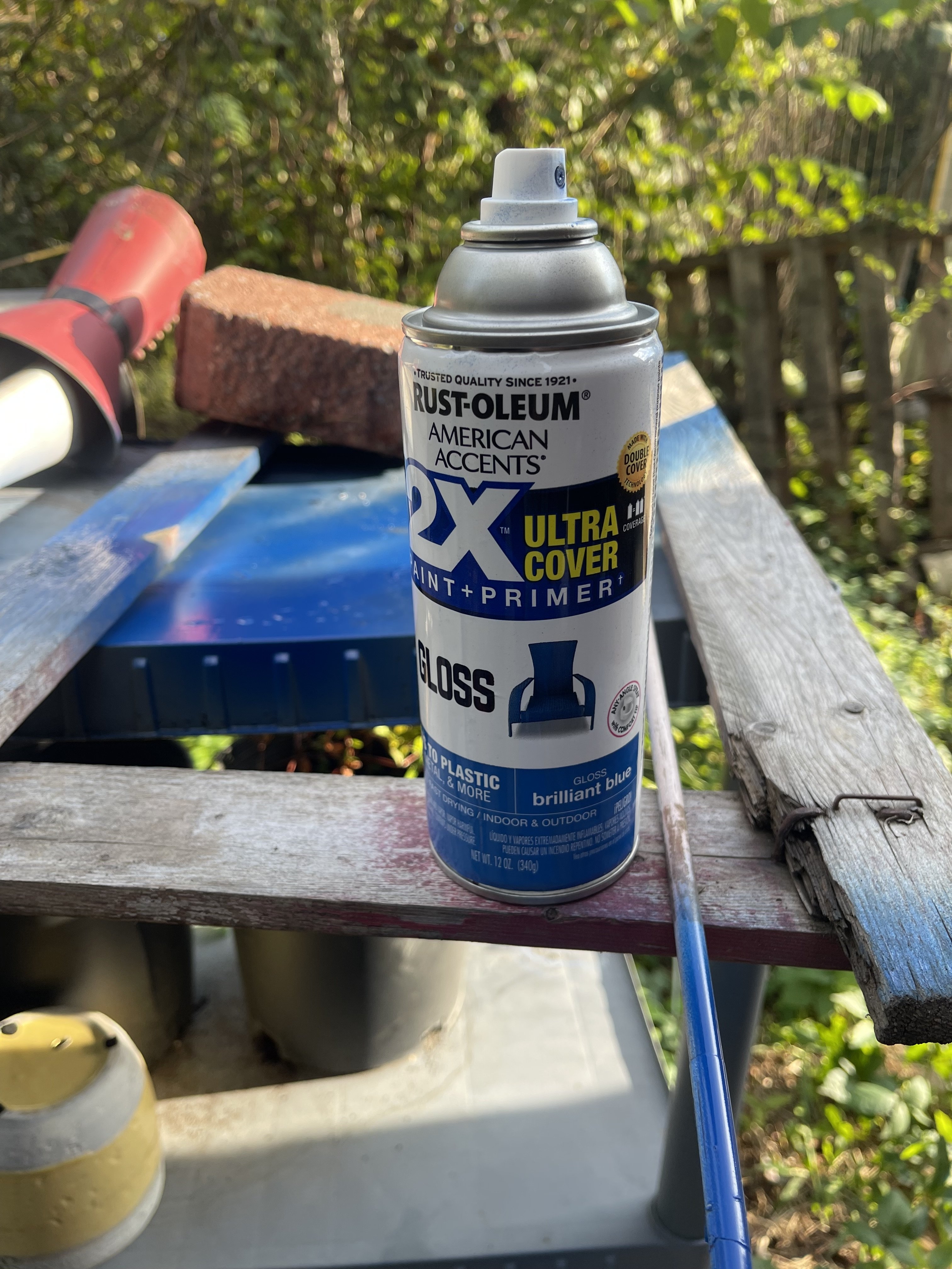

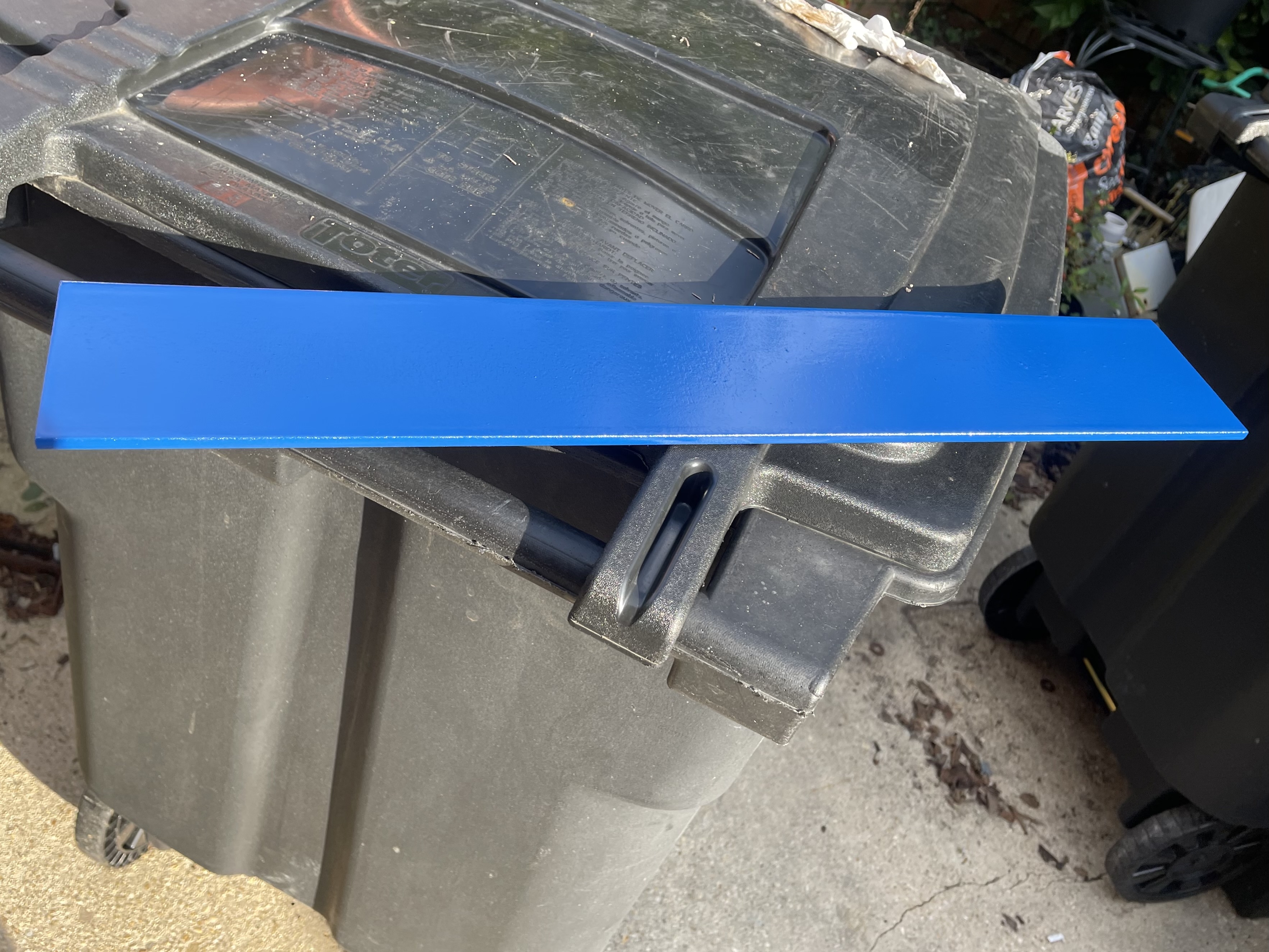

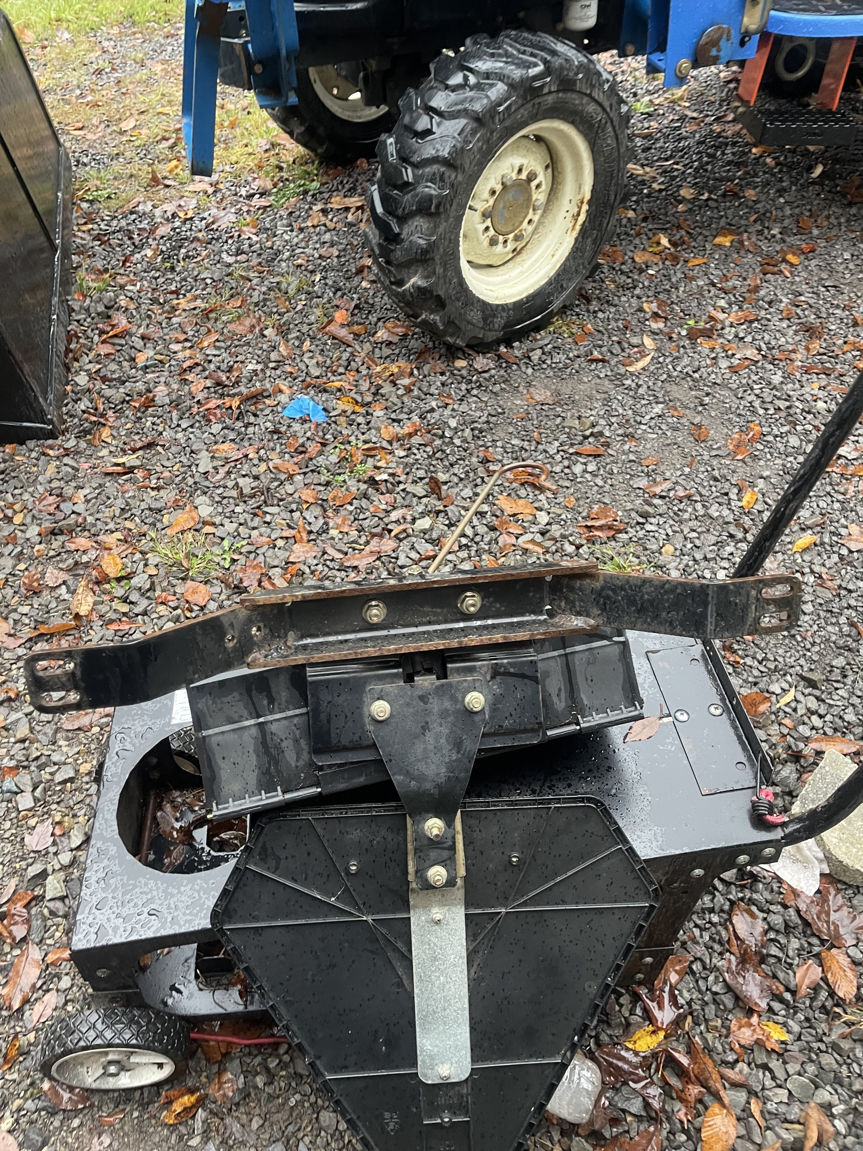

I removed my small plastic tool box and mounting bracket on my new holland TC33D tractor. I made a new tool box mount with a 1/4”x4”x24” piece of steel and am using an atv winch mount to hold a pelican 1520 hard plastic waterproof box. The flat piece of steel should give me around 4” more clearance so the new tool box won’t have a clearance problem with PTO implements. I am still working on it and will update pictures when completed. This tool box will hold more tools and will be easier to get into. Other tractor tool boxes you have to dig into to retrieve a tool.
