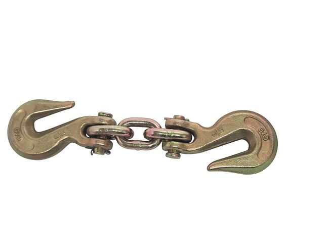

Something that is useful that some scoff at is back to back hooks...
That's what I use. I have 2 that store perfectly on the loader arm. 9 links of 5/16 chain hooks on the flat steel on the bucket top

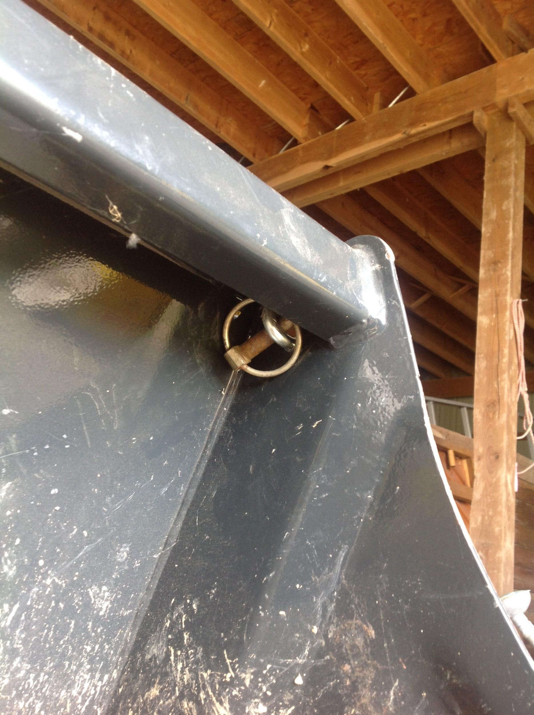

You're right, the MX bucket has a big flat iron top for extra support, they clip on and hold nicely. I was concerned about them sliding but haven't experienced them doing so. It's nice not having those hooks to grab limbs when clearing land. My dad welded hooks on his bucket and they grab vines and limbs.
Do the L and BX models have a reenforced top on the bucket? If not this method may no be a good option

As far as the bx, I don't think so. That's why personally I'd be real careful doing this if I had one of those, only them for lightweight stuff. I got a massey ferguson, I got hooks on the bucket but never snagged anything on them which I didn't want to.

Recently someone posted about two hooks on a short chain. That seemed like a great idea and since I already had a short chunk of chain and some extra hooks I made one up. Then the next day I used it to shorten a long chain. Very useful. I can't believe the idea never occurred to me, especially since I have been using chains for about 50 years or so.

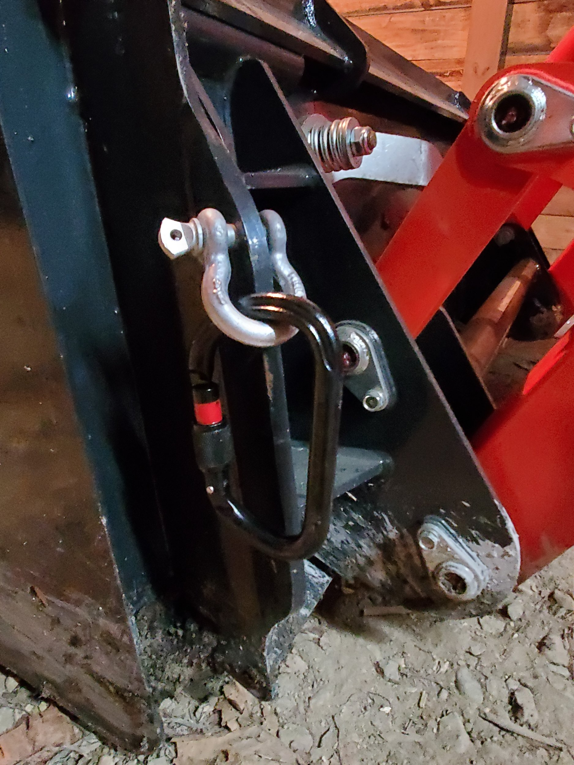

Actually.... You could use the ovals...
The ovals will work, thanks for the tip. Found a picture of the backside that shows the oval holes:
Tried DL Meisen's idea of putting the no hook end through the oval hole in the SSQA:
Works gooder-un, gonna be real handy (y)

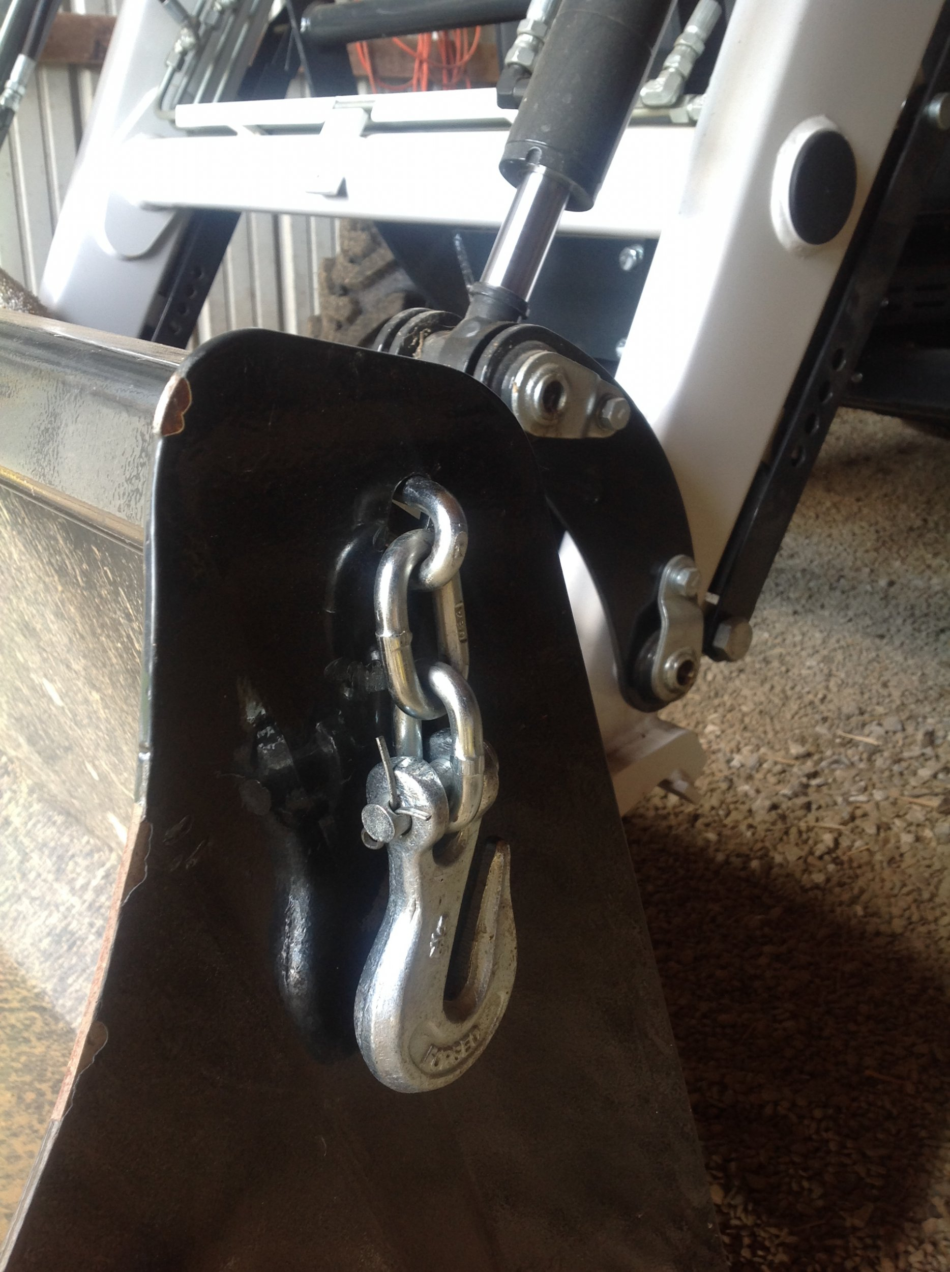

I think one of the big things about a chain hook is that since you can hook it anywhere on the chain, you can set the length more easily than if you had a large hook or ring where you would have to double your chain back and hook it to itself to shorten it. Or if you have a bare chain or chain with hook on only one end. I think it's useful to have chain hooks and one larger hook/loop/d-ring etc.
Another thing it brings to mind is something i may have done temporarily at one point and then taken back apart.. but you can pin a 'clevis' hook directly to an 'eye' hook and just make a double ended hook with no chain in between.
