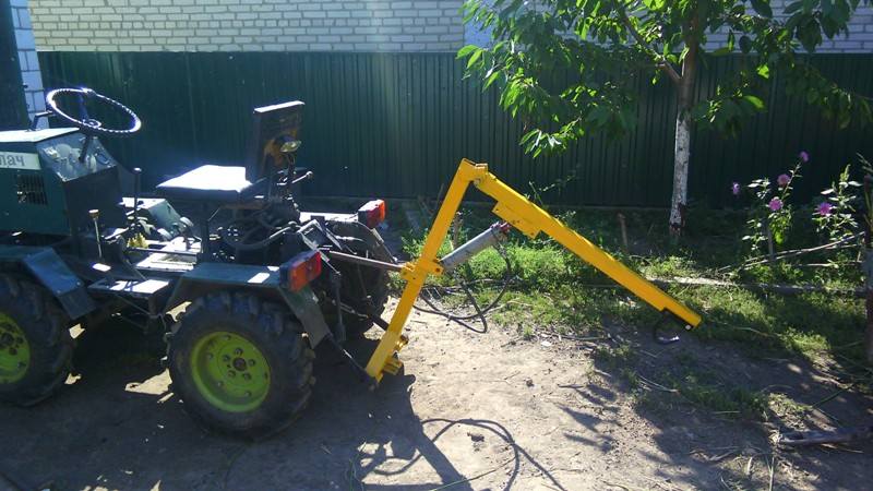

Made Crane for my tractor

/ Homemade garden mini tractor 4x4 #146
That's an impressive machine!! Great work!!

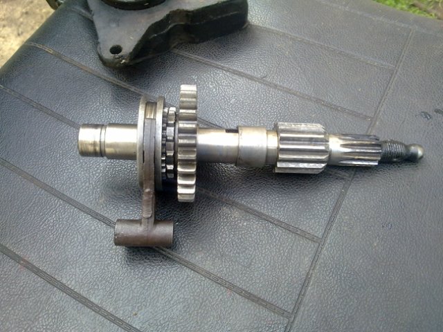

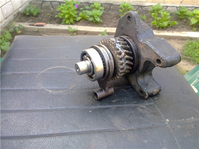

Hi guys. Sometimes there are moments when the four-wheel drive and locking rear differential can not do the job. Thinking hard to also install differential lock on the front axle. Or install a winch.

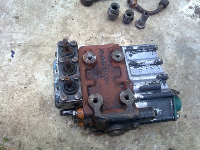

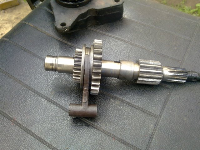

Transmission repair. Replacement of all bearings, synchronizers, switching plugs and clamps, secondary and primary shafts. Also repairs locking rear differential

/ Homemade garden mini tractor 4x4 #153
I would start easy and put the axle of your trailer all the way to the back, so a good portion of the weight rests on the tractor. Right now, you're just pulling dead weight. When you can put it on the tractor, it can help generate traction.
/ Homemade garden mini tractor 4x4 #154
+1, it's true. The more weight you'll have between rear axle of a tractor and an axle of a trailer, the more down pressure you will have on a rear axle of a tractor, what really generates better traction. But be careful not to exceed a distance between both axles, so your tractor's front end won't be lifted up.

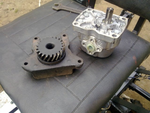

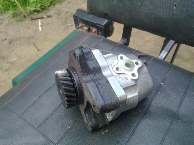

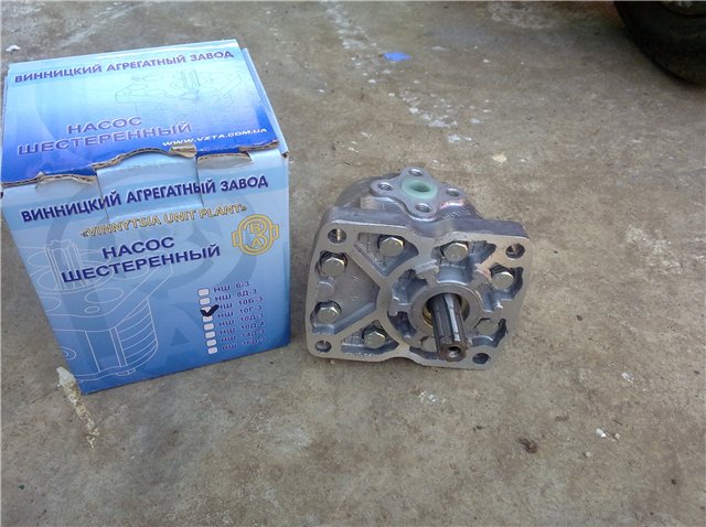

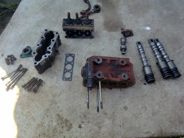

Innovative, good job making use of what you get can for parts. Is this a current upgrade you are making or one you did in the past?
#158
Thank. This a current upgrade. I want to make cultivator, so need a new strong drive shaft.
