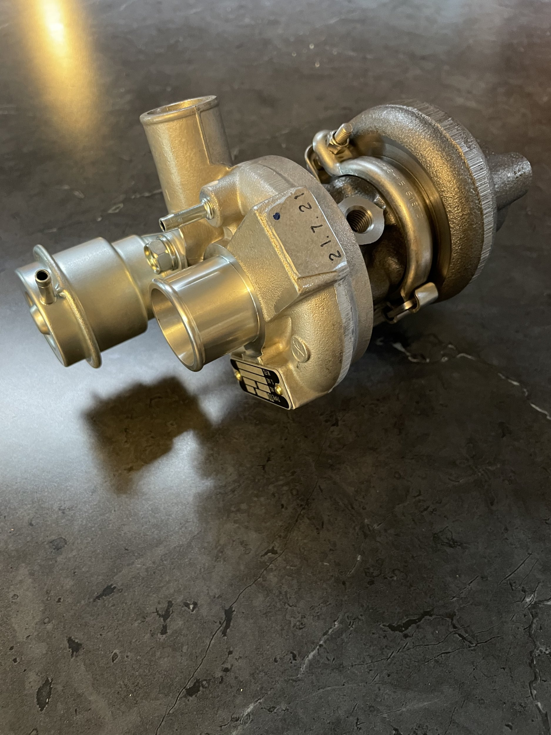

Not trying to throw too many curveballs at you with your first tractor purchase but, this is going on my simple, mechanical diesel Kubota L2501;
We’re expecting 45-50HP, 28-30PTO.
Benefits, more power and still a relatively simple setup.
Drawbacks, additional cost, no warranty.

Are you fabbing up a custom exhaust manifold or running an adapter?
which turbo did you go with?
these rigs have the fuel to support the added power as well?
have you already checked the timing to see if you have any room to advance and raised the rpm? Hopefully you were ready for 20 questions hah
That’s gonna be wicked!

A custom manifold will be too expensive, so we’re going to run an adapter to fit the turbo. A new MHI Mitsubishi Turbo. I’ve been logging EGT’s for months, there’s more than enough fuel for the turbo. We’re going to run factory timing and we’re not adjusting the RPM limit. More power can be achieved by both but, we don’t feel it’s necessary. It’s going to be more than enough power for the size and weight of the tractor. It’ll be a full bolt in setup.
It’s gonna be awesome!
Mike

Hopping up a tractor is cool, but it only increases engine power. It does not increase weight or loader capacity. Or strengthen the drivetrain. There's not a lot of tasks that are limited by engine power alone.
Cooling is also problematic.
/ First tractor #34
What's the Member's name that added a turbo to his Kubota??? Remember?? He actually posted a LOT of very valuable information about that modification.
/ First tractor #35
There are several members that have successfully added a turbo to an L2501 without cooling issues.
There’s a good thread at Orange tractor talk forums discussing modifications specifically to the L2501, including turbocharging.
