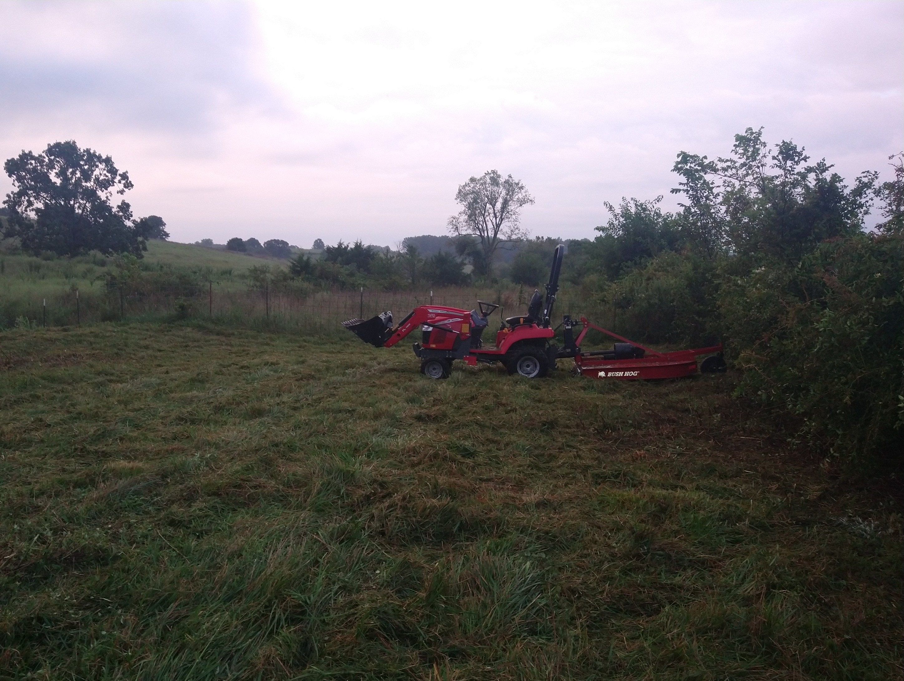

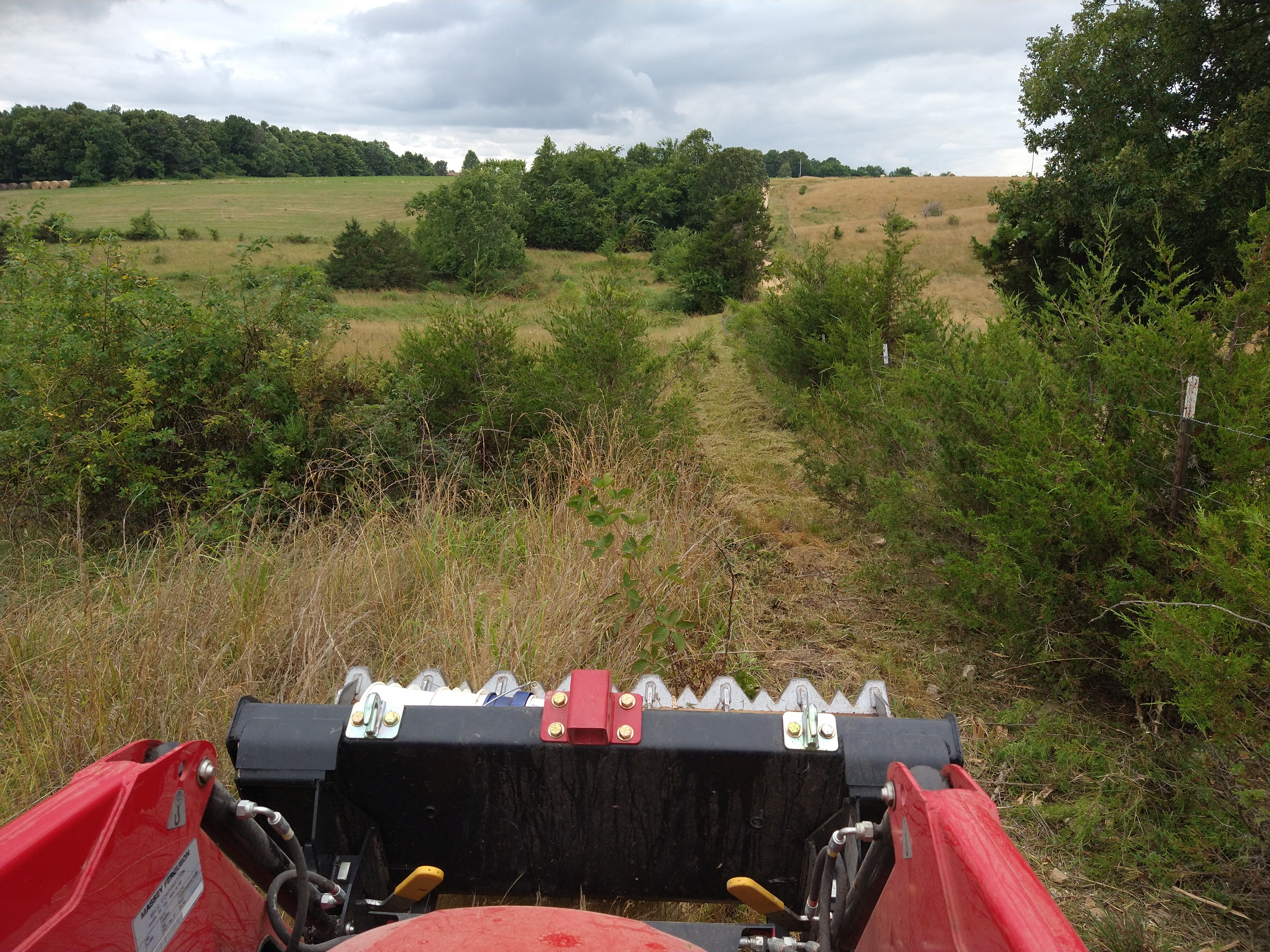

Here is just a tiny example of what I've done in the first 750 hours with my Little Baby Fergie TLB SCUT!

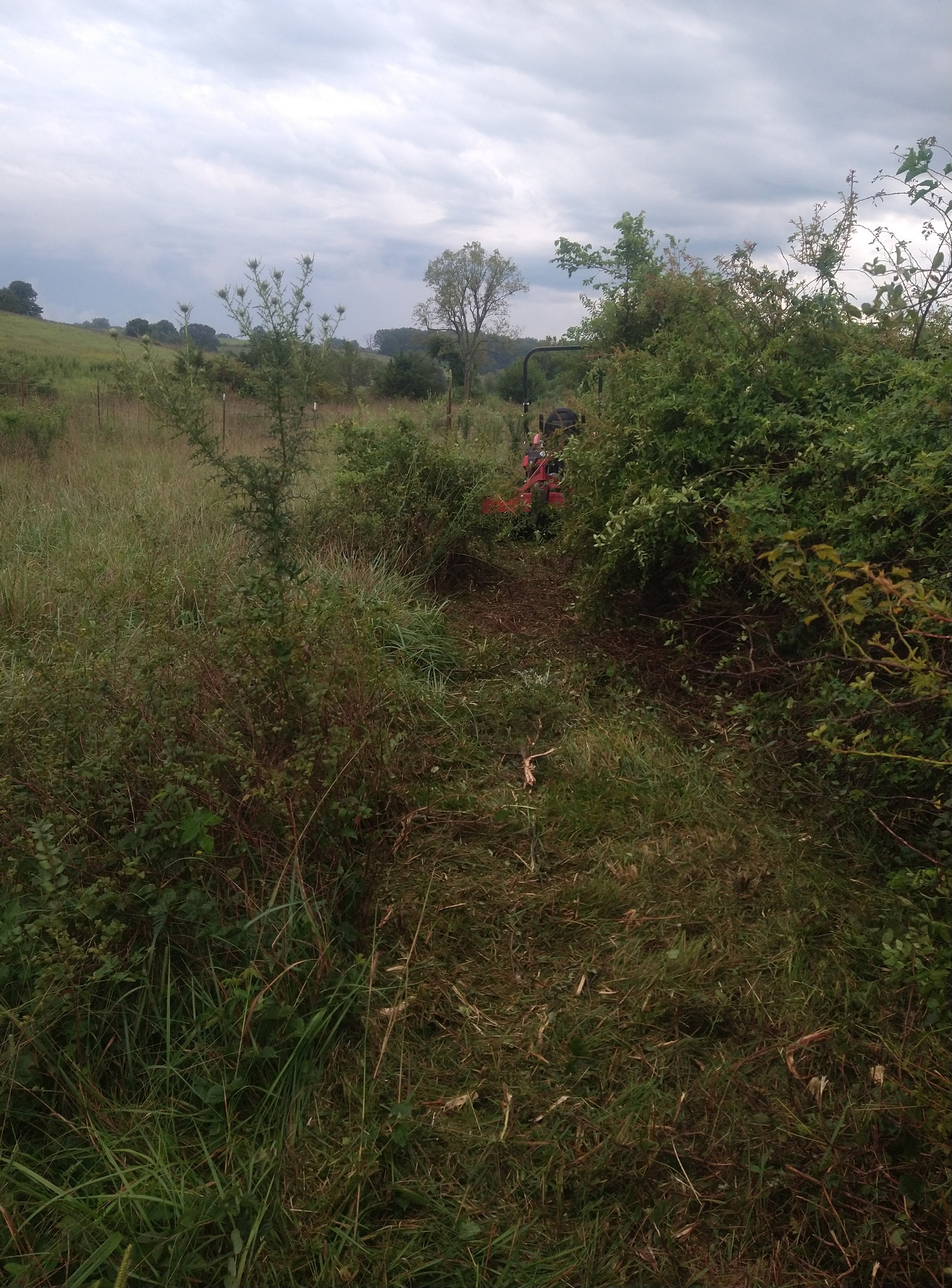

I added a link to a thread I made about just taking little bites, after you quoted me ...

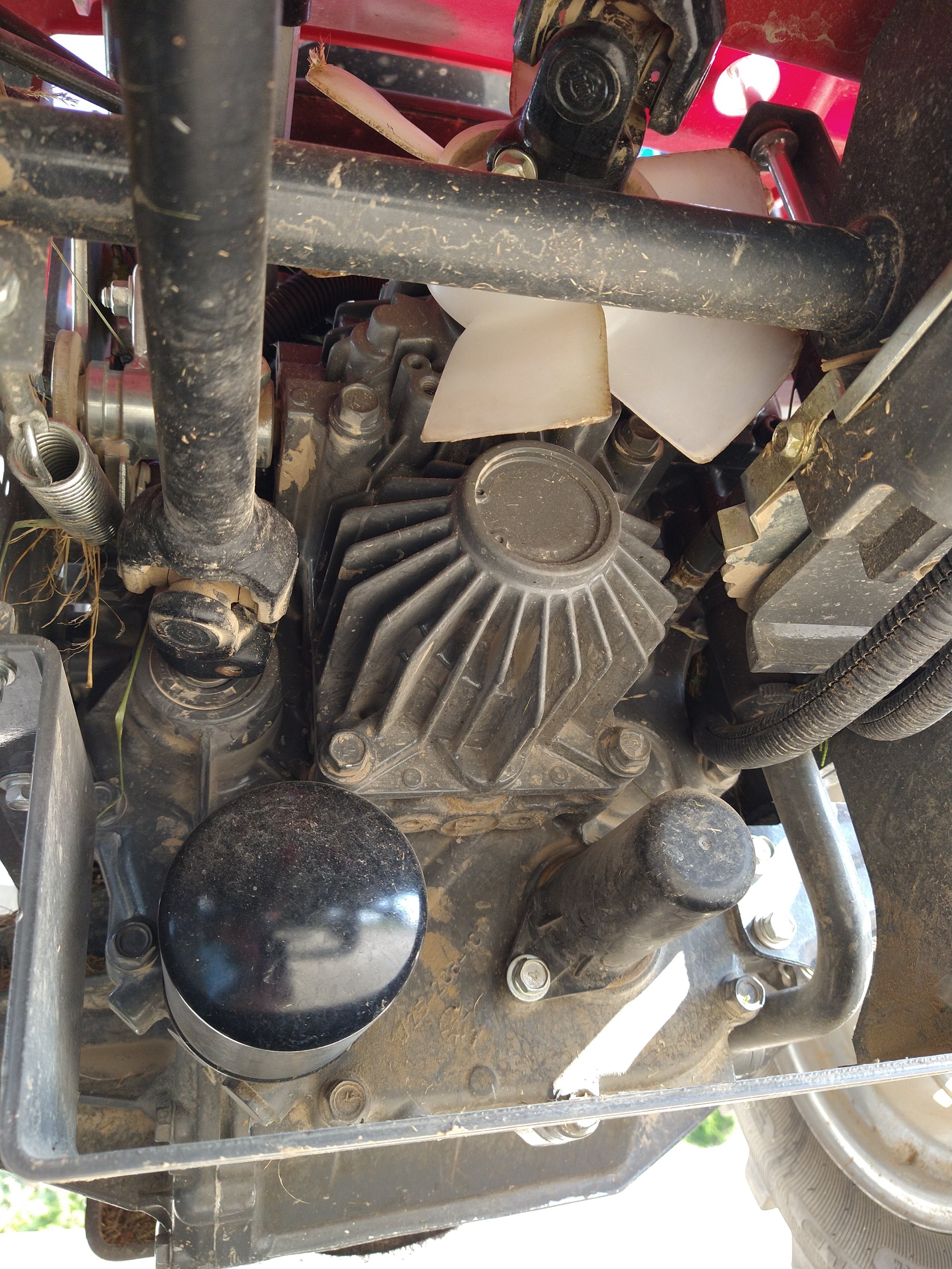

There is a transmission cooling fan under there, it's more than a foot off the ground, although front axle ground clearance is only about 6", and there are other things that low too ... but supposedly a few have managed to jamb a branch or root up and destroyed it ... I have a skid plate under it to protect it. Most SCUT's have the same setup ... You can see I got a few tiny nicks in my whitish fan blades ...
I don't have much woods here, but the pastures were quite overgrown ... With the tiny tires, I couldn't get up the other side of this creekbed, the long brush hog didn't help!
Just drive on through!
All finished!

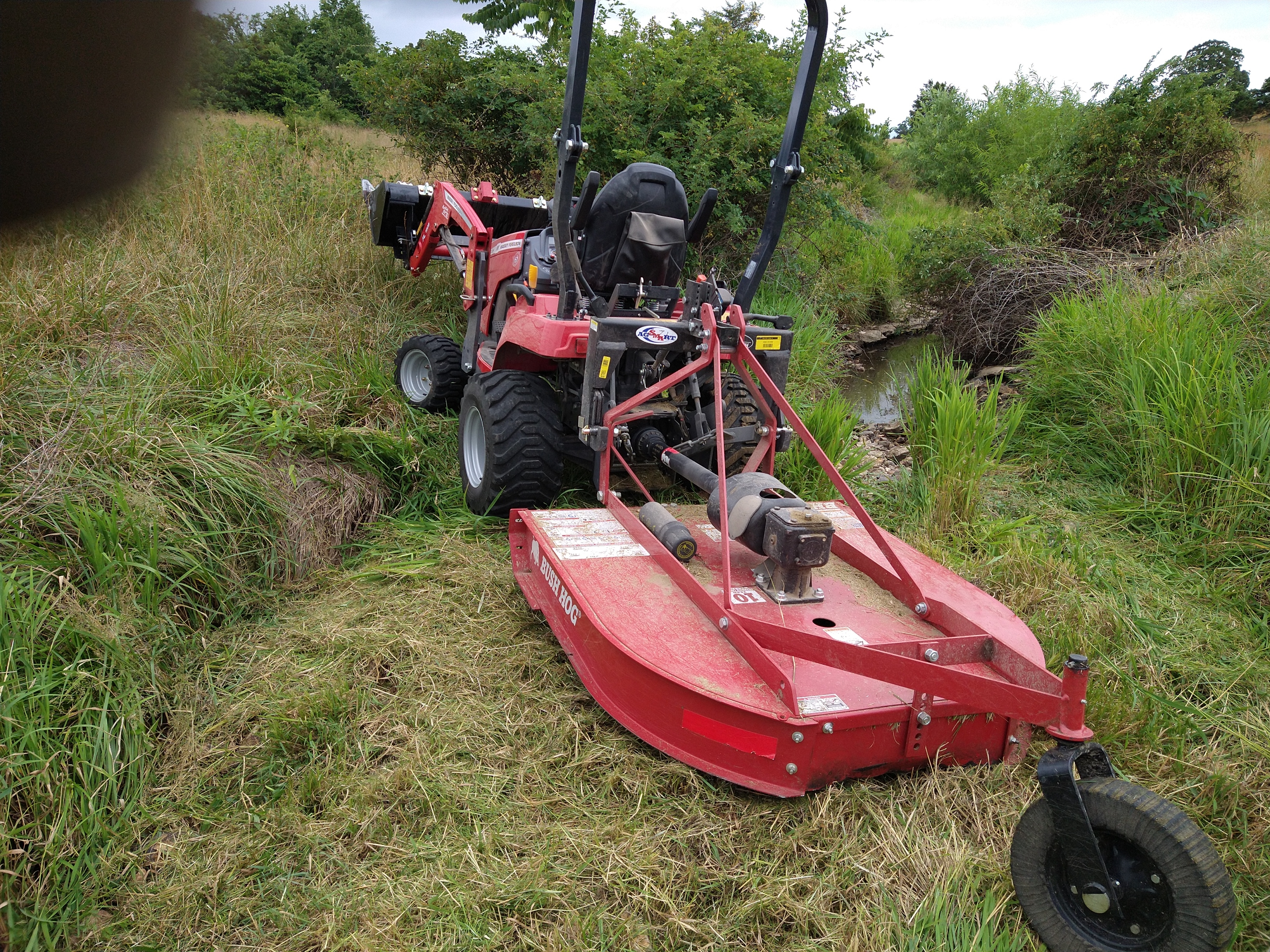

that creek bed you couldn’t get up looks pretty tame compared to lots of my woods 😅
Yes, it is partly camera angle, but ...
The "problem" is mostly due to the nearly 8' long unforgiving brush hog on the back ... But the bigger tired CUT would probably be able to lift it higher, so it wouldn't ground out, that's why I've been suggesting a CUT, over a SCUT.

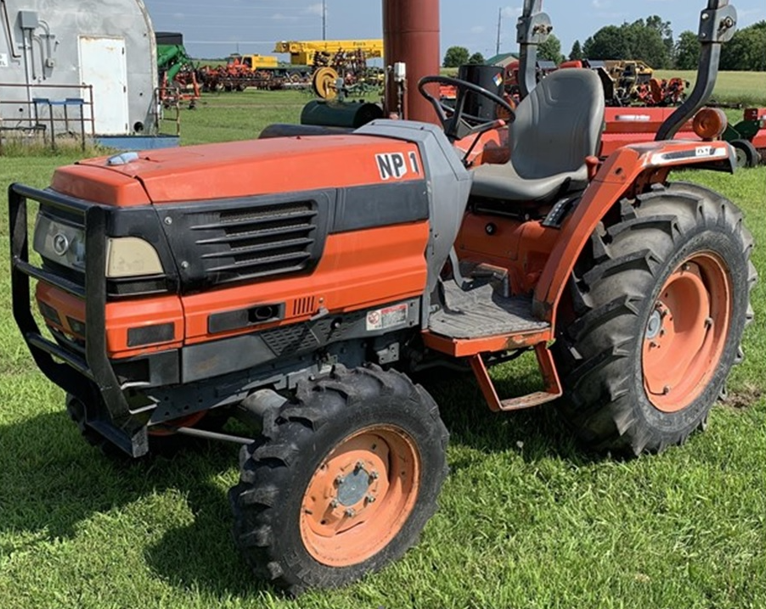

I had been looking for a tractor for our hunting land for close to a year. I saw this one listed on Tractorhouse at a dealer 125 miles away and it was a very good price. I looked at their Google reviews which were universally good. I called the sales person, and got full and straightforward information. Even though the price was very good, I made a slightly lower offer, and got them to throw in free delivery (the sales person had a cabin 15 miles away).
I bought it sight unseen (yes, I know I could have driven the 125 miles, but it wasn't in the cards at the time). Not only was the tractor better than I thought, but they went over it before delivery to make sure every functioned as it should. I acted quickly, because over the course of my search, I learned that when you find a really good deal, it sells fast. YMMMV
looks like a B7800, I had one, great tractors!
