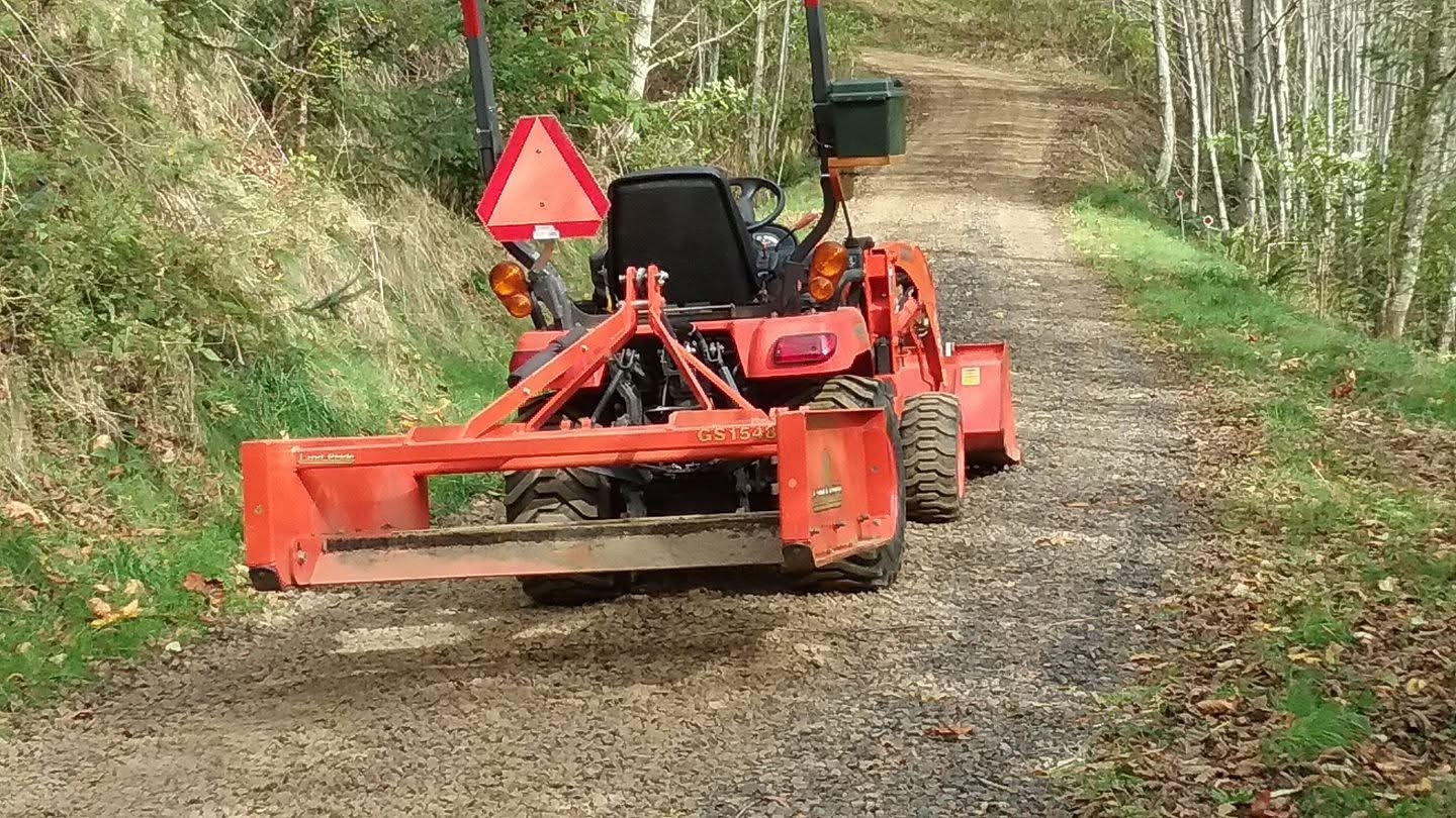

I also live in Washington State on a 20 acre very steep property overlooking the Columbia River. In Jan 2013 I purchased a 2008 Kubota BX24 with 45 hours for $10,700. The key here was having the cash in hand so I could offer it to the seller the minute his ad appeared and haunting Craig’s list for a couple years. The tractor now has 900 hours and has been a Godsend.
My gravel driveway is almost 1/2 mile long and has a 20% grade. The key is having the right category 1 implements. Over the years I have acquired Land Pride grading scraper, a Wolverine back blade, a DR Power shaft driven string trimmer for the sides of the driveway, and other stuff.
The backhoe spends most of its time in the garage but is super handy when needed.
My neighbor just purchased a brand new model L but I like the BX because of it smaller footprint and great maneuverability around the garden and the BXepanded accessories.
I have been able to do all my maintenance so far. I am 2 hours away from Watkins tractor and don’t have easy access to a trailer.
Just my 2 cents.
