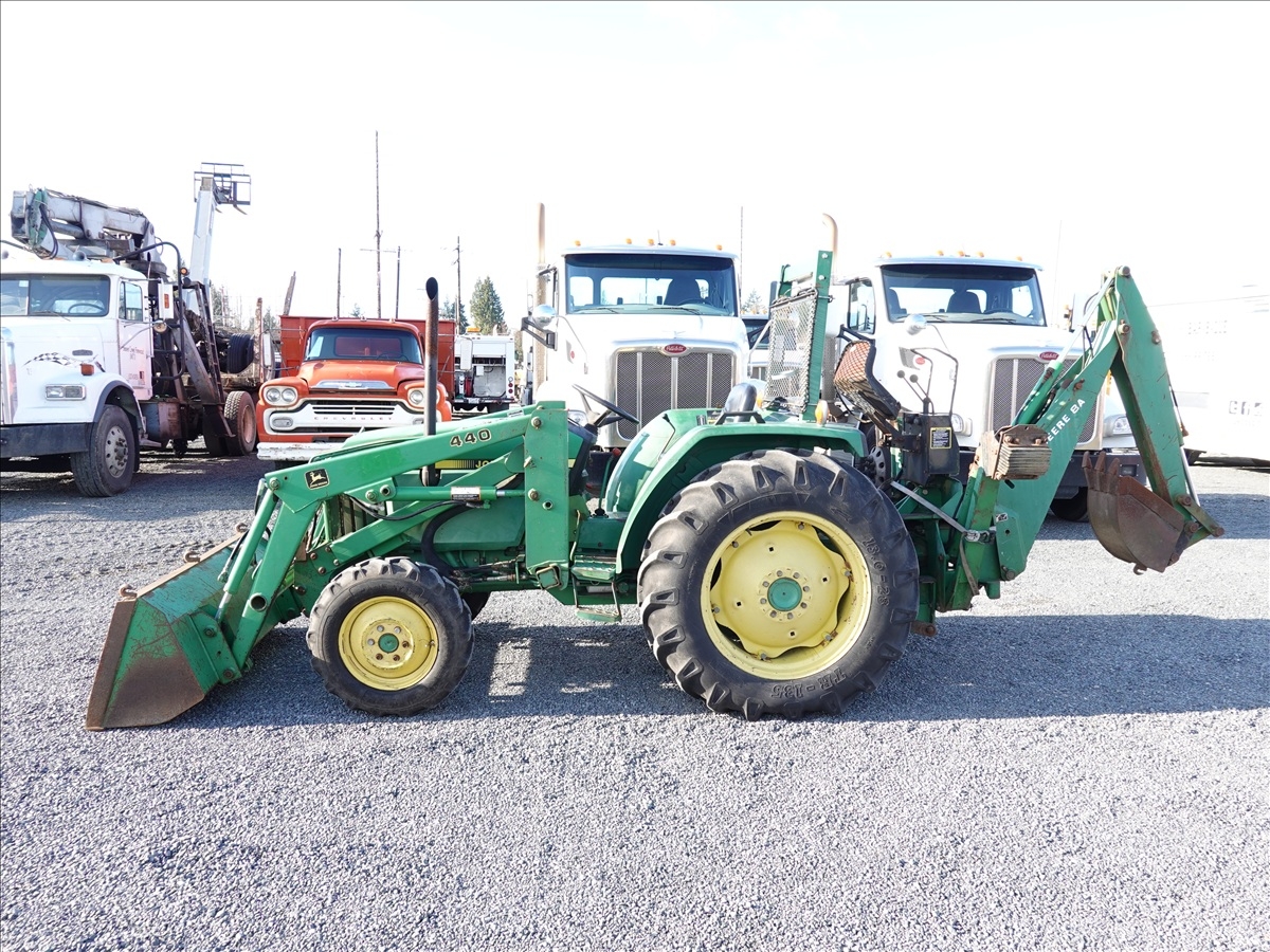

I had been looking for a tractor for our hunting land for close to a year. I saw this one listed on Tractorhouse at a dealer 125 miles away and it was a very good price. I looked at their Google reviews which were universally good. I called the sales person, and got full and straightforward information. Even though the price was very good, I made a slightly lower offer, and got them to throw in free delivery (the sales person had a cabin 15 miles away).
I bought it sight unseen (yes, I know I could have driven the 125 miles, but it wasn't in the cards at the time). Not only was the tractor better than I thought, but they went over it before delivery to make sure every functioned as it should. I acted quickly, because over the course of my search, I learned that when you find a really good deal, it sells fast. YMMMV
/ Realistic $ for a reliable tractor? #63
Here it is after the magic of Implement Paint :)
