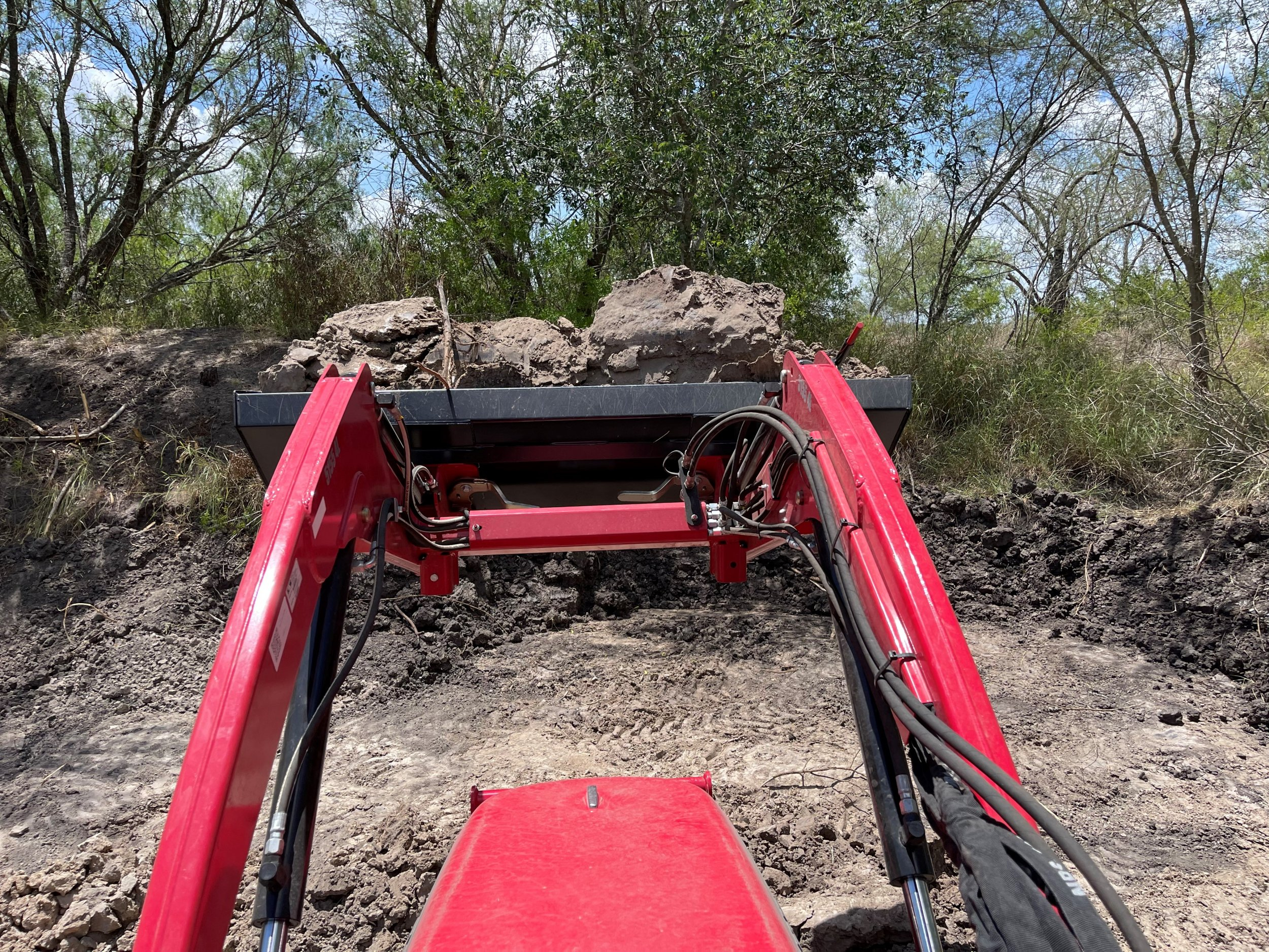

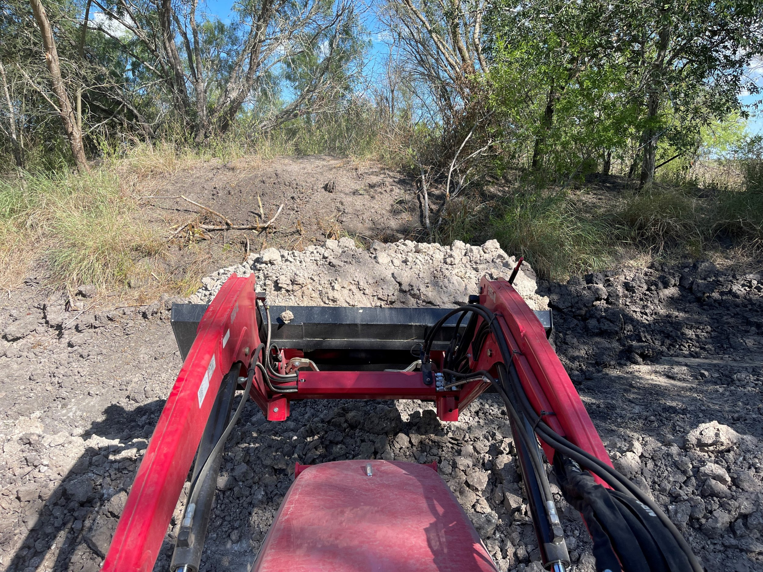

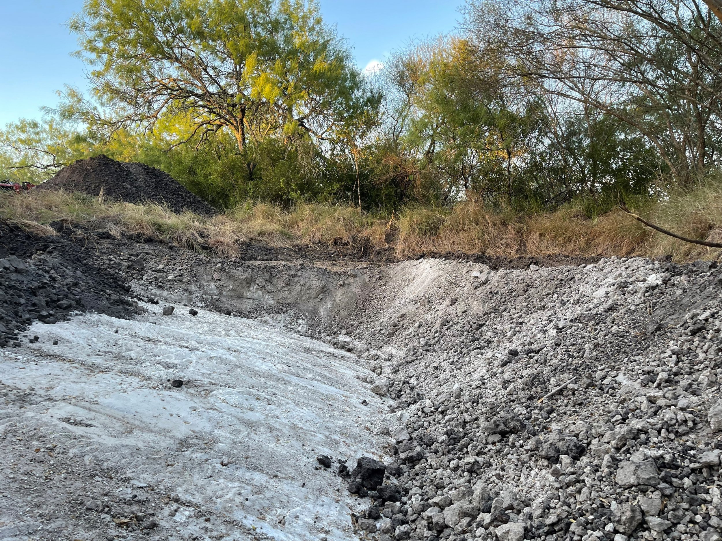

The first words out of my mouth when I saw your photos was "this has to be Texas" that is some serious soil and rock to move!! I was looking at Mahindra, and my only concern on the BH is its not a sub frame style implement, (at least not what I have seen for sale online and around here) it is a 4 pin hooked up to the back of the tractor. I just feel that it would break the tractor in half without that sub frame support. That said, I do like seeing that the loader can DIG that well, do you have a cut bar with rock teeth on the front edge of the blade? How large of an area is that, and how long did it take to achieve that? Thank you for your response!
i do not have a backhoe nor do i intend to get one so I will let someone else answer backhoe questions (Arrow) may have some insight. I cannot see the 5145 backhoe with out a subframe but I do not know. No tooth bar on mine and the pond is about 12 feet deep at this point, i got rained out and went to other project until it dries out a little. the time is dependent on your layout, as most of the time spent is toting the spoils out of the hole and to the stack. I would think that this is as fast as a backhoe if you include the time to stack the spoils. a med excavator would be faster but not a backhoe (i would think), you do have to plan better with a FEL for digging.
In my soil digging is a non-issue, point the bucket at the ground and push, feathering the bucket curl up as the tractor starts spinning and by the time it is curled up you have a full bucket and it happens faster than i can type the description. this is in undisturbed hard packed caleche with limestone/clay mixed in. I have heard a lot about CUT FELs will not dig efficiently but that does not apply to this machine in my soils, i'm having more problems figuring out where to stack than digging. about the only thing i could use a backhoe for is stumps, but the FEL does that, it just takes more time.
