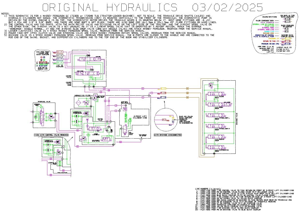

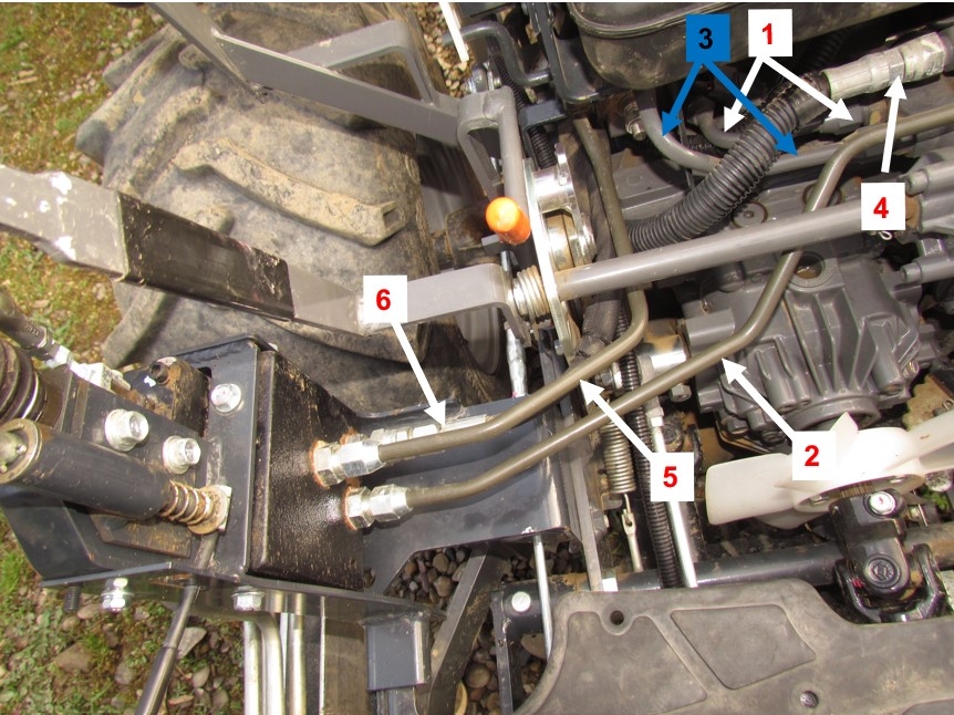

Massey Ferguson GC 1723EB hydraulics: update on original factory plumbing – updated from post #3
I have a 2022 Massey Ferguson GC1723EB TLB (tractor-loader-backhoe); her nickname is Fergie (named after the red-headed Sarah Ferguson, Dutchess of York). Much of this applies to other Massey Ferguson GC models.
I am posting an updated schematic of the original plumbing on my tractor. I have extensively updated this since my previous postings: I have added load check valves within the loader valve, and removed the pressure relief valve that “I thought” was there. I have rearranged the major components to depict their shapes and positions more nearly (note where the power takeoff relief valve is!) especially with regards to where the external lines are connected, and which are hard lines or hoses (flex lines). The locations have been determined by looking at my machine, the service manual, the parts book, and other people’s postings. All the internal lines are drilled passageways in the housings, and I have shown them close to the actual location. The internal components of valves and hydrostatic transmission have been squeezed in to be “tidy” and may not be correctly located “within” that assembly. I have also added line numbers in boxes with notes listing them. The so-called ”flange cover” mounted on top of the control valve is just a fitting block. Beware that the service manual for this model has photos which are outdated and from previous models, as they show at least one fitting and hard line where I have nothing, not even a place for that fitting; also, there are some errors in the factory schematics. Likewise, the parts books can be “iffy.” The attached photo of the schematic design will be hard to read on the forum, but I have attached a pdf file of it which you can open and be able to zoom in.
Here are some hydraulic relief valve pressure specs I have found:
- Main relief valve spec is 1920psi (blows off to tank).
- Steering pump relief valve spec is 1209psi (blows off to steering pump pressure beyond).
- Backhoe relief valve spec is 2175psi (blows off to tank).
- Hydraulic filter bypass spec is 14.2psi.
- Hydrostatic transmission high pressure relief valve spec is 2554-2700psi (blows off to other side of hydraulic loop).
- Hydrostatic transmission charge pressure relief valve spec is 57-85psi (blows off to tank – actually, I think it just blows off inside the HST housing and that housing has an overflow port to the transmission front cover located near the top).
But what is the setting for the power takeoff relief valve? As far as I can determine/figure/guess, the power takeoff relief valve and the power takeoff clutch valve are fed from power beyond of the steering valve. It appears that the power takeoff relief valve is always activated except when the power takeoff clutch valve is activated. And even when the power takeoff clutch valve is activated, it probably only takes a small amount of hydraulic fluid to lock the clutch, and then the power takeoff relief valve is again activated, although this may slowly cycle on-and-off to compensate for slight leakage. And it is only when the power takeoff relief valve is activated that any oil is fed to the hydraulic filter and then to the hydrostatic transmission. I guess that this relief valve is set at a far lower pressure than the main relief valve (likely around 100psi), and that is probably why it doesn’t seem to squeal when (always?) activated. This flow to the hydrostatic transmission is just the “charge flow”, which makes up for internal leakage within the HST.

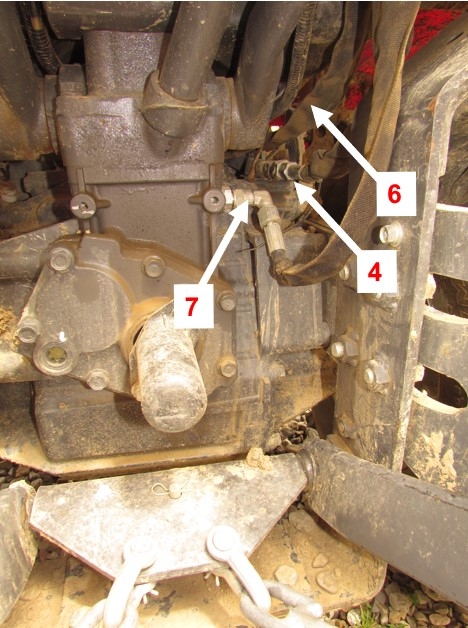

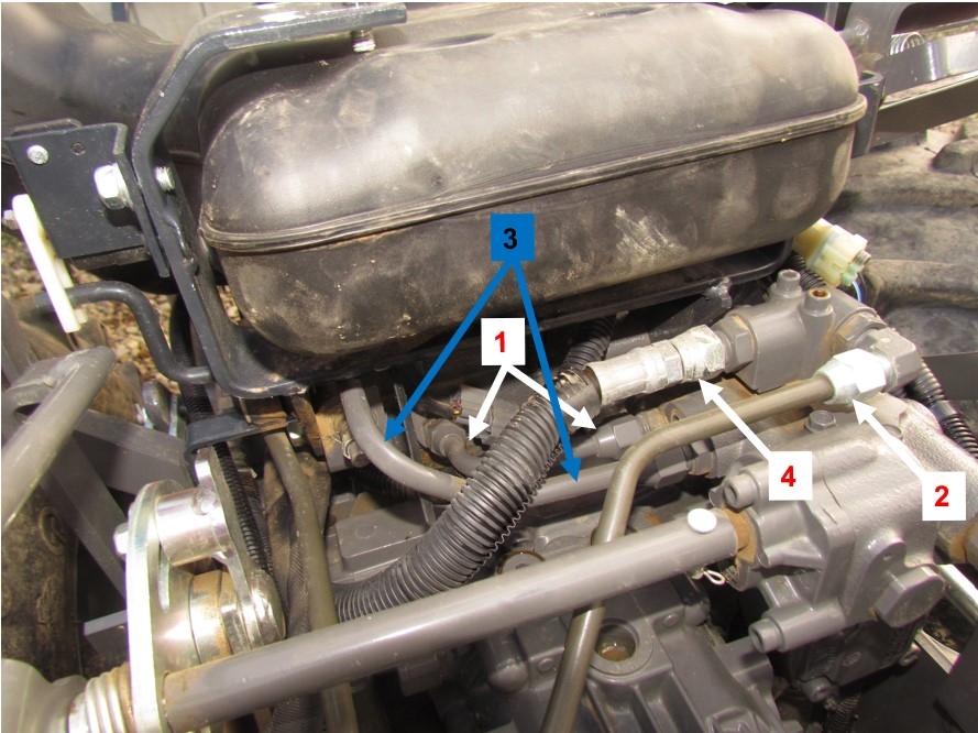

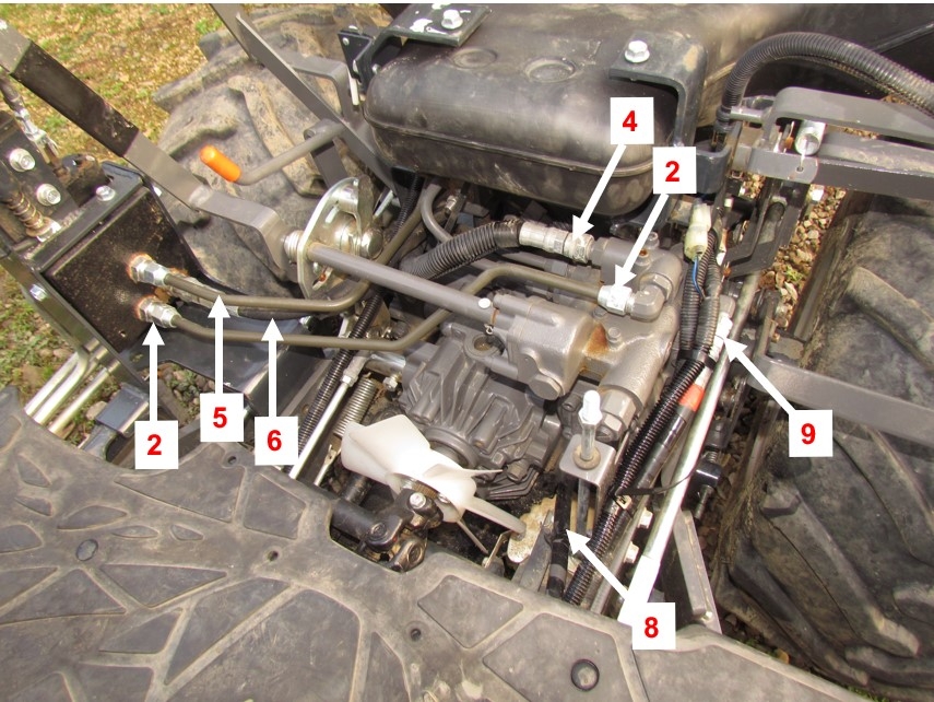

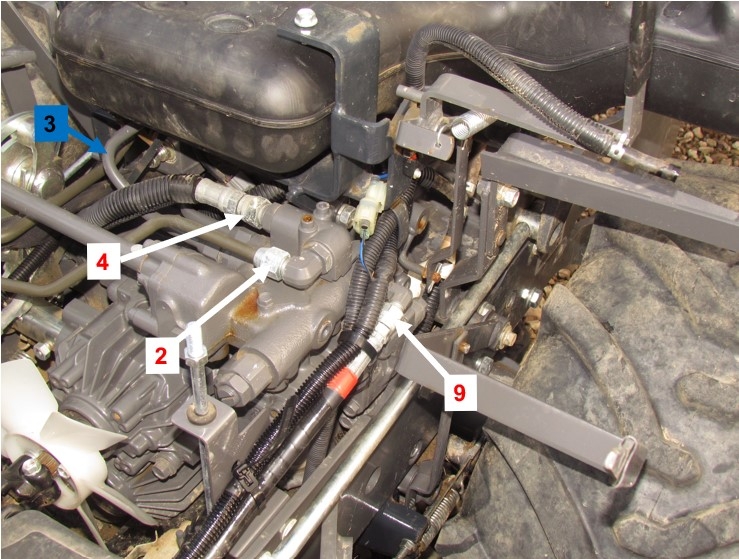

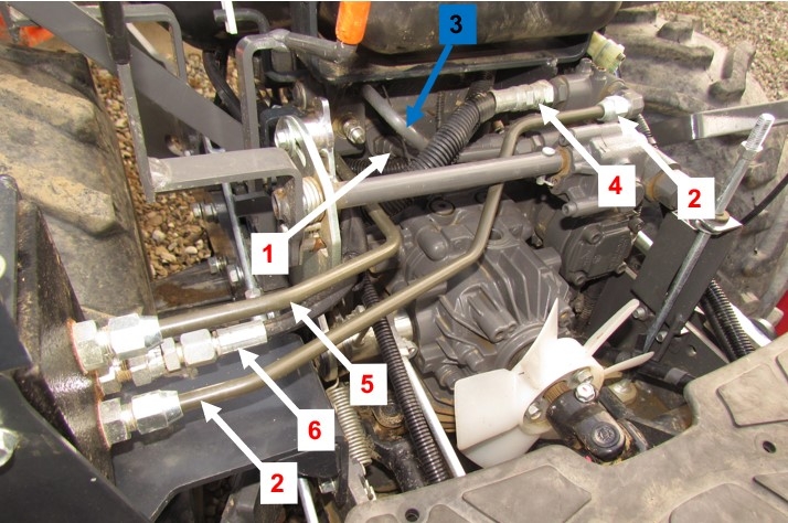

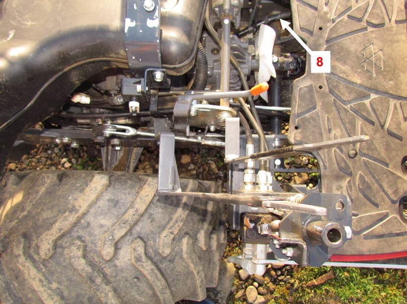

I am also posting some photographs of my machine with the fender/skirt and seat removed and the fuel tank moved aft that I have marked line numbers on that correspond with the line numbers on the schematic. There is no significance to the callouts for line #3 being blue in the pictures, it just to make sure it is not confused with the adjacent line #1.

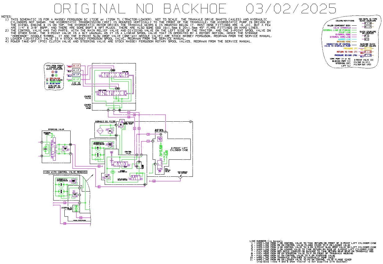

Massey Ferguson GC 1723EB hydraulics: update on original factory plumbing – updated from post #18
Once again, a new update:
- 12/7/24 file had some errors
- tried to simplify
- made the "no backhoe" version a separate drawing
Since you won't be able to read these on the forum, I am attaching pdf files of them.
I finally found a spec for the power take-off relief valve in an earlier service manual; it is 79 psi.

Nice work. I used to draw one-line hydraulic diagrams for work that were more pictorial with valve layouts, labeled ports, hose sizes, etc., used in a production environment where JIC schematics were not necessary but helped speed of assembly. I will find one somewhere and post back. Any chance you could do this 😁
