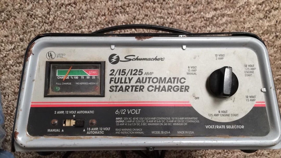

I've got one similar to this ...you just can't kill it..
I would look through FB marketplace or eBay before buying one of fancy worthless new chargers ...
I've got one of those but haven't used it in years since buying battery maintainers.
