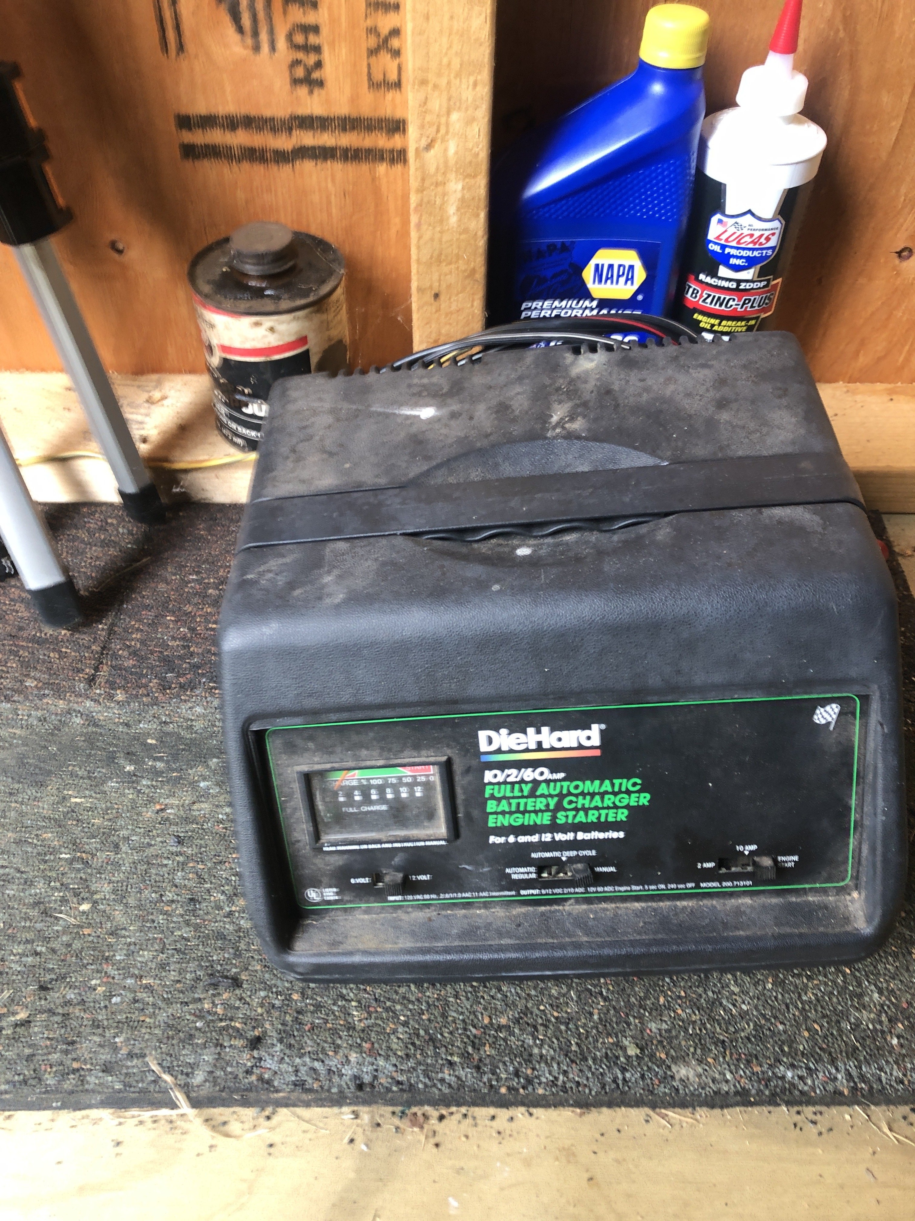

Good Afternoon Fallon,
I am pretty sure you can find what your looking for at Harbor Freight ! I picked this charger up many years ago, both 6 and 12 volt with a start option ! I use it on my 6 v tractors and my Ford Model A !

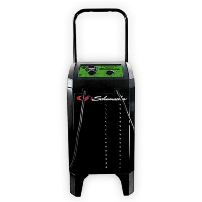

/ 6/12v battery charger recommendations?
I picked up a Schumacher Electric Wheeled Battery Charger and Jump Starter, SC1446, 2-in-1, Manual Timer-Controlled, 200 Cranking Amps, 6 Volt, 12 Volt, For Car, SUV, Truck, and Marine Batteries Amazon.com. Same thing & price as at TSC, but no hour round trip to pick it up. Time will tell if it was $150 well spent or not. Hopefully my automatic 12v unit keeps doing the unattended normal battery stuff. This should do fine for 6v, emergency starting & testing that smarts will try & thwart.
