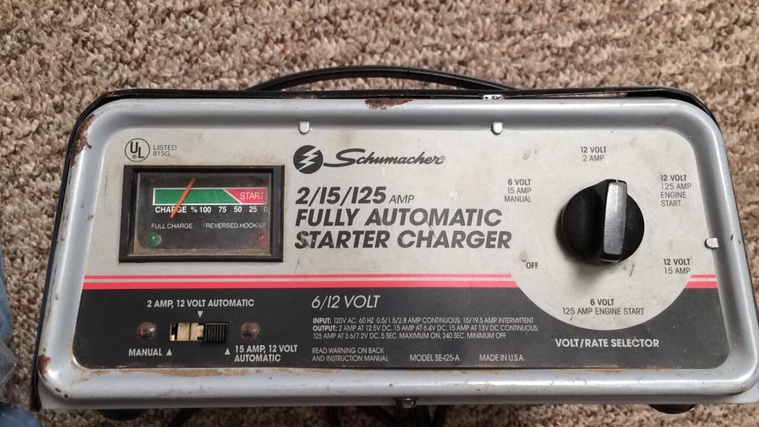

Sticking to my guns here ...
New tech out ..ole tech..hell yeah..😁
Those old tech chargers are OK if you have a dead or low battery you want to bring up to full charge (unless the battery is sulfated, in which case the charge won't hold for long.) However, too many of those old tech chargers will cook a battery if left on long term. When I'm looking for a battery maintainer for a piece of equipment that is used only occasionally, or might sit idle for a season, I want one that I can set and forget, not one that I'll come back to and find it has boiled off electrolyte in the battery.
The good ones often had a timer… very important.
I’ve had some success Cooking a battery and bringing it back to life…
Always outside with caps off and distilled water top off…
Yes the old Schumacher of mine has the dial timer on it...
